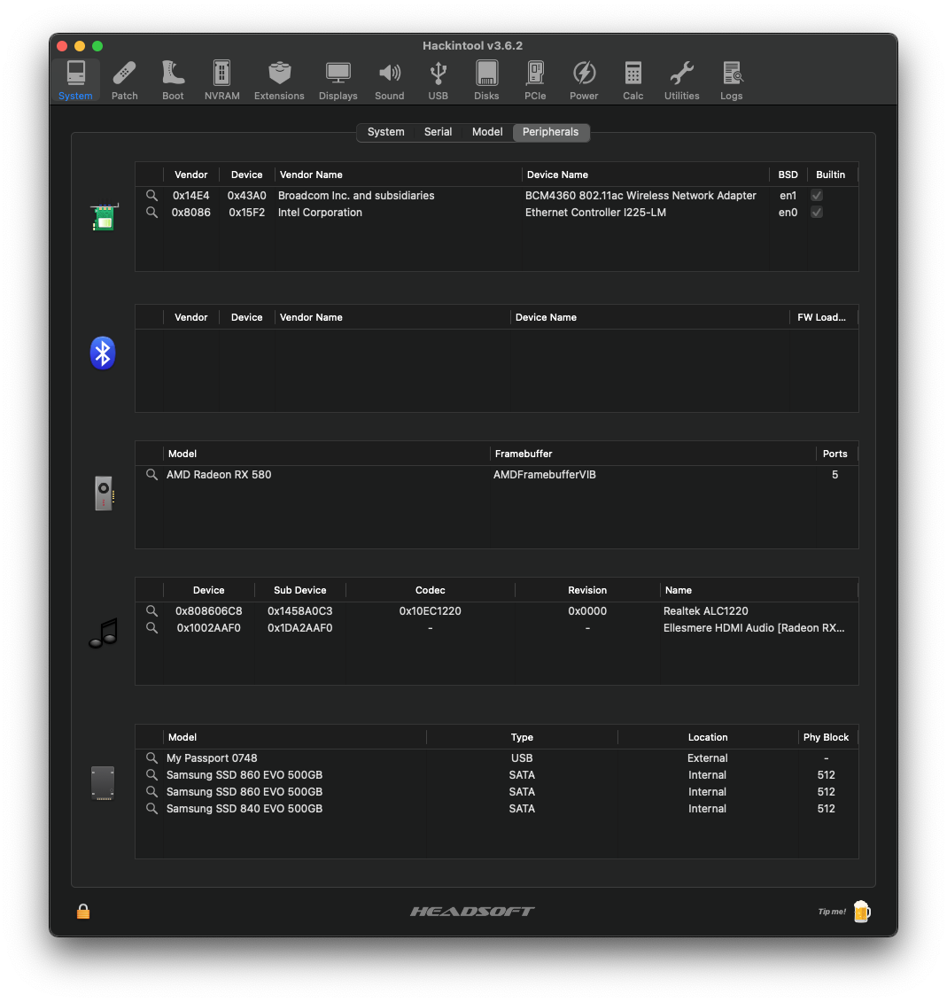

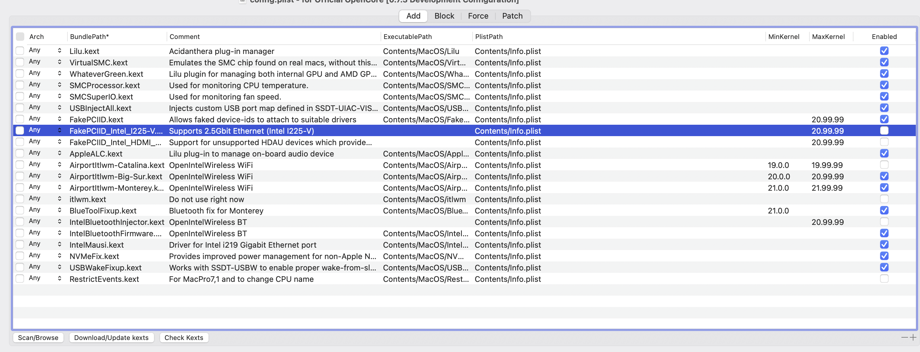

Guest 5T33Z0 Posted August 14, 2021 Share Posted August 14, 2021 On 8/3/2021 at 7:11 AM, surenmunoo said: From what I saw of your posts, it looks like you are NOT using the i225 Controller but the I219. Because the I219-V on the Vision D Board is controller number one (en0) and it shows up in Network Settings as "Ethernet" whereas the I225 Controller (en1) is "Ethernet2" unless you changed the names manually. Are you sure your LAN cable is connected to the red socket and not the black one? Link to comment https://www.insanelymac.com/forum/topic/348493-discussion-intel-i225-v-on-macos-monterey/page/3/#findComment-2764719 Share on other sites More sharing options...

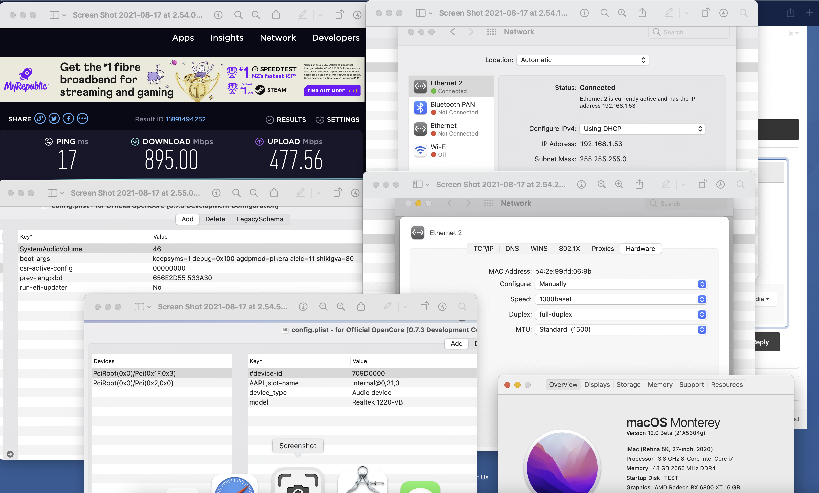

surenmunoo Posted August 14, 2021 Share Posted August 14, 2021 1 hour ago, 5T33Z0 said: From what I saw of your posts, it looks like you are NOT using the i225 Controller but the I219. Because the I219-V on the Vision D Board is controller number one (en0) and it shows up in Network Settings as "Ethernet" whereas the I225 Controller (en1) is "Ethernet2" unless you changed the names manually. Are you sure your LAN cable is connected to the red socket and not the black one? Yup, I am using the red network port at the back. I am sure I proved that by now that both my network ports work. If you refer to the pictures I posted you will see speed tests from each port with wifi disabled. Link to comment https://www.insanelymac.com/forum/topic/348493-discussion-intel-i225-v-on-macos-monterey/page/3/#findComment-2764720 Share on other sites More sharing options...
Guest 5T33Z0 Posted August 14, 2021 Share Posted August 14, 2021 @surenmunooOkay, cool. But how did you configure it? DeviceProperties, boot-args, Network settings etc. Because looking at screenshots doesn't fix my issue! Link to comment https://www.insanelymac.com/forum/topic/348493-discussion-intel-i225-v-on-macos-monterey/page/3/#findComment-2764729 Share on other sites More sharing options...
surenmunoo Posted August 14, 2021 Share Posted August 14, 2021 2 hours ago, 5T33Z0 said: @surenmunooOkay, cool. But how did you configure it? DeviceProperties, boot-args, Network settings etc. Because looking at screenshots doesn't fix my issue! MY EFI(excluding the kexts folder and serial numbers) is linked to a post from in in page 2. I use a boot arg with nothing else and it just works. Link to comment https://www.insanelymac.com/forum/topic/348493-discussion-intel-i225-v-on-macos-monterey/page/3/#findComment-2764733 Share on other sites More sharing options...
Henties Posted August 15, 2021 Share Posted August 15, 2021 @surenmunoo I am also interested in getting my i225-v onboard controller working properly under Monterey beta whatever, presently beta 5, therefore I had a very detailed look at your EFI folder but I could not find anything that I believe would make my i225-V working reliably. Why yours is working remains a mystery to me. I have therefore attached my EFI folder with the "Generic" section containing my serial etc. removed. To reduce the size of the upload I also removed the "Resources" folder, this single EFI is used for both Big Sur as well as Monterey, in a multi boot configuration, as can be seen from my comments added at the beginning of the config.plist file. I kept the kexts I use in as I believe they might be the key why my i225-V is not working reliably, whereas yours is, but as I don't know which kexts you are using I can only get this working with your assistance. I would be grateful, of cause time permitting, if you could analyse my EFI and suggest what I should add and or remove, to get my i225-V working reliably the same way yours is working. Greetings Henties EFI.zip Link to comment https://www.insanelymac.com/forum/topic/348493-discussion-intel-i225-v-on-macos-monterey/page/3/#findComment-2764749 Share on other sites More sharing options...
surenmunoo Posted August 15, 2021 Share Posted August 15, 2021 2 hours ago, Henties said: @surenmunoo I am also interested in getting my i225-v onboard controller working properly under Monterey beta whatever, presently beta 5, therefore I had a very detailed look at your EFI folder but I could not find anything that I believe would make my i225-V working reliably. Why yours is working remains a mystery to me. I have therefore attached my EFI folder with the "Generic" section containing my serial etc. removed. To reduce the size of the upload I also removed the "Resources" folder, this single EFI is used for both Big Sur as well as Monterey, in a multi boot configuration, as can be seen from my comments added at the beginning of the config.plist file. I kept the kexts I use in as I believe they might be the key why my i225-V is not working reliably, whereas yours is, but as I don't know which kexts you are using I can only get this working with your assistance. I would be grateful, of cause time permitting, if you could analyse my EFI and suggest what I should add and or remove, to get my i225-V working reliably the same way yours is working. Greetings Henties EFI.zip 2.55 MB · 0 downloads I will try your EFI on my system later this evening when I get home from work, will post my results back here. Link to comment https://www.insanelymac.com/forum/topic/348493-discussion-intel-i225-v-on-macos-monterey/page/3/#findComment-2764753 Share on other sites More sharing options...
surenmunoo Posted August 16, 2021 Share Posted August 16, 2021 12 hours ago, Henties said: @surenmunoo I am also interested in getting my i225-v onboard controller working properly under Monterey beta whatever, presently beta 5, therefore I had a very detailed look at your EFI folder but I could not find anything that I believe would make my i225-V working reliably. Why yours is working remains a mystery to me. I have therefore attached my EFI folder with the "Generic" section containing my serial etc. removed. To reduce the size of the upload I also removed the "Resources" folder, this single EFI is used for both Big Sur as well as Monterey, in a multi boot configuration, as can be seen from my comments added at the beginning of the config.plist file. I kept the kexts I use in as I believe they might be the key why my i225-V is not working reliably, whereas yours is, but as I don't know which kexts you are using I can only get this working with your assistance. I would be grateful, of cause time permitting, if you could analyse my EFI and suggest what I should add and or remove, to get my i225-V working reliably the same way yours is working. Greetings Henties EFI.zip 2.55 MB · 1 download Hey Mate, I tried with your refi for the last hour and I just cannot get it to work. I changed/removed your kexts and loaded mine, added the SSDT's that I have, put in my boot args but nothing works with your EFI. I boot with my EFI and all works properly. Have your tried my EFI and see if it works for you. Put it in a usb and test it out. Link to comment https://www.insanelymac.com/forum/topic/348493-discussion-intel-i225-v-on-macos-monterey/page/3/#findComment-2764775 Share on other sites More sharing options...

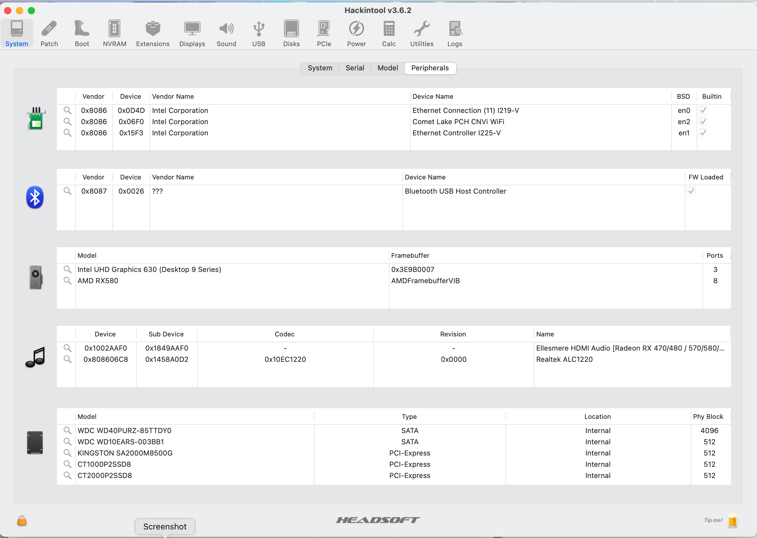

Guest 5T33Z0 Posted August 16, 2021 Share Posted August 16, 2021 (edited) @surenmunoo @Henties I had a look at both of your EFIs. Thanks for sharing. Besides the fact one of you uses a Vision G and one a Vision D Board, I noticed both of you have added all the DeviceProperies from Hackintool. Besides that I can't see anything else distinct related to networking to why the I225 works for you and not for me. Maybe I'll try importing all the DeviceProperties of existing PCI Devices as well for testing. But As far as I am aware, adding DeviceProperties found by Hackintool to the config is redundant, since you are adding in PCI Devices the system already detected anyway. From my understanding, you only need to add DeviceProperties for devices which you want to change certain properties of. or am I wrong? Edited August 16, 2021 by 5T33Z0 Link to comment https://www.insanelymac.com/forum/topic/348493-discussion-intel-i225-v-on-macos-monterey/page/3/#findComment-2764779 Share on other sites More sharing options...
Henties Posted August 16, 2021 Share Posted August 16, 2021 @5T33Z0 In my EFI I have only added the "Device Properties" that are needed. The i225-V controller is also currently disabled in my EFI by commenting out the line containing the dk.e1000=0 boot argument. I did this because the i225-V has become unusable, in my 2 rigs at least, and when booting into Monterey beta 5. I now rely on the Aquantia PCIe NIC for networking and a UGREEN gigabit dongle for my 2nd network port used for my DANTE audio backbone. Everything works honkey dory the way my EFI is configured for both my Vision G builds. Just wandering if there is something wrong with the counters on this board, the EFI.zip that I posted was only opened/downloaded once, yet 2 different people are ostensibly testing this EFI. Strange things, making me wander, happen in strange places. :-) Greetings Henties Link to comment https://www.insanelymac.com/forum/topic/348493-discussion-intel-i225-v-on-macos-monterey/page/3/#findComment-2764782 Share on other sites More sharing options...

Irish_Man Posted August 16, 2021 Author Share Posted August 16, 2021 I've tried everything I can to get my ethernet working but no luck. I've tried both of your EFI folders and still no luck. Btw, tnx for uploading. The green light is there but no connection. BTW, Bluetooth is not on the list (don't know why) but it's working fine. 1 Link to comment https://www.insanelymac.com/forum/topic/348493-discussion-intel-i225-v-on-macos-monterey/page/3/#findComment-2764812 Share on other sites More sharing options...
surenmunoo Posted August 17, 2021 Share Posted August 17, 2021 Just tested my system now with a new EFI with no boot arg for the i225-v and no device properties and the kext turned off and it still works. EFI.zip Link to comment https://www.insanelymac.com/forum/topic/348493-discussion-intel-i225-v-on-macos-monterey/page/3/#findComment-2764815 Share on other sites More sharing options...

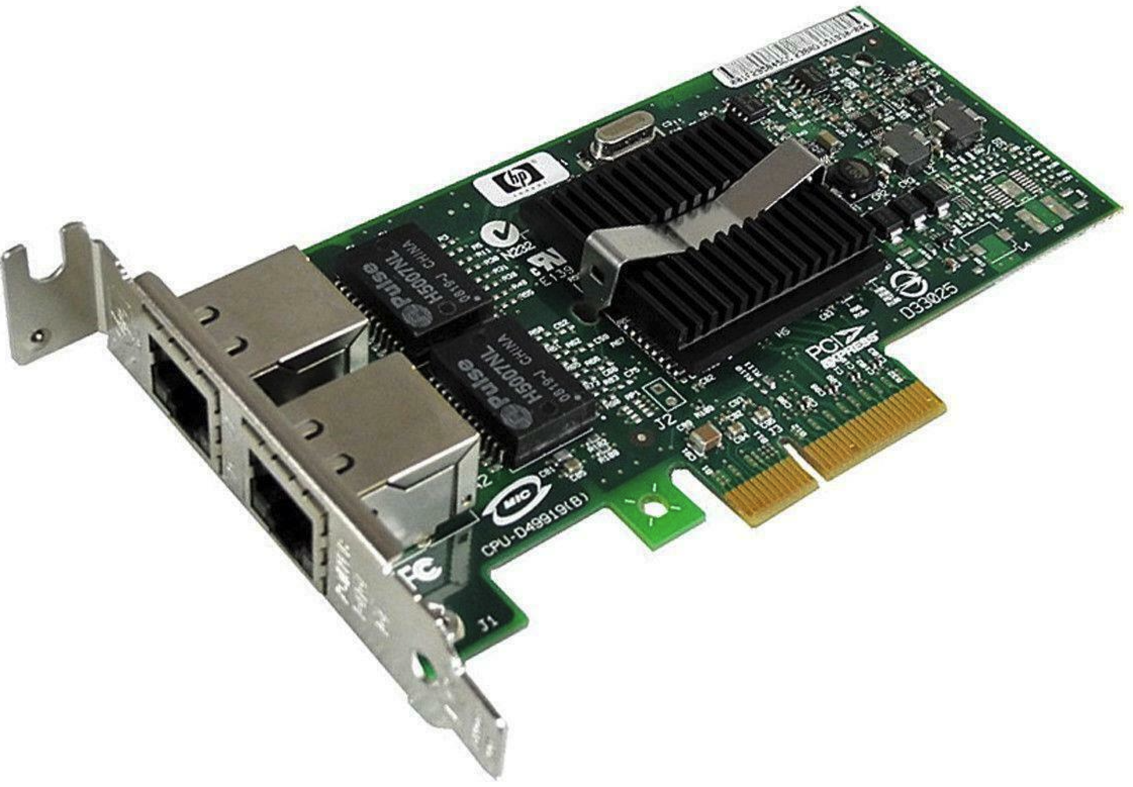

Guest 5T33Z0 Posted August 20, 2021 Share Posted August 20, 2021 Can anyone recommend a Network Card (Gigabit Ethernet is enough) which is compatible with Mojave all the way up to Monterey? Probabyl something where a Kext exists for, I guess. Because I managed to create a config for legacy systems since I have some old Apps and Audio Plugins which are 32 bit only, so I have to use Mojave from time to time. And not be able to have acces to the internet really suuuucks. Link to comment https://www.insanelymac.com/forum/topic/348493-discussion-intel-i225-v-on-macos-monterey/page/3/#findComment-2764957 Share on other sites More sharing options...
Rocky12 Posted August 20, 2021 Share Posted August 20, 2021 HP NC360T Intel PRO/1000 PT LP Gigabit Dual Port = Intel 82571EB work OTB from Mavericks to Monterey no issue no kext just relax eBay 3 2 Link to comment https://www.insanelymac.com/forum/topic/348493-discussion-intel-i225-v-on-macos-monterey/page/3/#findComment-2764976 Share on other sites More sharing options...
Guest 5T33Z0 Posted August 20, 2021 Share Posted August 20, 2021 @Rocky12 Thank you very much. Ordered it immediately on ebay for 10 Euros. Link to comment https://www.insanelymac.com/forum/topic/348493-discussion-intel-i225-v-on-macos-monterey/page/3/#findComment-2764990 Share on other sites More sharing options...

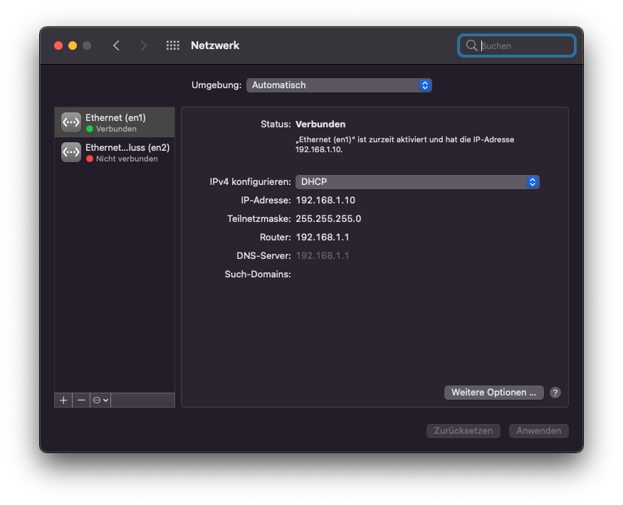

Guest 5T33Z0 Posted August 24, 2021 Share Posted August 24, 2021 (edited) The HP NC360T Network Card arrived today. Working OOB as promised in Mojave and Monterey. I am wondering: do I have to change the ROM of the PlatformInfos now since it's the MAC-Addesssof the I-225 NIC but the cable is now connected to the HP card? I would like to avoid having to change the MAC Adress in the config, because a lot of audio plugins use the MAC Address for authorization. I've noticed that with this card I had to disable the "dk.e1000=0" boot-arg for Monterey otherwise the machine would freeze during boot. Edited August 24, 2021 by 5T33Z0 Link to comment https://www.insanelymac.com/forum/topic/348493-discussion-intel-i225-v-on-macos-monterey/page/3/#findComment-2765186 Share on other sites More sharing options...

Irish_Man Posted September 22, 2021 Author Share Posted September 22, 2021 (edited) Guys, I just updated to Beta 7 and my i225-V Ethernet is working. No need for FakePCIID kexts at all. Edited September 22, 2021 by Irish_Man 1 Link to comment https://www.insanelymac.com/forum/topic/348493-discussion-intel-i225-v-on-macos-monterey/page/3/#findComment-2767210 Share on other sites More sharing options...
