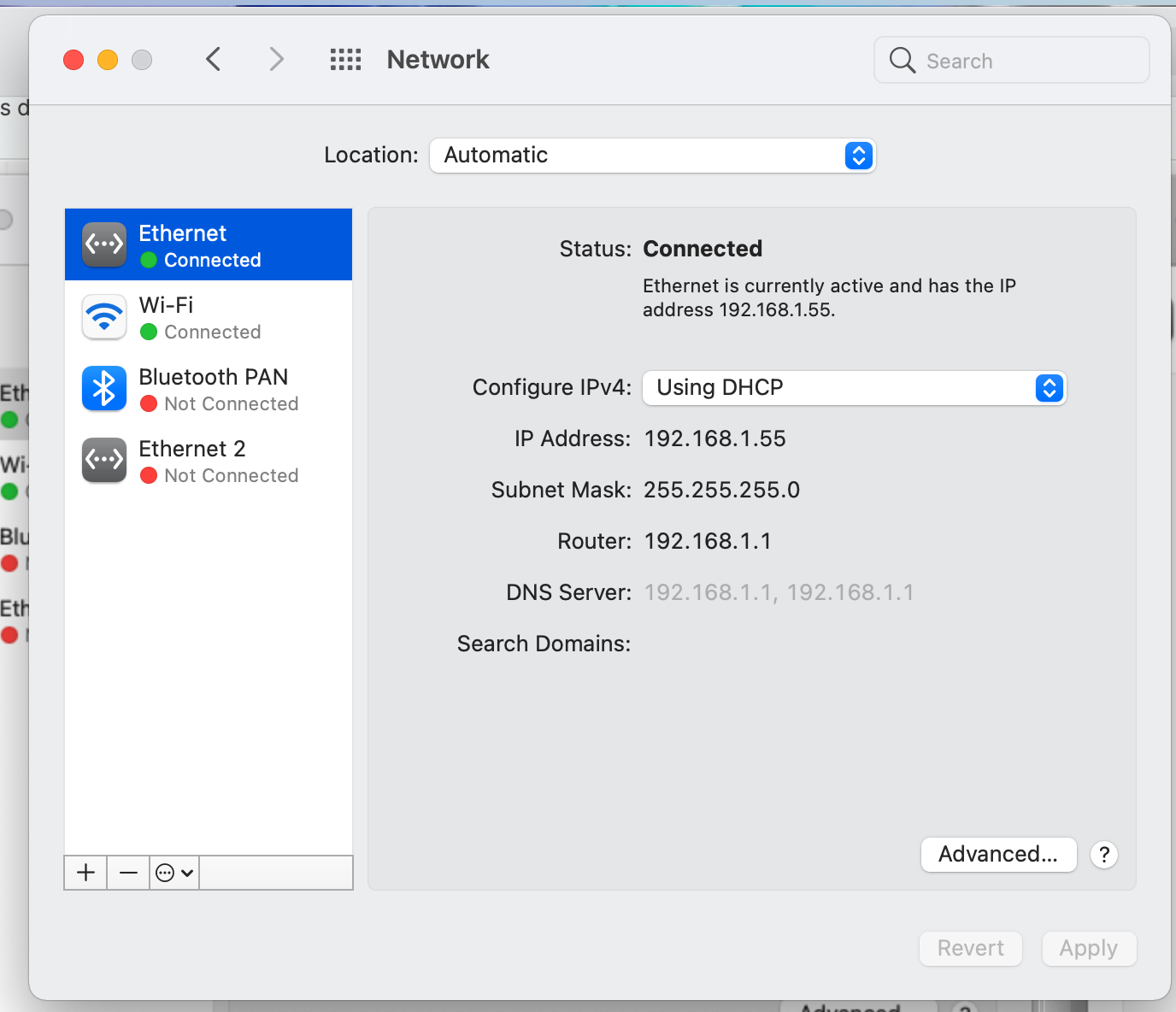

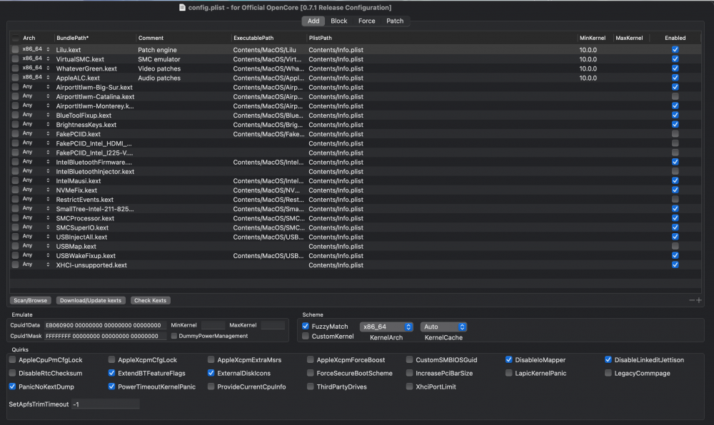

surenmunoo Posted August 2, 2021 Share Posted August 2, 2021 59 minutes ago, Irish_Man said: How? What kexts you using? I am using this boot arg " dk.e1000=0 " (without quotes ) and have no device properties for the ethernet ports. below is the kexts I have and you can see I have the i225-V disabled 3 Link to comment https://www.insanelymac.com/forum/topic/348493-discussion-intel-i225-v-on-macos-monterey/#findComment-2764078 Share on other sites More sharing options...

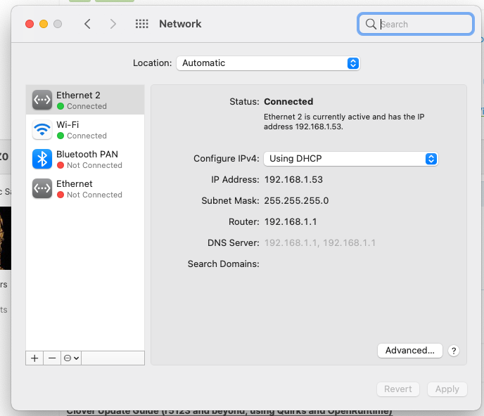

surenmunoo Posted August 2, 2021 Share Posted August 2, 2021 (edited) 9 hours ago, SavageAUS said: A lot of us have no working Ethernet with the smalltree kext, does that boot arg relate to this kext or another? Issue is here https://github.com/khronokernel/SmallTree-I211-AT-patch/issues/3 and not resolved yet. Can you post device details and screenshot of network prefs that shows connection. Sent from my iPhone using Tapatalk I should have mentioned that I changed my hardware in Ethernet to manual and changed speed 1000BaseT and then changed it back to Auto as my max fibre speed is 1GB. Not sure what that boot arg relate to but just know that it works and has done so well so far. Edited August 2, 2021 by surenmunoo Link to comment https://www.insanelymac.com/forum/topic/348493-discussion-intel-i225-v-on-macos-monterey/#findComment-2764116 Share on other sites More sharing options...
bidero Posted August 2, 2021 Share Posted August 2, 2021 1 hour ago, surenmunoo said: I should have mentioned that I changed my hardware in Ethernet to manual and changed speed 1000BaseT and then changed it back to Auto as my max fibre speed is 1GB. Not sure what that boot arg relate to but just know that it works and has done so well so far. Is it working when WiFi is disabled? I also have green light If I set up 225 manually but there is no connection at all. Link to comment https://www.insanelymac.com/forum/topic/348493-discussion-intel-i225-v-on-macos-monterey/#findComment-2764117 Share on other sites More sharing options...
SavageAUS Posted August 3, 2021 Share Posted August 3, 2021 I should have mentioned that I changed my hardware in Ethernet to manual and changed speed 1000BaseT and then changed it back to Auto as my max fibre speed is 1GB. Not sure what that boot arg relate to but just know that it works and has done so well so far. And what about the other Ethernet device? The one just listed as Ethernet? Does that work? You could be not using the 211 based port. Sent from my iPhone using Tapatalk Link to comment https://www.insanelymac.com/forum/topic/348493-discussion-intel-i225-v-on-macos-monterey/#findComment-2764128 Share on other sites More sharing options...

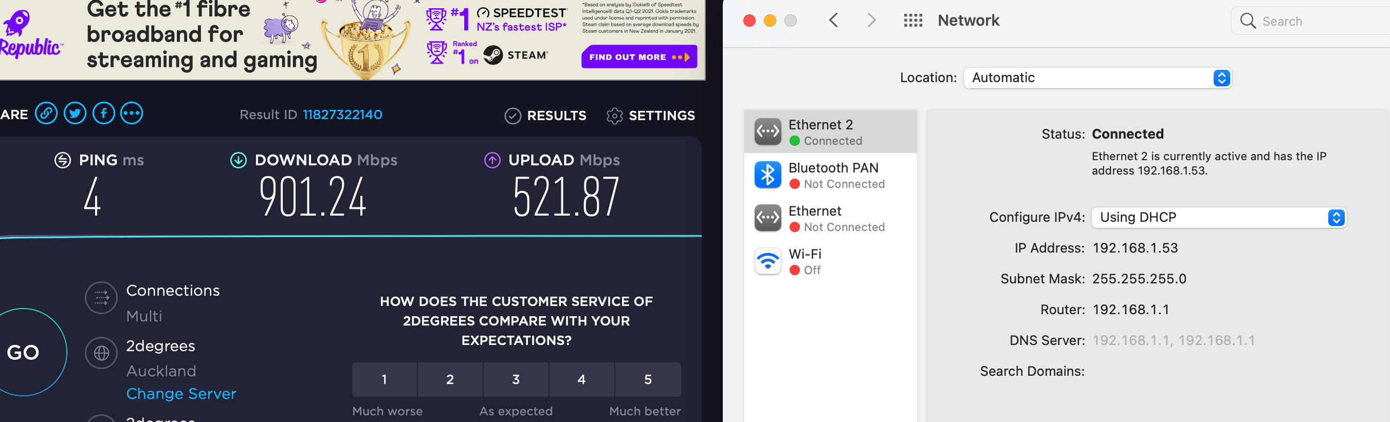

surenmunoo Posted August 3, 2021 Share Posted August 3, 2021 (edited) 8 hours ago, bidero said: Is it working when WiFi is disabled? I also have green light If I set up 225 manually but there is no connection at all. It works with no issues with or without wifi. 2 hours ago, SavageAUS said: And what about the other Ethernet device? The one just listed as Ethernet? Does that work? You could be not using the 211 based port. Sent from my iPhone using Tapatalk Both work just fine. Refer to the pictures of the port just marked ethernet. 2 hours ago, SavageAUS said: And what about the other Ethernet device? The one just listed as Ethernet? Does that work? You could be not using the 211 based port. Sent from my iPhone using Tapatalk Edited August 3, 2021 by surenmunoo Link to comment https://www.insanelymac.com/forum/topic/348493-discussion-intel-i225-v-on-macos-monterey/#findComment-2764132 Share on other sites More sharing options...

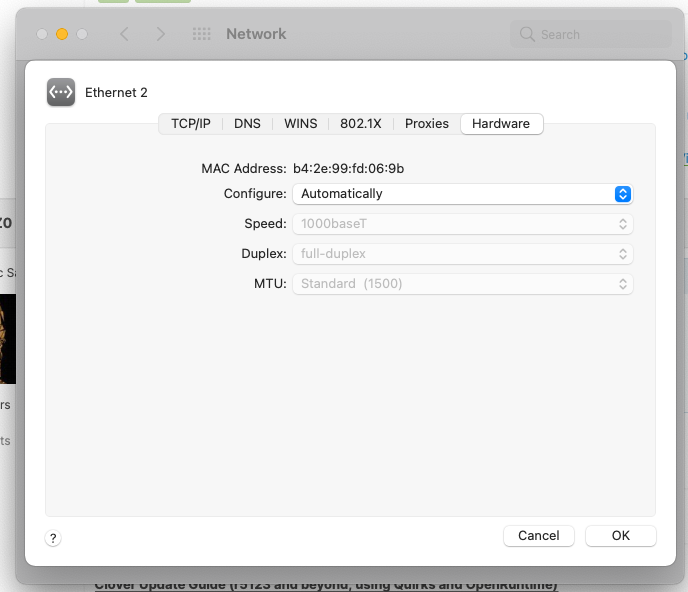

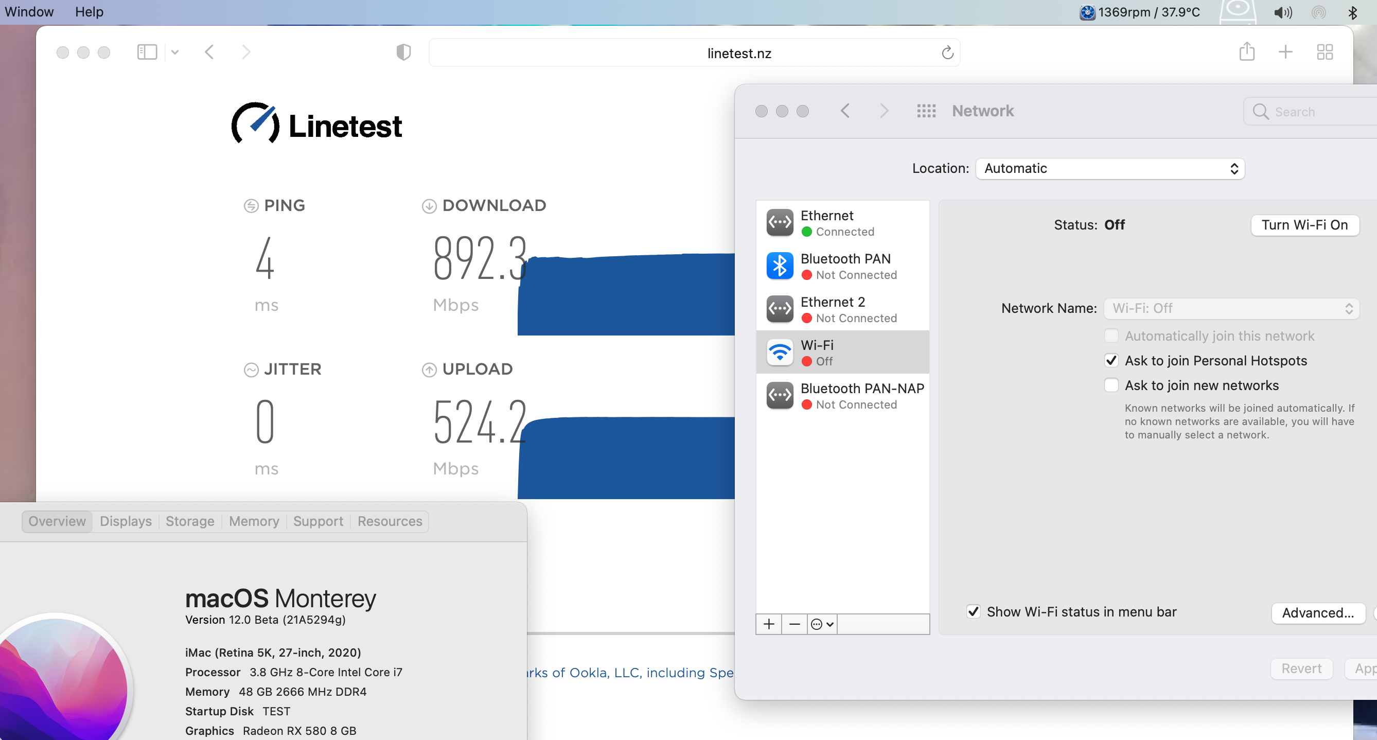

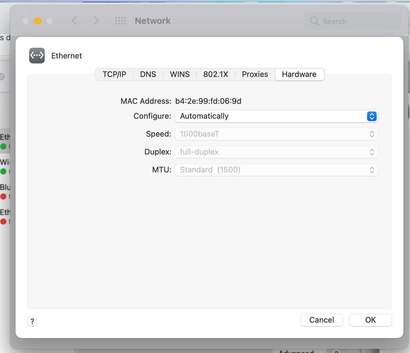

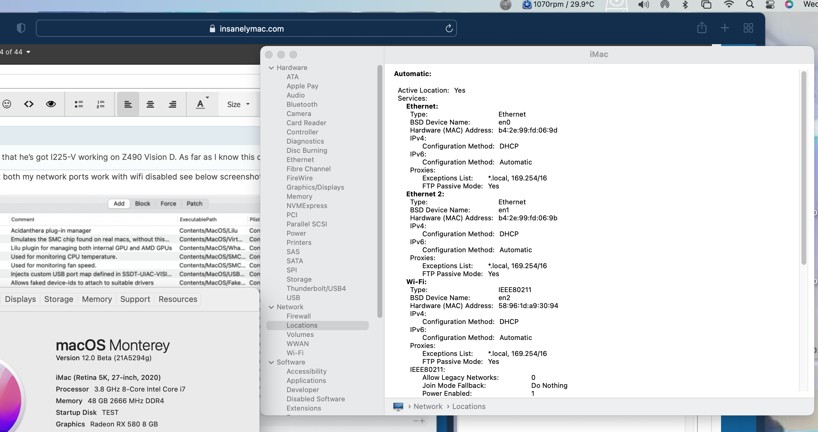

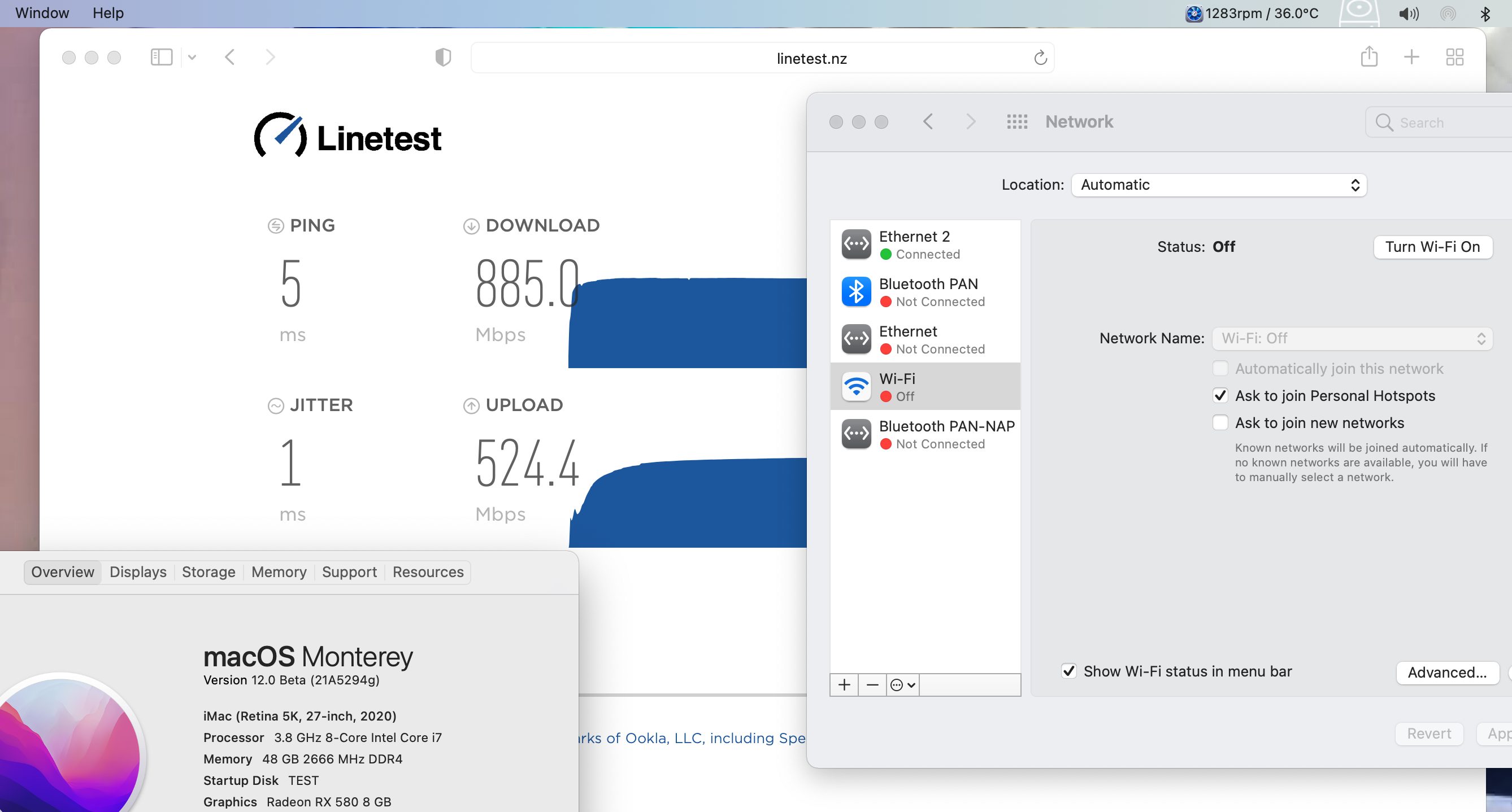

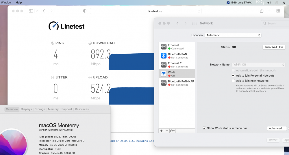

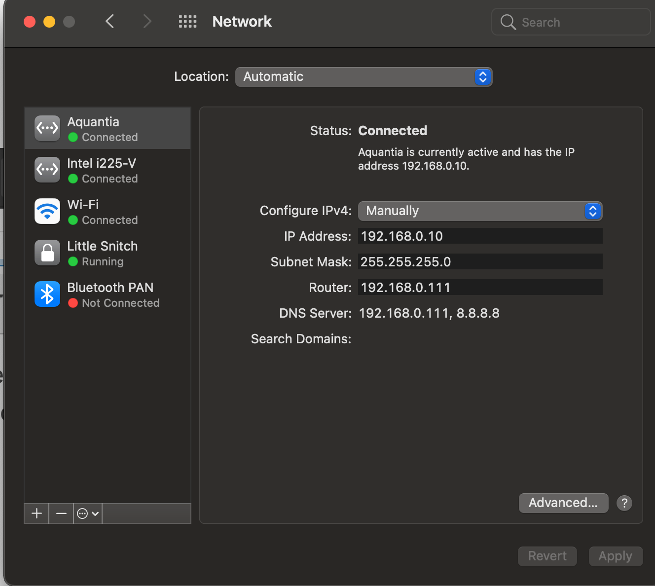

surenmunoo Posted August 4, 2021 Share Posted August 4, 2021 (edited) 17 hours ago, bidero said: Are you 100% sure you're using 225 instead of 219? Could you disable WiFi, connect ethernet cable to the other port and then check if it's working? Just try to load any website with WiFi disabled with each ethernet port. On my system (also Z490 Vision D) the 225 is marked as "Ethernet 2" and there is no way to make it work even with manual settings. 219 works just fine and Hackintool peripherals tab looks exactly the same. EDIT: I'm also using dk.e1000=0 in boot-args and removed 225 device properties even before installing Monterey. WIFI is disabled and tested for you. Yes I am using the i225-V network port, both my ports work perfectly fine using that boot arg with no issues. 16 hours ago, AudioGod said: @surenmunoo You’re Z370-P uses a Realtek RTL8111H Ethernet port and your Asus B560-F uses a Intel I225-V, both these ports are not related to the smalltree kext so I expect them to be working just fine. The issue people are having is with the Intel I211 that uses the smalltree kext and does not work under Monterey. This is on my Gigabyte Z490 Vision D, The tests are for this board. The initial question was about the i225-V ports and if they work of which Yes it works Edited August 4, 2021 by surenmunoo 1 Link to comment https://www.insanelymac.com/forum/topic/348493-discussion-intel-i225-v-on-macos-monterey/#findComment-2764193 Share on other sites More sharing options...
surenmunoo Posted August 4, 2021 Share Posted August 4, 2021 16 hours ago, bidero said: @AudioGod On previous page he said that he’s got I225-V working on Z490 Vision D. As far as I know this one doesn’t work in Monterey. That’s why we’re asking so much questions Just to clear everything and to prove that both my network ports work with wifi disabled see below screenshots. It works perfectly with no issues. I am on OC 0.7.2. I have done 2 speed tests with each network port and you can see the results. 3 Link to comment https://www.insanelymac.com/forum/topic/348493-discussion-intel-i225-v-on-macos-monterey/#findComment-2764194 Share on other sites More sharing options...

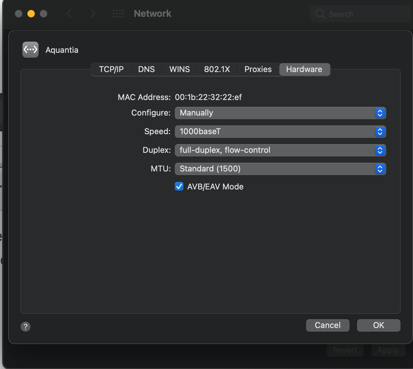

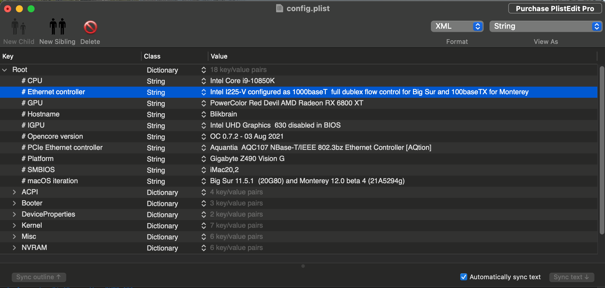

Henties Posted August 4, 2021 Share Posted August 4, 2021 (edited) I have moved my Monterey beta experimental efforts to another GA-Z490 Vision G build, (the almost twin brother of another computer) which is identical to the one I used for experimentation before. The only difference is that the new experimental machine is fitted with an Aquantia AQC107 PCIe ethernet card. The latter works very well and without configuration changes on either Big Sur 11.5.1 (20G80) or Monterey 12.0 beta 4 (21A5294g} whereas the i225-V works perfectly under Big Sur 11.5.1 (20G80) up to 1000baseT whereas on Monterey 12.0 beta 4 (21A5294g) it will only work up to 100baseTX. I am dual booting between Big Sur and Monterey with one EFI OC 0.7.2 folder and an identical config.plist file in all respects serving both operating systems. For clarity I have attached some pictures: Greetings Henties Edit: Added screenshot of "Boot menu" Edited August 4, 2021 by Henties 3 Link to comment https://www.insanelymac.com/forum/topic/348493-discussion-intel-i225-v-on-macos-monterey/#findComment-2764202 Share on other sites More sharing options...

bidero Posted August 4, 2021 Share Posted August 4, 2021 (edited) 6 hours ago, surenmunoo said: Just to clear everything and to prove that both my network ports work with wifi disabled see below screenshots. It works perfectly with no issues. I am on OC 0.7.2. I have done 2 speed tests with each network port and you can see the results. I'm really grateful that you have tested everything. You're the first person to have it working on Vision D. I'm wondering if it's somehow connected with mainboard revision. According to intel, early revisions of I225 had some problems setting correct link speed https://cdrdv2.intel.com/v1/dl/getContent/621661. I have I225 Rev. 2 - SLNJY. @SavageAUS With Gigabyte Z490 Vision D it's the other way around. We have two NICs. I219 - 1 Gbps which is working just fine with IntelMausi.kext and I225 - 2.5 Gpbs which is problematic. @Henties What's the brand of your Aquantia card? Edited August 4, 2021 by bidero Link to comment https://www.insanelymac.com/forum/topic/348493-discussion-intel-i225-v-on-macos-monterey/#findComment-2764208 Share on other sites More sharing options...

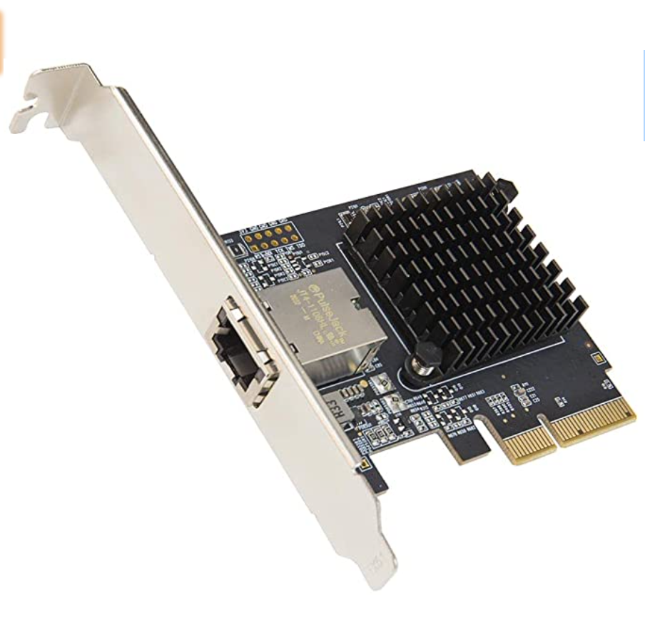

Henties Posted August 4, 2021 Share Posted August 4, 2021 (edited) @bidero here we go: Syba 1 Port 10 Gigabit Ethernet Network Card - PCIe x4 10Gb 10GBASE-T NIC AQTION AQC107-10Gbps Ethernet PCI-Express x4 Adapter SD-PEX24055 This is a 10 Gigabit incarnation requiring a 4 lane PCIe slot, beware of that, you may need those 4 lanes elsewhere. I am upgrading my backbone sooner than later so for the time being this for experimental purposes only. And here is a picture to round it off: Edited August 4, 2021 by Henties 2 Link to comment https://www.insanelymac.com/forum/topic/348493-discussion-intel-i225-v-on-macos-monterey/#findComment-2764211 Share on other sites More sharing options...
