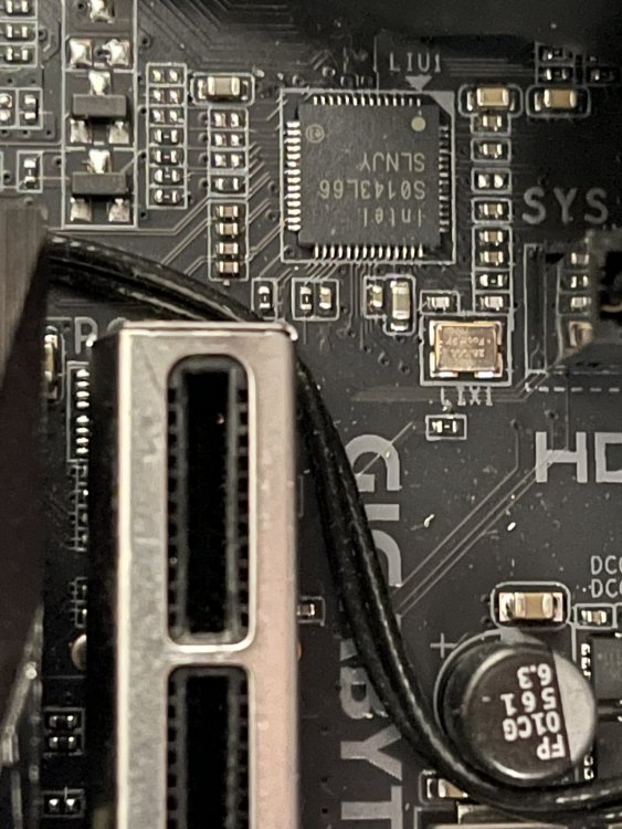

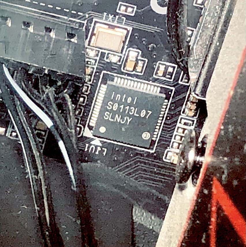

bidero Posted August 5, 2021 Share Posted August 5, 2021 @surenmunoo My board revision is also 1.1. I know I’ve already asked you a lot, but would you mind taking a picture of I225 on your board please? It’s near the left edge of the board (below back panel), just above 1st pcie slot. Or you could just write down what’s in the 3rd line. Link to comment https://www.insanelymac.com/forum/topic/348493-discussion-intel-i225-v-on-macos-monterey/page/2/#findComment-2764257 Share on other sites More sharing options...

surenmunoo Posted August 5, 2021 Share Posted August 5, 2021 7 hours ago, bidero said: @surenmunoo My board revision is also 1.1. I know I’ve already asked you a lot, but would you mind taking a picture of I225 on your board please? It’s near the left edge of the board (below back panel), just above 1st pcie slot. Or you could just write down what’s in the 3rd line. No Issues, I am changing my fans later this afternoon so will send a picture. 19 minutes ago, Naki said: @surenmunoo -- this is Linespeed.what!? Lose that dummy, noname, useless network test. Use the industry standard instead: https://www.speedtest.net/ RE guys with those 10 GBit LAN cards -- all good but have in mind that WiFi routers and LAN switches that support 10 GBit and even the slower 2.5 Gbit will cost a small fortune. Once such routers and switches prices go down, maybe there is a better chance to use such LAN cards. :) Yeah, I use that as well but that website is down most of the time. Link to comment https://www.insanelymac.com/forum/topic/348493-discussion-intel-i225-v-on-macos-monterey/page/2/#findComment-2764280 Share on other sites More sharing options...

surenmunoo Posted August 6, 2021 Share Posted August 6, 2021 15 hours ago, bidero said: @surenmunoo My board revision is also 1.1. I know I’ve already asked you a lot, but would you mind taking a picture of I225 on your board please? It’s near the left edge of the board (below back panel), just above 1st pcie slot. Or you could just write down what’s in the 3rd line. 2 Link to comment https://www.insanelymac.com/forum/topic/348493-discussion-intel-i225-v-on-macos-monterey/page/2/#findComment-2764292 Share on other sites More sharing options...
bidero Posted August 6, 2021 Share Posted August 6, 2021 Thanks @surenmunoo, SLNJY - Revision 2. Same as mine. I really have no idea how to make It work 😕 Link to comment https://www.insanelymac.com/forum/topic/348493-discussion-intel-i225-v-on-macos-monterey/page/2/#findComment-2764335 Share on other sites More sharing options...

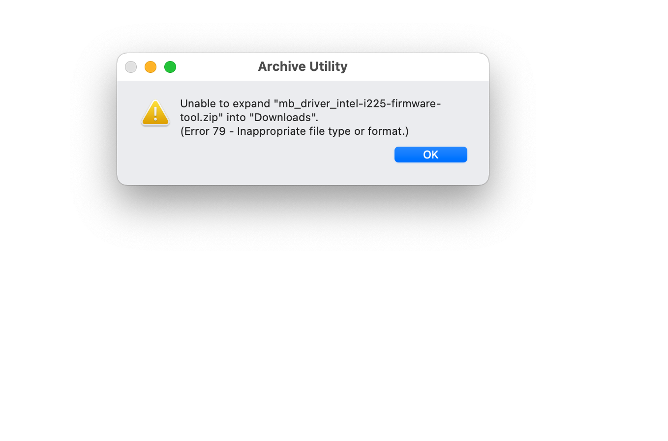

Henties Posted August 7, 2021 Share Posted August 7, 2021 @Rocky12 The mb_driver_intel-i225-firmware-tool.zip file which you posted cannot be opened by me, neither can I open the one that Gigabyte is hosting on their web site, what is the magic that seemingly enables you to open and use that file ? Greetings Henties Link to comment https://www.insanelymac.com/forum/topic/348493-discussion-intel-i225-v-on-macos-monterey/page/2/#findComment-2764348 Share on other sites More sharing options...

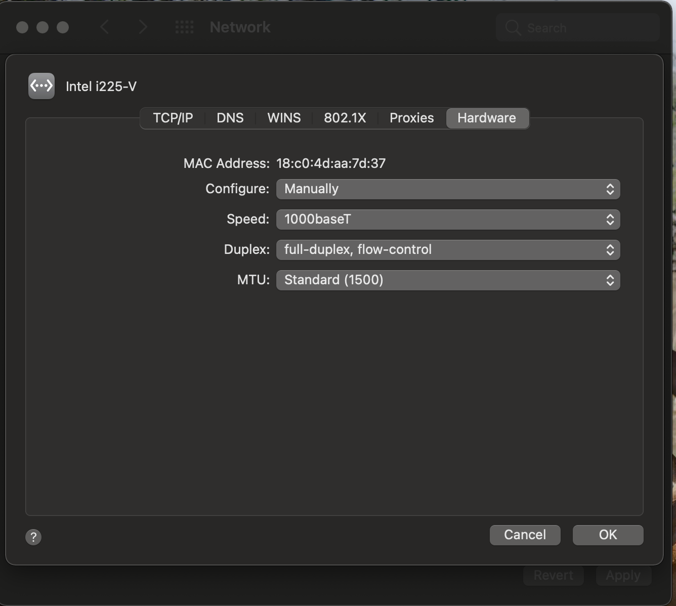

Henties Posted August 7, 2021 Share Posted August 7, 2021 (edited) @bidero @Rocky12 Attached is the output after running nvmupdatew64e.exe -i -l text.txt but not really knowing what to make of the contents of the generated text.txt file. My intel i225-V only works sort of with 100baceTX on Monterey, whereas is works up to 1000baseT under Big Sur. Any suggestions to get it working properly ? Regards Henties nvmupdatew64e.exe -i -l text.txt Inventory [00:010:00:00]: Intel(R) Ethernet Controller (2) I225-V Flash inventory started. Shadow RAM inventory started. Shadow RAM inventory finished. Flash inventory finished. OROM inventory started. OROM inventory finished. [00:010:00:00]: Intel(R) Ethernet Controller (2) I225-V Vendor : 8086 Device : 15F3 Subvendor : 1458 Subdevice : E000 Revision : 2 LAN MAC : 18C04DAA7D37 Alt MAC : 18C04DAA7D37 SAN MAC : 000000000000 ETrackId : 8000014B SerialNumber : 18C04DFFFFAA7D37 NVM Version : 1.69(1.45) PBA : G23456-000 VPD status : Not set VPD size : 0 NVM update : No config file entry checksum : Valid OROM update : No config file entry CIVD : 0.0.0 PXE : 0.4.9, checksum Valid EFI : 0.8.7, checksum None Edited August 7, 2021 by Allan Insert code Link to comment https://www.insanelymac.com/forum/topic/348493-discussion-intel-i225-v-on-macos-monterey/page/2/#findComment-2764401 Share on other sites More sharing options...
bidero Posted August 7, 2021 Share Posted August 7, 2021 @Henties Looks like your I225 has the same NVM firmware version as mine - 1.45. On Big Sur I have no problems at all. Everything is buttery smooth. Using only dk.e1000=0 in boot arguments. I can't manage it to make it work on Monterey with any possible manual settings combination (and/or with DHCP). I'm starting to wonder if one of the kexts used by surenmunoo is doing the job. I'm on Apple Broadcom WiFi/BT module - but I don't really think it's related. Link to comment https://www.insanelymac.com/forum/topic/348493-discussion-intel-i225-v-on-macos-monterey/page/2/#findComment-2764417 Share on other sites More sharing options...

Guest 5T33Z0 Posted August 9, 2021 Share Posted August 9, 2021 (edited) Glad to see this issue has its own thread now, so I can follow it. @Henties I managed to install beta 4 now. I can set-up the Internet connection (100baseTX, full duplex with flow control) and the icon becomes "green" and says I am connected. But I can't get any connection to any server in Safari or Firefox I've tried a manual address with DCHP supoort as well as a completely manual configuration. I am only using the boot-arg: dk.e1000=0, no DeviceProerties or Kernel Patches. Edited August 9, 2021 by 5T33Z0 Link to comment https://www.insanelymac.com/forum/topic/348493-discussion-intel-i225-v-on-macos-monterey/page/2/#findComment-2764465 Share on other sites More sharing options...
Henties Posted August 9, 2021 Share Posted August 9, 2021 @5T33Z0 I also only use dk.e1000=0 as a boot arg and can connect with the i225-V only at the reduced speed of 100baseTX, which is too slow for my everyday connection requirements for which I use an Aquantia PCIe card instead. The i225-V is used to connect to my DANTE audio network which in my setup runs quite well at 100baseTX. Why yours does not even want to connect at 100baseTX is however beyond my understanding, perhaps you are using additional kexts or SSDts which, I don't use and or need, causing your i225-V not to even kick in at 100baseTX ??? I anticipate Apple to seed Monterey beta 5 upgrade soon, hoping that the i225-V will then be fully functional. I don't think there is much we can do while we are dealing with Monterey which is still fairly early in it's beta development cycle, that being the reason why all my machines are still on Big Sur 11.5.1 and I only use Monterey beta in a dual boot configuration for testing and experimental purposes on one of my 2 GA-Z490 Vision G hacks. I am positive that the i225-V will eventually work the way it should under Monterey Greetings Henties Link to comment https://www.insanelymac.com/forum/topic/348493-discussion-intel-i225-v-on-macos-monterey/page/2/#findComment-2764474 Share on other sites More sharing options...
