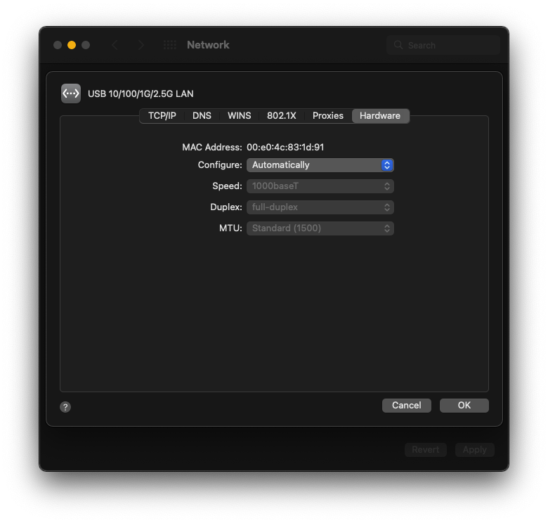

Shaneee Posted November 19, 2021 Share Posted November 19, 2021 I caved a bought a Type-C to 2.5GB adapter. Works a treat without any kexts/modification, https://amzn.to/3cBfm9L 3 1 Link to comment https://www.insanelymac.com/forum/topic/348493-discussion-intel-i225-v-on-macos-monterey/page/10/#findComment-2772186 Share on other sites More sharing options...
xtddd Posted November 20, 2021 Share Posted November 20, 2021 @Shaneee what is the chip mode inside? 1 Link to comment https://www.insanelymac.com/forum/topic/348493-discussion-intel-i225-v-on-macos-monterey/page/10/#findComment-2772197 Share on other sites More sharing options...

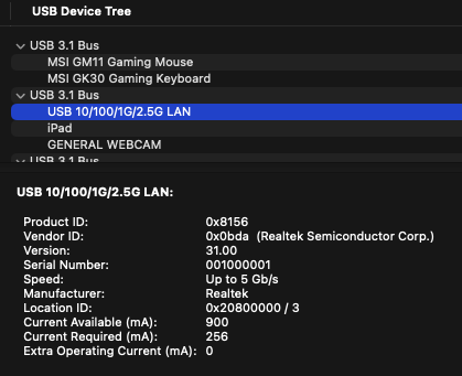

Shaneee Posted November 20, 2021 Share Posted November 20, 2021 8 hours ago, xtddd said: @Shaneee what is the chip mode inside? It's a Realtek chip and from what I can tell it's a RTL8156. USB 10/100/1G/2.5G LAN: Bus: USB Vendor Name: Realtek Product Name: USB 10/100/1G/2.5G LAN Vendor ID: 0x0bda Product ID: 0x8156 USB Link Speed: Up to 5 Gb/s Driver: com.apple.driver.usb.cdc.ncm BSD Device Name: en3 MAC Address: 00:e0:4c:83:1d:91 AVB Support: No Maximum Link Speed: 2.5 Gb/s 1 1 Link to comment https://www.insanelymac.com/forum/topic/348493-discussion-intel-i225-v-on-macos-monterey/page/10/#findComment-2772209 Share on other sites More sharing options...
