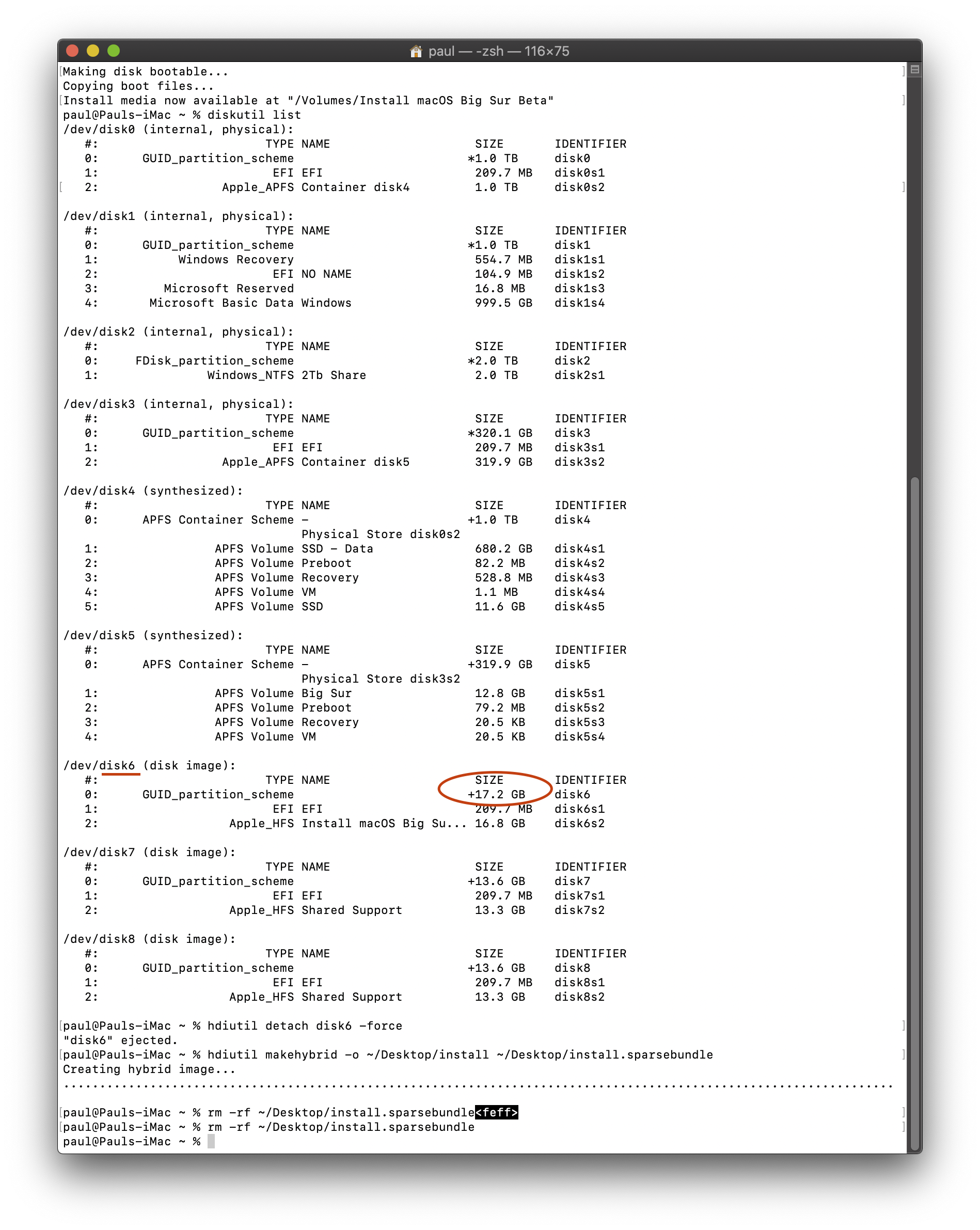

When I tried to install Beta 3 with this technique, I got the following error:
NSDestinationFilePath=/Volumes/Install macOS Big Sur Beta/Install macOS Big Sur Beta.app/Contents/SharedSupport/SharedSupport.dmg, NSFilePath=/Applications/Install macOS Big Sur Beta.app/Contents/SharedSupport/SharedSupport.dmg, NSUnderlyingError=0x7fadaa59e4c0 {Error Domain=NSPOSIXErrorDomain Code=34 "Result too large"}}The copy of the installer app failed.
Anybody experience the same?
Hi friend yes in the first command which reads
hdiutil create -size 12G -fs hfs+ -volname install -type SPARSEBUNDLE ~/Desktop/install
12gb is not enough, for beta 3 so I used 16gb instead. Works!
hdiutil create -size 16G -fs hfs+ -volname install -type SPARSEBUNDLE ~/Desktop/install
Notice the difference. It's 16gb instead of 12gb.
Also in the clean up commands where he says do this:
hdiutil detach `diskutil list |grep 'Install macOS Beta' |awk '{print $8}'` -force
I rather use command "diskutil list" to list all your disks. The one which is 12gb/16gb is the one you should detach. For me it was disk6 as you can tell here. (see attached screenshot)
hdiutil detach disk6 -force
I'm sure you notices your installer is probably called "Install Big Sur Beta" or something. I also use drag n drop to simplyfy matters. You can reveal the "createinstallmedia" file in finder and drag it into Terminal to avoid typing this whole command. Maybe you knew that.
Good luck.

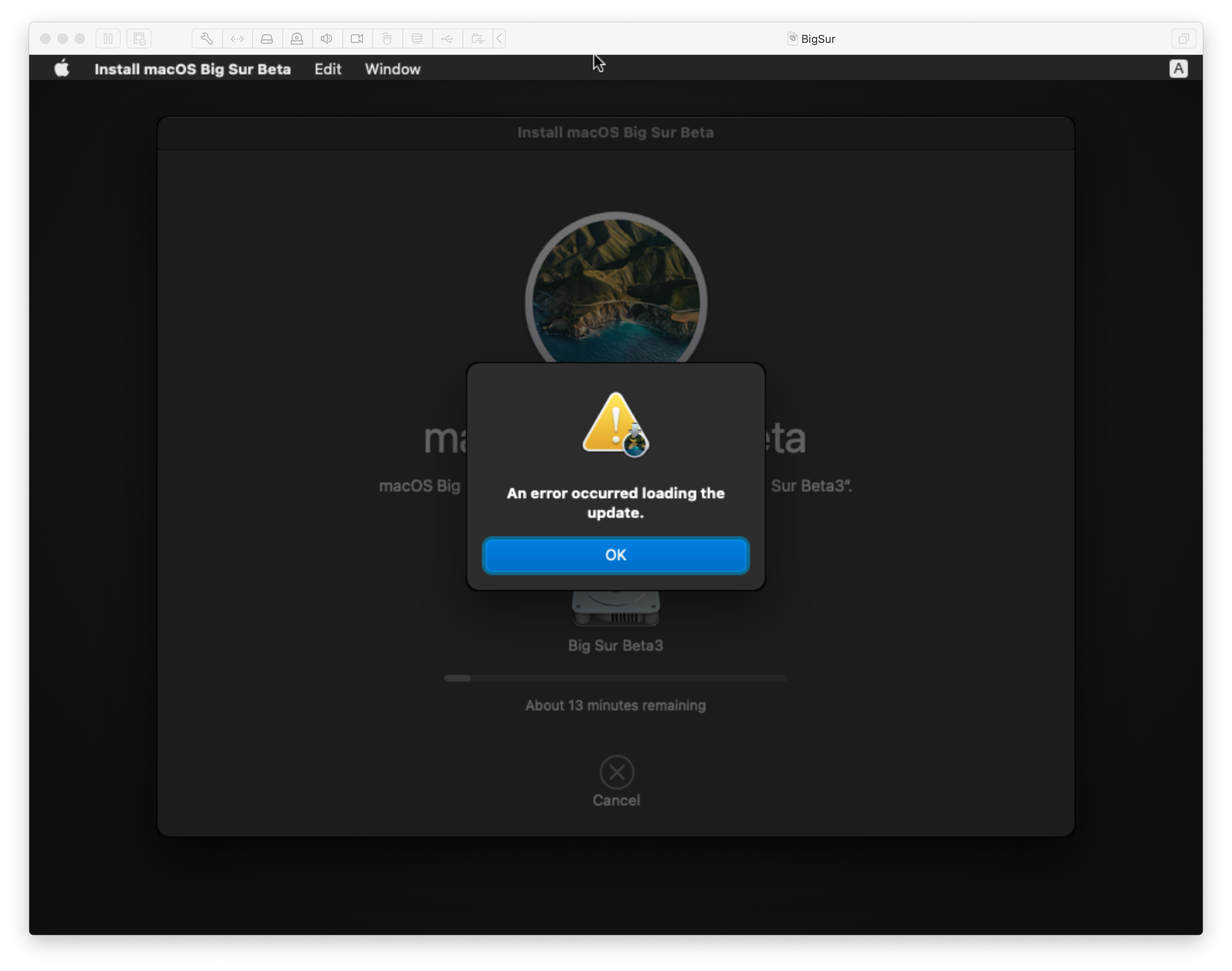

I am following your guide to install Big Sur Beta 3 but I am stuck with this error (see attached image), I had success with Beta 1 & 2 with your method and with Beta 2 also managed to create a bootable USB installer.
282016197_ScreenShot2020-07-25at7_52_03AM.thumb.png.de5496e2b38c4ad444e33db4e7ff7462.png
I have been struggling with Beta 3.
Creating USB installer is fine, but I get stuck with the ASmedia failed to reset error prompt on boot, same as @meaganmargaret. But on one of my USB ports after a NVRAM reset it progresses fine all the way to the installer.
I end up with the same error above during installation even using the USB installer.
I have tried downloading the Beta3 using the gibMacOS script at least 3 times now, assuming the previous copies could have been corrupt.
But no luck so far.
Any clue what this error might be caused by?

Ok. This was looking like a great guide until I got to
I had to change 'Install macOS Beta' to 'Intsall macOS Big Sur' as installing the latest release but I get the following error message.
chris@chriss-Mac-Pro ~ % hdiutil detach `diskutil list |grep 'Install macOS Big Sur' |awk '{print $8}'` -force
hdiutil: detach failed - No such file or directory.
Also had to change the size of SPARSEBUNDLE from 12G to 15G as getting error ' not enough memory'. Im assuming the beta had less memory requirements.
I have followed the guide to the 'T' only changing 'Beta' for 'Big Sur'. See below
hdiutil create -size 15G -fs hfs+ -volname install -type SPARSEBUNDLE ~/Desktop/install
hdiutil attach ~/Desktop/install.sparsebundle
sudo /Applications/Install\ macOS\ Big\ Sur.app/Contents/Resources/createinstallmedia --volume /Volumes/install --nointeraction
hdiutil makehybrid -o ~/Desktop/install ~/Desktop/install.sparsebundle
rm -rf ~/Desktop/install.sparsebundle.
Any assistance would be gratefully received. Thanks

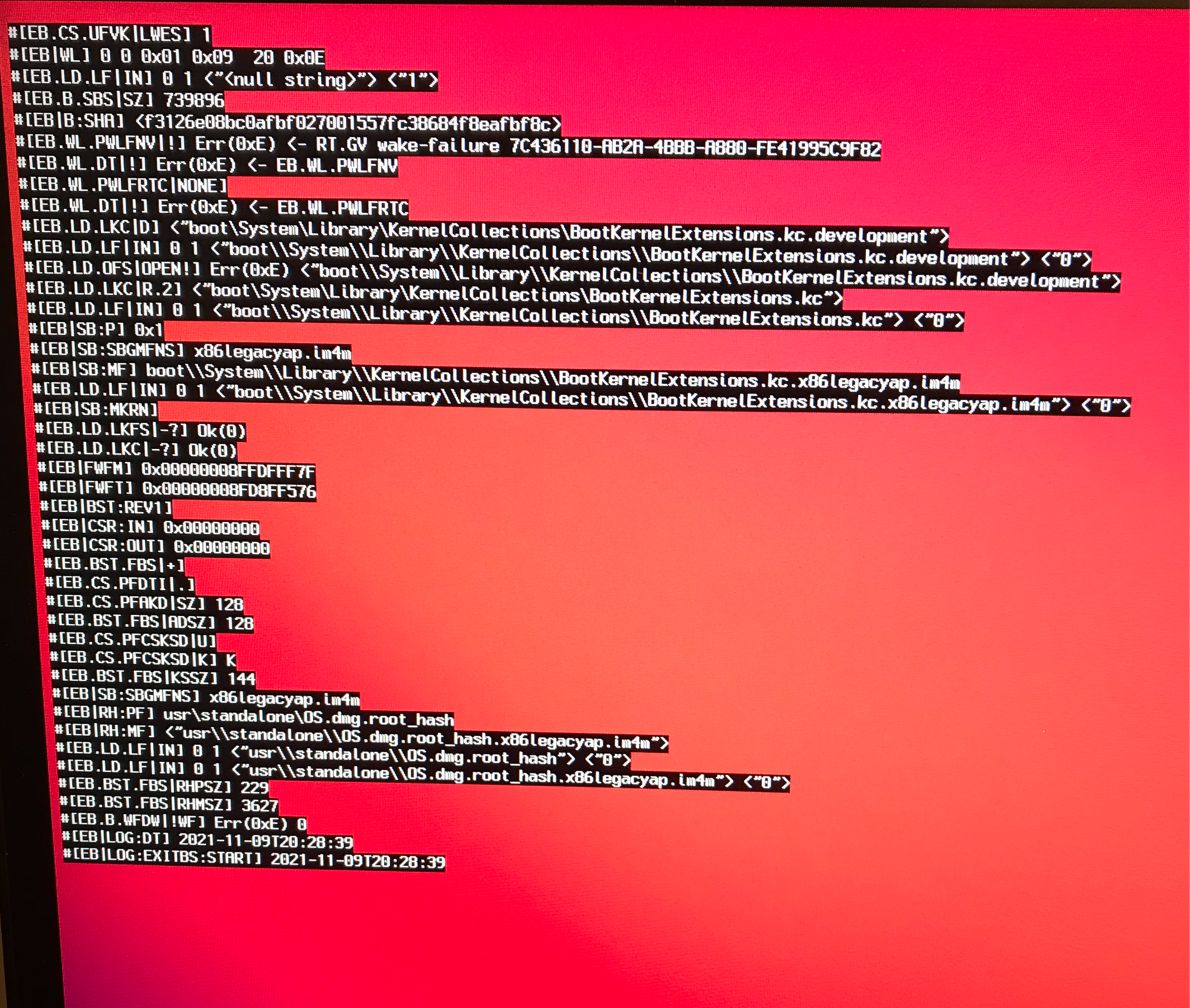

18 hours ago, tonyx86 said:
@gizlin Did you start experiencing your kernel panics after installing a new NVMe SSD?  If so, what NVMe SSD are you using?  Read this.
I have been using Samsung EVO 970 since forever. Never had any issues with it until recently.
I guess there is a problem with the SSD?
19 hours ago, Allan said:
Hello @gizlin. Your hardware is the same as this topic? Give us more information.
Do this please:
My specs are:
MOBO: z370n
CPU: i7 9700K
Power: Enermax 650W
RAM: Ballistix 32GB
SSD 1: EVO970 512Gb (macOS)
SSD 2: WD Blue 2Tb (data only)
GPU: RX 580
I have disabled TRIM. So far it seems to be fine.
