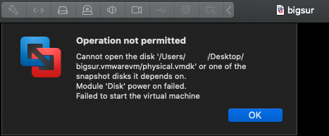

I get the following error when starting up the iso.
"Operation not permitted
Cannot open the disk '/...bigsur.vmwarevm/physical.vmdk' or one of the snapshot disks it depends on.
Module 'Disk' power on failed.
Failed to start the virtual machine."
Can anyone help me?
Can anyone help me?
Make sure the Physical disk is unmounted. Then start the installation.

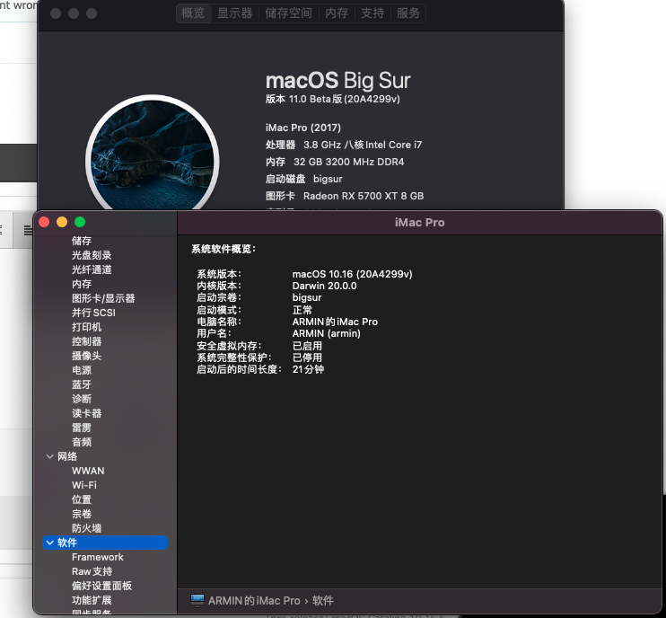

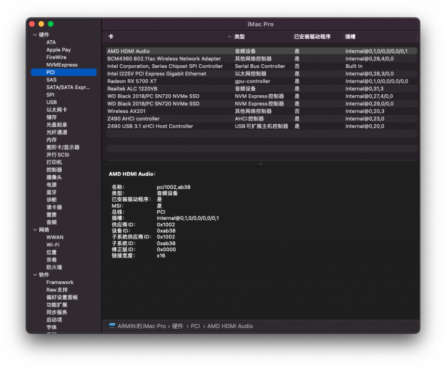

I used your installation tutorial and now I'm using 11.16 bigsur
Motherboard: Gigabyte z490 aorus ultra motherboard supports CPU 10900k / 10700k (Intel z490 / LGA 1200)
CPU:I7 10700K
Graphics card: public version of AMD radon RX 5700 XT  8g gddr6 game graphics card
Memory: g.skill 16gbx2 DDR4 3200 frequency desktop memory module sniper x (camouflage black)
Hard disk: m.2 x2 250gwd_ Black sn750, western data 1TB SSD m.2 interface (nvme protocol) WD_ BLACK SN750
Network card: bcm4360cs two antenna version, Intel i225v 2.5gbe perfect, Intel ax201 has no driver at present
Sound card: alc1220-vb
Thank you very much!

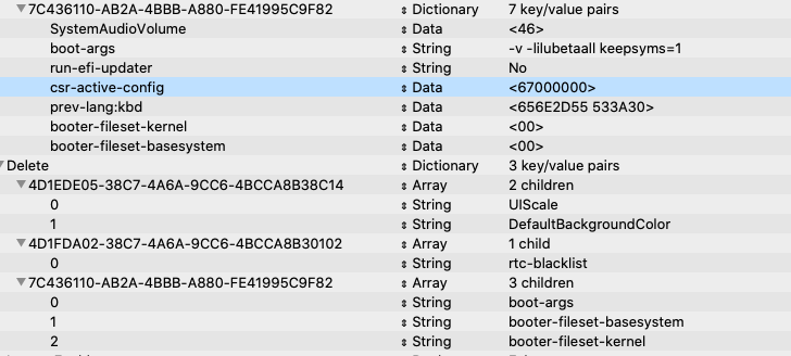

On 6/26/2020 at 5:10 PM, ludufre said:
NVRAM -> Delete -> 7C436110-AB2A-4BBB-A880-FE41995C9F82 -> booter-fileset-basesystem
NVRAM -> Delete -> 7C436110-AB2A-4BBB-A880-FE41995C9F82 -> booter-fileset-kernel
@SavageAUS You forgot this. I believe that's the problem.
Just now, SavageAUS said:
Ok I’ll give that a try and post back.
Sent from my iPhone using Tapatalk
I just saw that your boot-args is empty. Forgot to put -lilubetaall. And it would be interesting to add keepsyms=1 too (to show more details of the KP)
