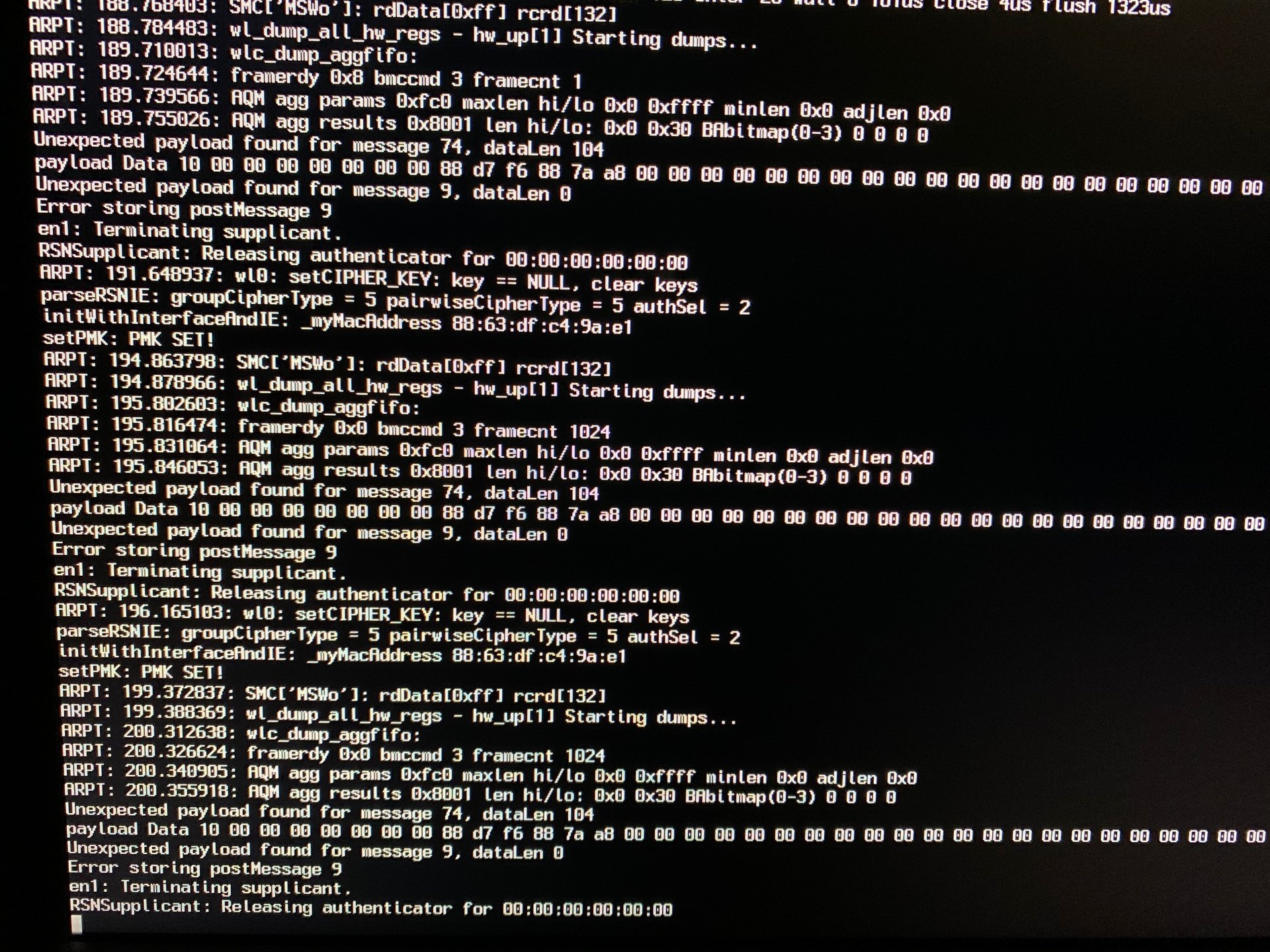

fastfwd Posted June 29, 2020 Share Posted June 29, 2020 Hi there, I was hoping one of the experts here could kindly help me with my OC efi. I installed Big Sur with a real Mac and then Quit at the initial setup and installed it in my Hack. My Catalina OC efi works great but intantly fails with Big Sur. I tried the efi provided in the first post and it boots about 3/4 of the way and then an error keeps looping. I wonder if my efi can be corrected. Thanks EFI.zip Link to comment https://www.insanelymac.com/forum/topic/344299-guide-gigabyte-ga-z370n-wifi-i7-8700k-uhd-630-big-sur-110-dp1/page/3/#findComment-2727742 Share on other sites More sharing options...
ludufre Posted June 29, 2020 Author Share Posted June 29, 2020 1 minute ago, fastfwd said: Hi there, I was hoping one of the experts here could kindly help me with my OC efi. I installed Big Sur with a real Mac and then Quit at the initial setup and installed it in my Hack. My Catalina OC efi works great but intantly fails with Big Sur. I tried the efi provided in the first post and it boots about 3/4 of the way and then an error keeps looping. I wonder if my efi can be corrected. Thanks EFI.zip Hi. You need provide more information. What's the happening? What's error? Link to comment https://www.insanelymac.com/forum/topic/344299-guide-gigabyte-ga-z370n-wifi-i7-8700k-uhd-630-big-sur-110-dp1/page/3/#findComment-2727743 Share on other sites More sharing options...

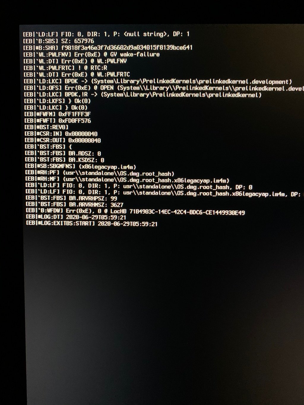

fastfwd Posted June 29, 2020 Share Posted June 29, 2020 The posted efi in this thread gets stuck with the error posted below. Link to comment https://www.insanelymac.com/forum/topic/344299-guide-gigabyte-ga-z370n-wifi-i7-8700k-uhd-630-big-sur-110-dp1/page/3/#findComment-2727744 Share on other sites More sharing options...

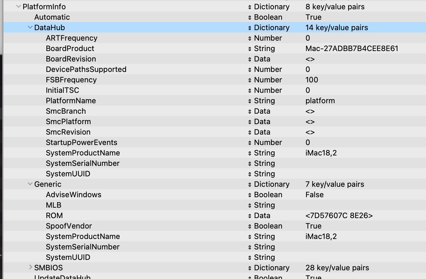

ludufre Posted June 29, 2020 Author Share Posted June 29, 2020 @fastfwd Your PlatformInfo is very wrong! Did you pasted from Clover config.plist? - DataHub and SMBIOS don't have to be here. - Generic -> MLB, SystemSerialNumber and SystemUUID are empty. I assumed that your platform is iMac18,2 (alright?). I generated SMBIOS with GenSMBIOS and fixed your config.plist EFI_fastfwd.zip Link to comment https://www.insanelymac.com/forum/topic/344299-guide-gigabyte-ga-z370n-wifi-i7-8700k-uhd-630-big-sur-110-dp1/page/3/#findComment-2727746 Share on other sites More sharing options...
