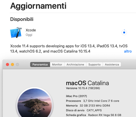

iCanaro Posted March 24, 2020 Share Posted March 24, 2020 My Ryzentosh OC 056 1 Link to comment Share on other sites More sharing options...

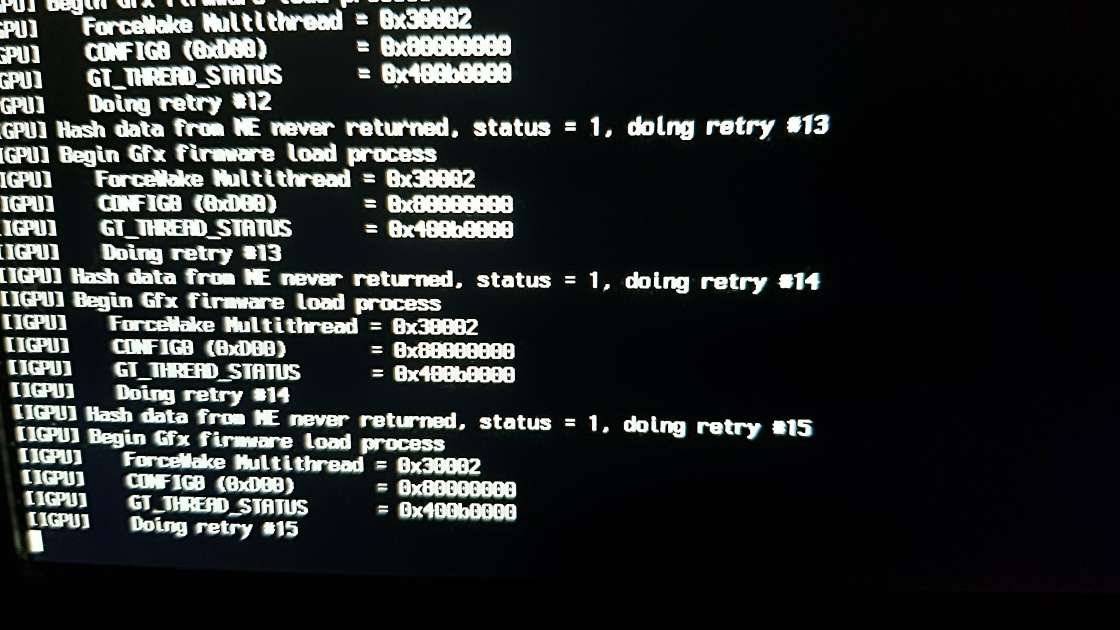

DoZe Posted March 24, 2020 Share Posted March 24, 2020 (edited) Argggghhh…... Clover 5107, whatevergreen v1.3.7 Works perfectly fine before. -disablegfxfirmware of waiting for a new whatevergreen release ? Edited March 24, 2020 by DoZe Link to comment Share on other sites More sharing options...

DoZe Posted March 25, 2020 Share Posted March 25, 2020 1 hour ago, DoZe said: Argggghhh…... Clover 5107, whatevergreen v1.3.7 Works perfectly fine before. -disablegfxfirmware of waiting for a new whatevergreen release ? -disablegfxfirmware in boot argument: WORKS But I suppose a new version of Whatevergreen kext will be released to solve this. Link to comment Share on other sites More sharing options...
