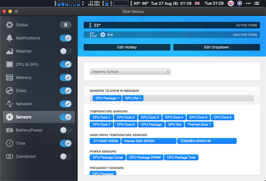

I kind of like iStat Menus because it combines many things and it is very detailed about each aspect you monitor; thus I'm gonna stick with what I have for now and try to fix the DSDT to be able to see fans as well
I’d like too but can’t make it work for gpu die

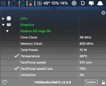

@gino8080 I did made GPU Die work as you can see in the following screenshot:
but I do not have fan indicators, so I'm unable to see CPU Fan RPM's, and it is kind of important for me for my reasons.
I did that by replacing VirtualSMC with FakeSMC, BUT I do not suggest it to anyone, and I quote @AudioGod:

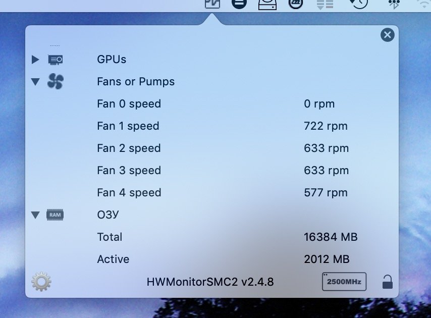

No idea why Hwmonitor is able to show us all 5 possible fans and btw: there are forks for FSMC and some development still exist.

With VirtualSMC I'm also able to see Fan1 and Fan2, and I also assume they correspond to my water colling fans. They run at ~950rpm, of course with VirtualSMC I'm not getting GPU temp in iStat, I'm able to see GPU temp with HWMonistor SMC2.
Also in HWMonitor SMC2 fan indicators, Fan0 and Fan4 indicate my CPU fans, and Fan1 indicate a fan I have on the backside of the tower.
@texem thanks a lot for the info! I was digging in GitHub yesterday, indeed there are many FakeSMC forks out there, I think I'm gonna stick with the flow, VirtualSMC is young in comparison to FakeSMC, but is it's successor so I believe further development will be done and maybe a 3rd party plugin will allow to have GPU stats as well, nothing to rush about I think.
I removed the GPU Die from iStat Menus and placed HWMonitor SMC2 next to it to show my GPU temp:
The only thing that I would love to have in HWMonistor SMC2 is to not dim the menu bar when you are not in Finder. For instance when I switch from Finder to any other app, the menubar dim:
I know that this is the native macOS behaviour, but I would like to have an option to not dim :)

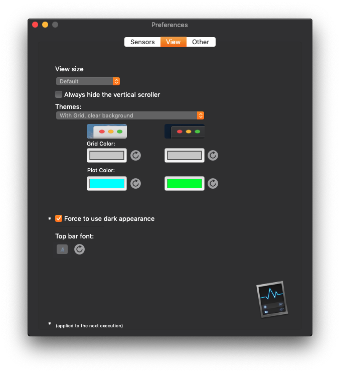

Try changing View Preferences theme
This is mine, and that it do NOT dim when I change app, only when I change focus monitor, the secondary is dimmed
@gino8080 Goos morning! Ah I see, the same behaviour from my side too, when I switch monitors then it dimms. Well would be cool if it didn't but what the heck :D
Cheers!

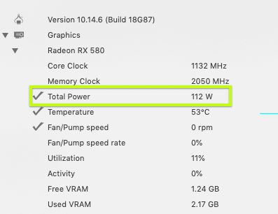

HWMonitorSMC2 is showing the RX580 as using over 100W power at idle... !!
How realistic is this? Or is the sensor unreliable? This card is supposed to idle around 16W - 30W.
Actually... the GPU core clock and memory clock are also maxed out... constantly. Am I possibly missing some kext to control the GPU's power?
Would you please run the following script in terminal and post your result back here:
while sleep 1; do clear;ioreg -l |grep \"PerformanceStatistics\" | cut -d '{' -f 2 | tr '|' ',' | tr -d '}' | tr ',' '\n'|grep 'Temp\|Fan\|Clock'; done

The results are the same as hardware monitor SMC, so the software is reporting the right numbers. Looks like your card got stuck at max speed all the time... and the Wattage draw is typical for RX580.
Do you run any kind of software in the background? I recommend you remove all monitoring software / Kext then run the script again. My vega 56/64, RX570 , and radeon VII are working perfectly fine with the same monitor setup and yours.
Also, when look at your VRAM usage, it's almost 2/3 full. That must be something that's been using your card....

You're right, it was just "stuck". I ran the OpenCL Geekbench test, then opened up the HWMonitorSMC2 pane to see if the frequencies would change - and the machine did the white screen freeze lockup. After power cycling the hack, the GPU core now fluctuates between 460-1000MHz. GPU Memory is locked at 2050MHz. I may have a faulty card - got it really cheap. I suspect maybe it was used for crypto mining.
Do your cards report the correct amount of total VRAM in HWMonitorSMC2? Mine adds up to around 3.25GB even though it's reported as a 4GB card in MacOS.

My Radeon VII memory clock is also stuck at max in both the hack and windows (a known issue with the VII). But my RX570 / Vega never has this before. I highly recommend that you remove all monitoring kext / software then do a cold reboot and run the script to check mem clock again.
with 4GB of VRAM, you will always get around 3.25 GB usable, that's normal.

Uninstalled iStat and HWMonitor. I never added any monitoring Kexts. Cold reboot. Found out that the Nitro+ series of video cards have 2 BIOS's which are selected using a dip switch on the card. Switched it over to the "quiet" BIOS position. Here's the results:
"Fan Speed(%)"=0
"Core Clock(MHz)"=337
"Memory Clock(MHz)"=1750
"Fan Speed(RPM)"=0
"Temperature(C)"=48
The memory clock is always 1750. I'll install Win10 on the hack this weekend to see if this is a software or hardware issue.
