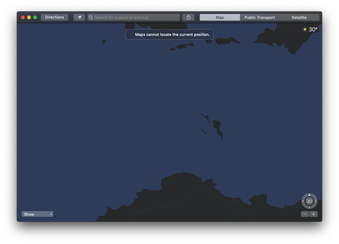

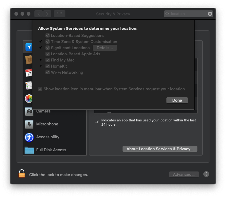

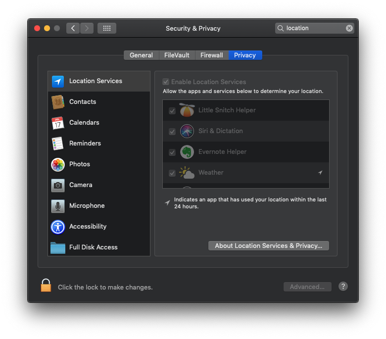

panosru Posted August 31, 2019 Share Posted August 31, 2019 Hello to everybody! I came to post about an issue I have with location services, it seems they are not working :/ My WiFi is enabled though, but reading the thread I noticed that I'm also experiencing the same "issue?" with my RX580, I'm not really sure if it is an issue though: My setup has 3 monitors, two of them are 2560x1080 and the other is 1080p (1920x1080), is that normal? Thanks! Link to comment https://www.insanelymac.com/forum/topic/339980-audiogods-aorus-z390-pro-patched-dsdt-mini-guide-and-discussion/page/4/#findComment-2688031 Share on other sites More sharing options...
AudioGod Posted August 31, 2019 Author Share Posted August 31, 2019 33 minutes ago, panosru said: Hello to everybody! I came to post about an issue I have with location services, it seems they are not working :/ My WiFi is enabled though, but reading the thread I noticed that I'm also experiencing the same "issue?" with my RX580, I'm not really sure if it is an issue though: My setup has 3 monitors, two of them are 2560x1080 and the other is 1080p (1920x1080), is that normal? Thanks! Bro if you have windows installed then check to see if it's happening on that side too. Link to comment https://www.insanelymac.com/forum/topic/339980-audiogods-aorus-z390-pro-patched-dsdt-mini-guide-and-discussion/page/4/#findComment-2688040 Share on other sites More sharing options...
panosru Posted August 31, 2019 Share Posted August 31, 2019 @AudioGod I do not have Windows installed :/ is there any other option? Also, I guess you are referring to the graphics card issue, about the location services, do they work for you? Link to comment https://www.insanelymac.com/forum/topic/339980-audiogods-aorus-z390-pro-patched-dsdt-mini-guide-and-discussion/page/4/#findComment-2688041 Share on other sites More sharing options...
AudioGod Posted August 31, 2019 Author Share Posted August 31, 2019 (edited) 8 minutes ago, panosru said: @AudioGod I do not have Windows installed :/ is there any other option? Also, I guess you are referring to the graphics card issue, about the location services, do they work for you? Yes i was talking about the gpu. It seems to be a common hardware problem for a lot of people on macos and windows too. Il double check my location services when I finish working later for you but last time I checked it was working fine. Update - I just checked my ipad and its seeing my hack at my house and showing the location so it must be working fine otherwise it wouldnt know where the hack was on my ipad Edited August 31, 2019 by AudioGod Link to comment https://www.insanelymac.com/forum/topic/339980-audiogods-aorus-z390-pro-patched-dsdt-mini-guide-and-discussion/page/4/#findComment-2688043 Share on other sites More sharing options...

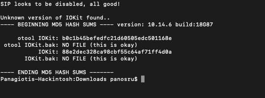

panosru Posted August 31, 2019 Share Posted August 31, 2019 (edited) @AudioGod I indeed had many instances in my iCloud account, I removed all the unnecessary devices and I left my Hackintosh and my MacBook. I then rebooted just in case, but it did not solve the problem. I then followed again glasgood's imessage fix, reboot -> nothing... I enabled wake on LAN, booted in the system, and still location services are dead UPDATE: For my GPU: Display 1: Display 1 + 2 (exactly the same displays): Display 1 + 3 (different displays): UPDATE2: I just realised also that my WiFi is only able to connect to 5GHz WiFi signals, any 2.4GHz signal, although it is detected, it cannot connect to it, I'm entering the correct password and it still does not accept it. I tried with my phone's hotspot as well. That may be the source of the problem for the Location Services too, I guess that has something to do with the AirportBrcmFixup kext (I'm using v2.0.3) UPDATE3: I removed TP-Link Archer 26E and installed a spare card I have. I am able to connect to 2.4GHz WiFi network now, but Location Services are still dead. I also checked with previous EFI's surprisingly enough it didn't work with them either, I can swear that it used to work though... I don't think that BIOS has something to do with it, I upgraded to F10 but I guess this shouldn't be an issue. Edited August 31, 2019 by panosru Link to comment https://www.insanelymac.com/forum/topic/339980-audiogods-aorus-z390-pro-patched-dsdt-mini-guide-and-discussion/page/4/#findComment-2688064 Share on other sites More sharing options...

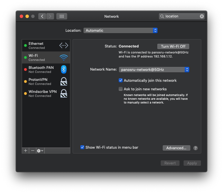

panosru Posted August 31, 2019 Share Posted August 31, 2019 (edited) So after some more digging, I switched back to TP-Link Archer T6E, the BCM943602CS didn't work so well for me. I figured that when I'm connected to a WiFi network Location services are not working, I deleted all known networks from my WiFi interface and Location Services work again. The same thing happened with BCM943602CS, but after a few reboots while I was testing my Archer T6E and BCM943602CS, location services stopped work at all with BCM943602CS, also bluetooth module on BCM943602CS didn't work for me. Now I have my T6E on without connecting to any network and location services are working fine. It doesn't bother me since I'm using Ethernet either way. Regarding GPU, two of my monitors are 60Hz and one is 75Hz, I'm unable to change the refresh rate in the settings for the two of my monitors 2 monitors: https://www.cnet.com/products/lg-25um58-p-led-monitor-25-25um58pus/ 1 monitor: https://www.cnet.com/products/lg-e2251t-bn-led-monitor-full-hd-1080p-21-5/ Both 25UM58-P have a resolution of 2560 x 1080 at 75Hz but for some reason, macOS set them to 60Hz: I selected scaled just so you can see the resolution set. It only allows me to change refresh rate between 50Hz and 60Hz when I set the resolution to 1080p/i Edited August 31, 2019 by panosru Link to comment https://www.insanelymac.com/forum/topic/339980-audiogods-aorus-z390-pro-patched-dsdt-mini-guide-and-discussion/page/4/#findComment-2688098 Share on other sites More sharing options...

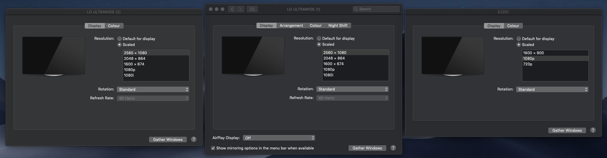

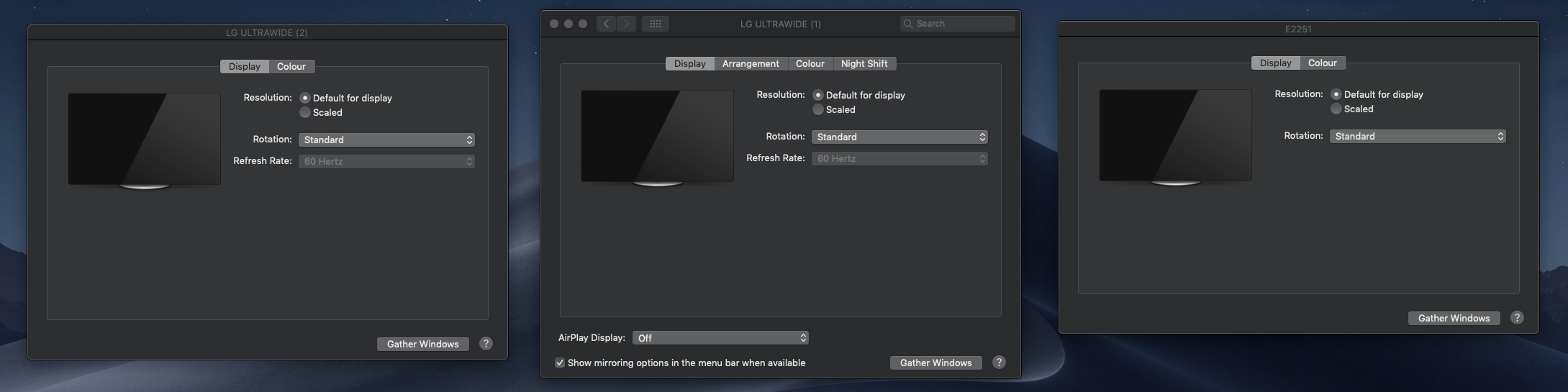

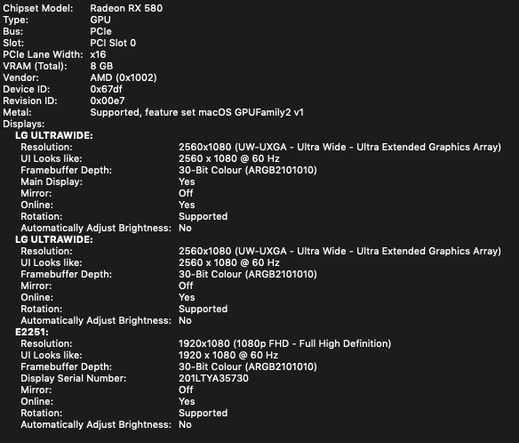

panosru Posted August 31, 2019 Share Posted August 31, 2019 (edited) @larabee Monitor 1 Display Port -> HDMI Adapter Monitor 2 HDMI Monitor 3 HDMI -> VGA Adapter I have bought an SSD from day 1 for windows, but I never used it and I kept it empty, I might install windows someday, but I highly doubt it. I'm ok with 60Hz, I will try to find a way to overclock the monitor somehow, there is a patch here, I tried it in my hack but it does not work, it works on real macs only I guess btw, location services stopped working again go figure... nvm I won't spend any more time on that. Edited August 31, 2019 by panosru Link to comment https://www.insanelymac.com/forum/topic/339980-audiogods-aorus-z390-pro-patched-dsdt-mini-guide-and-discussion/page/4/#findComment-2688105 Share on other sites More sharing options...
larabee Posted August 31, 2019 Share Posted August 31, 2019 3 minutes ago, panosru said: @larabee Monitor 1 Display Port -> HDMI Adapter Monitor 2 HDMI Monitor 3 HDMI -> VGA Adapter I have bought an SSD from day 1 for windows, but I never used it and I kept it empty, I might install windows someday, but I highly doubt it. I'm ok with 60Hz, I will try to find a way to overclock the monitor somehow, there is a patch here, I tried it in my hack but it does not work, it works on real macs only I guess btw, location services stopped working again go figure... nvm I won't spend any more time on that. With adapters, sometimes you won't get the full options. That's the problem here. About the location services, yeah , I will try to find more answers with that. Do you know what chipset your wifi card is using? Link to comment https://www.insanelymac.com/forum/topic/339980-audiogods-aorus-z390-pro-patched-dsdt-mini-guide-and-discussion/page/4/#findComment-2688106 Share on other sites More sharing options...
panosru Posted August 31, 2019 Share Posted August 31, 2019 (edited) @larabee seems like Broadcom For the adapters, I understand that, but one of the displays (monitor 2) does not use any adapter. I just tried to remove both the monitors that use adapters and leave only monitor 2 with HDMI connection, still, the refresh rate select menu was greyed out and locked on 60Hz. I will try now the SwitchResX app UPDATE: SwitchResX didn't do the trick, so... never mind... Edited August 31, 2019 by panosru Link to comment https://www.insanelymac.com/forum/topic/339980-audiogods-aorus-z390-pro-patched-dsdt-mini-guide-and-discussion/page/4/#findComment-2688108 Share on other sites More sharing options...
