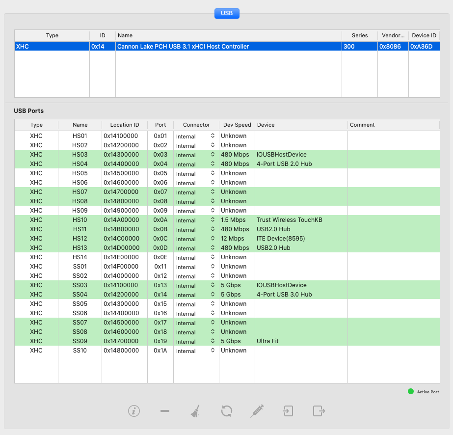

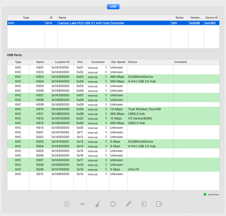

Alex1982 Posted February 6, 2021 Share Posted February 6, 2021 13 hours ago, rob1980 said: Could somebody tell me if USB C functions as a power device only or for data transfer too? I ask as my new iPhone has a USB C cord now as is not detected. Thanks The same issue, only charging on USB C and no data transfer on macOS. On Windows data transfer works. Link to comment Share on other sites More sharing options...
AudioGod Posted February 6, 2021 Author Share Posted February 6, 2021 15 minutes ago, Alex1982 said: The same issue, only charging on USB C and no data transfer on macOS. On Windows data transfer works. @rob1980 @Alex1982 I might no why actually. Is one of you available to do a test in around 45 mins from now? 1 Link to comment Share on other sites More sharing options...
jimborae Posted February 6, 2021 Share Posted February 6, 2021 (edited) 32 minutes ago, AudioGod said: @rob1980 @Alex1982 I might no why actually. Is one of you available to do a test in around 45 mins from now? Yo AG. if they aren't, I am, & I think I've witnessed this behavior also, although it didn't register with me at the time. *Edit* Yep confirmed, none of the USB Type C ports do anything but. but charge. I have 2 USB Type C ports on my hack, one is the onboard port on the back and I also have another via a front panel add on that connects to the motherboard connector. Edited February 6, 2021 by jimborae Link to comment Share on other sites More sharing options...
Alex1982 Posted February 6, 2021 Share Posted February 6, 2021 @AudioGod, sure, I can. Which test you are meaning? I already do some testing before by disabling 15 USB port limit in OC(as suggested earlier in this thread), so all HS and SS ports be available. When I disable 15 USB port limit I see that macOS started detecting my USB C devices but all of them always connected to HS(not SS) port(I check it via Hackintool). From above observation I concluded that when 15 USB port limit enabled(I use your USBMap.kext as is without any modifications) HS ports are disabled for USB C that's why devices is not detected. The question here why USB C devices connecting only as HS but not SS. Probably the cause of @rob1980 issue is the same with mine. 1 Link to comment Share on other sites More sharing options...
AudioGod Posted February 6, 2021 Author Share Posted February 6, 2021 (edited) Do u think it’s possible that it’s looking for usb2 over usb c? I used to use a usb c hub on my old Intel hack and all my devices worked but they were all true usb 3 not 2.0 using a type c connection. @Alex1982 going by what you just said that does seem to be the case. you have two options in that case, go past the 15port limit or change the USBMap and give usb2 as well as 3.0 to type-c. I can Bosch up a new kext in a few mins to try if you want to do the later? p.s and before you say the iPhone uses a type c usb 3.0 cable well I don’t think that’s ever been the case. It’s always been usb2.0 as far as I’m concerned. I even just checked just this second on my iPhone via windows and it’s showing usb2.0 speeds. Edited February 6, 2021 by AudioGod 1 Link to comment Share on other sites More sharing options...
