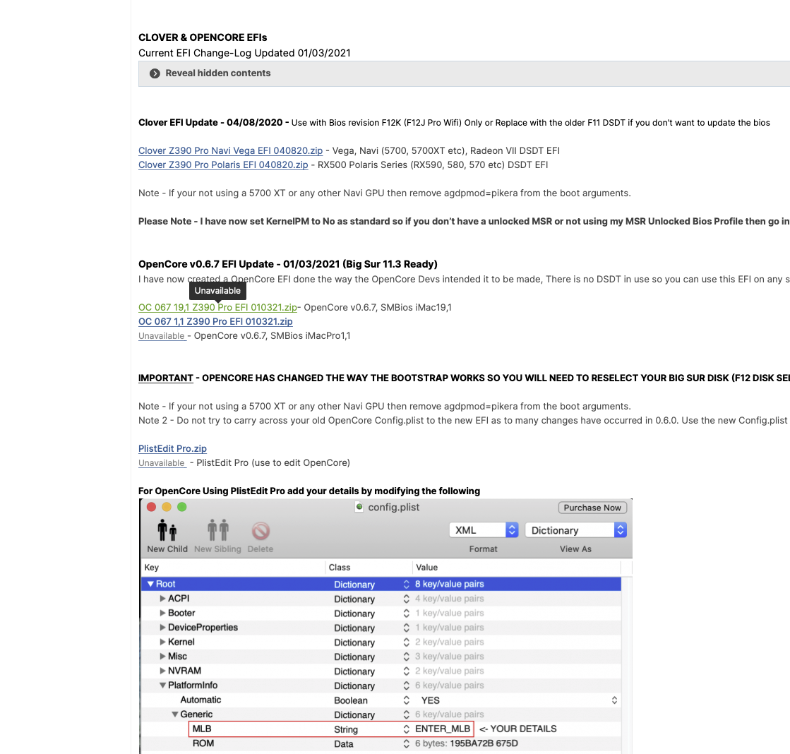

rob1980 Posted March 6, 2021 Share Posted March 6, 2021 14 minutes ago, AudioGod said: @rob1980 The links for the EFIs are working fine. Try again! Thanks, said unavailable below them earlier in grey text and link led to a blank page.. wasn’t sure if they’d been taken down by yourself for some reason. 1 hour ago, eSaF said: Hi - Same board, same cpu, same amount of memory, maybe try my EFI Folder on a test USB Drive to see if the glitch is removed. I use iMacPro1,1 (2017) to enable DRM for Apple TV+ and Netflix. I have removed my personal data from the config.plist if it works out for you, you'll have to furnish with your own. Good luck. Hide contents EFI.zip 7.86 MB · 0 downloads I’ll give that a go tomorrow, thank you!! Link to comment https://www.insanelymac.com/forum/topic/339980-audiogods-aorus-z390-pro-patched-dsdt-mini-guide-and-discussion/page/170/#findComment-2752568 Share on other sites More sharing options...
jimborae Posted March 6, 2021 Share Posted March 6, 2021 1 hour ago, eSaF said: @rob1980 I would advise you to try AG's posted EFI first Whether the Pro 1.1 or the 19.1 for your rig and carefully follow instructions, my EFI Folder is basically based on his iMac 1.1 Pro folder from day one and never had any problems. Both his published EFI Folders are tried and tested by many that follow his Thread without any major problems. Like I said the iMac Pro1.1 is more suited for me to enable AppleTV+ and Netflix as the iMac 19.1 proved very difficult to enable those two services with the latter SmBIOS Mac Model. Good luck. Personally before starting from a clean EFI I'd reset the bios first then apply the correct bios settings then start doing the hackintosh magic. Gigabyte boards are not exactly known for their stable bioses and the fact that the Aorus splash screen is being displayed incorrectly makes me think something hanky is going on in the bios. Therefore I'd try & start with a totally clean slate on the latest bios. 2 Link to comment https://www.insanelymac.com/forum/topic/339980-audiogods-aorus-z390-pro-patched-dsdt-mini-guide-and-discussion/page/170/#findComment-2752578 Share on other sites More sharing options...
rob1980 Posted March 6, 2021 Share Posted March 6, 2021 (edited) Just to be clear guys (as I probably wasn't before) Im using AG's EFI (always have) im on the latest BIOS with everything exactly as it should be, this is a new issue that has occurred without any bios changes. having said that, jamboree comment about the splash screen could be onto something, so I'll try resetting the bios first and go from there. @AudioGod link on page 1 is still not working for me for some reason.(fixed see edit) Edit* Im on Bios F12J, going to update to K before proceeding. Another edit* Link is no longer saying unavailable and is working again...404 error gone so all good there. Thanks guys!! Edited March 6, 2021 by rob1980 Link to comment https://www.insanelymac.com/forum/topic/339980-audiogods-aorus-z390-pro-patched-dsdt-mini-guide-and-discussion/page/170/#findComment-2752618 Share on other sites More sharing options...
rob1980 Posted March 7, 2021 Share Posted March 7, 2021 Well, in the end I formatted.. only because I have cloud backups of important docs and my build was restored from two previous builds and there was lots of unneeded garbage. I updated the bios to the latest revision which is now 12K for the wifi model, reset all settings then manually setup bios again. Created a new USB installer with the latest Big Sur and OC 0.67, installed and setup our account, restored docs and installed only needed apps. So far restarting has been problem free. The issue with the oversized splash screen and icons on boot picker plus apple loading screen remains (is normal size when booting from USB / Recovery) so Im lost on that one, its an ultra wide monitor but I recall it being ok before an update at some point, I think to Big Sur.. I'm sure there are others with wide monitors who do not have that issue, its only looks and doesn't affect performance but still Fugly lol. I also realized the download links kept going as this website would not save my login each Time I left/closed my browser (safari) I've not checked again since the new install however. Thanks for the help and suggestions guys, I'll do some more reading up on the resolution issue, I'd tried setting custom sizes in config before without success, its still set to Max right now. Link to comment https://www.insanelymac.com/forum/topic/339980-audiogods-aorus-z390-pro-patched-dsdt-mini-guide-and-discussion/page/170/#findComment-2752631 Share on other sites More sharing options...

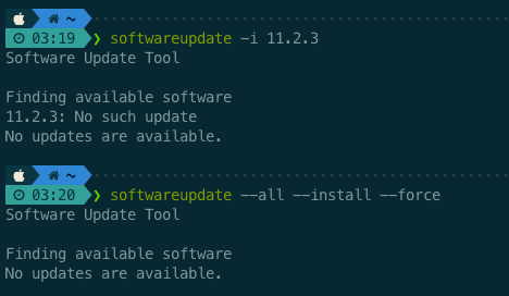

panosru Posted March 10, 2021 Share Posted March 10, 2021 (edited) has anyone updated to v11.2.3? For me it doesn't even showed in Software Update yet :/ UPDATE: It seems that the issue was because I had SIP disabled, although I had SIP disabled for a long time now and I didn't had any issues getting updates, strange. Edited March 10, 2021 by panosru 1 Link to comment https://www.insanelymac.com/forum/topic/339980-audiogods-aorus-z390-pro-patched-dsdt-mini-guide-and-discussion/page/170/#findComment-2752843 Share on other sites More sharing options...

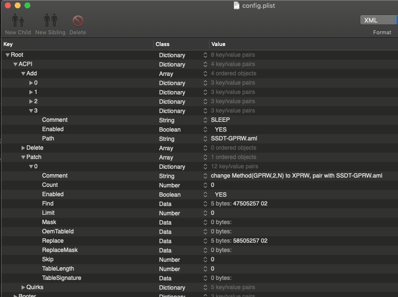

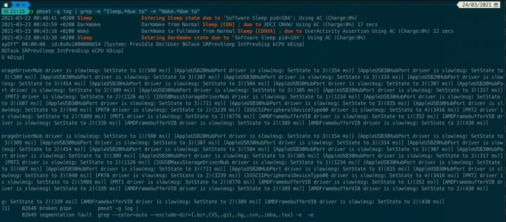

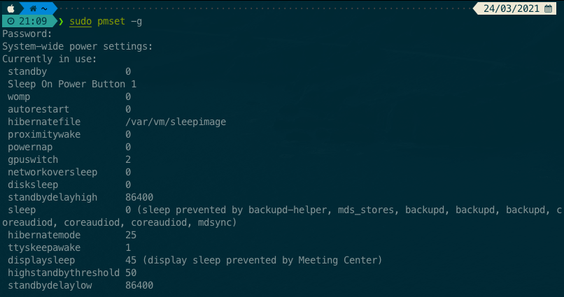

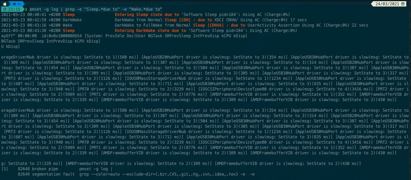

panosru Posted March 24, 2021 Share Posted March 24, 2021 (edited) is anyone else experience issues with sleep, or it's just me? When I put my hack to sleep, once the fans stop it wakes up after a couple of seconds :/ I have wake on lan disabled in WiFI (in both places) and I think power management is set properly: UPDATE: After running pmset -g log | grep -e "Sleep.*due to" -e "Wake.*due to" I'm getting the following: I'm trying to understand where the issue might be. UPDATE: I think it might be related to a software, maybe time machine, because actually after a minute it goes back to sleep and it's ok afterwards. Edited March 24, 2021 by panosru 1 Link to comment https://www.insanelymac.com/forum/topic/339980-audiogods-aorus-z390-pro-patched-dsdt-mini-guide-and-discussion/page/170/#findComment-2753779 Share on other sites More sharing options...
robix604 Posted March 25, 2021 Share Posted March 25, 2021 I had the same issues with sleep, I applied patches from https://dortania.github.io/OpenCore-Post-Install/usb/misc/instant-wake.html. 1 Link to comment https://www.insanelymac.com/forum/topic/339980-audiogods-aorus-z390-pro-patched-dsdt-mini-guide-and-discussion/page/170/#findComment-2753802 Share on other sites More sharing options...
panosru Posted March 25, 2021 Share Posted March 25, 2021 (edited) @robix604 thanks for the suggestion! I was also about to patch it, although I was a bit sceptical at first, but that you also posted that the patch works for you I proceeded with it myself as well. I have to note that with the patch sleep functionality works flawlessly for me, although you cannot wake up your computer via keyboard or mouse, only via power button, which to me is a desired behaviour. I have my phone connected to my hack and I have it on a desk stand, a lot of times when I put my hack to sleep and forgot to unplug my phone before I put it to sleep, once I unplug the phone the hack wakes up, with that patch now I don't need to worry about it because I can plug and unplug my phone from the usb dock without waking up the hack. Thanks! Edited March 25, 2021 by panosru Link to comment https://www.insanelymac.com/forum/topic/339980-audiogods-aorus-z390-pro-patched-dsdt-mini-guide-and-discussion/page/170/#findComment-2753822 Share on other sites More sharing options...
AudioGod Posted March 25, 2021 Author Share Posted March 25, 2021 That patch is meant for things like usb2 internal hubs forcing wake like Corsair AIOs for example. If you have a issue with sleep and it’s not connected to the above then all your doing is covering up a problem. That’s fine but it’s not a fix. if you had a deep gash in your arm that needed stitches a plaster may cover it up but won’t make it better. You get what I mean? Link to comment https://www.insanelymac.com/forum/topic/339980-audiogods-aorus-z390-pro-patched-dsdt-mini-guide-and-discussion/page/170/#findComment-2753824 Share on other sites More sharing options...
panosru Posted March 25, 2021 Share Posted March 25, 2021 @AudioGod thanks for clarifying that up! I troubleshooted the issue for a few hours but I couldn't find what caused the issue, although what was happing actually was that after I put my hack to sleep after a few seconds (sometimes a couple other times 10 - 15 seconds) it woke up (the monitors were still turned off), it done something and then after a few seconds it returned back to sleep. That could also repeat after a few hours (I suspect time machine), but with the patch so far it doesn't do anything like it, plus I really like that I don't wake my hack with the keyboard, I prefer pressing the power button. Link to comment https://www.insanelymac.com/forum/topic/339980-audiogods-aorus-z390-pro-patched-dsdt-mini-guide-and-discussion/page/170/#findComment-2753827 Share on other sites More sharing options...
AudioGod Posted March 25, 2021 Author Share Posted March 25, 2021 (edited) That’s called power nap bud. It semi wakes itself up to check Mail, download iCloud pictures messages, etc etc. Totally normal behaviour but if you wanna turn it off then uncheck power nap in energy saver Edited March 25, 2021 by AudioGod Link to comment https://www.insanelymac.com/forum/topic/339980-audiogods-aorus-z390-pro-patched-dsdt-mini-guide-and-discussion/page/170/#findComment-2753828 Share on other sites More sharing options...
panosru Posted March 26, 2021 Share Posted March 26, 2021 @AudioGod I had power nap unchecked already, but it still was waking up for a few seconds and then it went back to sleep, besides I really prefer to wake up my computer via power button and not the keyboard Link to comment https://www.insanelymac.com/forum/topic/339980-audiogods-aorus-z390-pro-patched-dsdt-mini-guide-and-discussion/page/170/#findComment-2753963 Share on other sites More sharing options...
