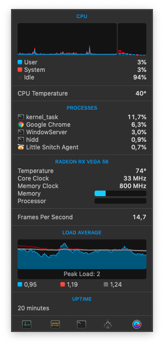

panosru Posted August 17, 2019 Share Posted August 17, 2019 @larabee yes, I do that already, at first I thought it was related to apps that use gpu heavily, but then it was happening even without those apps being running, so I have no clue, I will monitor it now. Link to comment https://www.insanelymac.com/forum/topic/337837-glasgoods-macos-mojave-successguide-for-aorus-z390-pro/page/58/#findComment-2686443 Share on other sites More sharing options...

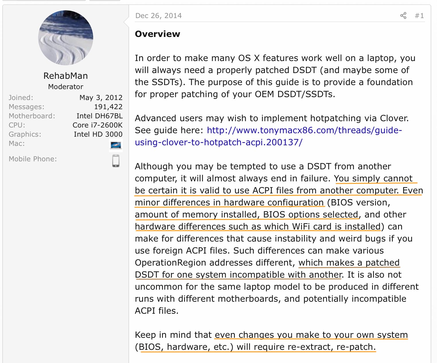

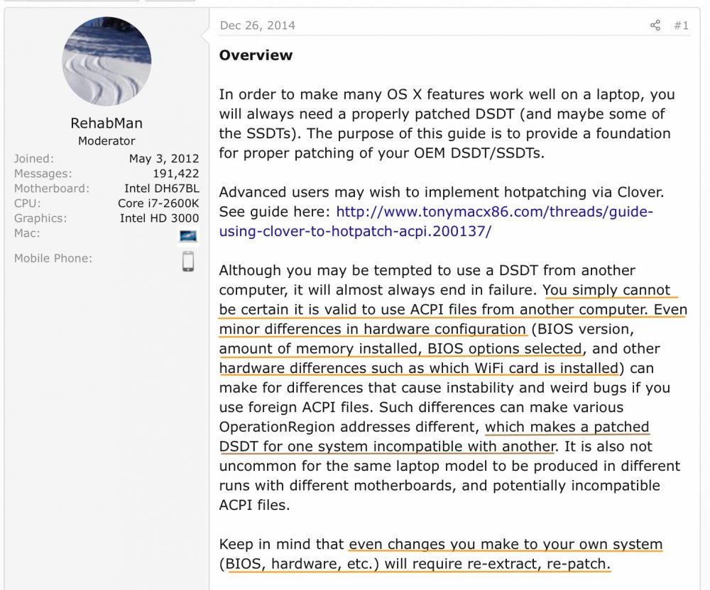

glasgood Posted August 17, 2019 Author Share Posted August 17, 2019 17/07/2019 Reverted back to the non DSDT EFI folder within guide as an EFI fit for all, it seems that a DSDT extracted from one specific setup does not greatly transfer to majority of Aorus Pro Z390 configs with different memory, graphics cards, BIOS configuration. For those looking for DSDT fix it's best to extract your own ACPI files and source your own patched DSDT @MaLd0n can possible assist with DSDT Patch. 2 Link to comment https://www.insanelymac.com/forum/topic/337837-glasgoods-macos-mojave-successguide-for-aorus-z390-pro/page/58/#findComment-2686447 Share on other sites More sharing options...
texem Posted August 17, 2019 Share Posted August 17, 2019 afaik the DSDT table is static from BIOS but SSDT is dynamic. So there might be different DSDT's for different BIOS versions. To find out, some guys here can use BIOS F10 , extract with F4 in Clover boot and then compare . Wondering if we get different aml's 1 Link to comment https://www.insanelymac.com/forum/topic/337837-glasgoods-macos-mojave-successguide-for-aorus-z390-pro/page/58/#findComment-2686449 Share on other sites More sharing options...

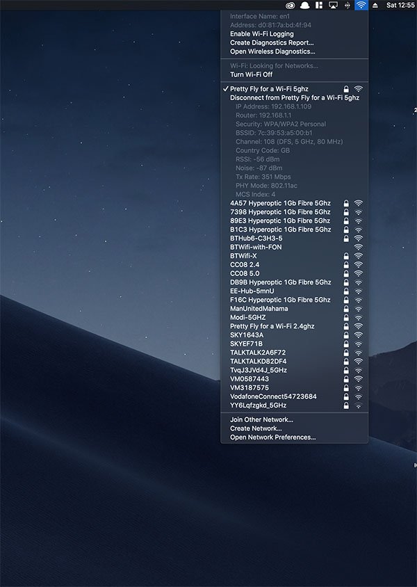

ainsleyclark Posted August 17, 2019 Share Posted August 17, 2019 Thanks for your reply @glasgood I have attached my EFI folder, with extracted ACPI. Im also experiencing some very slight bluetooth lag on mouse Apple Magic Mouse, I'm using a BCM943602CS and confirmed its not WIFI interference. Any help would be greatly appreciated. EFI.zip Link to comment https://www.insanelymac.com/forum/topic/337837-glasgoods-macos-mojave-successguide-for-aorus-z390-pro/page/58/#findComment-2686450 Share on other sites More sharing options...
ainsleyclark Posted August 17, 2019 Share Posted August 17, 2019 Was my bad, had the HD's in the USB3 ports, Still have a laggy mouse though, I have deleted AirportBrcmFixup.kext, Wifi running on 5ghz, and plugged into PCIEX1_3, USB attached to F_USB2. Fixed country code. Not sure what this can be now, will a antenna extension help? If so can anyone recommend? Link to comment https://www.insanelymac.com/forum/topic/337837-glasgoods-macos-mojave-successguide-for-aorus-z390-pro/page/58/#findComment-2686455 Share on other sites More sharing options...
hackinbot Posted August 17, 2019 Share Posted August 17, 2019 3 hours ago, glasgood said: 17/07/2019 Reverted back to the non DSDT EFI folder within guide as an EFI fit for all, it seems that a DSDT extracted from one specific setup does not greatly transfer to majority of Aorus Pro Z390 configs with different memory, graphics cards, BIOS configuration. For those looking for DSDT fix it's best to extract your own ACPI files and source your own patched DSDT @MaLd0n can possible assist with DSDT Patch. @AudioGod thanks for posting your EFI buddy. I may have time to test it next weekend. In light of @glasgood's post above - I think it's safest to use DSDT's from system with extremely similar hardware, or create your own DSDT. I have a Fenvi T919 wifi/bt card installed, so that may act up and provide another vector for instability. We also have different GPUs installed. @glasgood was your iMessage activation problem due to the NVRAM not saving the ROM and Board Serial Number values? That's the problem I was having with the DSDT version of your EFI. I always use my own unique values in my hack but for some reason the DSDT EFI with native NVRAM wasn't reading/saving them from Clover. 1 Link to comment https://www.insanelymac.com/forum/topic/337837-glasgoods-macos-mojave-successguide-for-aorus-z390-pro/page/58/#findComment-2686457 Share on other sites More sharing options...
glasgood Posted August 17, 2019 Author Share Posted August 17, 2019 56 minutes ago, ainsleyclark said: Was my bad, had the HD's in the USB3 ports, Still have a laggy mouse though, I have deleted AirportBrcmFixup.kext, Wifi running on 5ghz, and plugged into PCIEX1_3, USB attached to F_USB2. Fixed country code. Not sure what this can be now, will a antenna extension help? If so can anyone recommend? Hi @ainsleyclark Go with ==>Aorus Pro Z390 EFI.zip you may get a kernel panic on first boot, if so then just reboot. If mouse is still an issue, then follow: WIFI – Clover Hotpatch PXSX to ARPT in the guide. 1 Link to comment https://www.insanelymac.com/forum/topic/337837-glasgoods-macos-mojave-successguide-for-aorus-z390-pro/page/58/#findComment-2686458 Share on other sites More sharing options...
hackinbot Posted August 17, 2019 Share Posted August 17, 2019 (edited) 1 hour ago, ainsleyclark said: Was my bad, had the HD's in the USB3 ports, Still have a laggy mouse though, I have deleted AirportBrcmFixup.kext, Wifi running on 5ghz, and plugged into PCIEX1_3, USB attached to F_USB2. Fixed country code. Not sure what this can be now, will a antenna extension help? If so can anyone recommend? To rule out if it's a range issue vs software/config issue - bring the Magic Mouse right next to the antenna to see if the lag's gone. If it's a range issue, you can try orienting the antenna (not sure which one is for BT) differently. If it's not a range issue, I'm not sure what else to try. My card's also in PCIEX1_3, USB attached to F_USB2. There's no lag on the Magic Trackpad about 5ft away. The BT antenna is oriented parallel to the floor - pointing straight out of the back of the tower (not bent). Edited August 17, 2019 by hackinbot 1 Link to comment https://www.insanelymac.com/forum/topic/337837-glasgoods-macos-mojave-successguide-for-aorus-z390-pro/page/58/#findComment-2686460 Share on other sites More sharing options...

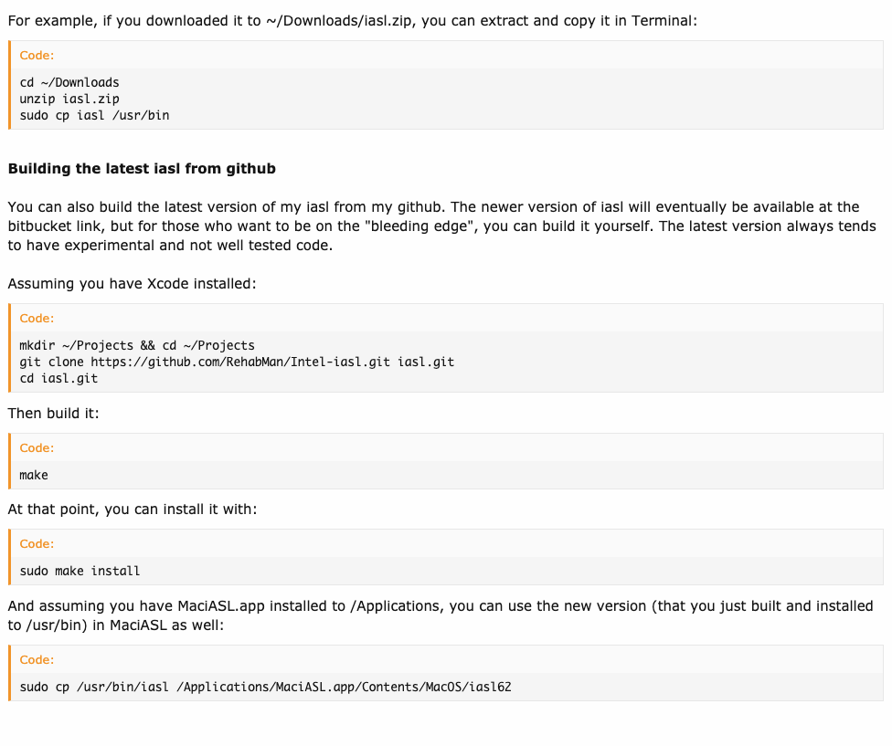

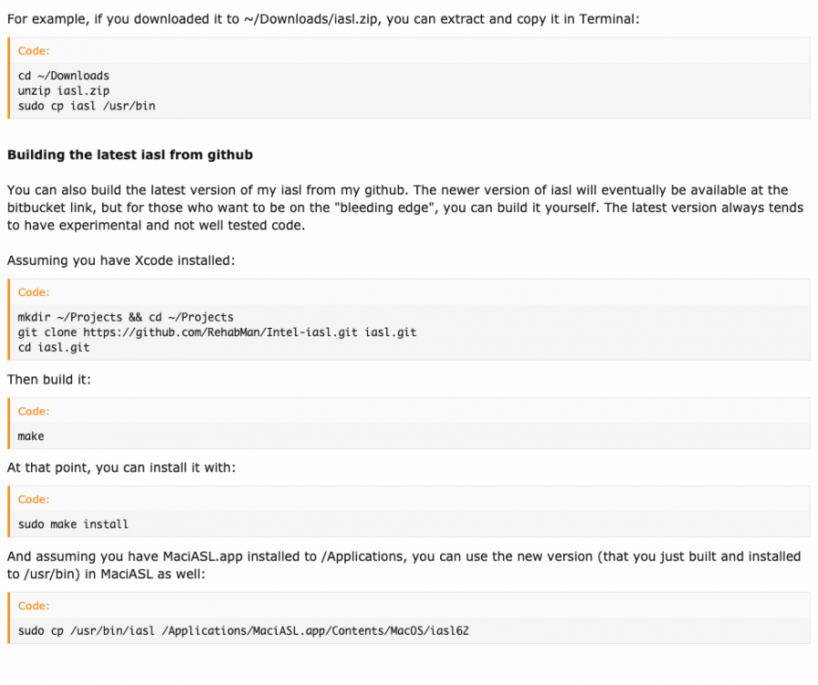

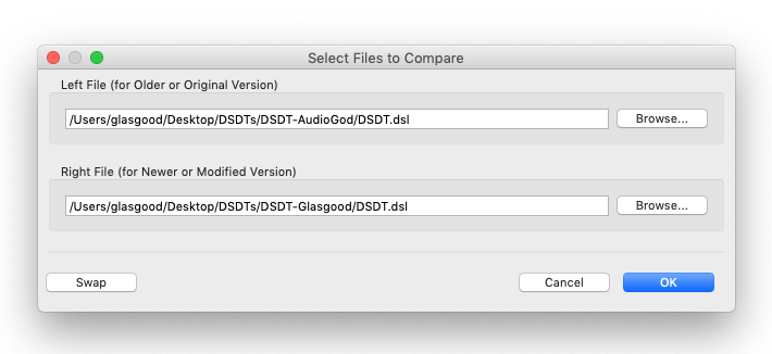

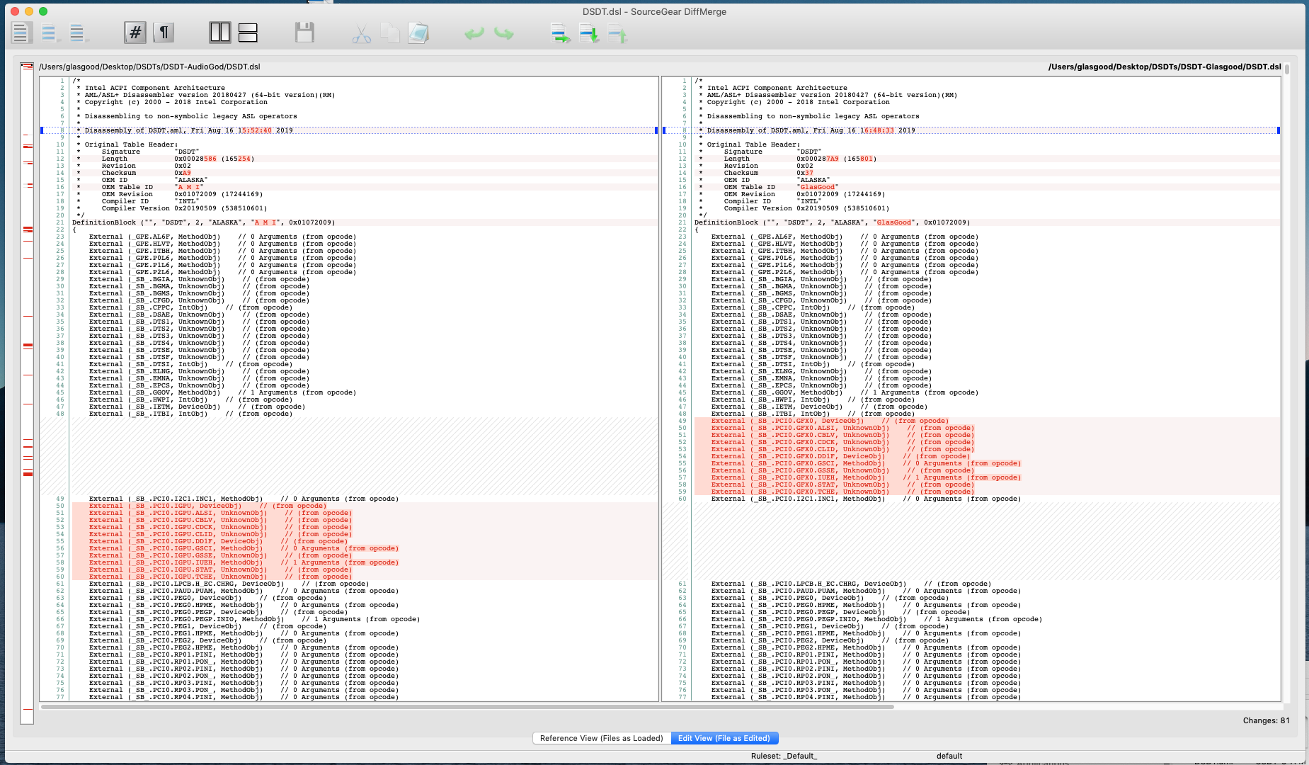

glasgood Posted August 17, 2019 Author Share Posted August 17, 2019 (edited) Anyone looking to study ( the curious ) and compare DSDT, a good tool to use is DiffMerge and can be downloaded ==>here DSDT must be decompiled from .aml to .dsl when using tool. Here attached are two DSDT decompiled to .dsl DSDT.dsl DSDT.dsl To decompile your own DSDT Follow Rehabman's instructions Change directory to folder where DSDT or SSDT file is and then use following command to decompile all DSDT and SSDT files ( you may have to create a refs.txt if decompiling from Clover F4 extract, instructions in link above ) iasl -dl DSDT.aml SSDT*.aml Edited August 17, 2019 by glasgood 1 1 Link to comment https://www.insanelymac.com/forum/topic/337837-glasgoods-macos-mojave-successguide-for-aorus-z390-pro/page/58/#findComment-2686462 Share on other sites More sharing options...
ainsleyclark Posted August 17, 2019 Share Posted August 17, 2019 (edited) Thank you for your replies, helping alot. glasgod - Both attempts still result in a tiny little bit of lag, what are the differences between the EFI you attached? I think this is quite high in noise? Hackinbot - I had the antenna bent upwards. Will try it straight. Is this allowing for a cleaner signal? Let me know your thoughts, thank you so much again! Edited August 17, 2019 by ainsleyclark Link to comment https://www.insanelymac.com/forum/topic/337837-glasgoods-macos-mojave-successguide-for-aorus-z390-pro/page/58/#findComment-2686465 Share on other sites More sharing options...
glasgood Posted August 17, 2019 Author Share Posted August 17, 2019 (edited) 18 minutes ago, ainsleyclark said: Thank you for your replies, helping alot. glasgod - Both attempts still result in a tiny little bit of lag, what are the differences between the EFI you attached? I think this is quite high in noise? Let me know your thoughts, thank you so much again! Look through both EFI folders, you will see the difference. Did you apply the Clover PXSX to ARPT with correct device ACPI path using IOregExplorer. Your hack does seem in very close proximity to 24 wireless routers with strong signals ( noise ). I'm not a wireless networking expert, but maybe you could try changing to a different channel on your router. Ha Ha " Pretty Fly for a Wi-Fi " love it Edited August 17, 2019 by glasgood Link to comment https://www.insanelymac.com/forum/topic/337837-glasgoods-macos-mojave-successguide-for-aorus-z390-pro/page/58/#findComment-2686466 Share on other sites More sharing options...
glasgood Posted August 17, 2019 Author Share Posted August 17, 2019 44 minutes ago, glasgood said: Anyone looking to study ( the curious ) and compare DSDT, a good tool to use is DiffMerge and can be downloaded ==>here DSDT must be decompiled from .aml to .dsl when using tool. Here attached are two DSDT decompiled to .dsl DSDT.dsl DSDT.dsl To decompile your own DSDT Follow Rehabman's instructions Change directory to folder where DSDT or SSDT file is and then use following command to decompile all DSDT and SSDT files ( you may have to create a refs.txt if decompiling from Clover F4 extract, instructions in link above ) iasl -dl DSDT.aml SSDT*.aml To decompile your own DSDT first download install iasl ( ensure you have SIP disabled or you will be unable to copy iasl to usr/bin/ ) Follow Rehabman's instructions Link to comment https://www.insanelymac.com/forum/topic/337837-glasgoods-macos-mojave-successguide-for-aorus-z390-pro/page/58/#findComment-2686468 Share on other sites More sharing options...

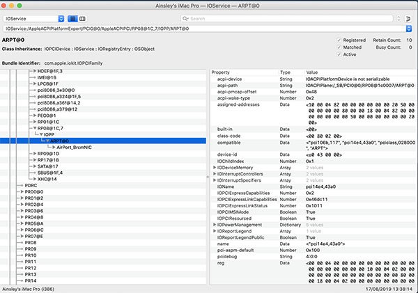

ainsleyclark Posted August 17, 2019 Share Posted August 17, 2019 Still no luck, the mouse is better and its' not dreadful but will slowly drive me insane. This was working ok on a Gigabyte z170x Gaming 5 before hand, exactly the same just changed board & CPU. Changed to ARPT (screenshot attached) and using the EFI you suggested up there ^. New EFI attached, dropped Firmware.scap from Apple in order to upload, not sure what that was? Haha, pretty fly for a wifi :). Only thing thats not working :(. Thanks for helping! EFI.zip Link to comment https://www.insanelymac.com/forum/topic/337837-glasgoods-macos-mojave-successguide-for-aorus-z390-pro/page/58/#findComment-2686470 Share on other sites More sharing options...

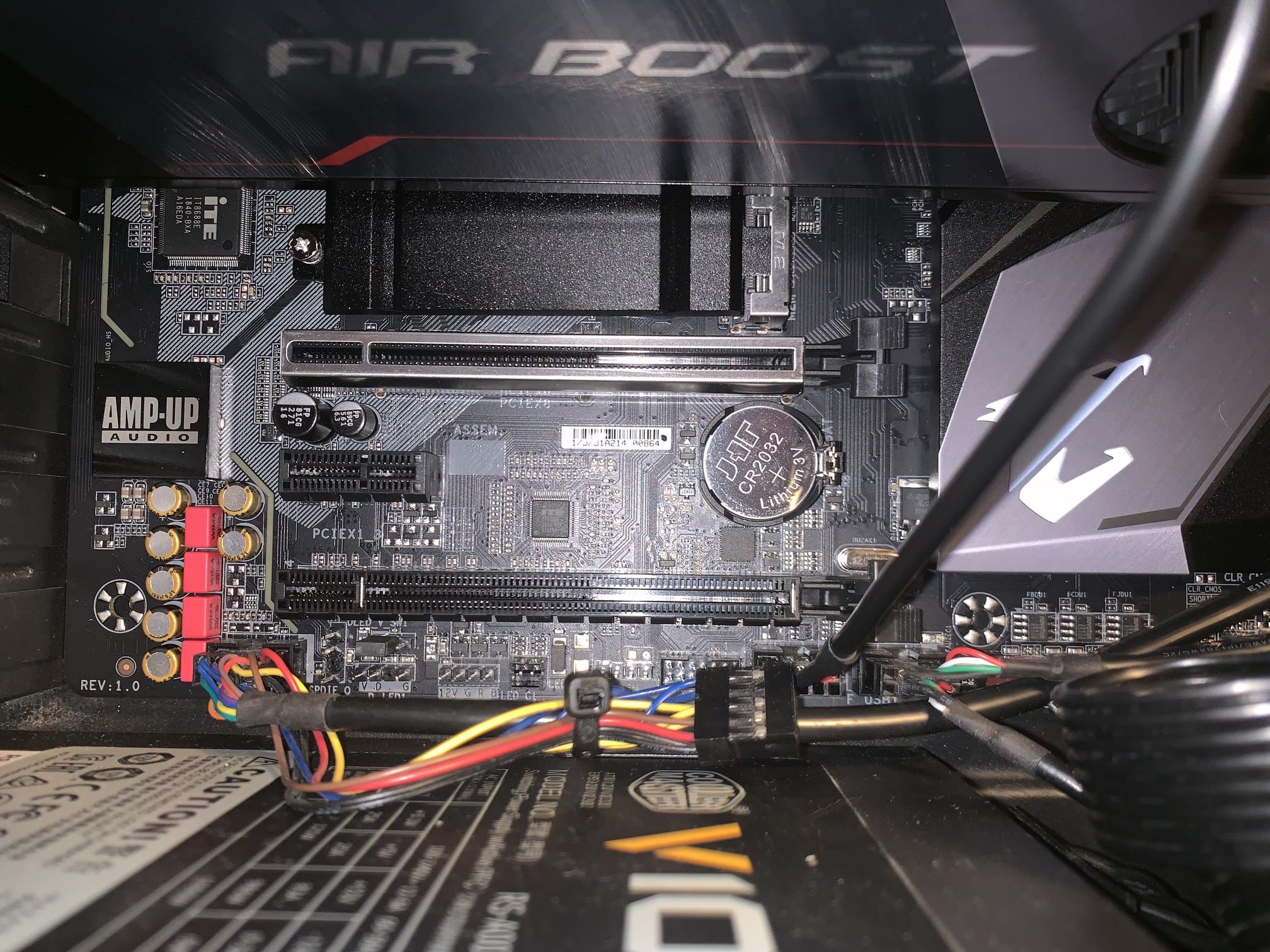

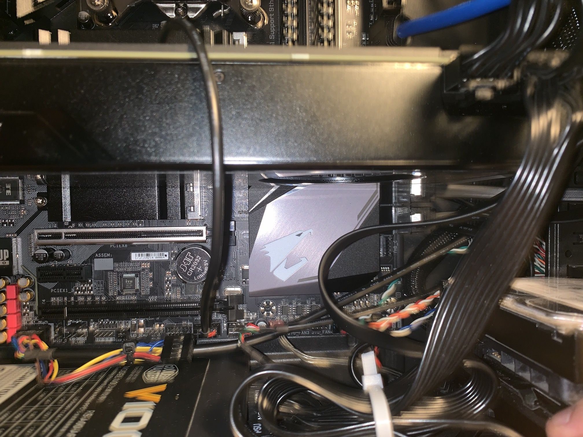

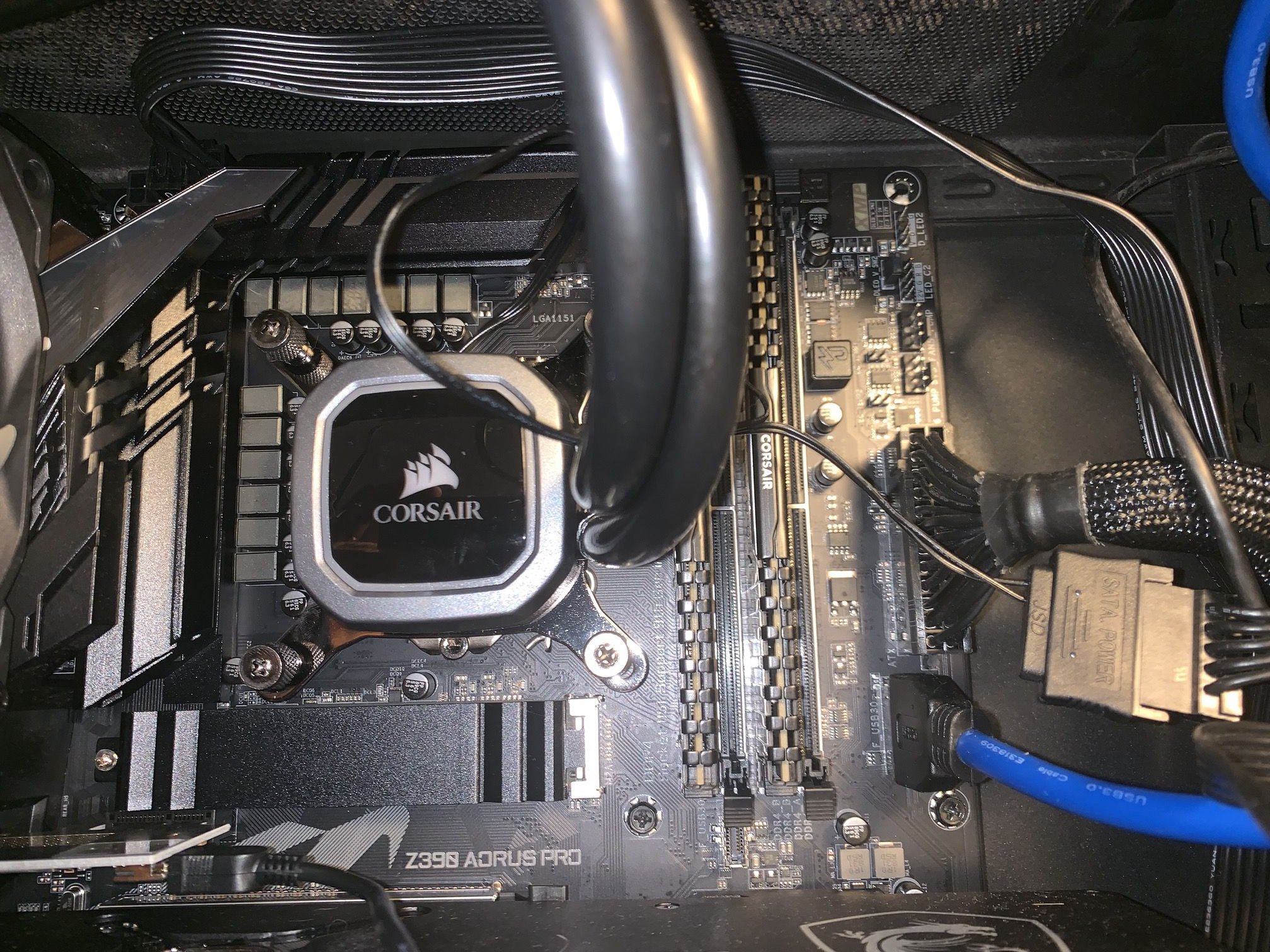

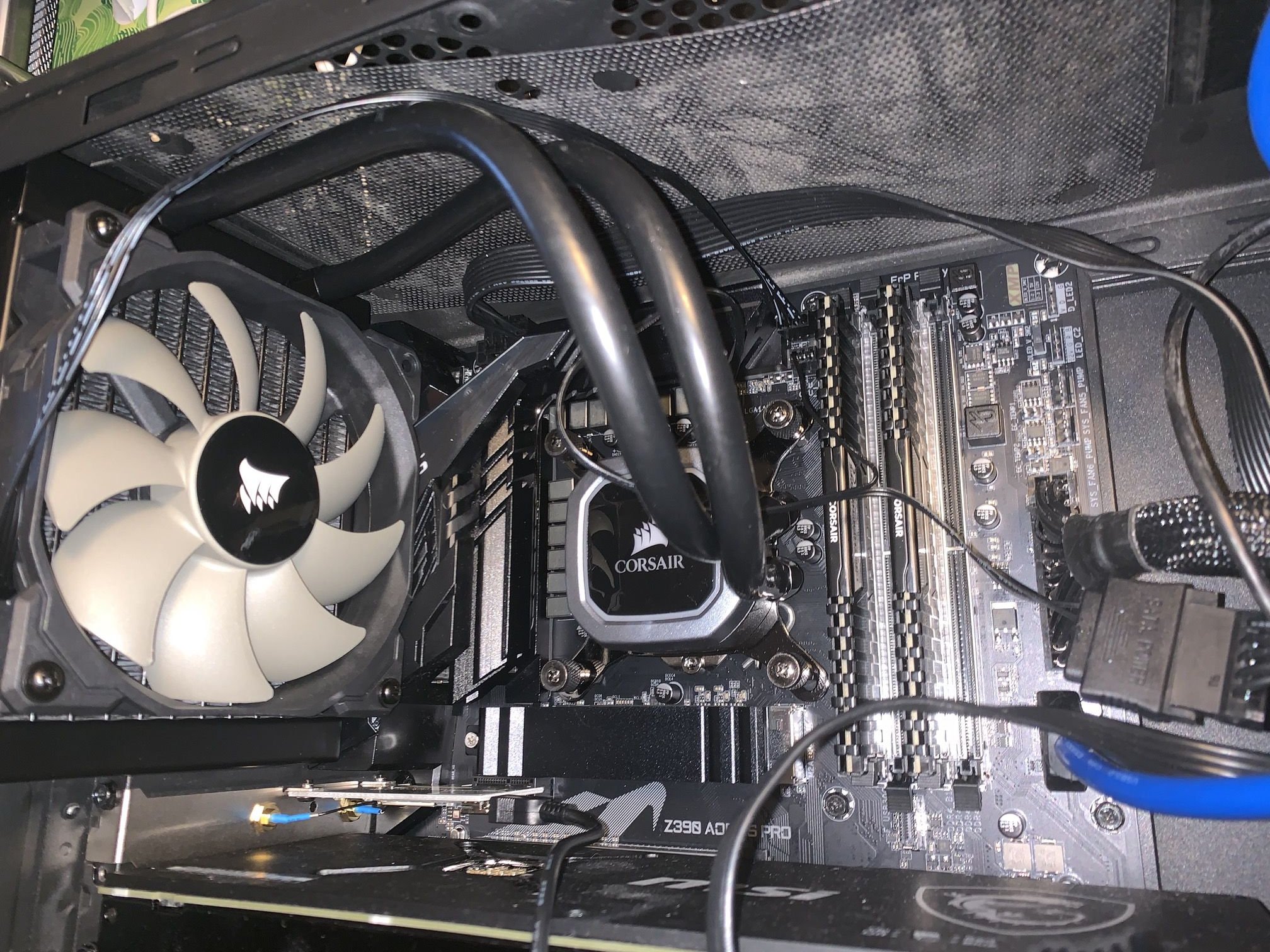

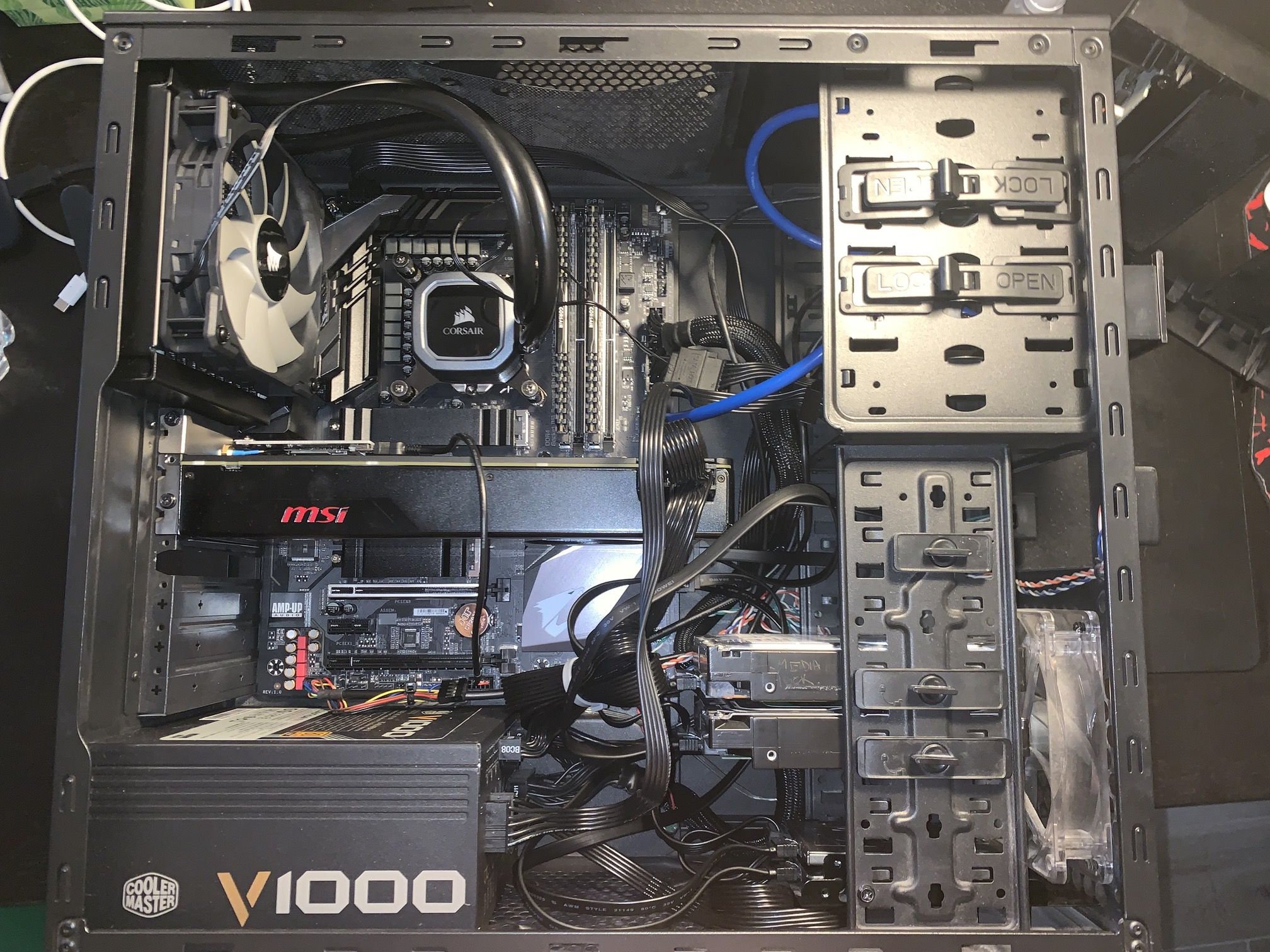

D3v1L Posted August 17, 2019 Share Posted August 17, 2019 (edited) On 8/10/2019 at 12:59 PM, gino8080 said: Hello and sorry for late answer, So these are my pics of the build (a bit messy ) hope they are clear, otherwise I'll shoot new with better light and/or zoom Do you see something strange? the power supply is a Cooler Master V1000 (bought less than 1 year ago) Now I mounted a new noctua fan (for the case) and attacched a APC BR1500GI 1500 VA, tried disconnecting power, and seems working on battery without problems Now seems pretty stable, temps "seems" good these are in idle.. (Istat menu screen) I'm using the integrated mobo sound, BUT i did not tried again disconnecting/connecting the audio jack, because that was the problem, i'll try again to see If i'll got a black screen BUT NOW I HAVE A PROBLEM with bluetooth not anymore recognized! and so also airdrop stopped working DOn't know why, the only new hardware thing changed, is the new noctua fan that is a 4pin (the old was a 3 pin) I also changed the usb port of the Abwb 802.11AC Wi-Fi (PCI-E) BCM943602CS , and removed the front usb from the other port (so atm I have only 1 of the 2 usb2 port busy with the Abwb bluetooth cable) What can be the problem for the bluetooth stopping working? (i''l check in windows if it's recognized) EDIT: SOLVED! As suggested from @ilcondannato (ciao caro grazie l'ho visto prima che lo cancellassi! :)) I just swapped pci port, and also usb2 port (for the bluetooth cable) and now it's working good! I also changed Country code to #4 and also TX rate seems better! THANK YOU! See now!...glade you resolve! ;-) uhm don't delete nothing...but seem not allowed write in other lang...so someone delete my mex...glade you see it before! cheers! :-D "ammazz che casino in quel case lol" xD Edited August 17, 2019 by ilcondannato Link to comment https://www.insanelymac.com/forum/topic/337837-glasgoods-macos-mojave-successguide-for-aorus-z390-pro/page/58/#findComment-2686478 Share on other sites More sharing options...

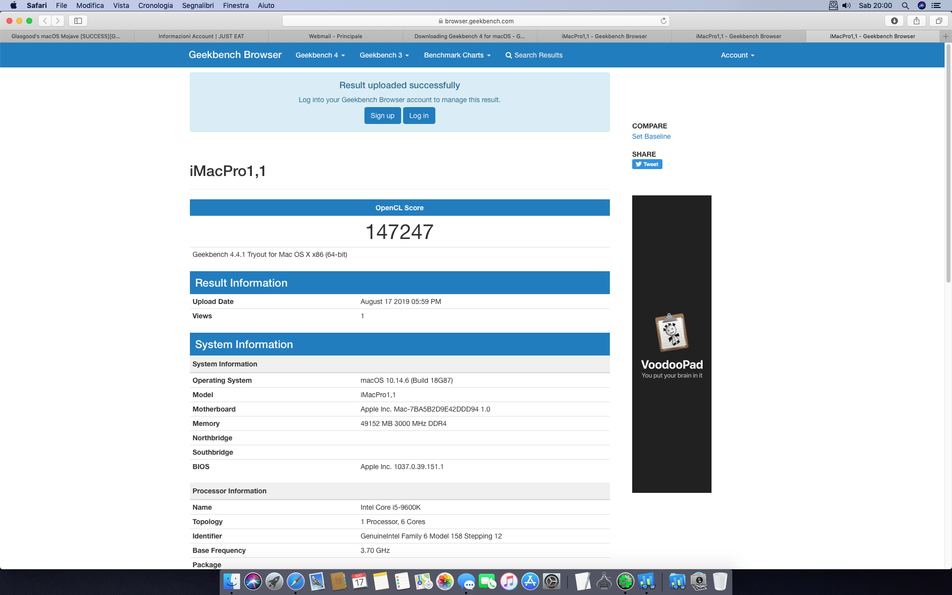

gino8080 Posted August 19, 2019 Share Posted August 19, 2019 wooo Thread is back online! thanks @glasgood! On 8/17/2019 at 12:53 AM, AudioGod said: Correct, don’t set it manually though, use the XMP Profile and you should be good. Thank you @AudioGod now i see my memory at 3000 Mhz! On 8/16/2019 at 11:39 PM, AudioGod said: No you should be able to boot into the system with the igpu enabled just go into your config and add slide=0 to the boot arguments and then in the bios enable the igpu and set it to its default settings and it should work fine using imacpro1,1 And no generate a new serial and follow glasgoods guide on how to enable iMessage. Personally I prefer the igpu disabled but I'm a overclocker so I would....lol What's the point of having igpu active when atm I'm using 2 video port of my Vega 56? (connected to 2 monitors) (it's possible to delegate to igpu some kind of works?) and lastly, anyone knows the correct code to make my i7-9700K recognised correctly? (now it shows as 3,6 GHz Intel Core i9 on sys preference) thank you! Link to comment https://www.insanelymac.com/forum/topic/337837-glasgoods-macos-mojave-successguide-for-aorus-z390-pro/page/58/#findComment-2686644 Share on other sites More sharing options...
