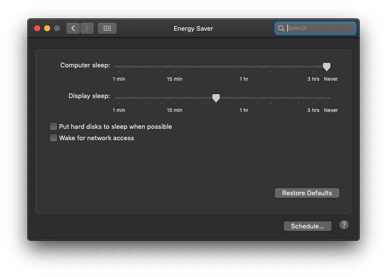

panosru Posted August 13, 2019 Share Posted August 13, 2019 Hello, I noticed that when I leave my computer unattended for a few hours, when I return back the screen is black (which is normal) but I cannot "wake" it, the computer is working but when I press my spacebar it does nothing. Note, it is not in sleep mode, it is working normally but the screen does not turn on, I tried to unplug and plug back the monitor cable, move the mouse, press all the buttons of the keyboard, nothing... This started to happen since I updated my kexts in my EFI, but I'm not sure which kext to blame if no one had a similar experience, I eventually will try to revert back the updated kexts with the old ones one by one to pinpoint the one that causes that behaviour. My energy settings are normal. I tried to put "Display sleep" to never, and it works fine, but if my display turns off for an X amount of time, then I cannot turn it back on and I'm forced to press the reset button on my tower. Maybe it is a cause of whatevergreen? I'm on 1.3.0 version. Also, I'm using EFI iMac 19,1 because it works better for me than the iMac Pro 1,1 with iMac Pro 1,1 EFI I have the following issues: The USB ports are not backwards compatible and although currently, I use only USB3 devices on my USB3 ports, my USB3 hub for some reason is recognised as a USB2 hub with iMac Pro 1,1 EFI but it is a USB3 device, I'm sure about it (photo attached). Sleep is not working for me, it may be related to USB for some reason, but I tried a variety of SSDT and I did not have a success story to share. My graphics card is not recognised by many apps, and also I have no way to see the temperature of it in iStats Menus. My CPU was recognised as i9 but I have i7. Those are the primary reasons that made me revert back to my previous EFI, but I updated my kexts, I'm not thinking to downgrade the kexts as it was before in case I won't be able to find a solution on the display sleep issue. Cheers! Link to comment https://www.insanelymac.com/forum/topic/337837-glasgoods-macos-mojave-successguide-for-aorus-z390-pro/page/55/#findComment-2685870 Share on other sites More sharing options...

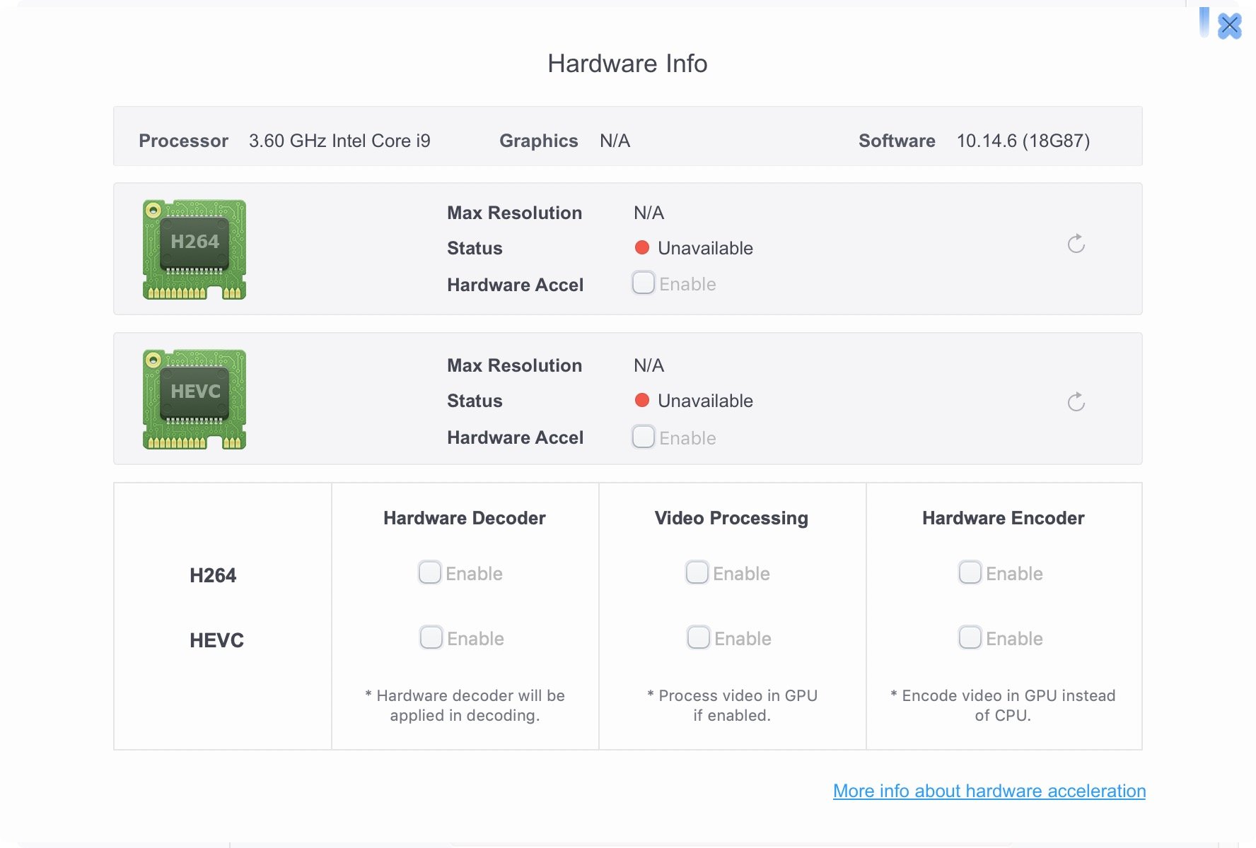

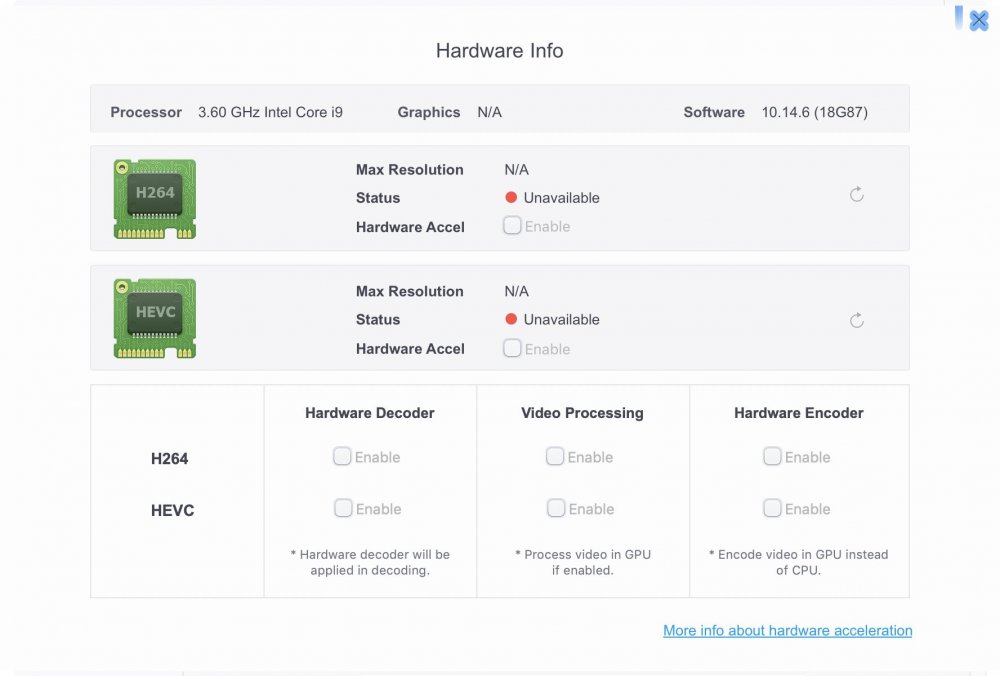

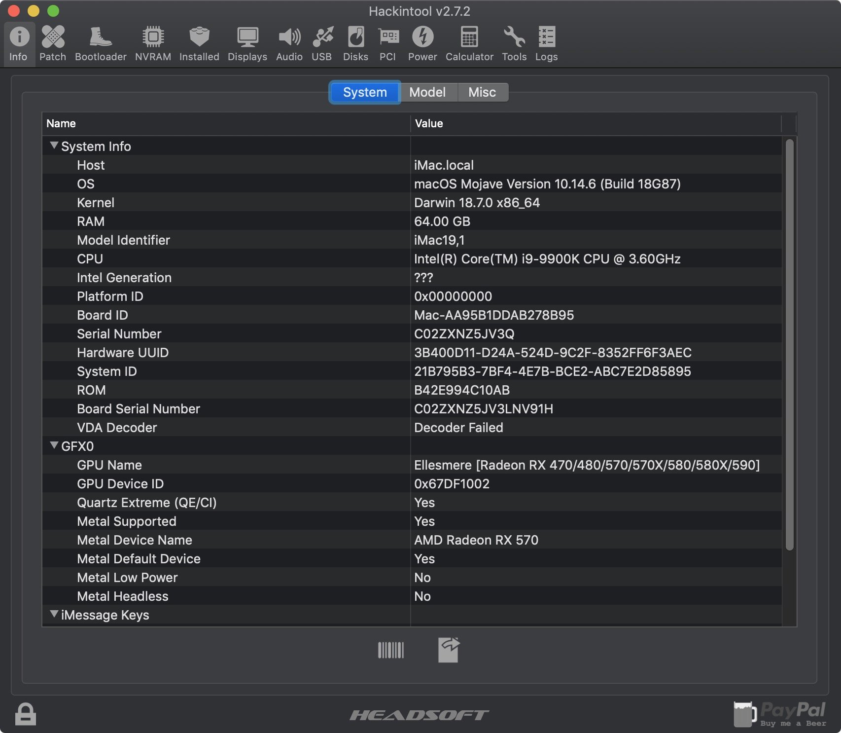

pkdesign Posted August 13, 2019 Share Posted August 13, 2019 I update my BIOS to 10 last night and I have noticed a few things. 1) I no longer have the ability to set video DVMT: • Chipset → DVMT Pre-Allocated • Chipset → DVMT Total Gfx Mem 2) I use to be able to see both graphic cards (IGPU and RX570) but now I can only see one. VideoProc tells me I have no acceleration and the IGPU is not listed in System Profiler either. Hackintool use to show correct frame buffer, and now it doesn’t. VDA decode doesn’t work. WTF? Anyone have any similar issues? Link to comment https://www.insanelymac.com/forum/topic/337837-glasgoods-macos-mojave-successguide-for-aorus-z390-pro/page/55/#findComment-2685879 Share on other sites More sharing options...
panosru Posted August 13, 2019 Share Posted August 13, 2019 (edited) @pkdesign I'm using EFI iMac 19,1 as you and I also have updated my bios to F10, make sure that you follow the following instruction of this topic in the first page 1. Follow the steps in the section "PART 2 - BIOS SETTINGS (Version F10 )" 2. Follow the steps in the section "FINAL CUT PRO – Configuration for AMD RX5xx", even though it has a strikethrough, for those who are using iMac19,1 EFI, is must-have. The final cut pro section will replace some of the settings of part 2 because part 2 is now optimised for iMacPro1,1 EFI and not iMac19,1, but as I wrote on my previous post, so far I have some deal-breaking issues with the newest EFI. Cheers Edited August 13, 2019 by panosru Link to comment https://www.insanelymac.com/forum/topic/337837-glasgoods-macos-mojave-successguide-for-aorus-z390-pro/page/55/#findComment-2685883 Share on other sites More sharing options...
pkdesign Posted August 13, 2019 Share Posted August 13, 2019 Argh! I selected Internal Graphics>Enabled but it didn't stick. It went back to "Auto." I went back into setup and selected it again and it now works again. Doh! Link to comment https://www.insanelymac.com/forum/topic/337837-glasgoods-macos-mojave-successguide-for-aorus-z390-pro/page/55/#findComment-2685886 Share on other sites More sharing options...

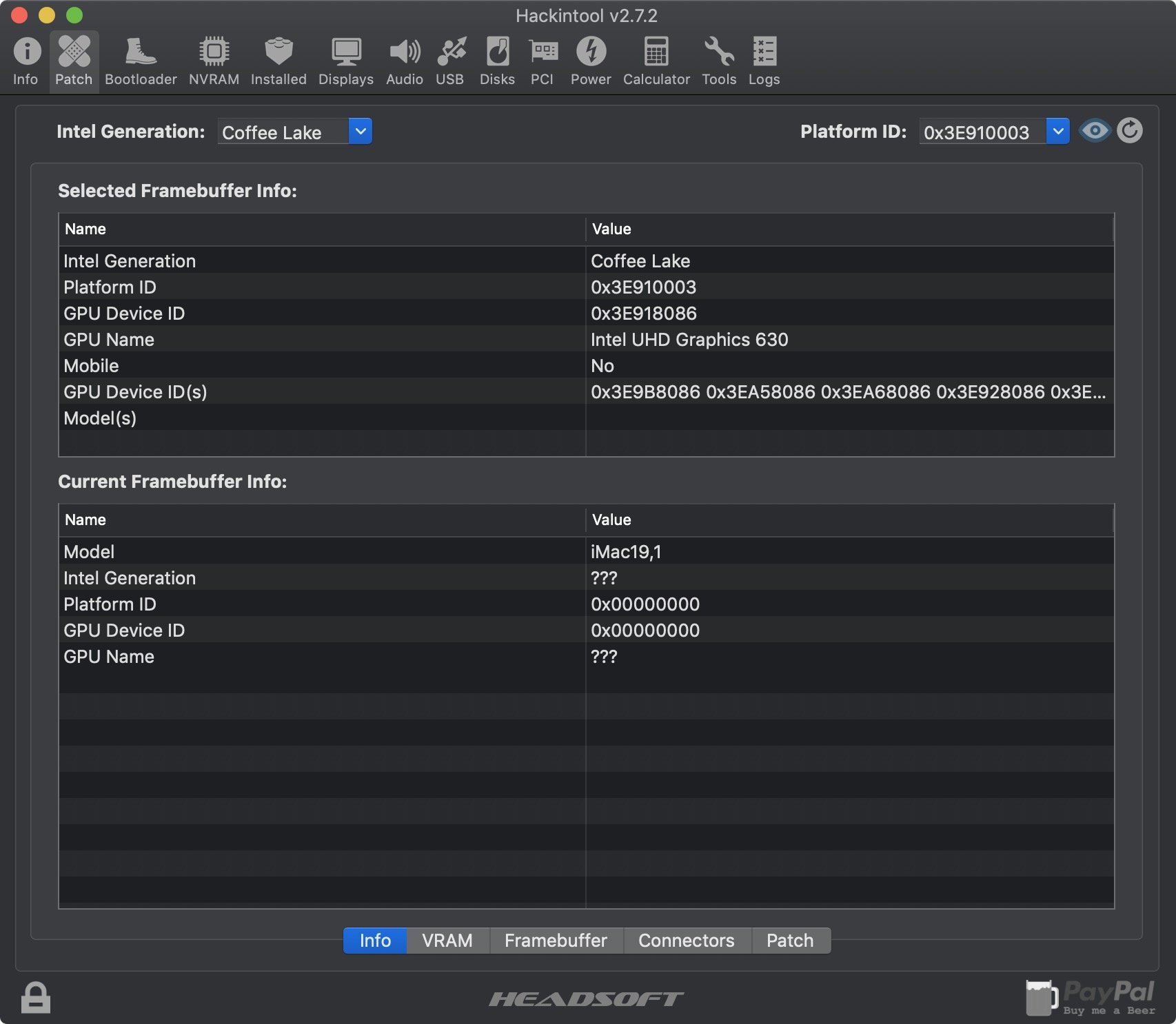

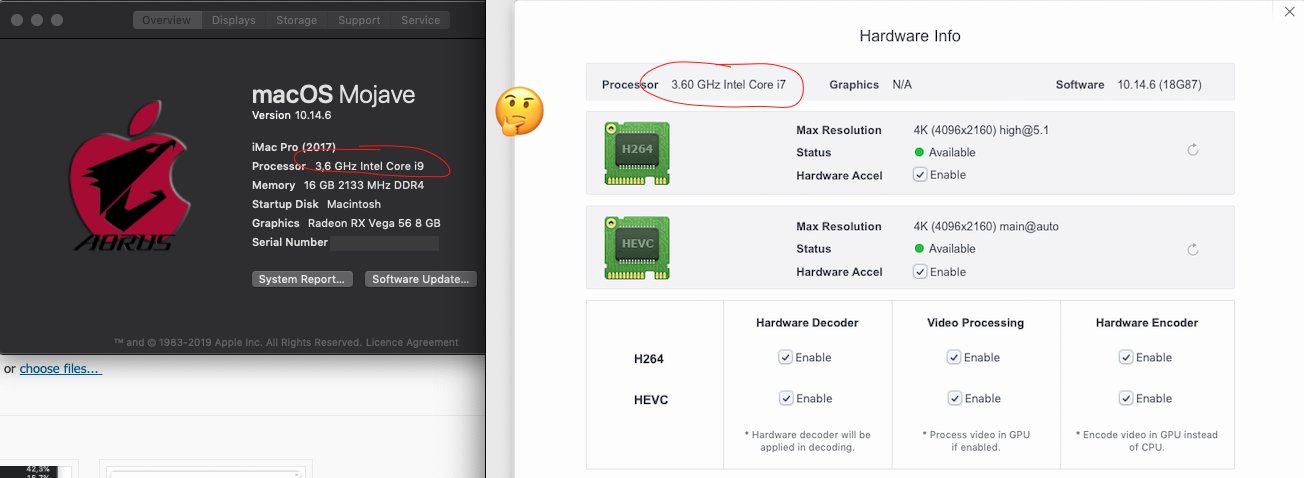

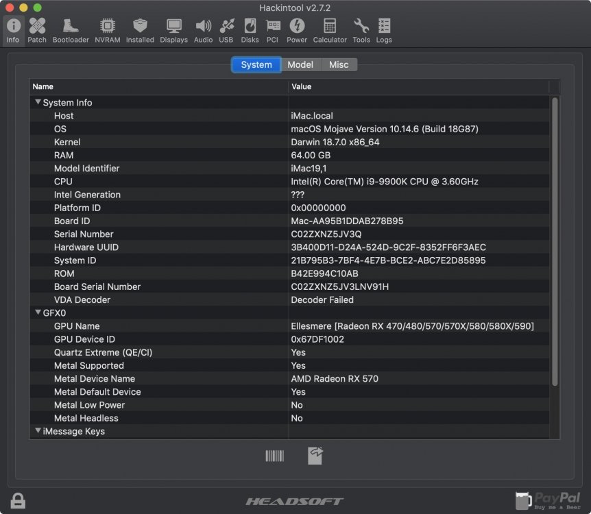

gino8080 Posted August 13, 2019 Share Posted August 13, 2019 (edited) I'm on F10 and using iMac Pro 1,1 and just NOW I realized that I have pretty these same problems: 4 hours ago, panosru said: with iMac Pro 1,1 EFI I have the following issues: The USB ports are not backwards compatible and although currently, I use only USB3 devices on my USB3 ports, my USB3 hub for some reason is recognised as a USB2 hub with iMac Pro 1,1 EFI but it is a USB3 device, I'm sure about it (photo attached). I have same problem, only works as usb3, but my usb3 internal adapter seems working good at usb3 speed 4 hours ago, panosru said: Sleep is not working for me, it may be related to USB for some reason, but I tried a variety of SSDT and I did not have a success story to share Sleep seems ok, i can press space bar or move mouse to awake it most of the time EDIT Sleep IS NOT WORKING,when in sleep I have to press power to awake , but screens remains Black without gpu input signal this happens also when I powerUp the PC (from OFF state) I though was related to APC, but at this point I can exclude this, I have to press reset just after POWER ON to ensure monitor will get signal PLEASE ANY HELP? 4 hours ago, panosru said: My graphics card is not recognised by many apps, and also I have no way to see the temperature of it in iStats Menus. Gfx is recognized well , with hw acceleration , also I can see this temp on istat (I don't know if it's a real value btw ) 4 hours ago, panosru said: My CPU was recognised as i9 but I have i7. System info shows as i9 and VideoProc shows correctly as i7 Does this can create problems &/or perfomance issues of any type? how to fix it? Switching to iMac 19,1 can resolve/change something ? Edited August 13, 2019 by gino8080 not working Link to comment https://www.insanelymac.com/forum/topic/337837-glasgoods-macos-mojave-successguide-for-aorus-z390-pro/page/55/#findComment-2685908 Share on other sites More sharing options...

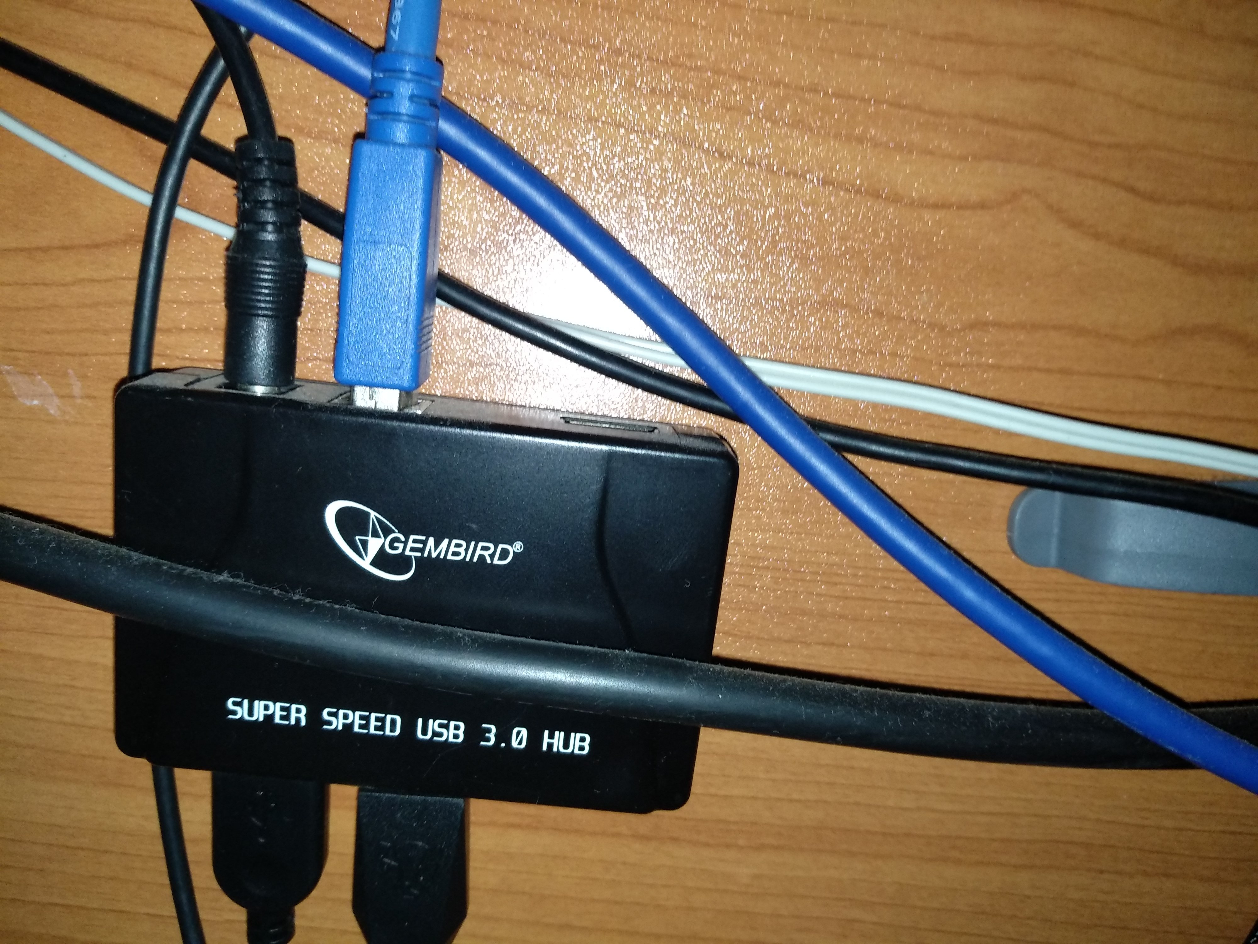

panosru Posted August 14, 2019 Share Posted August 14, 2019 (edited) @gino8080 for me, my USB 3 hub wasn't working, so I had to use a custom SSDT, which I'm not sure if I have done it right, but in any case, I had issues with sleep which I could not fix and I had to return back to my previous EFI with iMac19,1. I cannot tell if it is the best option for you, as there are much more experienced users here to advise you, for me it was the best option at that time but I'm constantly monitoring this topic to see what other users say, once I see that it became stable, then I will give it a second shot. I will try whatevergreen 1.3.1 to see if it solves the issue, yesterday I set my display sleep to never, but I forgot to disable the screensaver when I returned home the monitor was frozen with the screensaver, I'm not sure what triggers the freeze. Also some times I get freezes during my work, but that is completely random and I cannot reproduce it, but the freeze when I leave my computer unattended it is a sure thing. Another issue that I faced (not often) is after sleep, I was waking up the computer but my monitors would not turn on, lately I haven't faced that issue, maybe it is resolved with kext updates I'm not sure, I'm still monitoring. Those are the main issues I'm currently facing with my iMac19,1 EFI, but even so, it is more stable than iMac Pro 1,1, at least for me, maybe for others with a different setup it is the opposite. In regards to the way you wake up your computer, I prefer to use power button instead of my keyboard or other devices for many reasons and the main is that I don't want to accidentally wake up my computer for whatever reason, I might cleaning the office at that time and press a keyboard button. I have 3 monitors (my left and right on HDMI and my main in the centre on DisplayPort). for SSDT look at this guide, I'm not an expert and I'm also not sure if I did it correctly for myself, but give it a shot. Edited August 14, 2019 by panosru Link to comment https://www.insanelymac.com/forum/topic/337837-glasgoods-macos-mojave-successguide-for-aorus-z390-pro/page/55/#findComment-2686035 Share on other sites More sharing options...

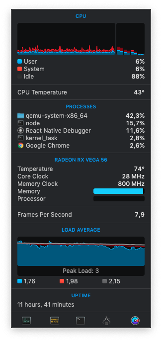

panosru Posted August 14, 2019 Share Posted August 14, 2019 (edited) Updating to whatevergreen 1.3.1 resolved the issue with my computer being frozen while unattended for a few hours For some reason the new EFI with iMac Pro 1,1 uses 1.3.0 because with 1.3.1 one of display ports will not function, unfortunately, I do not have another monitor with display port to test it. I hope that was the reason with random freezes I was encountering lately. Most of the times I encountered those issues was when I was working with apps like Final Cut Pro, Adobe Premiere, Adobe After Effects and Adobe Photoshop, but because I work with those apps almost every day I did not think that whatevergreen kext might cause the freezes. Personally, I believe OpenCore will be much more stable and the primary solution for Hackintosh. UPDATE: Well, I spoke too early... anyways I will wait for a more stable EFI to try it out. Edited August 15, 2019 by panosru Link to comment https://www.insanelymac.com/forum/topic/337837-glasgoods-macos-mojave-successguide-for-aorus-z390-pro/page/55/#findComment-2686178 Share on other sites More sharing options...

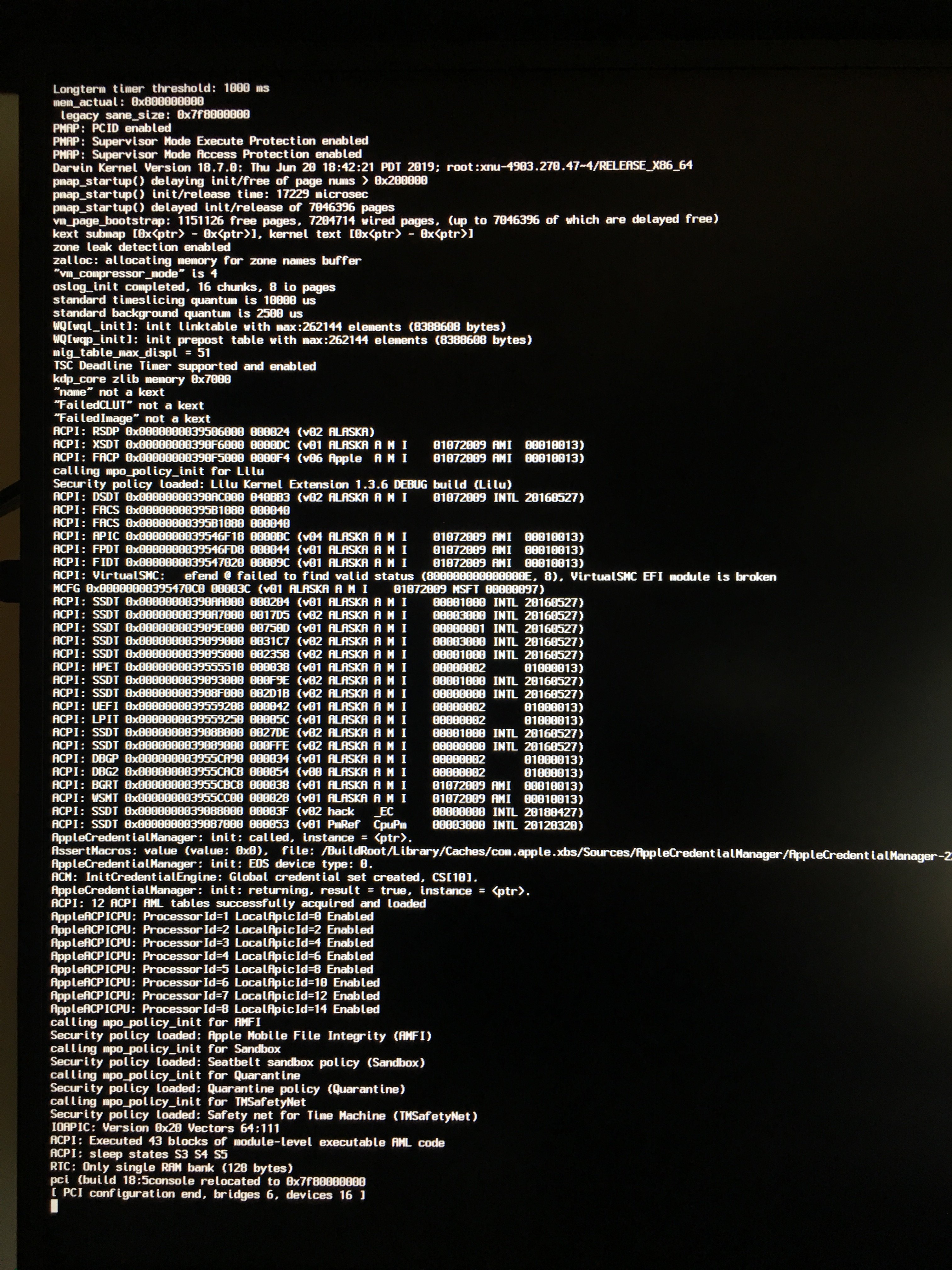

Cipha Posted August 16, 2019 Share Posted August 16, 2019 Today I started my hackintosh and this error appeared. I didn’t change anything in the bios but appetently something went wrong. I restored the profile and it worked again. Can anybody tell what went on here? Today I started my hackintosh and this error appeared. I didn’t change anything in the bios but appetently something went wrong. I restored the profile and it worked again. Can anybody tell what went on here? Link to comment https://www.insanelymac.com/forum/topic/337837-glasgoods-macos-mojave-successguide-for-aorus-z390-pro/page/55/#findComment-2686335 Share on other sites More sharing options...
AudioGod Posted August 16, 2019 Share Posted August 16, 2019 (edited) @glasgood In Clover under RT Variables change CsrActiveConfig from 0x67 (SIP Completely disabled) too 0x0 (SIP Enabled) or 0x3 (Partially Disabled(loads unsigned kexts)) and that should do it 7 minutes ago, Cipha said: Today I started my hackintosh and this error appeared. I didn’t change anything in the bios but appetently something went wrong. I restored the profile and it worked again. Can anybody tell what went on here? Today I started my hackintosh and this error appeared. I didn’t change anything in the bios but appetently something went wrong. I restored the profile and it worked again. Can anybody tell what went on here? What EFI Folder are you using? Edited August 16, 2019 by AudioGod Link to comment https://www.insanelymac.com/forum/topic/337837-glasgoods-macos-mojave-successguide-for-aorus-z390-pro/page/55/#findComment-2686337 Share on other sites More sharing options...

Cipha Posted August 16, 2019 Share Posted August 16, 2019 7 minutes ago, AudioGod said: @glasgood In Clover under RT Variables change CsrActiveConfig from 0x67 (SIP Completely disabled) too 0x0 (SIP Enabled) or 0x3 (Partially Disabled(loads unsigned kexts)) and that should do it What EFI Folder are you using? An older version glasgoods EFI with RX580 + custom SSDT for USB Since everything went super smooth I didn't had a need to update. Link to comment https://www.insanelymac.com/forum/topic/337837-glasgoods-macos-mojave-successguide-for-aorus-z390-pro/page/55/#findComment-2686339 Share on other sites More sharing options...
