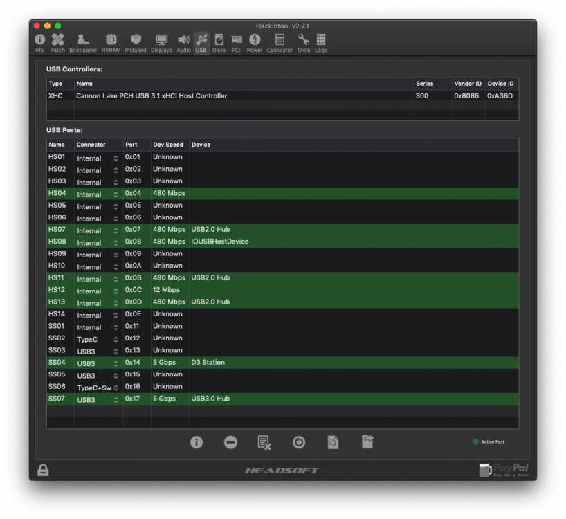

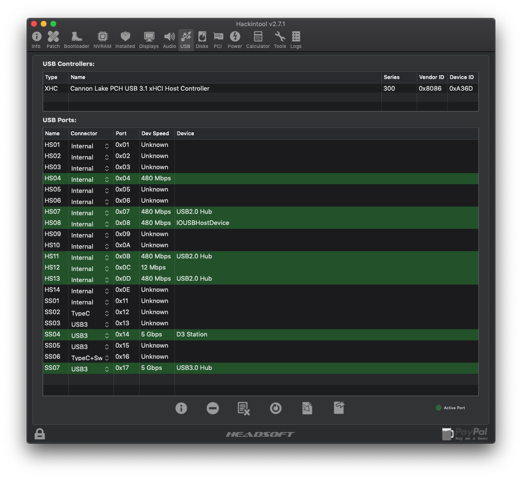

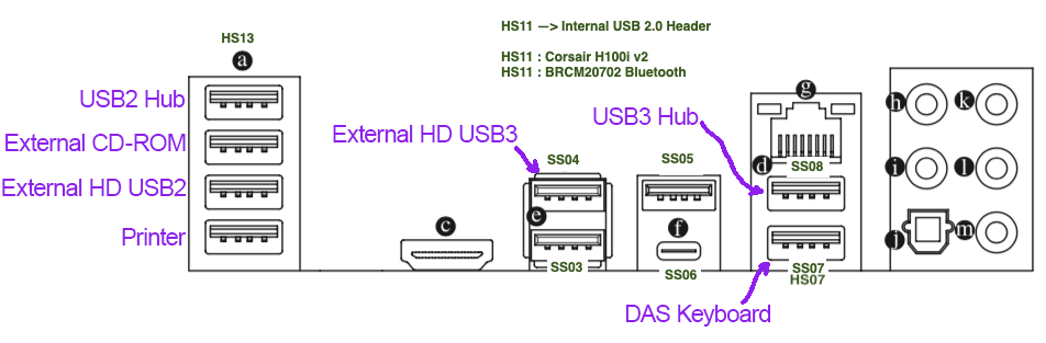

4 hours ago, larabee said:
The USB 3 port in glasgood original EFI and DSDT EFI is patched in a way that disable USB2 on USB3 ports. You can create your own USB patch using the guide included in the first post.
Well I'm not sure if I did it right, but it seems to work so far.
I run hackintool, went to USB tab, removed everything and refreshed, then I exported and it placed in my desktop two files "SSDT-UIAC.aml" and "USBPorts.kext", I then mount my EFI partition and deleted the DSDT.aml that was inside CLOVER/ACPI/patched/ folder and placed my newly generated SSDT-UIAC.aml file, then I replaced the USBPorts.kext file located in CLOVER/kexts/Others/ with the one generated in desktop from hackintool, then rebooted and now it seems that everything is working fine again.
I attach here the two files that where generated from hackintool.
1919604150_Screenshot2019-08-08at23_08_06.thumb.png.d1ba8e03d7a397d63b6403ad623aa72a.png
This is what I have plugged in my USB ports:
AorusZ390Port.png.227503cb405ad08ef4638c287e9ca7f5.png.45675a5b9cefc3f39b0ebe6416fc4d5f.png
In my previous EFI that I kept as a backup, I also had an SSDT-GRPW.aml file but I have no clue what is it for. Other EFI's that I saw posted in this topic also contain SSDT-EC and SSDT-USBX files, but still I have no clue what they are for so I did not include any of them.
I also attach my clover configuration zip here.

Just a guess: On the Aorus Pro only HS11 and HS12 are internal USB 2.0 ports. Maybe that's why some devices prevent sleep.
You can try my SSDT if you want. Sleep is working fine for me

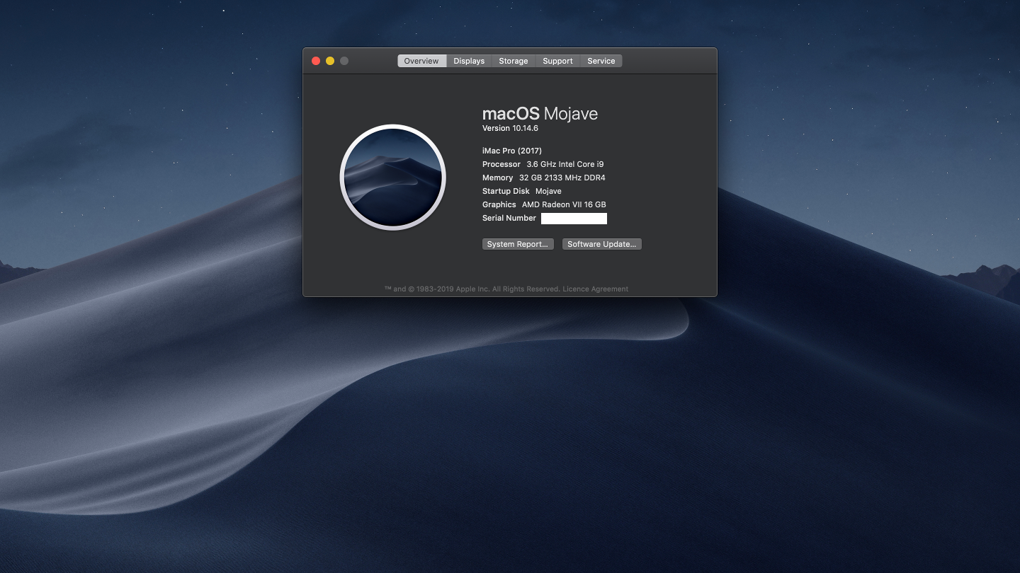

Shout out to Glasgood for another successful Gigabyte z390 Aorus Pro Wifi install
i9 9900K
Corsair Hydro H100x AIO Liquid CPU Cooler
Corsair 32GB Kit
Intel 6 Series 512GB M.2 NVMe SSD
Samsung 860 QVO 7mm 2.5" 2TB SSD
Gigabyte Radeon VII 7nm Triple Fan 16GB HBM2
Corsair HX750 750W 80PLUS Platinum Modular Power Supply
Jonsbo UMX4 Plus Silver Full Tower Case
Simplecom Bluetooth dongle
Powerline ethernet
Edited by saCULar

@Cipha thanks for the suggestion!
I tried your SSDT first, but for some reason my USB ports was messed up, ports that was USB 3, where treated like usb 2 and I wasn't getting USB 3 speed on my USB 3 device (d3 Station) which was connected on USB 3 port. Then I tried a USB 3 flash disk on a few USB 3 ports and the speed was very low as well :(
I then tried to create my own SSDT but as I said, I'm not experienced on this stuff, it is my first hackintosh and I'm not sure what I did wrong...

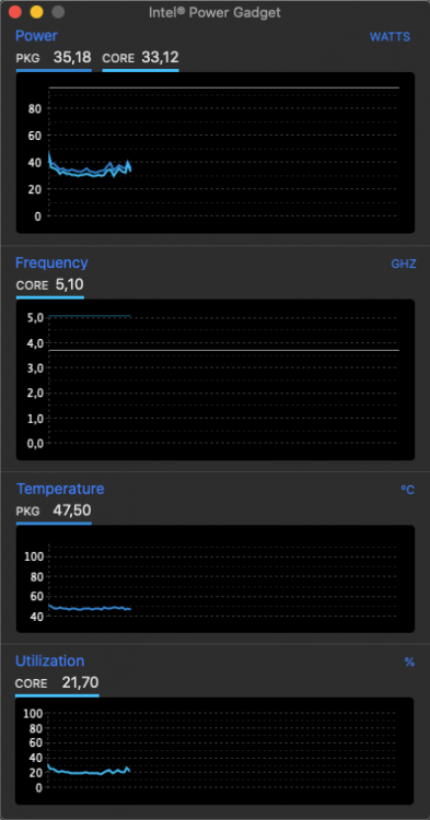

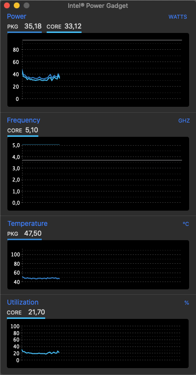

@gino8080 You can use Intel Power Gadget to see your CPU temperature. For GPU, I run this command from terminal to check temperature:
while sleep 1; do clear;ioreg -l |grep \"PerformanceStatistics\" | cut -d '{' -f 2 | tr '|' ',' | tr -d '}' | tr ',' '\n'|grep 'Temp\|Fan\|Clock'; done

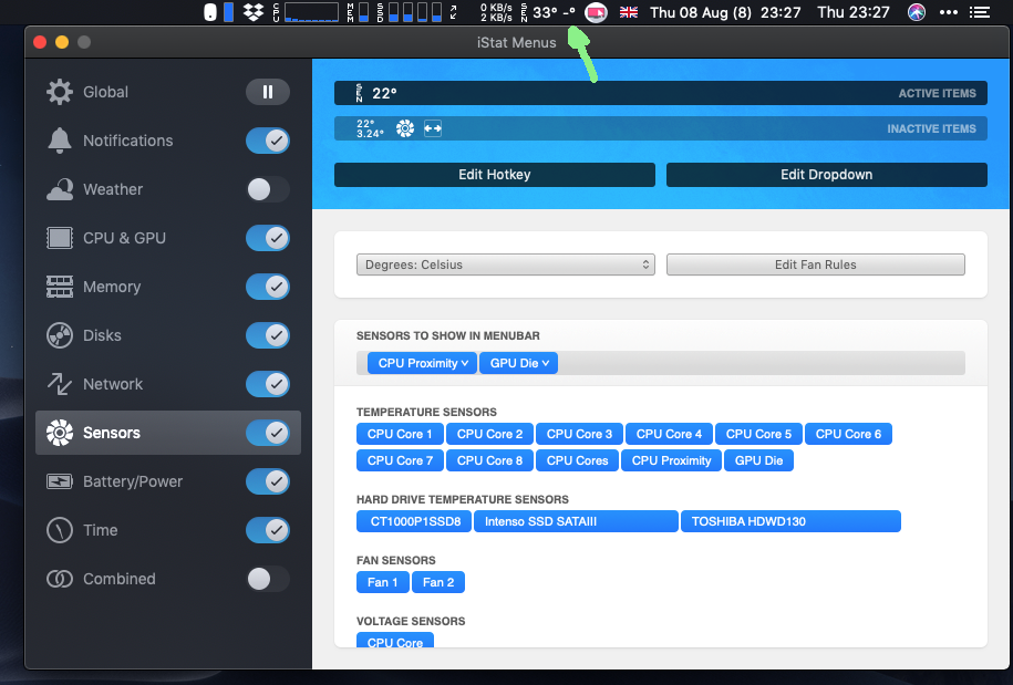

Now I mounted a new noctua fan (for the case) and attacched a APC BR1500GI  1500 VA, tried disconnecting power, and seems working on battery without problems
Now seems pretty stable, temps "seems" good  these are in idle..
(Istat menu screen)

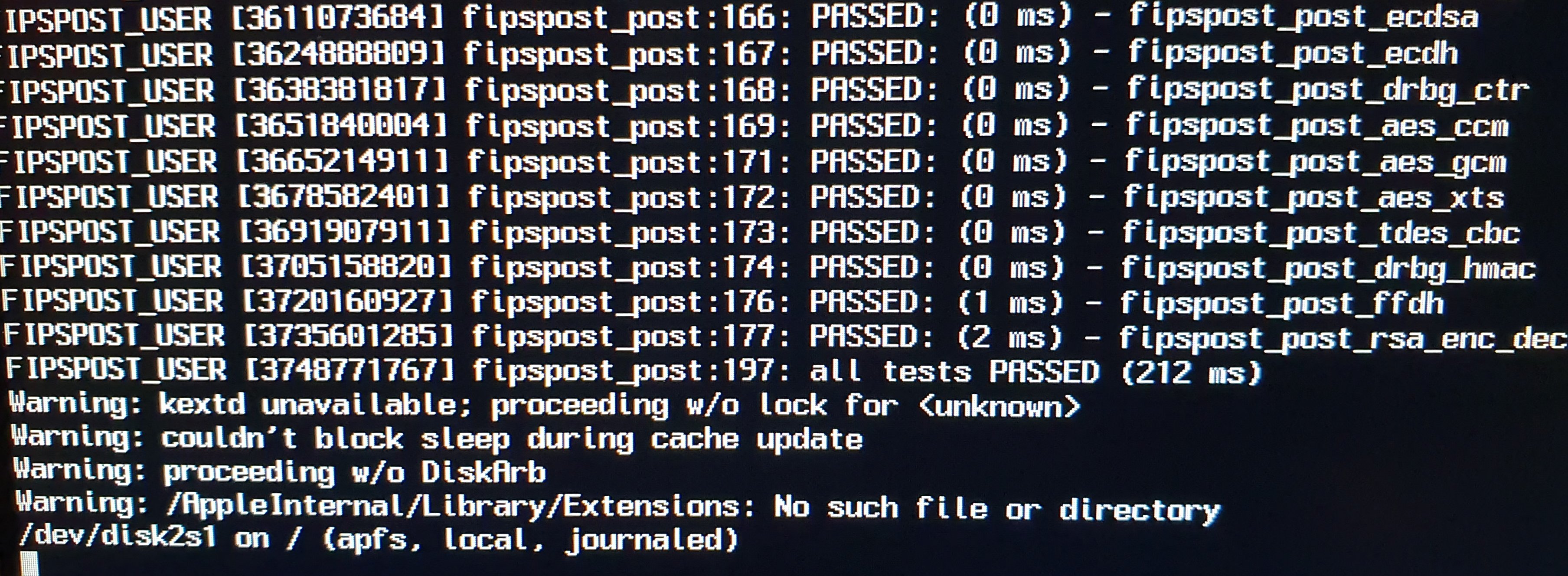

18 hours ago, AudioGod said:
@larabee or anybody know why im getting these warnings on boot up and how to fix it?
I have it on my real mac too.
You can safely ignore the AppleInternal/Library/Extensions because it’s meant for developing apps.
So if you want to add something to /System/Library/ for testing, but don't want to do it in the "real" software - you could add it to /AppleInternal/System/Library/ instead - and get the same effect. If the folder doesn’t exist and some kexts call for it, you will see the warning.
For the Proceed w/o DiskArbm it’s The disk arbitration daemon that maintains the list of available disks for graphical interface. Did you turn on TRIM? Try doing a disk repair in safe mode.
I think those warnings are tied to some IO problems that needs to be patched but it also appears on my real iMac 2017 then it’s an Apple thing, not hackintosh particular problem.

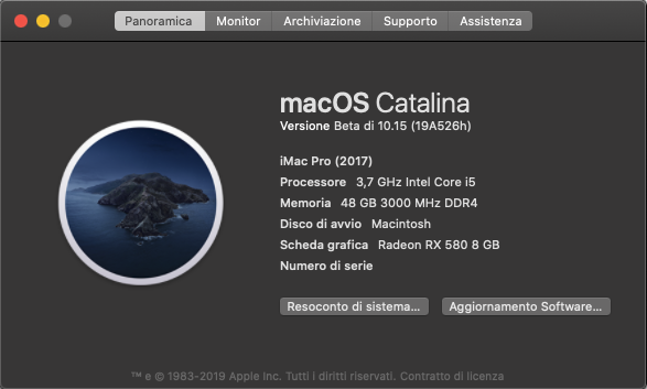

All ok now with all!
All working!
All perfect!
all with "only" my "little" 5,1ghz i5 9600k on Catalina 19A526h b5 :D
i7/i9 not needed ...I'm photographer and video maker not really need it...only ram and m.2 :gun::thumbsup_anim:
catalina.png.0c558dfdf1b946713eccd96d0a809138.png1830662622_pcfirma1.thumb.jpg.e9d81eef0f0e45e5e1505d025bd34a51.jpg
9224555_Schermata2019-08-12alle14_46_22.thumb.png.a01899fcbdc846b79c807ef7e113d41c.png
