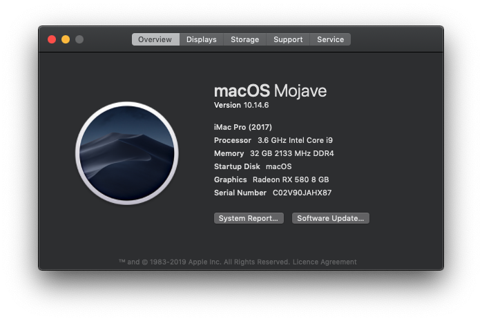

texem Posted August 7, 2019 Share Posted August 7, 2019 Hi @glasgood and @all, thanks a million for that thread which helped me out to build my new i9-9900 RX580 hack, the old cheese grater is to be sold now. Using the latest EFI _with_ DSDT I tried to start as an iMac19.1 instead of iMacPro because the native CPU support. Well, it boots but USB2 and 3 is completely dead but only the USB-C is alive. I had to plug in an USB-C Hub with USB-A Ports to reboot the machine. No ideas whats the problem and how to fix. Any hint ? Link to comment https://www.insanelymac.com/forum/topic/337837-glasgoods-macos-mojave-successguide-for-aorus-z390-pro/page/53/#findComment-2684917 Share on other sites More sharing options...

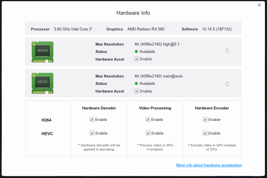

AudioGod Posted August 7, 2019 Share Posted August 7, 2019 (edited) 3 hours ago, texem said: Hi @glasgood and @all, thanks a million for that thread which helped me out to build my new i9-9900 RX580 hack, the old cheese grater is to be sold now. Using the latest EFI _with_ DSDT I tried to start as an iMac19.1 instead of iMacPro because the native CPU support. Well, it boots but USB2 and 3 is completely dead but only the USB-C is alive. I had to plug in an USB-C Hub with USB-A Ports to reboot the machine. No ideas whats the problem and how to fix. Any hint ? The new EFI wont work properly with smbios 19.1 and I can confirm that a 9900k will work perfectly with smbios imacpro1,1 (I have two system running now) If you really want to stay at 19.1 your need to redo your USB info as the kext glasgood uses is written for imacpro1,1. Or you can use plist pro and edit the kext witch is a very simple process to do. My advice though is put the smbios back to imacpro1,1 and enjoy. Use cinibemch and run it both ways if you still have doubts buddy. also make sure you fully disable your igpu in the bios. Edited August 7, 2019 by AudioGod Link to comment https://www.insanelymac.com/forum/topic/337837-glasgoods-macos-mojave-successguide-for-aorus-z390-pro/page/53/#findComment-2684938 Share on other sites More sharing options...

texem Posted August 8, 2019 Share Posted August 8, 2019 9 hours ago, AudioGod said: The new EFI wont work properly with smbios 19.1 and I can confirm that a 9900k will work perfectly with smbios imacpro1,1 (I have two system running now) If you really want to stay at 19.1 your need to redo your USB info as the kext glasgood uses is written for imacpro1,1. Or you can use plist pro and edit the kext witch is a very simple process to do. My advice though is put the smbios back to imacpro1,1 and enjoy. Use cinibemch and run it both ways if you still have doubts buddy. also make sure you fully disable your igpu in the bios. thanks for reply Your are right, fiddeling with 19.1 is wasting time here. So following your hints I am back to iMacPro1,1 SMSBIOS but anyway I enabled the iGPU. It' working stable and acceleration is available. F10 BIOS settings are slightly different here ( ErP and Platf.Power Management disabled, iGPU enabled, XMP Profile 1). No issues , best benchmarks results. Link to comment https://www.insanelymac.com/forum/topic/337837-glasgoods-macos-mojave-successguide-for-aorus-z390-pro/page/53/#findComment-2685008 Share on other sites More sharing options...

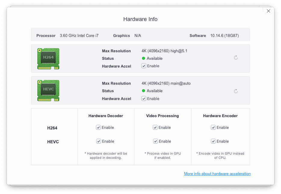

AudioGod Posted August 8, 2019 Share Posted August 8, 2019 (edited) 2 hours ago, texem said: thanks for reply Your are right, fiddeling with 19.1 is wasting time here. So following your hints I am back to iMacPro1,1 SMSBIOS but anyway I enabled the iGPU. It' working stable and acceleration is available. F10 BIOS settings are slightly different here ( ErP and Platf.Power Management disabled, iGPU enabled, XMP Profile 1). No issues , best benchmarks results. have you rewritten in the igpu properties into clover? the igpu won’t be working correctly if you haven’t and your need to use 19.1 for the same reason. i don’t think you have it setup correct buddy but I could be wrong. Does sleep work with your current settings and it’s not waking to a dark display? Theres plenty of convos on this thread about this very subject so please take a moment to look though and double check everything. @larabee didn’t you run this very same test to try this for @glasgood? Edited August 8, 2019 by AudioGod Link to comment https://www.insanelymac.com/forum/topic/337837-glasgoods-macos-mojave-successguide-for-aorus-z390-pro/page/53/#findComment-2685020 Share on other sites More sharing options...

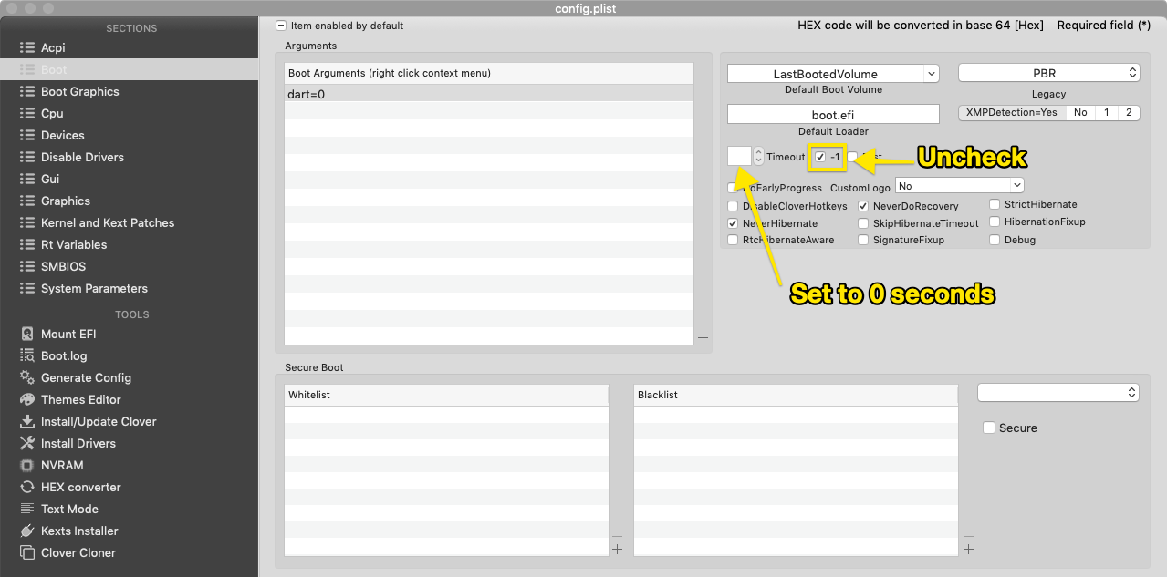

panosru Posted August 8, 2019 Share Posted August 8, 2019 (edited) Hello! Today I upgraded clover to r5033 and flashed by BIOS from F8 to F10, also used the latest EFI by @glasgood (attached) So far the issues that I'm facing are: Major: 1. When I boot my computer I have to select the disk in Clover from where it will boot the OS 2. USB 3 ports are not working, only USB 2 Minor: 1. While on Hardware info from videoproc app it recognises Intel Core i7, everywhere else it says Intel Core i9 2. I tried to check if hardware acceleration works with videoproc app, and I noticed that now it does not detects my Graphics card, although it seems to work Before: Current: What changes should I make in order to fix the above issues? Thank you in advance!!! EFI.zip Edited August 8, 2019 by panosru Link to comment https://www.insanelymac.com/forum/topic/337837-glasgoods-macos-mojave-successguide-for-aorus-z390-pro/page/53/#findComment-2685070 Share on other sites More sharing options...
larabee Posted August 8, 2019 Share Posted August 8, 2019 7 hours ago, AudioGod said: have you rewritten in the igpu properties into clover? the igpu won’t be working correctly if you haven’t and your need to use 19.1 for the same reason. i don’t think you have it setup correct buddy but I could be wrong. Does sleep work with your current settings and it’s not waking to a dark display? Theres plenty of convos on this thread about this very subject so please take a moment to look though and double check everything. @larabee didn’t you run this very same test to try this for @glasgood? I've run many tests with iMac 19,1 vs iMac PRO. Please stick with iMac Pro for the best performance and stability with Glasgood new EFI. I have better benchmark, exporting faster and gains at least 8-9 fps in openGL games and metal performance is about 15% better. Link to comment https://www.insanelymac.com/forum/topic/337837-glasgoods-macos-mojave-successguide-for-aorus-z390-pro/page/53/#findComment-2685093 Share on other sites More sharing options...

texem Posted August 8, 2019 Share Posted August 8, 2019 8 hours ago, AudioGod said: have you rewritten in the igpu properties into clover? the igpu won’t be working correctly if you haven’t and your need to use 19.1 for the same reason. i don’t think you have it setup correct buddy but I could be wrong. Does sleep work with your current settings and it’s not waking to a dark display? Theres plenty of convos on this thread about this very subject so please take a moment to look though and double check everything. @larabee didn’t you run this very same test to try this for @glasgood? should be ok with iGPU, VideoProc shows CPU GFX accel., VDADecoderChecker = ok .. what else ? Sleep is working perfectly. One thing I changed in Clover is adding darkwake=0, w/o it the screen appears only after a second mouse klick or BT trackpad after wake. I am using the compatible Broadcom PCIe card , Airdrop and BT is fully working --- btw: with DSDT-EFI got an unresolvable issue on a second machine I'm currently setting up. Identical hardware, same mobo, but the diff is a i7-8600K CPU and Sapphire 560, not 580 . Thought it's easy going using same Clover with EFI from the i9 setup with DSDT, clearing CMOS, configure same F10 BIOS with identical fresh BIOS settings after battery remove etc etc but no chance, system behaves strange (hangs during boot early). Clover "F11" does not help .. some un-initialized things or wrong access to native NVRAM ?! So currently no luck with DSDT EFI on this machine , only the "classic" RX580 Version is running without issues. Link to comment https://www.insanelymac.com/forum/topic/337837-glasgoods-macos-mojave-successguide-for-aorus-z390-pro/page/53/#findComment-2685112 Share on other sites More sharing options...
hackinbot Posted August 8, 2019 Share Posted August 8, 2019 4 hours ago, panosru said: Hello! Today I upgraded clover to r5033 and flashed by BIOS from F8 to F10, also used the latest EFI by @glasgood (attached) So far the issues that I'm facing are: Major: 1. When I boot my computer I have to select the disk in Clover from where it will boot the OS 2. USB 3 ports are not working, only USB 2 Check your boot timeout settings: For testing USB 3 ports - you must use a USB3 device. The USB3 ports are not backwards compatible with USB2 with these SSDT/DSDTs. Have you tried a USB3 device in the USB3 ports? Link to comment https://www.insanelymac.com/forum/topic/337837-glasgoods-macos-mojave-successguide-for-aorus-z390-pro/page/53/#findComment-2685113 Share on other sites More sharing options...
panosru Posted August 8, 2019 Share Posted August 8, 2019 @hackinbot Thank you for your reply! I will try now your suggestion about the timeout, in regards to the USB 3, I believe the devices I'm testing are USB3, except of the web cam, all other cables have blue colour inside the plug and they are brand new. Link to comment https://www.insanelymac.com/forum/topic/337837-glasgoods-macos-mojave-successguide-for-aorus-z390-pro/page/53/#findComment-2685115 Share on other sites More sharing options...
hackinbot Posted August 8, 2019 Share Posted August 8, 2019 13 minutes ago, larabee said: I'm using Wacom Intuos Pro on my hack and it's working perfectly fine. Not a source of any issue with the latest driver. Another note on iGPU, as long as you have any thing newer than a rx580, you can rest assure that they are more powerful and faster than any intel iGPU , so iGPU is no longer needed. Ok, good to know. I'll plug the tablet back in tomorrow. I'd like to enable the iGPU because it could give me a third display since I can only get the 2 DisplayPorts working on my RX580. Link to comment https://www.insanelymac.com/forum/topic/337837-glasgoods-macos-mojave-successguide-for-aorus-z390-pro/page/53/#findComment-2685116 Share on other sites More sharing options...
texem Posted August 8, 2019 Share Posted August 8, 2019 13 minutes ago, hackinbot said: You have an iMacPro1,1 SMBIOS + enabled iGPU setup working? Can you post a zip of your EFI/CLOVER/DRIVERS folder? I'm curious how you got it working without having to use OsxAptioFix2Drv-free2000.efi enclosed my EFI, enter your own SN and UUID in config.plist Let us hear about if it works for you. EFI.zip Link to comment https://www.insanelymac.com/forum/topic/337837-glasgoods-macos-mojave-successguide-for-aorus-z390-pro/page/53/#findComment-2685118 Share on other sites More sharing options...
tasc Posted August 8, 2019 Share Posted August 8, 2019 5 minutes ago, hackinbot said: Ok, good to know. I'll plug the tablet back in tomorrow. I'd like to enable the iGPU because it could give me a third display since I can only get the 2 DisplayPorts working on my RX580. I'd be surprised if that worked reliably without the free2000 memory driver. It seems the other memory drivers don't like it when the iGPU is enabled on our boards. Also since real iMacPro doesn't have an iGPU, enabling it might be inviting something else to go wrong, but who knows. @AudioGod did you ever get your build sorted out? Are you up and running on a new DSDT? Did you require an SSDT as well? If so, can you post it because I want to compare the 3 DSDTs we have so far for this board. Link to comment https://www.insanelymac.com/forum/topic/337837-glasgoods-macos-mojave-successguide-for-aorus-z390-pro/page/53/#findComment-2685123 Share on other sites More sharing options...
panosru Posted August 8, 2019 Share Posted August 8, 2019 @hackinbot the timeout config fixed the clover boot issue, but for the USB3 I couldn't figure out what is wrong, I have a few USB3 devices, including my DAS Professional 4 keyboard for Mac. My drives are working on USB 3 ports, some USB2 devices that I have (gaming mouse, webcam, wacom tablet) are not working on USB3 port, my USB3 hub also is not working for some reason and my DAS Keyboard is also not working... I will revert back to my old EFI because not having backwards compatibility with USB3 is a deal breaker for me. Thanks! Link to comment https://www.insanelymac.com/forum/topic/337837-glasgoods-macos-mojave-successguide-for-aorus-z390-pro/page/53/#findComment-2685126 Share on other sites More sharing options...
