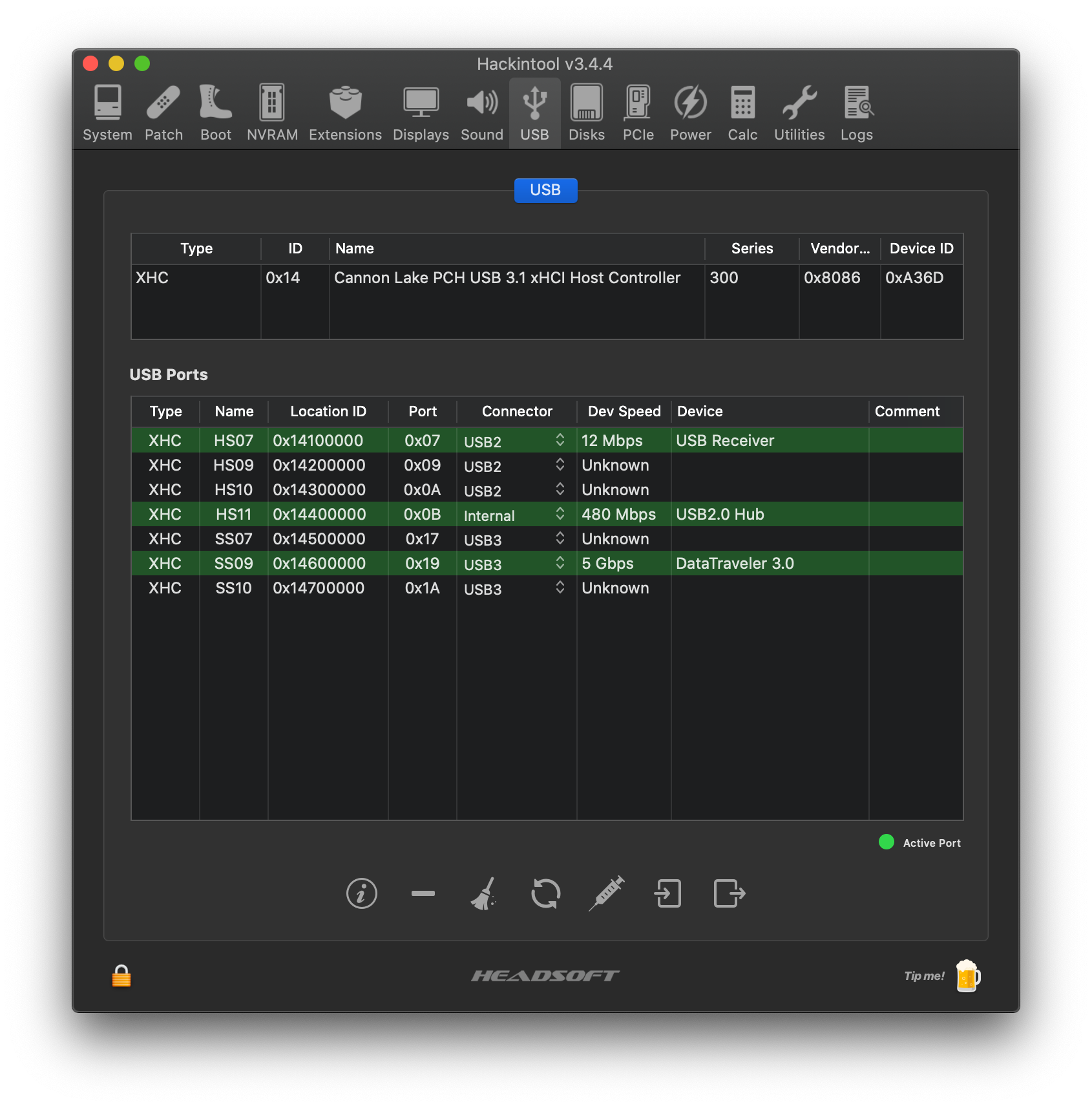

1029458883_ScreenShot2020-08-04at1_23_45AM.thumb.png.8d8813f141fad2174effc899f89d12ea.png
Here is what a healthy port map looks like. There are two ports beside the Ethernet port on the back of this board. I have the farthest one away mapped. You can see my mouse is plugged into that one. Most mice, even modern ones are typically USB2.0. Then I have the internal hub where my BT/WiFi card is mounted to. Lastly, the two case USB ports are mapped and you can see my USB3.0 stick mounted into one (HS09 is the one of the left, HS10 is the one on the right).

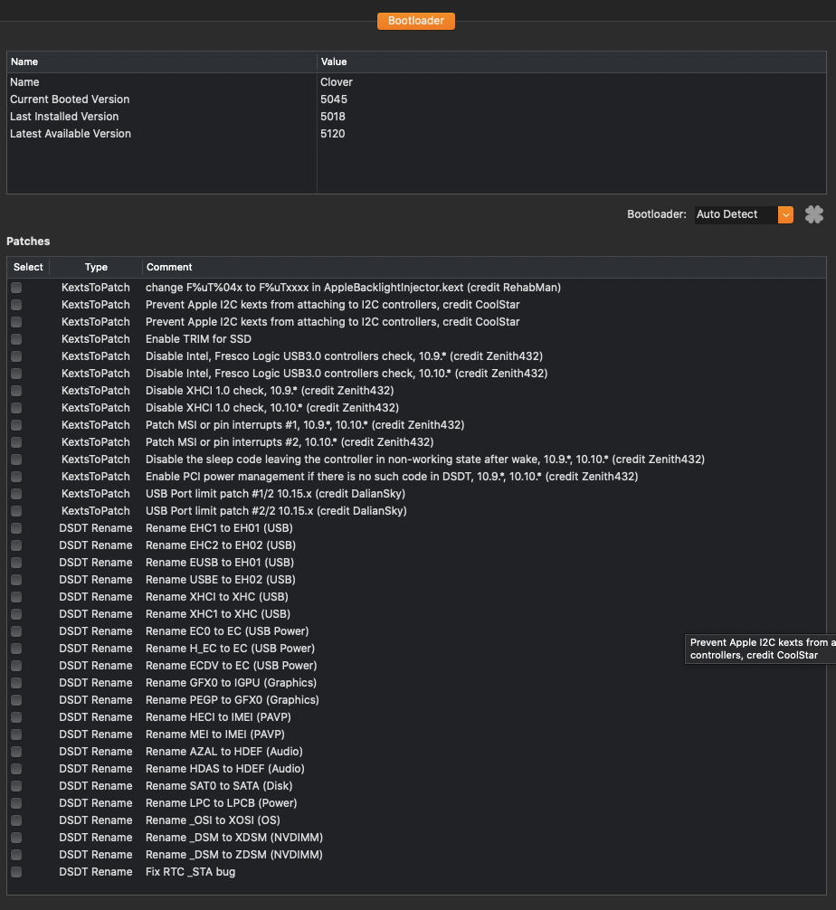

Hello all!
I was long time away, so I'm still at 10.15 (19A602)
Tried to read all  the older post, but please be nice with me :)
I want to upgrade to upgrade to latest 10.15.6
What is the safer way to do it?
Can I start updating kexts and clover (while I'm still on 10.15) ?
Whats the best and safer way to update clover?
I'm still on BIOS F10
thank you!
