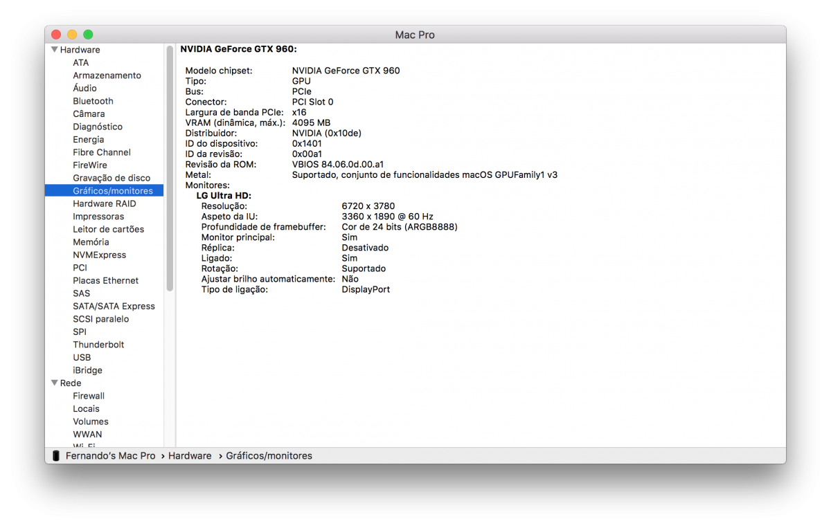

4K graphics by DP but still only with Web Driver 104 or 106 ?
