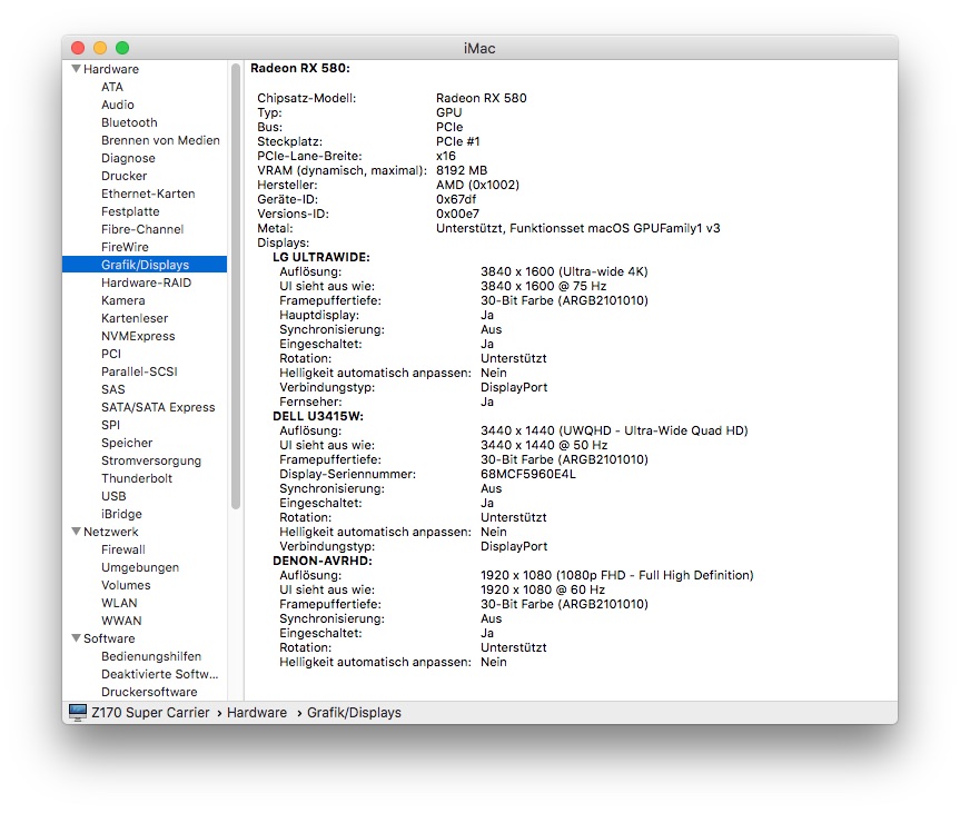

I Could confirm, that with macOS 10.13.4 beta1 my AMD Radeon RX480 don't need any WhatEverGreen-, RadeonDeInit- or Miezi-patch anymore.
Got full initialization, no Blackscreen during boot, fully multimonitorsupport at real "out-of-the-box":
I didn't even set "inject ATI = true" in config.plist. Only need my GFX-SSDT to inject HDMI sound. Nothing else. And of cause Framebufferpatch to get the correct FB detected.

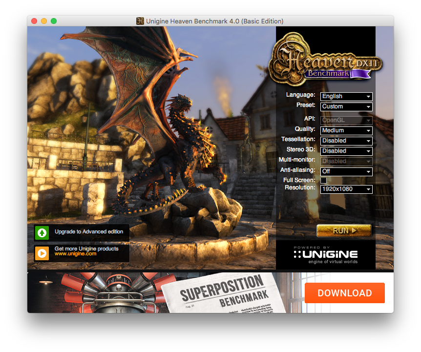

EDIT#2: did a test - running HEAVEN Benchmark tool with just the Apple Driver and settings as posted in the attached screenshot gives 55 FPS. Same benchmark with only the Apple Drivers but Miezie-Patch edit back into SSDT gives 90 FPS !!!

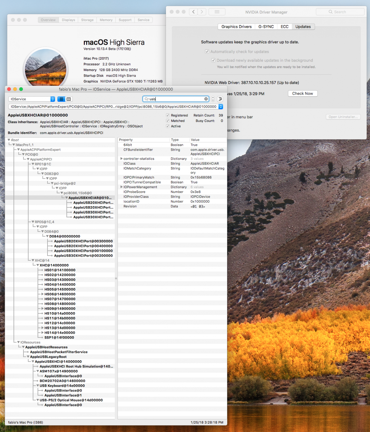

Has anybody tried removing the USB patch totally?
Mine seems fine without USB patch but I don't have a USB 3 or 3.1 external drive to test speeds.
All USB is working.
All USB is working.

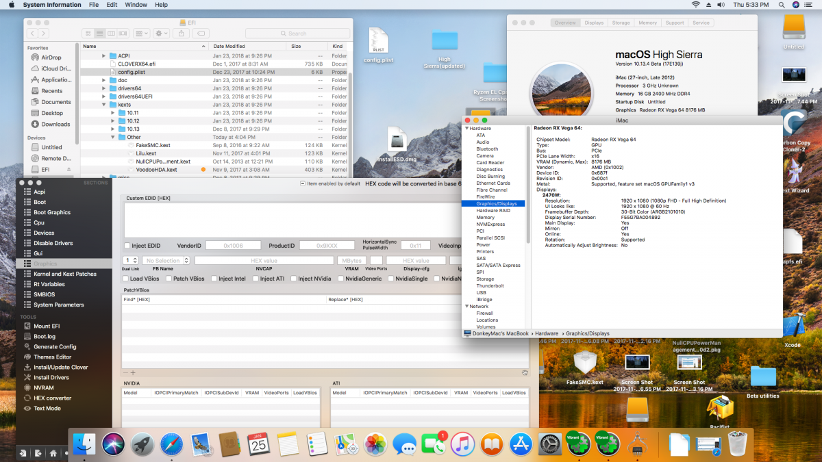

My Vega 64 is working with Family V3 on Ryzen CPU setup, this is a first.    No WhateverGreen or rad de init it has proper naming but fan still running fast at idle.
My Vega 64 is finally able to idle without the fans sounding like a jet engine.  My x299 system is water cooled so it's the only audible thing in my case since it still has the reference air cooler shroud on it.  Sadly I too have the single DP port that's working along with the HDMI.  Fortunately I only have 2 monitors working but would like to get a third at some point down the road.
