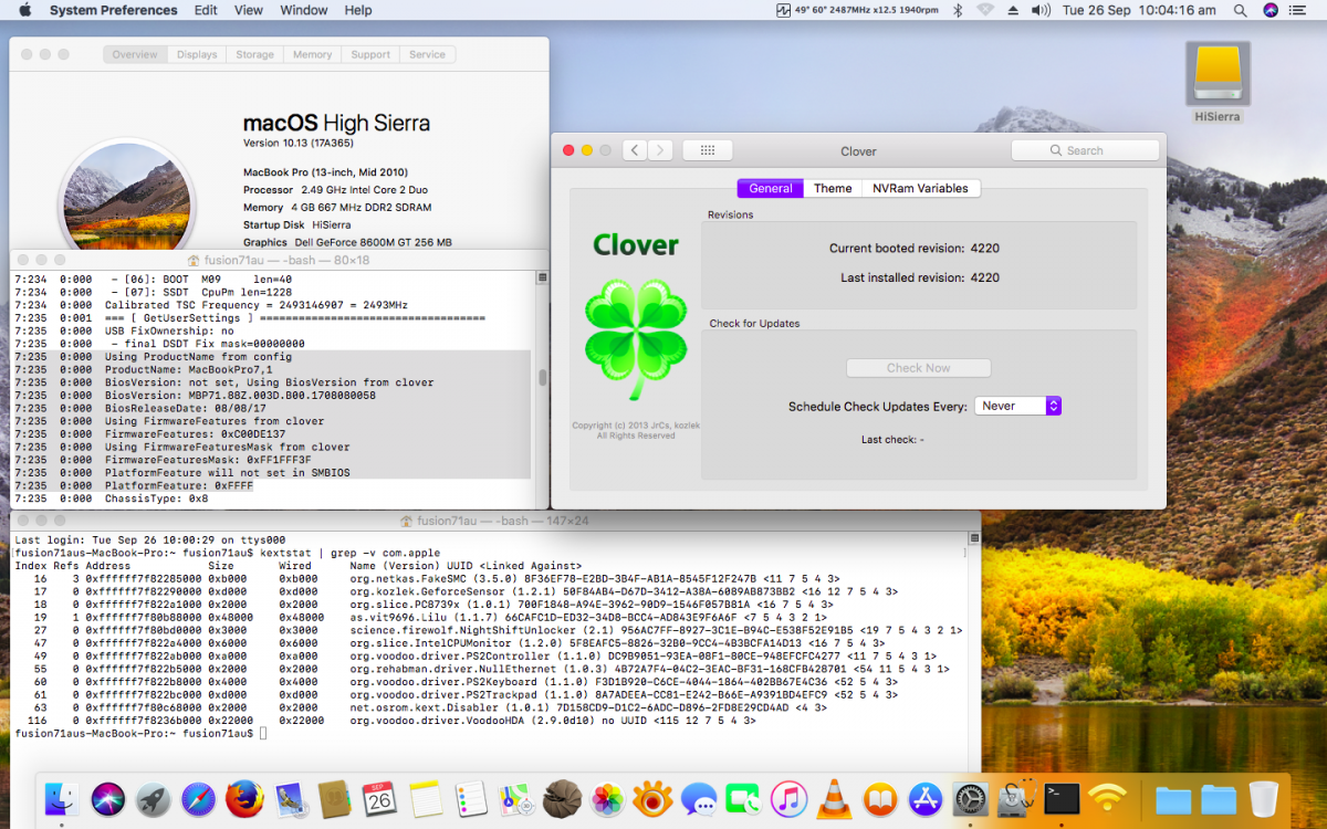

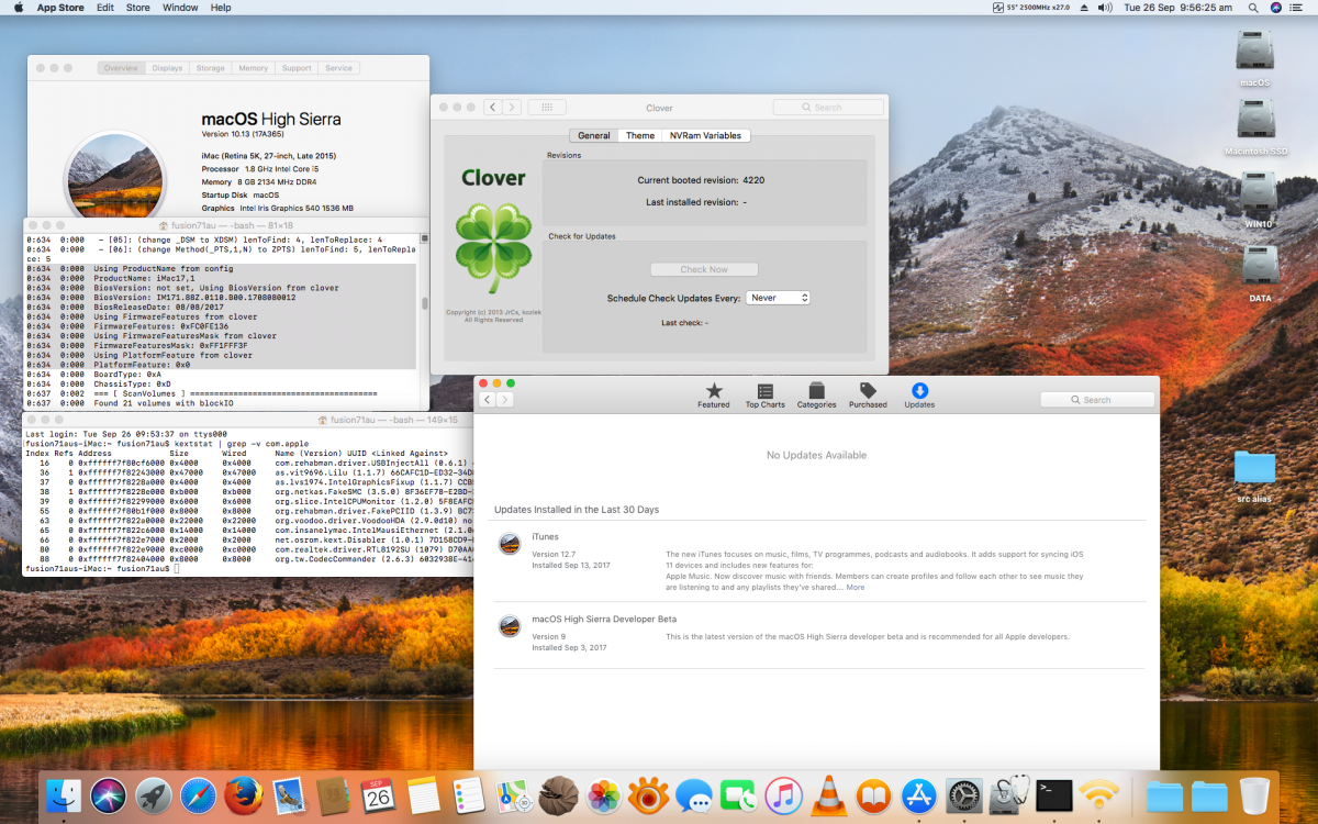

fusion71au Posted September 25, 2017 Share Posted September 25, 2017 Hi Guys, Successfully updated both my desktop systems and my Dell XPS M1530 notebook to High Sierra Release - 10.13_17A365 . 1. GA-P55aUD3 with legacy BIOS/Intel i5-750/ATI HD5770/HFS+ HDD 2. Skylake NUC6i5SYH with UEFI/Intel i5-6260U/Iris 540/APFS SSD 3. Dell XPS M1530 legacy BIOS/Intel T9300/Geforce 8600M GT/HFS+ Ext HDD Installation Notes "Install macOS High Sierra.app" v 13.0.64 run directly from Applications folder for upgrade install of existing GM_17A362a Updated to latest Clover r4220, Clover injected default values for FF/FFM/PF and BIOS ver/date/Board-ID data (iMac11,3, iMac17,1, MBP7,1) --> avoid error while "verifying firmware" Latest apfs.efi driver in /EFI/CLOVER/drivers64 or /EFI/CLOVER/drivers64UEFI (only needed if APFS target volume) Removed NVRAM.plist files from all EFI partitions (incl USB drives), ran sudo NVRAM -c command in terminal to reset NVRAM prior to update On my Skylake NUC, I don't need or use EmuVariableUefi-64 ---> avoid OSInstall.mpkg damaged/missing error If upgrading existing OS X on HDD, HFS+ is preserved (on SSD HFS+ will be converted automatically to APFS) Certain SATA controllers will still have issues with AppleAHCIPort v329 (eg ICH10, 5 series, 7 series, ASMedia 1061) ---> Disks may fail to initialize, not readable or hot plug may fail. AppleAHCIPort.kext v328 with version bundle 999.1.1 survives upgrade if installed in /L/E, and is loaded in preference to v329 A windows disk present on the machine during installation is OK. Update 30 Sep 2017 @SunKi has discovered a patch for AppleAHCIPort.kext that fixes the SATA issues described above. This can be applied in Clover config.plist/KextsToPatch... <dict> <key>Comment</key> <string>fix IO error ICH10 for 10.13, credit SunKi</string> <key>MatchOS</key> <string>10.13.x</string> <key>Disabled</key> <false/> <key>Name</key> <string>AppleAHCIPort</string> <key>Find</key> <data>RYX2D5XCiciD4P5mhcl4D4TSdQs=</data> <key>Replace</key> <data>iciD4P5mhckPmMFBCMyQkJCQdQs=</data> </dict> Clover_v2.4k_r4221.zip apfs_17A365.efi.zip 9 Link to comment https://www.insanelymac.com/forum/topic/327488-macos-high-sierra-final-release-is-out-17a365/page/2/#findComment-2500583 Share on other sites More sharing options...

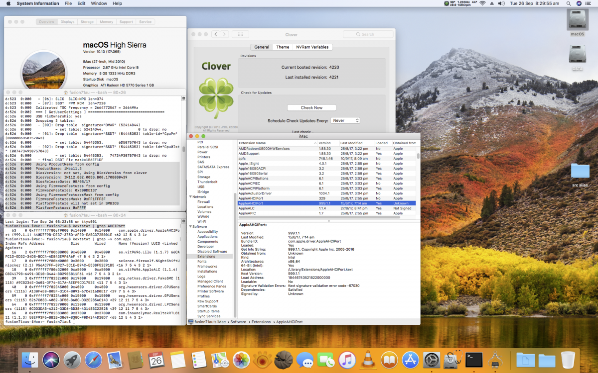

Sherlocks Posted September 26, 2017 Share Posted September 26, 2017 Hi Guys, Successfully updated both my desktop systems and my Dell XPS M1530 notebook to High Sierra Release - 10.13_17A365 . 1. GA-P55aUD3 with legacy BIOS/Intel i5-750/ATI HD5770/HFS+ HDD HS_17A365 on GAP55aUD3, Clover r4220.png 2. Skylake NUC6i5SYH with UEFI/Intel i5-6260U/Iris 540/APFS SSD HS_17A365 on NUC6i5SYH, Clover r4220.png 3. Dell XPS M1530 legacy BIOS/Intel T9300/Geforce 8600M GT/HFS+ Ext HDD HS_17A365 on XPS M1530, Clover r4220.png Installation Notes "Install macOS High Sierra.app" v 13.0.64 run directly from Applications folder for upgrade install of existing GM_17A362a Updated to latest Clover r4220, Clover injected default values for FF/FFM/PF and BIOS ver/date/Board-ID data (iMac11,3, iMac17,1, MBP7,1) --> avoid error while "verifying firmware" Latest apfs.efi driver in /EFI/CLOVER/drivers64 or /EFI/CLOVER/drivers64UEFI (only needed if APFS target volume) Removed NVRAM.plist files from all EFI partitions (incl USB drives), ran sudo NVRAM -c command in terminal to reset NVRAM prior to update On my Skylake NUC, I don't need or use EmuVariableUefi-64 ---> avoid OSInstall.mpkg damaged/missing error If upgrading existing OS X on HDD, HFS+ is preserved (on SSD HFS+ will be converted automatically to APFS) Certain SATA controllers will still have issues with AppleAHCIPort v329 (eg ICH10, 5 series, 7 series, ASMedia 1061) ---> Disks may fail to initialize, not readable or hot plug may fail. AppleAHCIPort.kext v328 with version bundle 999.1.1 survives upgrade if installed in /L/E, and is loaded in preference to v329 A windows disk present on the machine during installation is OK. Do you have itune crash(randomly) on your NUC6i5SYH? I'm gathering reason about itunes crash. I suspect igpu driver or something 나의 LG-F800S 의 Tapatalk에서 보냄 iTunes always crash crash and crash. 6700HQ+HD530 8250U+UHD620 This two have same problem when open the itunes and forceclsed. But the 2410m+HD3000 with no crash with iTunes. 从我的 iPhone 发送,使用 Tapatalk What is your platformid for uhd620?Empty with lastest clover? 나의 LG-F800S 의 Tapatalk에서 보냄 Link to comment https://www.insanelymac.com/forum/topic/327488-macos-high-sierra-final-release-is-out-17a365/page/2/#findComment-2500636 Share on other sites More sharing options...

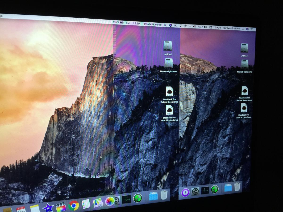

TombaFI Posted September 26, 2017 Share Posted September 26, 2017 Sleep mode issue. Anybody else got this behaviour? Laptop Yoga 710IKB. Everything else is working as it should, and only problem is duplicate screen at the right side. Hdmi out is working (wake after sleep) and the problem is not related to it! This problem existed at previous beta versions too, and I hoped it would be fixed HS final release. But it’s still there… Anyone? High Sierra related bug? Link to comment https://www.insanelymac.com/forum/topic/327488-macos-high-sierra-final-release-is-out-17a365/page/2/#findComment-2500748 Share on other sites More sharing options...
