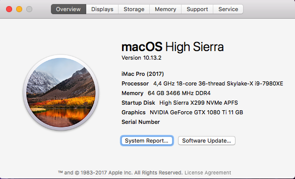

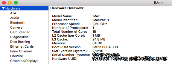

kgp Posted December 31, 2017 Share Posted December 31, 2017 World's first iMac Pro Hackintosh 3 Link to comment https://www.insanelymac.com/forum/topic/327488-macos-high-sierra-final-release-is-out-17a365/page/17/#findComment-2559148 Share on other sites More sharing options...
