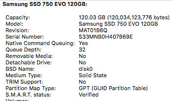

Morpheus NS Posted October 8, 2017 Share Posted October 8, 2017 How do you guys enable trim on High Sierra with APFS? And do you? I've read about some problems (long boot?) if trim command is used in Terminal, so I am still running my APFS SSD without it. Link to comment https://www.insanelymac.com/forum/topic/327488-macos-high-sierra-final-release-is-out-17a365/page/12/#findComment-2511376 Share on other sites More sharing options...
MICKHAEL Posted October 8, 2017 Share Posted October 8, 2017 How do you guys enable trim on High Sierra with APFS? And do you? I've read about some problems (long boot?) if trim command is used in Terminal, so I am still running my APFS SSD without it. TRIM enabled by default.. maybe just on nvme Link to comment https://www.insanelymac.com/forum/topic/327488-macos-high-sierra-final-release-is-out-17a365/page/12/#findComment-2511377 Share on other sites More sharing options...
Morpheus NS Posted October 8, 2017 Share Posted October 8, 2017 I guess it's just NVMe... Link to comment https://www.insanelymac.com/forum/topic/327488-macos-high-sierra-final-release-is-out-17a365/page/12/#findComment-2511385 Share on other sites More sharing options...
MorenoAv Posted October 8, 2017 Share Posted October 8, 2017 Nope, my ssd is a crucial mx300 and I have no trim... Link to comment https://www.insanelymac.com/forum/topic/327488-macos-high-sierra-final-release-is-out-17a365/page/12/#findComment-2511389 Share on other sites More sharing options...
Morpheus NS Posted October 8, 2017 Share Posted October 8, 2017 Thank you, @fabiosun , solved! Link to comment https://www.insanelymac.com/forum/topic/327488-macos-high-sierra-final-release-is-out-17a365/page/12/#findComment-2511398 Share on other sites More sharing options...

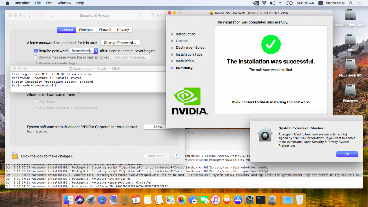

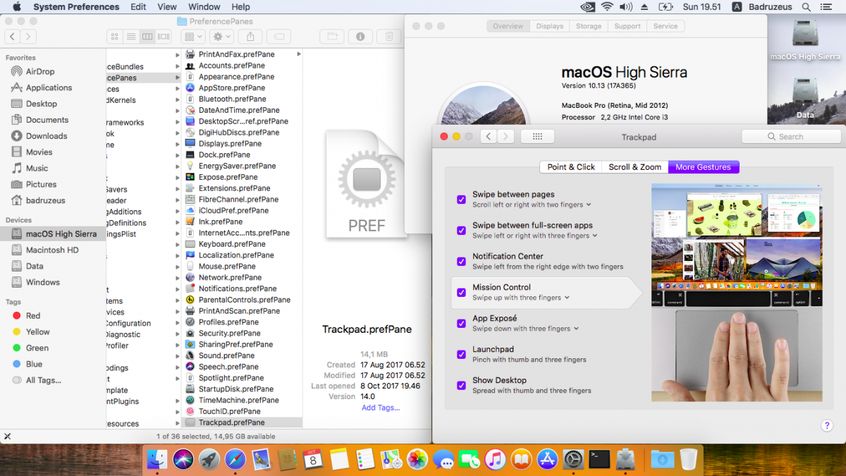

Badruzeus Posted October 8, 2017 Share Posted October 8, 2017 Someone told me that "We are in a great Forum, so, let's have some fun and learn from each other!" So, I wanna share my stories after re-installing APFS-10.13 (17A365) with SIP: Enabled from pre- till post-install succeeded: 1. Installer: (OFC) a Retail macOS 10.13 downloaded from Mac App Store. USB Installer using createinstallmedia or Boot Buddy (GUI) 2. Bootloader: Using Legacy Clover v2.4k r4243 w/o rc.script I got no "OSInstall.mpkg" missing / corrupted error again, though with "RecoveryHD" environment looks a like installation UI with no Languages selection chooser as a greeting. For SMBios is MBP10,1 with default values generated by Clover Configurator v4.5.3. And still same since DP1, I removed nvram.plist found from all my partitions before proceeding (there're already another OSes installed on a single Disk) 3. Graphics: My Nvidia Fermi GF119 however has known issue with random windowserver crash since 10.12 using native / web driver, though QE/CI was enabled. I then tried reconfiguring it using Web Driver with SIP: Enabled (no longer need for NVWebValidationFix) and yeah, same crash with non-native display resolutions but get much better: my crazy cursor behavior has gone! Oh wait, just a little bit problem with abnormal logoff-reboot-shutdown except replacing NVDAResman.kext with DP1 has (for sure, not applied for web driver). It works well on 10.11.x as my daily use with InjectNvidia=True/False or with GFX0 Graphics personalities within my patched DSDT, just forget it under newer macOS versions. 4. TouchPad (PS2 ELAN_101): This is I think, the funny part or maybe sounds illogical... using EmlyDinesh's ApplePS2SmartTouchpad v4.7 b5 since 10.13 DP1 I got a blank trackpad under Preferences, my TP however still detected as a mouse (previously was using 10.11.6's trackpad.Pref for temp solution to work). At the first time reaching the Desktop after did a clean install, I then accidentally connected my USB Mouse to the port and voilaaa... my TP Pref no longer became blank and all features are back again automatically illogically..!!! I think I loss my mind, then turning my wifi on.. and yes, now get motion video guides on TP Pref. 5. Battery: Using @Slice's FakeSMC v3.5.0 and VoodooBattery v1.4.2 the indicator shown on Apple Menu Bar. My another devices fortunately (as seen on sig), just work except AR3011 BT, known incompatible RTL-CardReader, WebCam works with CamTwist, but.. aah, NP. That is guys for my "stories", not a successful guide nor even tutorial so.., if U don't mind just simply, ignore it..!!! . This concludes my 17A365 (I mean, on my mach) before updating to 17A405 and going to be 'crazy' again, happily. #EDIT: Plz note regarding to SIP: Enabled, I only use this on Legacy..!!! 3 Link to comment https://www.insanelymac.com/forum/topic/327488-macos-high-sierra-final-release-is-out-17a365/page/12/#findComment-2511496 Share on other sites More sharing options...
Cyberdevs Posted October 8, 2017 Share Posted October 8, 2017 @Badruzeus Can you please tell me the value of the CsrActiveConfig that you are using? I assume by "SIP:Enabled" you are referring to that config. Right? 1 Link to comment https://www.insanelymac.com/forum/topic/327488-macos-high-sierra-final-release-is-out-17a365/page/12/#findComment-2511497 Share on other sites More sharing options...
Cyberdevs Posted October 8, 2017 Share Posted October 8, 2017 With pleasure... Thanks a lot man unfortunately I ran out of my quota for positive votes Link to comment https://www.insanelymac.com/forum/topic/327488-macos-high-sierra-final-release-is-out-17a365/page/12/#findComment-2511506 Share on other sites More sharing options...

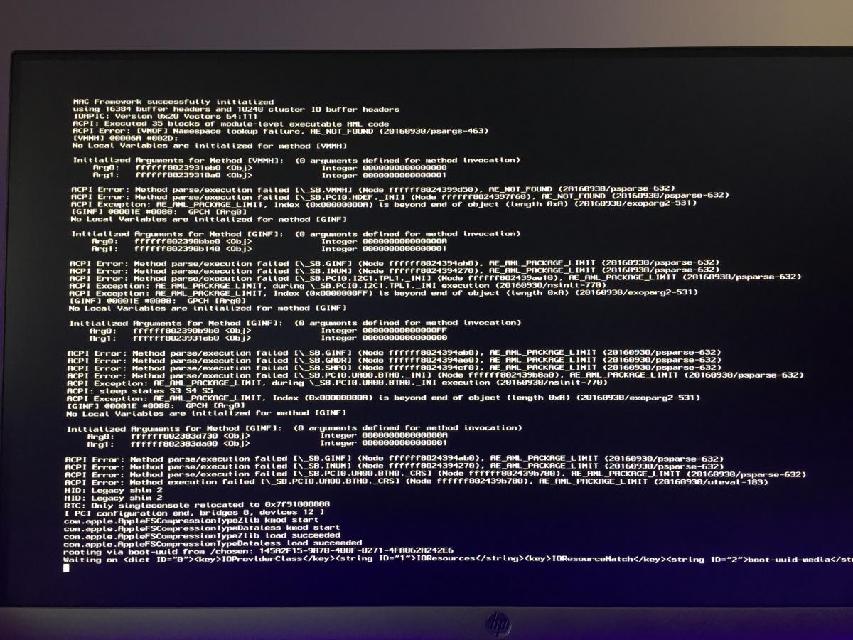

Morpheus NS Posted October 12, 2017 Share Posted October 12, 2017 My High Sierra installation suddenly stopped working this morning. I get only the stop sign, verbose mode shows this: followed by “Still waiting for root device”. It doesn’t matter how I try to boot, from SSD or USB... any suggestions? Link to comment https://www.insanelymac.com/forum/topic/327488-macos-high-sierra-final-release-is-out-17a365/page/12/#findComment-2514526 Share on other sites More sharing options...
MICKHAEL Posted October 12, 2017 Share Posted October 12, 2017 My High Sierra installation suddenly stopped working this morning. I get only the stop sign, verbose mode shows this: 736D62F8-DF22-4F06-843D-E135CCF8F63D.jpeg followed by “Still waiting for root device”. It doesn’t matter how I try to boot, from SSD or USB... any suggestions? check ACPI bios settings. Link to comment https://www.insanelymac.com/forum/topic/327488-macos-high-sierra-final-release-is-out-17a365/page/12/#findComment-2514529 Share on other sites More sharing options...
