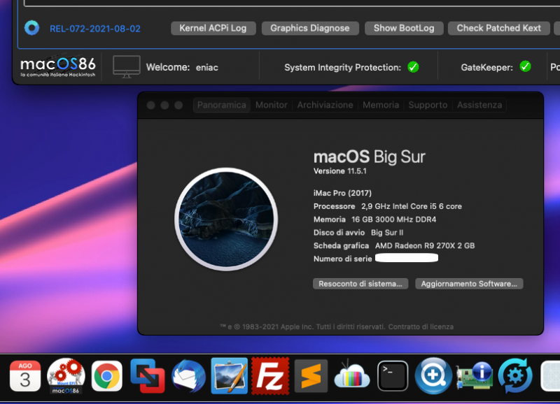

I have a problems whit Whatevergreen version 1.5.2 .
With this version i don't have hardware acceleration though  the GPU is recognized exactly ,  on OC 0.7.0 - 0.7.1 and 0.7.2
My graphics card is R9 270 2gb
With whatevergreen versione 1.5.1 it's work fine.
107182674_Schermata2021-08-03alle10_27_12.thumb.png.f220cb183aabc1de63f30a07eec0e1e9.png
Edited by Eniac
add image

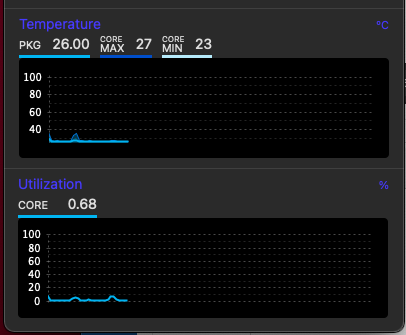

Don't you have the problem with igfxrpsc=1 , where igpu frequency stays on max after sleep?
@matgeo No.  Sleep/Wake still works perfectly with igfxrpsc=1 (no different than without).
before sleep with igfxrpsc=1
Spoiler
after sleep with igfxrpsc=1
Spoiler
Edited by tonyx86

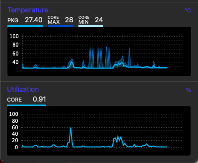

  Hide contents
  Hide contents

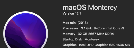

For those using DP->DVI video adapters with their iGPUs (CFL UHD630 in my case), in order to run Monterey 12.1, I needed to change my patched connector types from dual-link DVI (<04000000>) to HDMI (<00080000>).  My rig would boot 12.1 to black screens with connector types set to DVI.  When I first started patching the HP EliteDesk 800 G4 Mini (and now G5 Mini), guides at the time indicated that video converters/adapters were not supported.  Through brute force experimentation, I found only connector type dual-link DVI would enable my rig's displays with DP->DVI adapters.  I continued to use patched connector type DVI for Catalina and Big Sur.  Now, with Monterey, I need to switch to HDMI connector types to enable my displays with DP->DVI adapters.
My rig is documented here.  Note that the only change I need to make for Monterey 12.1 is the patched connector type.  The rest of my posted OC 0.7.6 EFI remains unchanged.
EDIT: Note that in order to use DP->DVI video adapters with my CFL UHD630 iGPU, I must use a "mobile" framebuffer (I'm using AAPL,ig-platform-id 0x3E920000).  A "desktop" framebuffer (e.g., AAPL,ig-platform-id 0x3E9B0007) with DP->DVI video adapters results in booting to black screens on my rig.  This has been true for as long as I have been patching my HP EliteDesk 800 G4/G5 Minis.
About This Mac: Monterey 12.1
Spoiler
Edited by tonyx86
