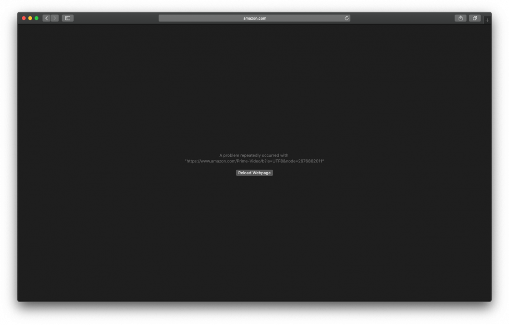

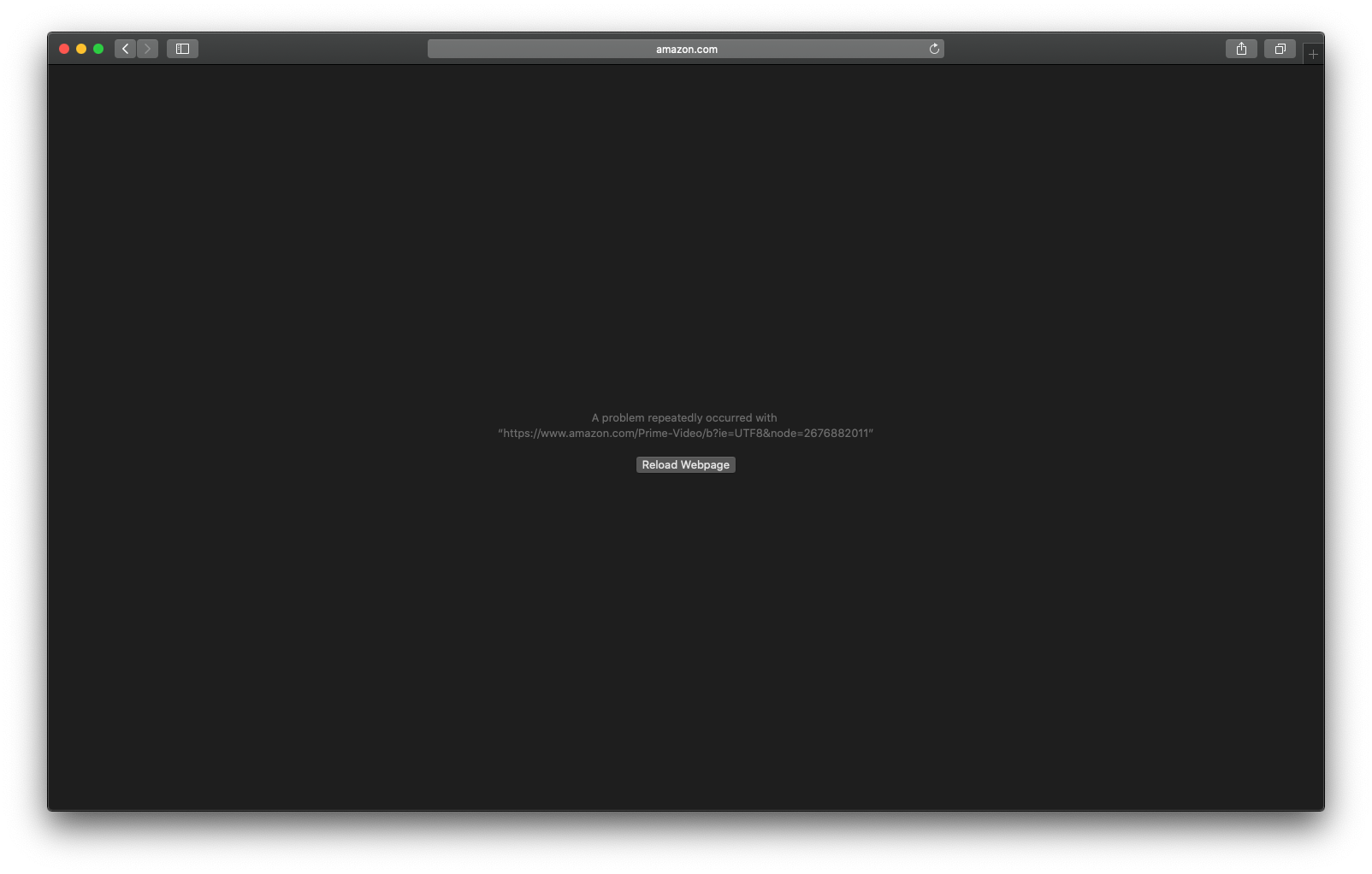

Since a lot of people are complaining about Netflix working but Amazon Prime Video Crashing but as far as I've seen no one is uploading crash reports so here is one:
This is the WebKit crash when trying to watch an Amazon Prime Video:
com.apple.WebKit.WebContent_2020-01-31-181054-1_iMac.crash
I get the same problem... iMac19,2 SMBIOS with iGPU set as headless, macOS 10.15.4, WEG 1.3.7 with boot-arg: shikigva=80
GPU: RX 5700
Netflix on Safari working but Amazon Prime Video crashing

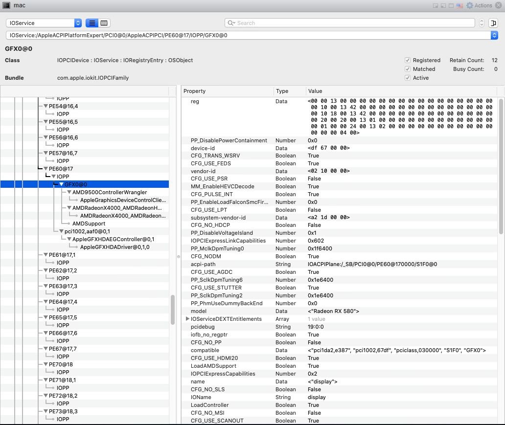

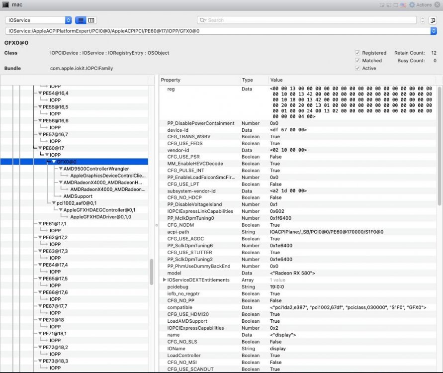

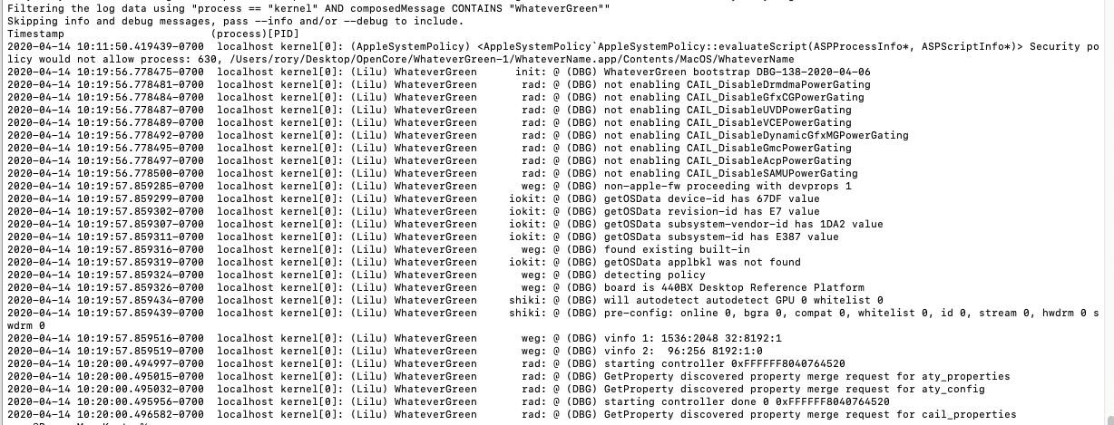

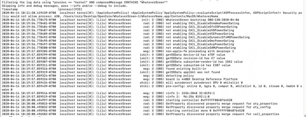

I'm new to WhateverGreen and trying to debug a problem with an unusual configuration...
Background: GPU passthru for ESXi has been broken since Mojave, I am trying to see if a combination of OpenCore and WhateverGreen can fix this.
System : Dell server with E5-2600 V3 series processors, ESXi 6.7u3, unlocker 3.0,  AMD RX580 video card. As a baseline I configured passthru for a windows 10 client and it works perfectly...
Step 1: Configure a Catalina 10.15.4 guest with passthru: system information lists the "display" adapter as a GPU on PCIe, correctly shows vendorID and board ID. Does not detect attached monitor and no video output.
Step2: Install OpenCore, Lilu, and WhateverGreen. System boots to OpenCore boot picker, after timeout or hitting enter the system boots to Catalina. System information now shows "Radeon RX 580" GPU on PCIe, but again does not detect attached monitor and no video output.
Step 3: enabled WhateverGreen debug output. See attached logs. Any help/pointers on what is going on wrong would be appreciated.

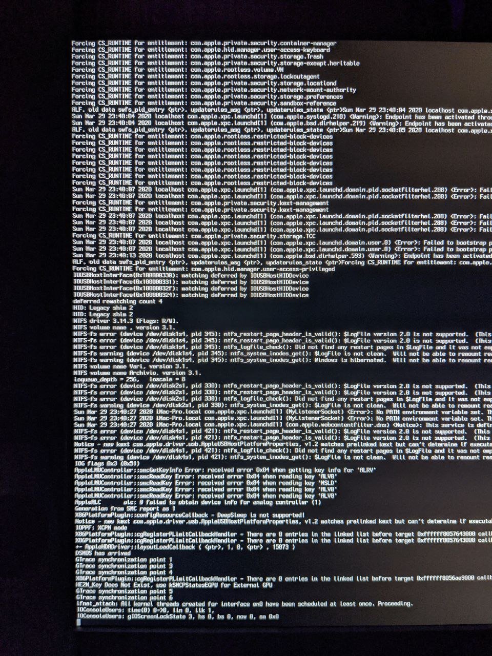

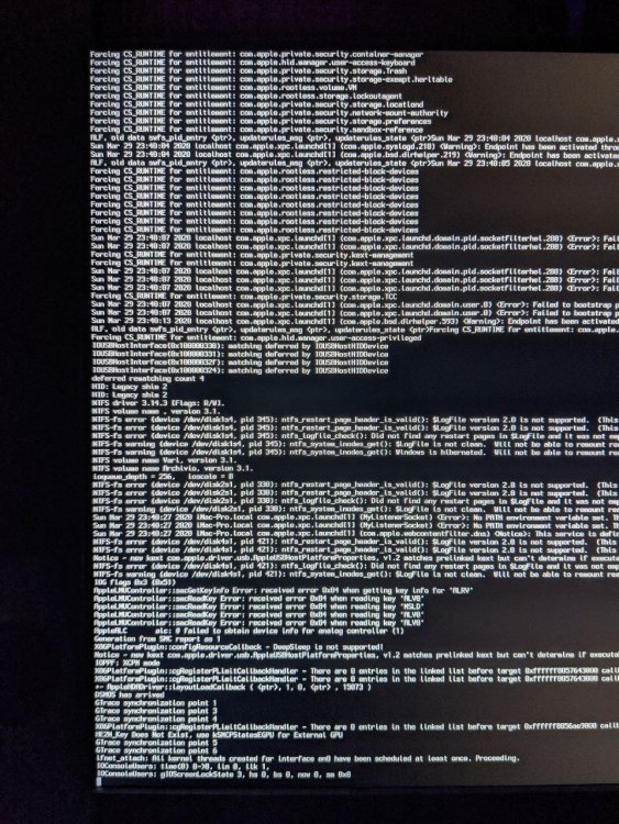

Hi,
I'm getting black screen after 2nd boot during installation, I can get to the install screen, choose SSD, Apple Logo takes 8 mins, then the screen goes black for 5 mins and then the computer shutdown. When i start back up i belive it's going through the 2nd install part of the installation but i can't see anything.
I went through a similar thing with clover when i installed 10.13.6 ages ago, i think it was fixed with VegaGraphicsFixup.kext which isnt used anymore for OC.
I have tried (-v debug=0x100 slide=128 keepsyms=1 npci=0x2000 agdpmod=vit9696 alcid=1) and without agdpmod=vit9696 but still black screen, i'm using Display Port on my RX480. I've searched but can't find any solution! Whatevergreen and Lilu latest as well.
working EFI without credits.zip

Following up to my previous post...
I've downloaded the WhateverGreen source and have started debugging... it appears that I have no frame buffer associated with the card at all!
Can anyone supply the debug output or IORegistry dump of a working RX580 installation so I can compare it to the ESXi environment?

Hi,
Was hoping you could help me find a solution to a problem I have had with my Sapphire Nitro 5700 XT and Catalina 15.2 - 15.5. I’m hoping there is a WEG command that would help. Maybe ‘-radvi’ or other property. The issue is that in 15.4 the GPU will cause a system lockup crash requiring reset or shutdown of the pc. I have traced the cause to the gpu via Console Crash Report stating an error with AmdRadeonX6000 Kext and Radeon framebuffer Assertion failed error has occurred as detailed below. The system is completely stable if I boot from IGfx instead. 15.5 beta is even worse causing a blinking desktop. 15.2 Almost perfect short of an annoying 2 inch black square hovering over cursor randomly. I have tried both Clover and Opencore. Currently with Clover I need WEG and agdpmod=pikera. Same system problem using Opencore though it doesn’t need WEG to avoid black screen. So going to study the WEG manual but it’s over my head.
Thanks
Heres the crash report:

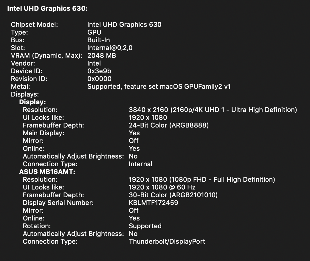

Hello everyone,
I have an issue that I do not know how to fix it and I did not find any info in threads/posts that can give me a clue on how to tackle it.
I have a laptop running Catalina with UHD 630 and a NVIDIA GPU that is disabled with the help of Whatevergreen property injection and all things work as expected if I use the laptop without any external monitors.
The issue I'm facing is when I attach a USB-C monitor to the laptop (I need to attach it before I start the laptop as the USB-C ports are enabled by WMI and not getting powered if no device is connected at boot). The system boots in mirror mode till the framebufer gets initialized and at this point the internal screen gets blank (the brightness function keys still work as the backlit of the screen is on) and I have the background image on the attached monitor. If I connect to the laptop with Remote Desktop the both screen are shown in "About This Mac" and also in "System Information" (see the attached image) so the system should work but that is not the case.
I discovered that if I close the lid and what for a couple of seconds the attached monitor flickers and the password input appears on it and after that I reopen the lid, after another 2 seconds I have the image on both monitors.
This issue presented was before upgrading the Whatevergreen 1.3.8 , after upgrading to 1.3.8 the internal screen was no longer detected and got switched off at framebuffer initialization so I had to play with the boot options and the following combination "igfxfw=2 igfxpavp=1 igfxonln=1" got me the same result as with 1.3.7 as in the issue is still there.
I also played with connector configuration but with no change.
I'm injecting the following properties into PciRoot(0x0)/Pci(0x2,0x0) for UHD 630 to work :
<key>AAPL,ig-platform-id</key>
<data>CQCbPg==</data>
<key>AAPL,slot-name</key>
<string>Internal@0,2,0</string>
<key>disable-external-gpu</key>
<data>AQAAAA==</data>
<key>enable-dpcd-max-link-rate-fix</key>
<key>enable-hdmi20</key>
<key>framebuffer-patch-enable</key>
<key>framebuffer-unifiedmem</key>
<data>AAAAgA==</data>
<key>hda-gfx</key>
<string>onboard-1</string>
<key>model</key>
<string>Intel UHD Graphics 630</string>
Any hints or information that can help with this issue are welcome.
Thank you all in advance.
