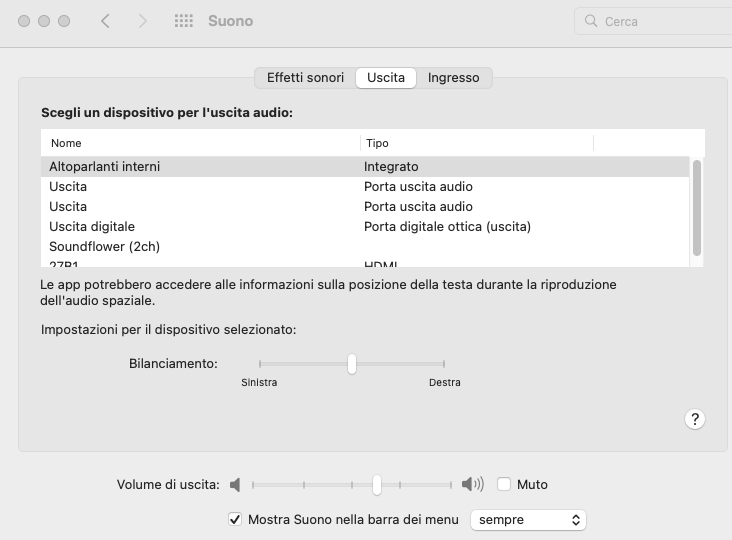

Hi, posting this here, but not sure it's related to weg or something else.
I have upgraded my gpu to a sapphire nitro+ se 6900 xt.
I'm using weg, applealc and lilu.
I'm using weg (with boot-args agdpmod=pikera) because:
1. without it only hdmi and 1 out of 3 dp ports work, with whatevergreen all the ports work (video)
2. no green screen on apple tv with unfairgva in config.plist
The issue is with audio (through hdmi/dp).
I'm currently using onboard audio, but I noticed that:
1. dp audio never works (with all the 3 ports)
2. in system preferences -> sound, sometimes (rarely) I have all the audio outputs (onboard, hdmi and dp), sometimes hdmi audio is missing, sometimes dp audio is missing; in any case, even if dp audio is showing, dp audio is not working
Any of you experienced the same issue?

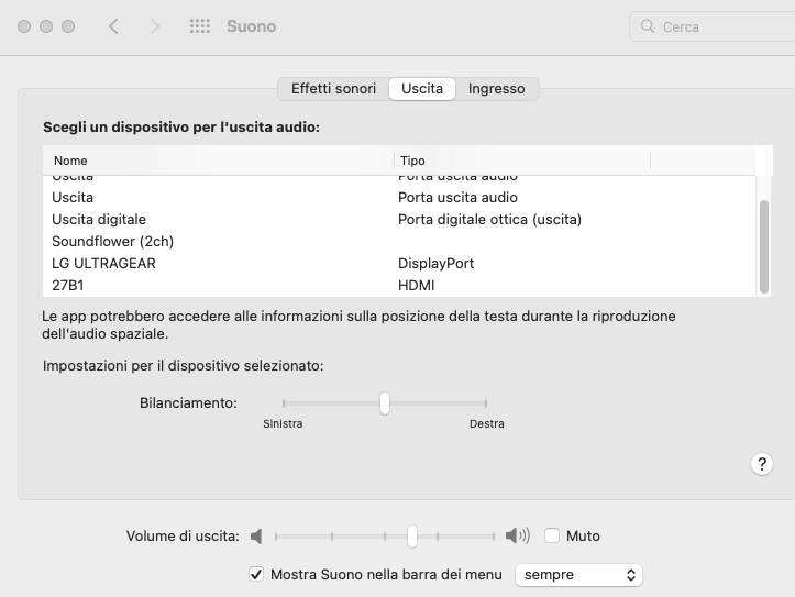

As an example:
Now, with 2 monitors attached (aoc 27b1 (hdmi) and lg ultragear (dp)), I have only onboard and hdmi audio showing in system preferences:

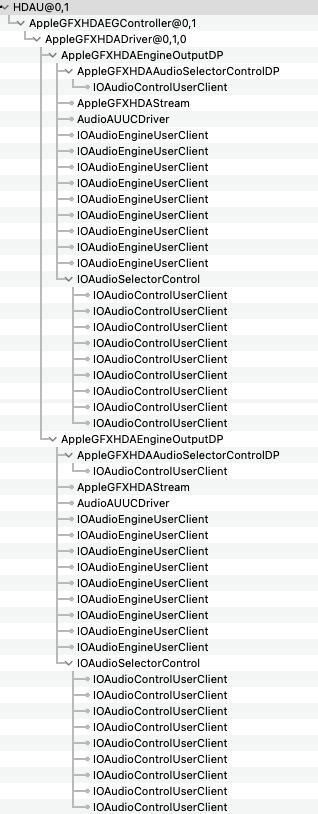

And this is HDAU in ioregistry:

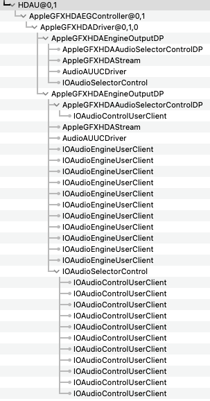

And this is another example with onboard, HDMI and dp showing, but dp audio not working:
and ioreg:
Obviously I tested the hardware in windows too and dp audio is working there.
