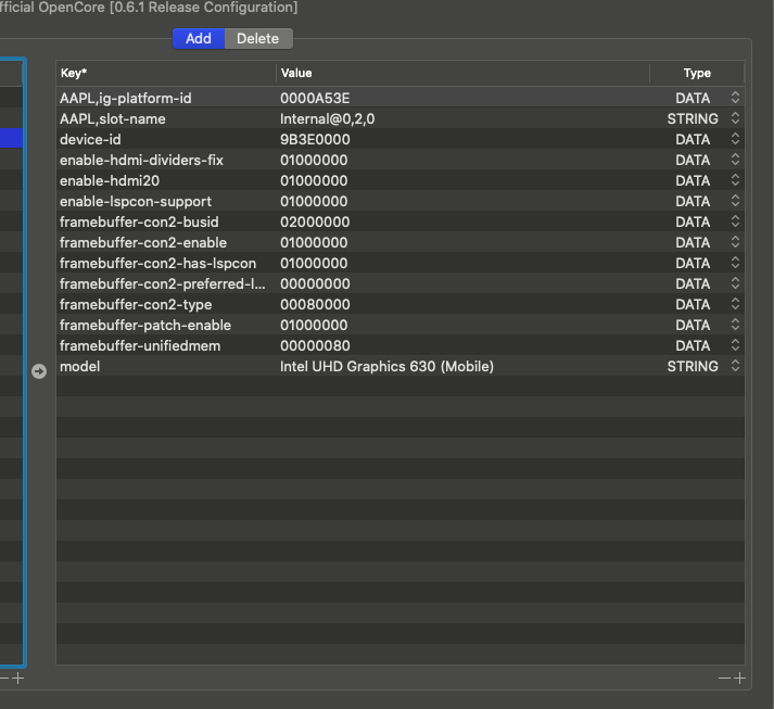

Hi everyone,
I've been trying to run my Laptop HDMI port in 4K30Hz for days now. I'm pulling my hair off!!I've tried various configurations with Hackintool. Most of the time I get LV display going on and off when connecting to HDMI cable. The monitor itself is trying to connect but stays black. I also can see that the monitor is detected in about my Mac.
What is weird - sometimes it works and I get full 4K30Hz, but after sleep monitor stays black. 1080p monitors work without big issues. also deleting Colorsync profiles, most of the time i get the monitor to work.
I'm using OC 0.6.1 with newest kexts
i7 10510U with UHD Graphics
Current config: see screenshot
I've attached a log with lots of IGFB erros, but don't understand a thing.
logconnectedafterdeletingcolorsyncprofiles.rtf
logconnectfailed.rtf
Edited by Neblogas
Added new logs

Same on my "MBP15,2" ( see sig ) and external display through HDMI does't work anymore
On my Z390 Hack no problems though !
