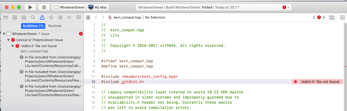

Where can I get your version of Lilu and WhateverGreen? I can't compile it from sources in Mojave because undefined names. Probably they defined in Ventura.
Can you upload your Release?
Is it true that your Lilu is for Ventura only?
It builds for me in Mojave 10.14.6 (18G9323). Xcode Version 11.3 (11C29).
You should check the symlinks to make sure they are pointing correctly at their targets.
In the Lilu folder, right click MacKernelSDK and select "Show Original". It should select the joevt-MacKernelSDK folder that you cloned.
If you need to redo a symlink, then first delete it from the directory before executing the ln command.
In the project settings, Library Search Paths (double click it or select and press enter) under the Lilu target level should contain these three paths:
$(inherited)
$(PROJECT_DIR)/$(PROJECT_NAME)$(LOCAL_LIBRARY_DIR)
$(PROJECT_DIR)/MacKernelSDK/Library/universal
And there should also be KERNEL_EXTENSION_HEADER_SEARCH_PATHS (Debug, Release, Sanitize) under the Lilu project level:
$(PROJECT_DIR)/MacKernelSDK/Headers
And KERNEL_FRAMEWORK_HEADERS (Debug, Release, Sanitize) under the Lilu project level:

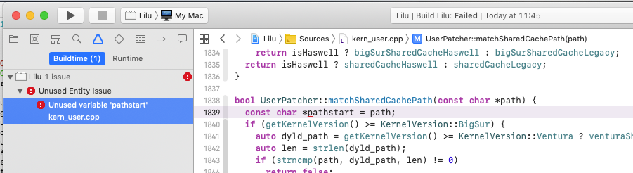

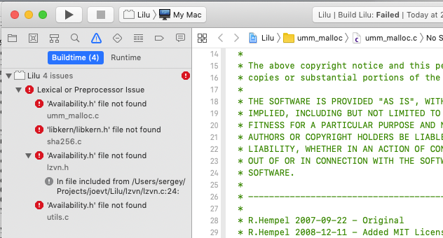

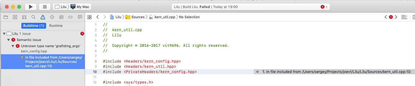

Then I have new error
Where it is proposed to be?
OK, it is in MacKernelSDK.
Now I have successful compilation both kexts.
To compile the Lilu I had to revert those commit.
Thanks for checking. I fixed it by adding a commit to https://github.com/joevt/MacKernelSDK
I was able to build successfully in Ventura with Xcode 14.1

Thanks for the fix.
I made "git stash" to exclude my changes and then "git pull" to accept your changes.
Now Lilu-DEBUG is compiled successfully but not release.
This variable is used only for DEBUG build  so should be excluded by
#ifdef DEBUG
#endif

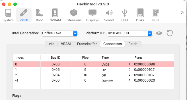

Do we need a different framebuffer in Ventura 13.2 with coffeelake? I’ve recently made no changes to my config, just haven’t used macOS for about 2 weeks and now I boot to a black loading screen with Apple logo. I can VNC into my desktop so I know it is booting just not reaching the desktop on my laptops screen.
I7-9750H and UHD 630. It is definitely graphics related. I have the latest WEG and I have posted my config on the prerelease page page for Ventura 13.2.
Please help.

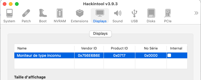

On 2/3/2023 at 7:01 PM, Baio77 said:
Hi I have a problem with the integrated screen (3000x2000) of my Thinkpad X1 Tablet I5 8250U.
I would like to know where I can write to get support and understand if the problem is solvable.
Thank you
try older version of osx one by one till u find where the problem started.
i wish oclp can open back its bugtracker, is there a oclp support thread in insanelymac?
The OP has a KabyLake-R.  Why is OCLP relevant?
EDIT: I looked back for some history.  Maybe this response is two separate topics?
Edited by deeveedee
