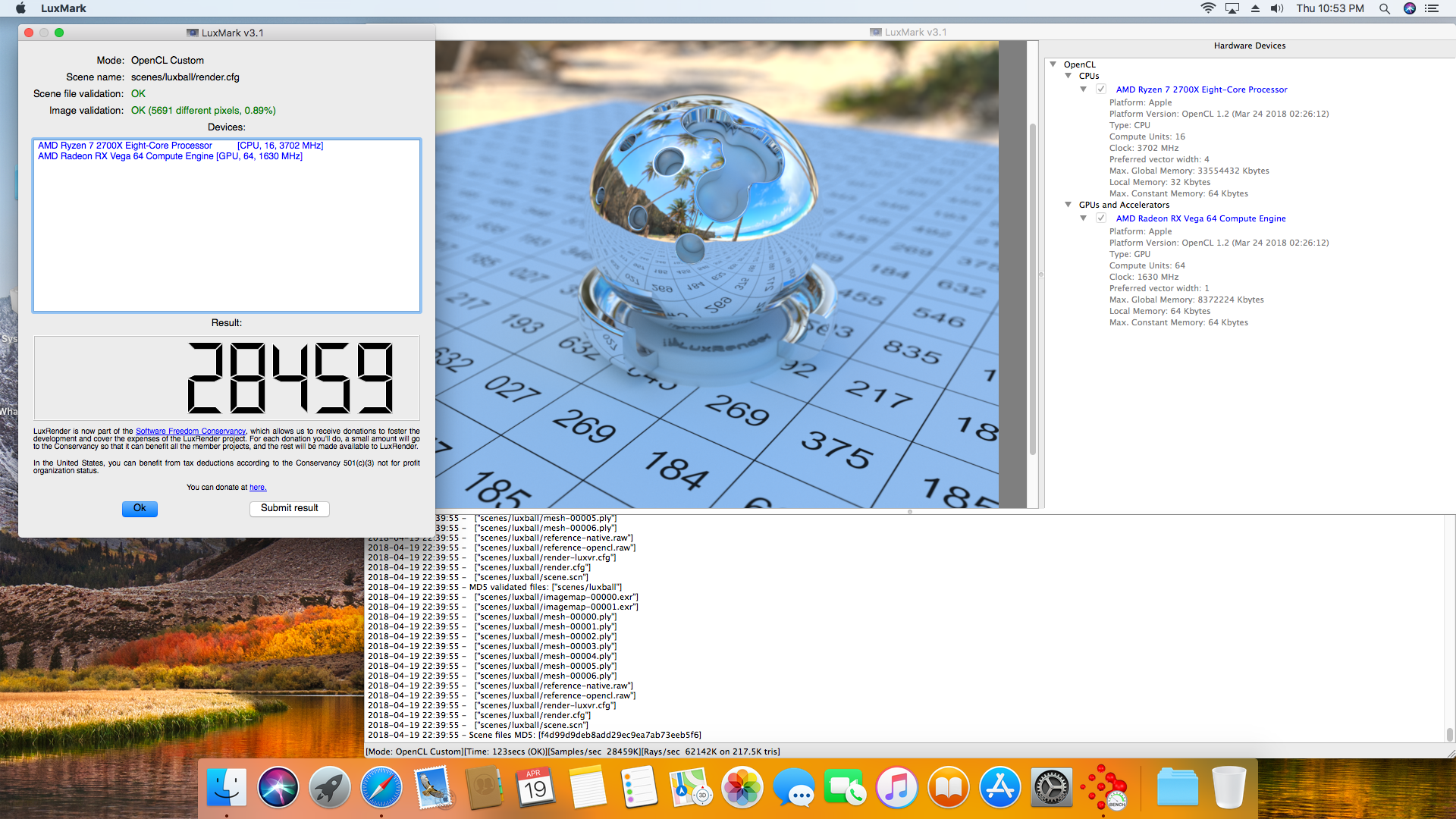

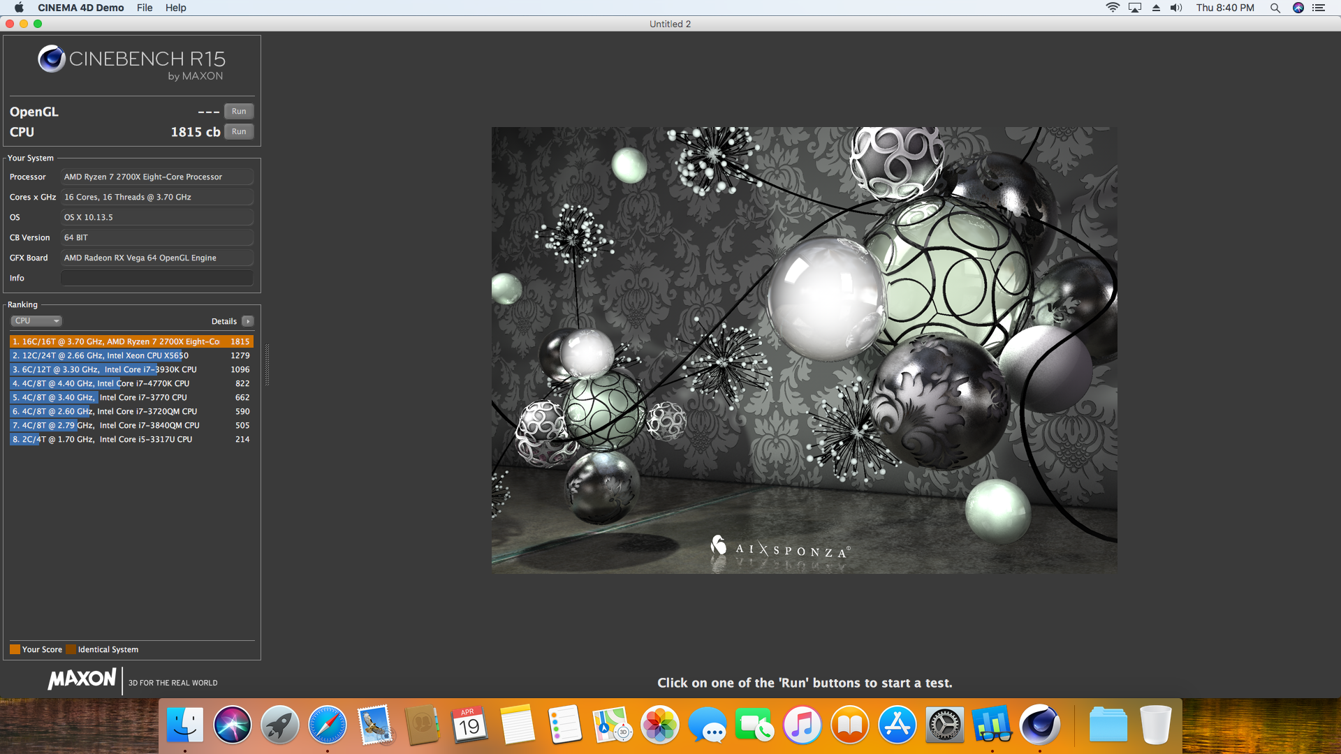

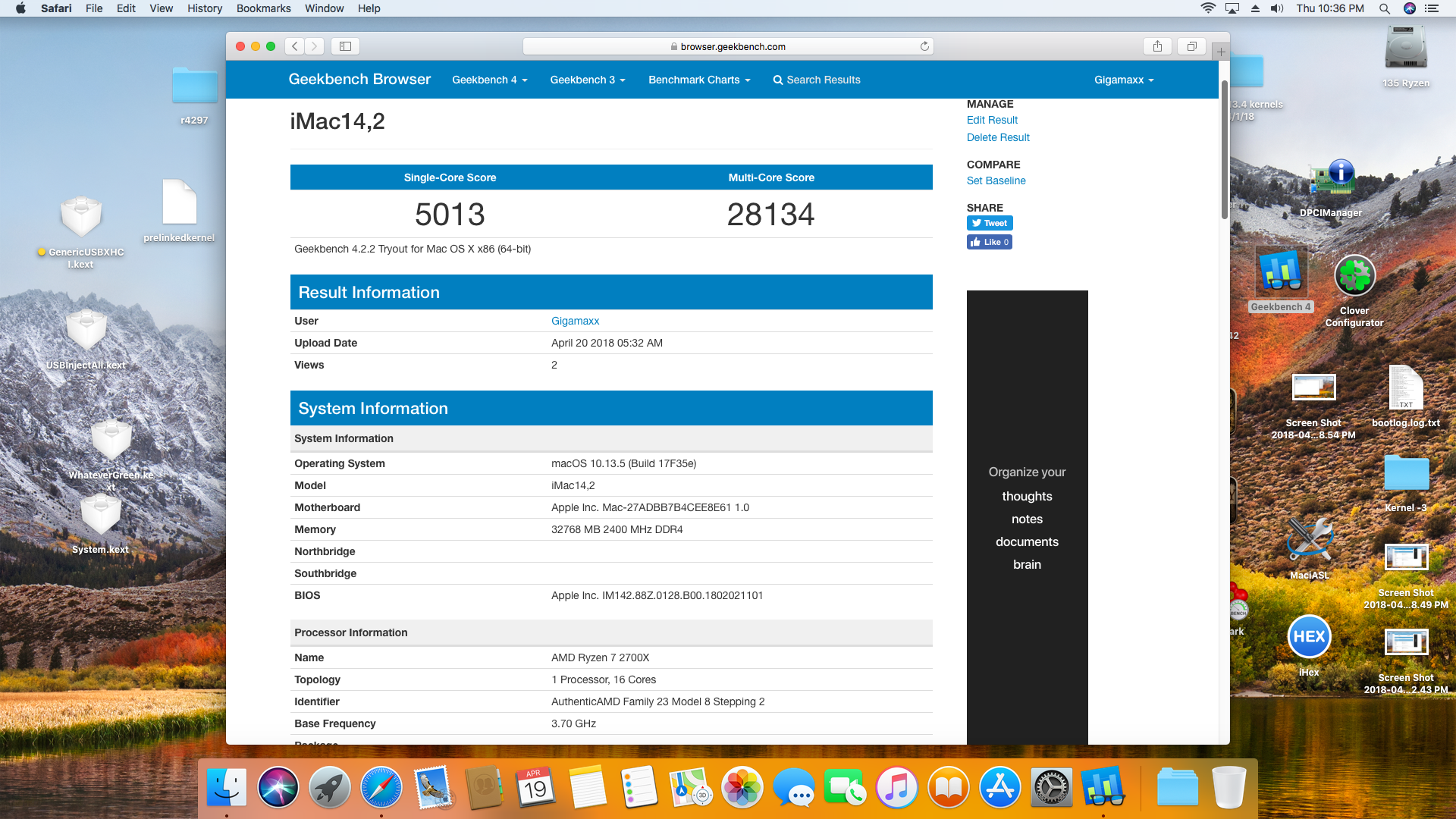

Gigamaxx Posted April 20, 2018 Author Share Posted April 20, 2018 (edited) Ryzen 7 2700X with Gigabyte X470 Gaming mobo works. Higher clocks, better scores It has 2 power steppngs (Geekbench) always stuck with one on the 1700. Edited April 20, 2018 by Gigamaxx 2 Link to comment https://www.insanelymac.com/forum/topic/325514-amd-high-sierra-kernel-release-and-testing/page/36/#findComment-2610796 Share on other sites More sharing options...
bbmatias3 Posted April 20, 2018 Share Posted April 20, 2018 Nice!! How’s gpu performance? Link to comment https://www.insanelymac.com/forum/topic/325514-amd-high-sierra-kernel-release-and-testing/page/36/#findComment-2610798 Share on other sites More sharing options...
Gigamaxx Posted April 20, 2018 Author Share Posted April 20, 2018 (edited) A little better, Vega still isn't up to par but I will try RX 480 to see if it acts like intel. I'm in Beta 13.5 though so kernel support may not be optimal. A really bitchn looking fan though with a nice copper tube heatsink versus the older RBG fan on 1700. 54589985796__32DED299-5FA9-4D09-A2FD-6669A73AE3F7.MOV Edited April 20, 2018 by Gigamaxx Link to comment https://www.insanelymac.com/forum/topic/325514-amd-high-sierra-kernel-release-and-testing/page/36/#findComment-2610799 Share on other sites More sharing options...

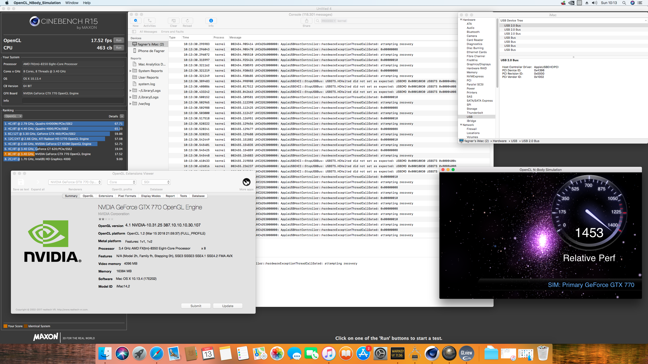

fagneroliveira Posted May 13, 2018 Share Posted May 13, 2018 On 5/7/2018 at 6:08 PM, sajmonella9 said: Any test for Nvidia GPU ? on 10.13.4 . I mean... still gpu performance is 50% less that normal? Yes the Performance is poor Anyone had the Problem with the USB 3.0 my hackintosh Say no have usb3 but the Port usb 3 work. but of i remove the device in the usb 3 the hackintosh Reboot. Shannne some one Progress in your Kernel? Link to comment https://www.insanelymac.com/forum/topic/325514-amd-high-sierra-kernel-release-and-testing/page/36/#findComment-2613447 Share on other sites More sharing options...
