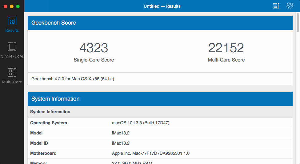

On 8/9/2018 at 8:38 PM, Shaneee said:

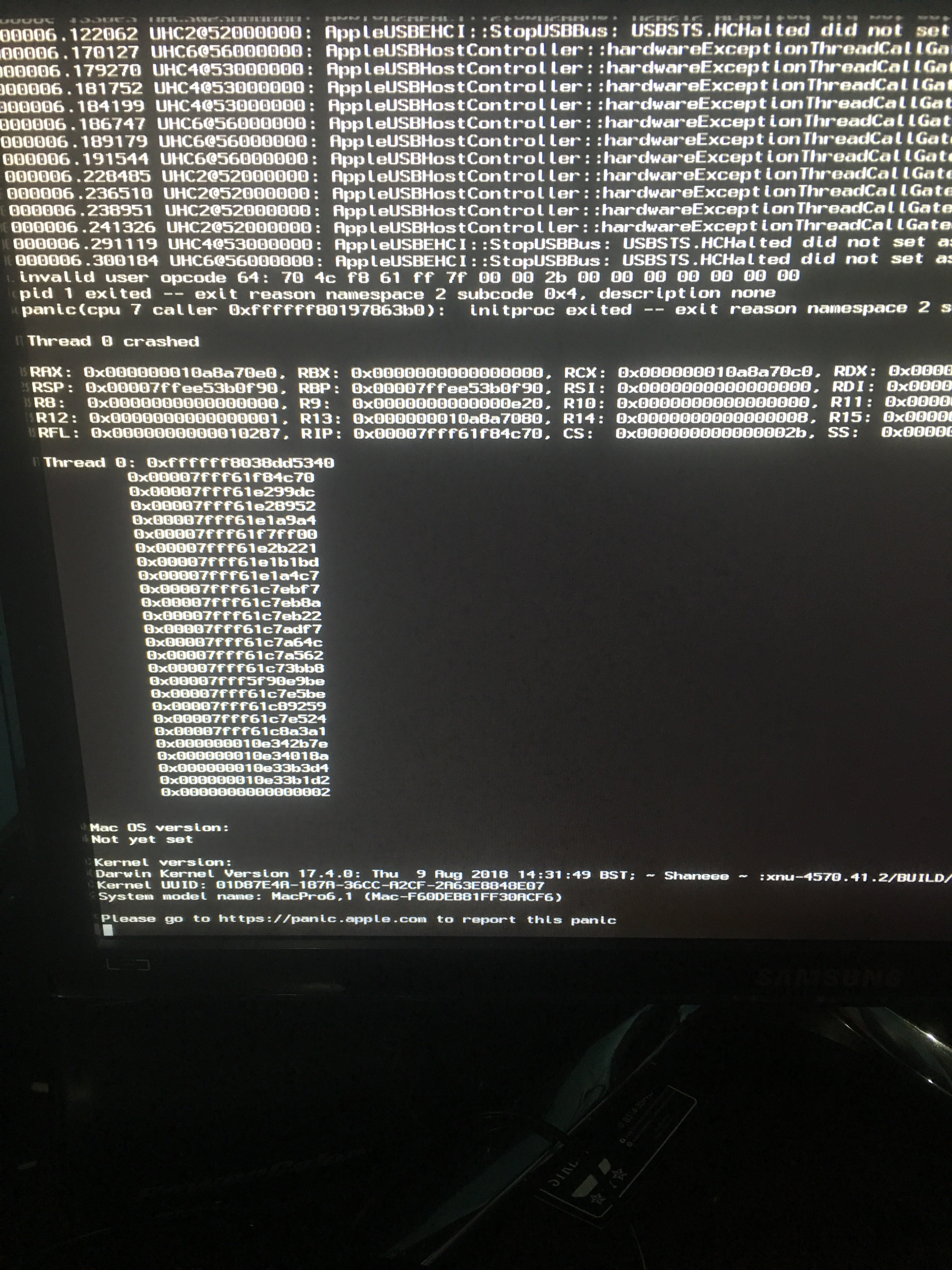

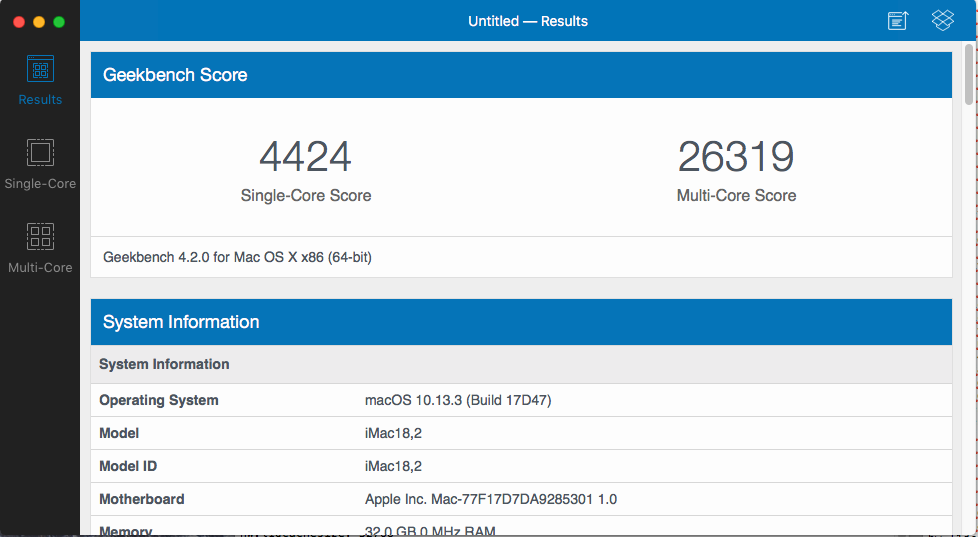

Thanks for this new Ryzen kernel which can boot with "-s, then Exit" to dektop in my Ryzen 1700X hackintosh at 10.13.3 (17D47).
Its performance by Cinebench R15 or Geekbench was very good indeed.
Without these boot arguments it always got invalid kernel opcode (64-bit): .......... errors repeatedly and unable to login desktop !
1700x.txt
Edited by jsl2000

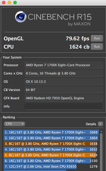

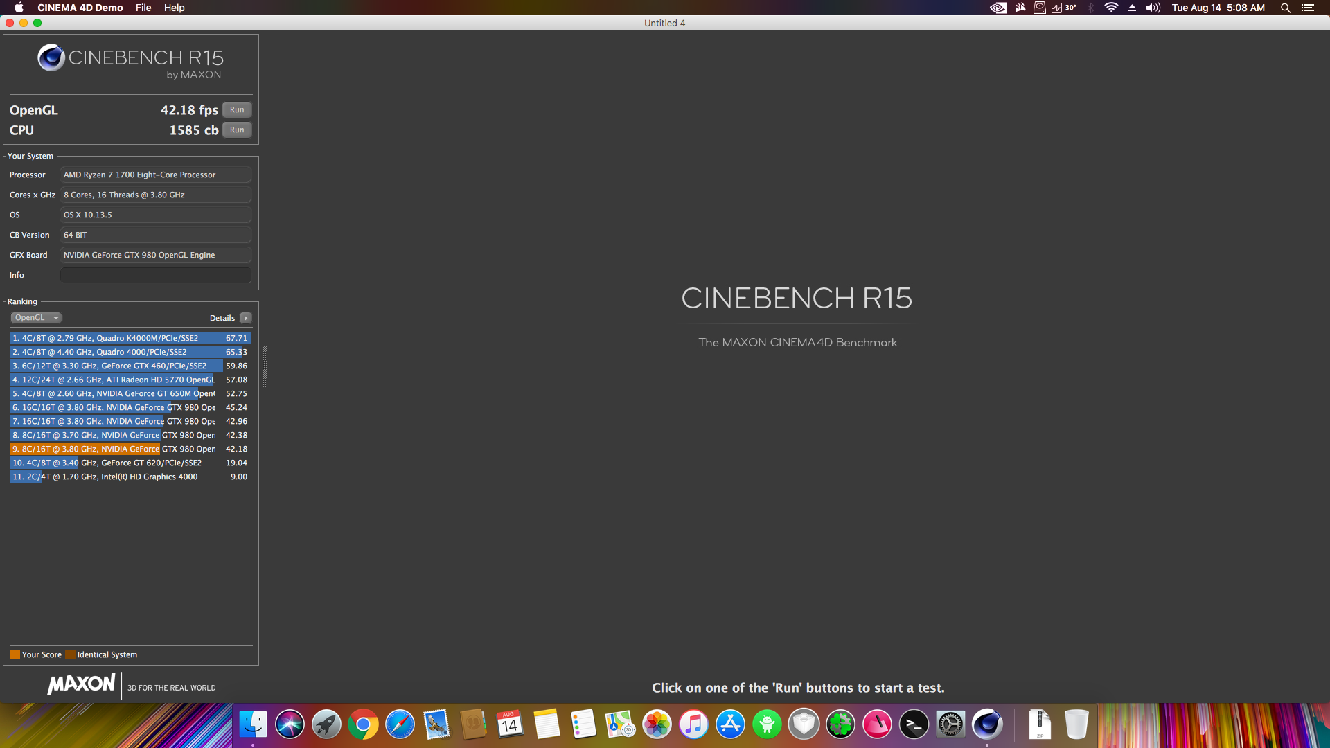

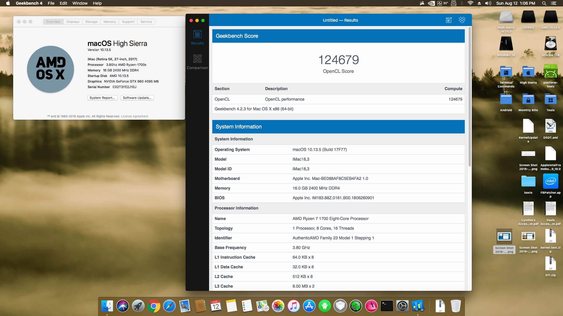

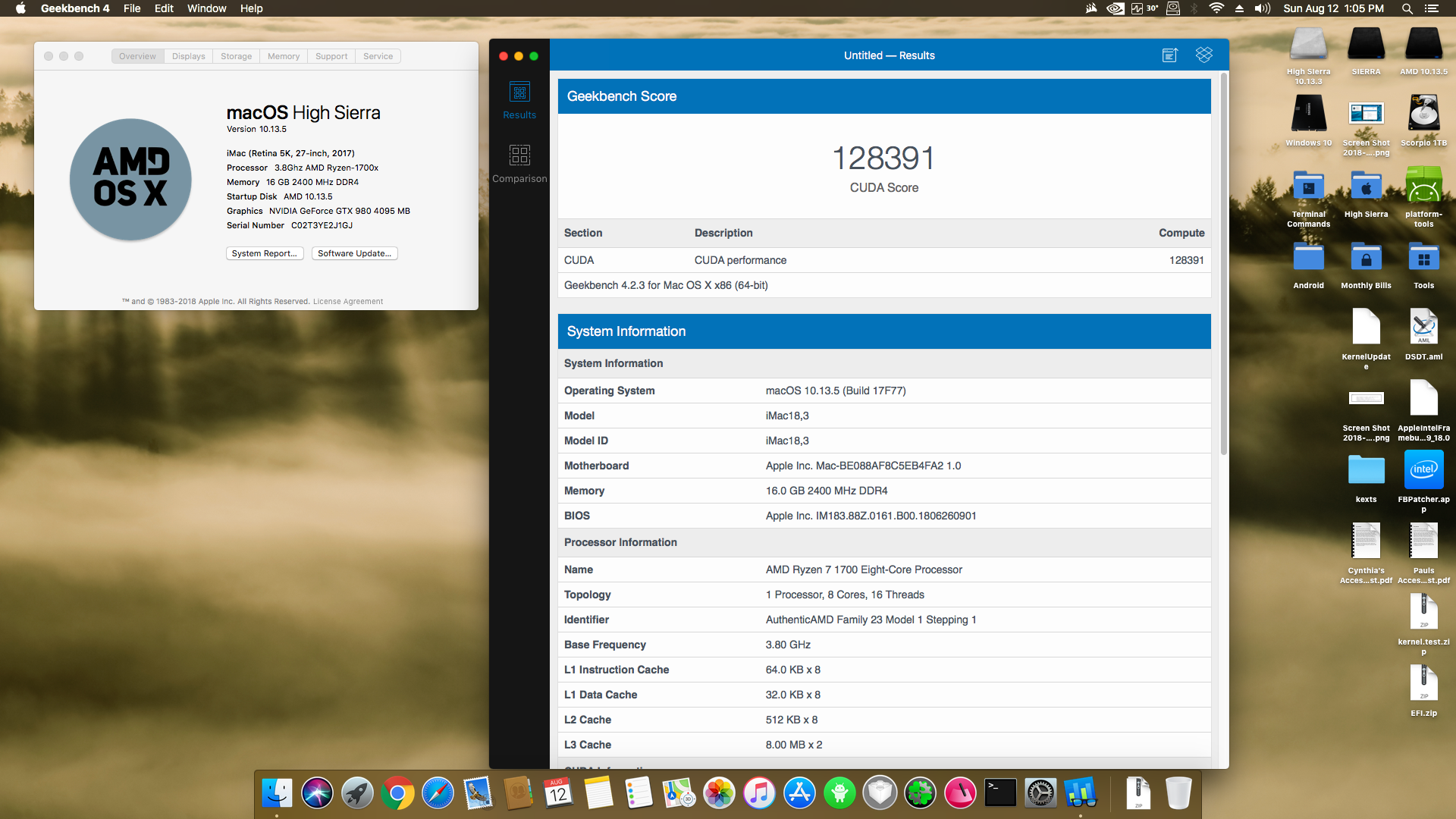

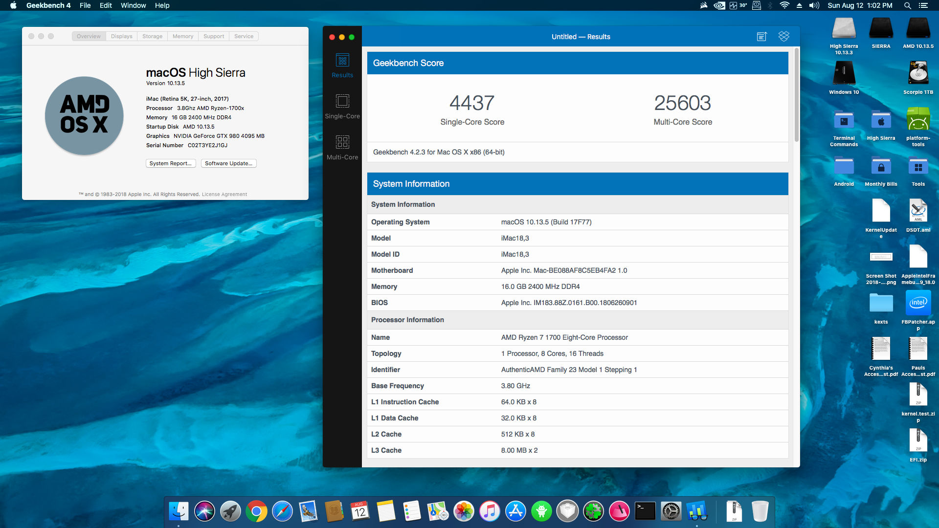

21 hours ago, Shaneee said:
Were you experiencing poor Nvidia performance before at all? If so how is it now?
Not that i can notice. These are my current benchmark results with the "new" kernel.

31 minutes ago, fagneroliveira said:
With the fx8350  i receite kernelpanic
using   kcauffix=test ir not using
Yeah we are working on fixing the FX issues with the new kernel. Can you test this one with kcsuffix please. Replace the kernel then run
sudo kextcache -i / && sudo kextcache -u /
kernel.test.zip

2 hours ago, Gigamaxx said:
Can you run a cinebench or other OpenGL app like Uningine?
Yeah, Nvidia performance still just isnt there with AMD support yet. Cinebench scores below, and Uningine Valley crashes within 20 seconds. Starting off at 22fps.

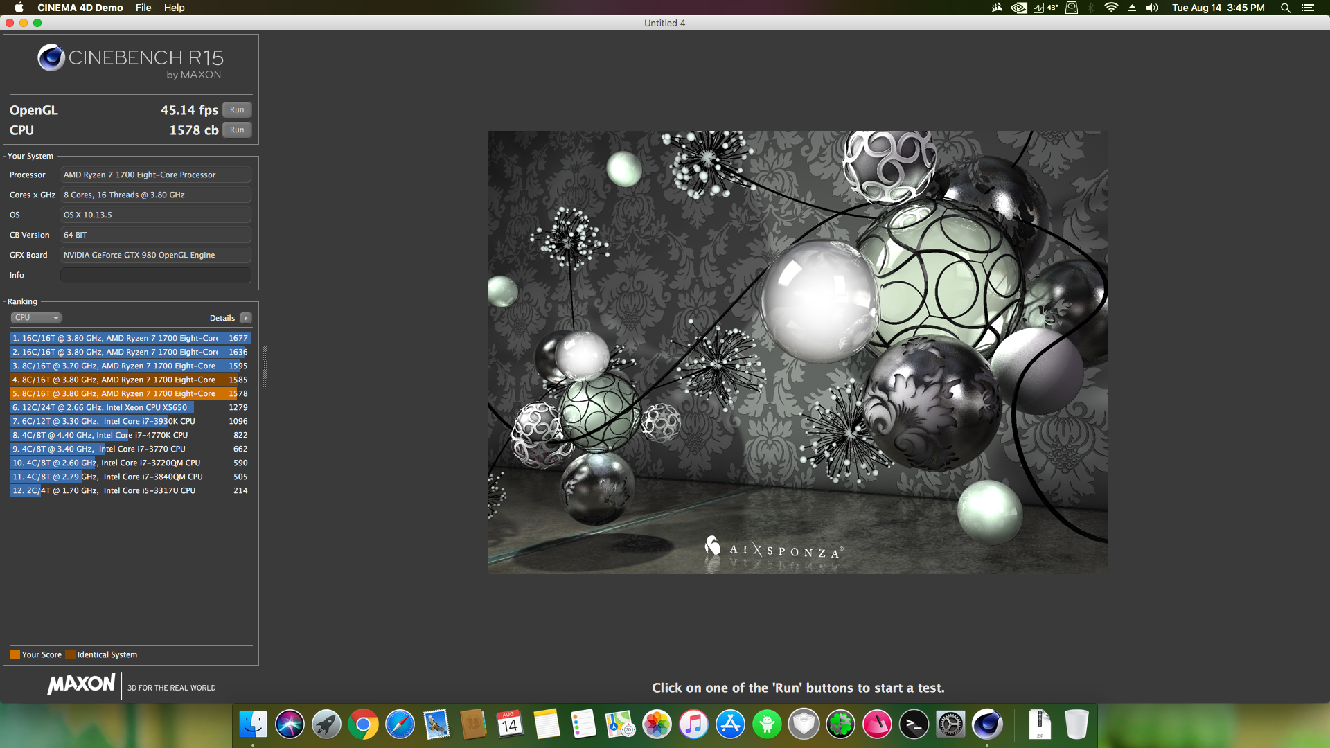

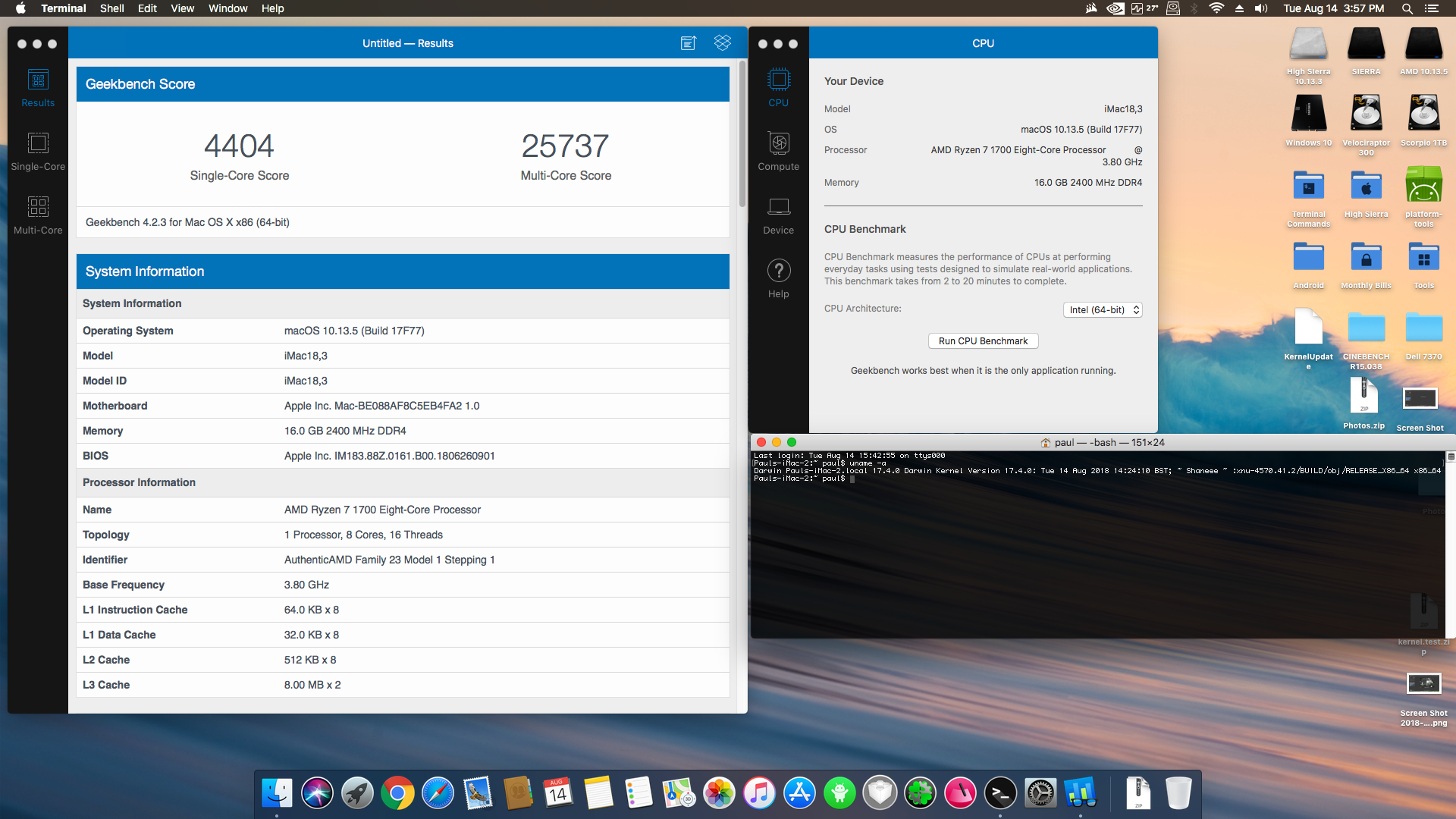

Score is slightly higher on Cinebench. Valley still crashes. I will say general speed and app opening is extremely fast and smooth with this kernel. Best to date so far. With these new Ryzen kernels should i be leaving the CPU section in clover blank? or does it matter?
I've got nothing set in the CPU tab. Can you try booting with kcsuffix=test -enableleaf and see if it makes a difference.

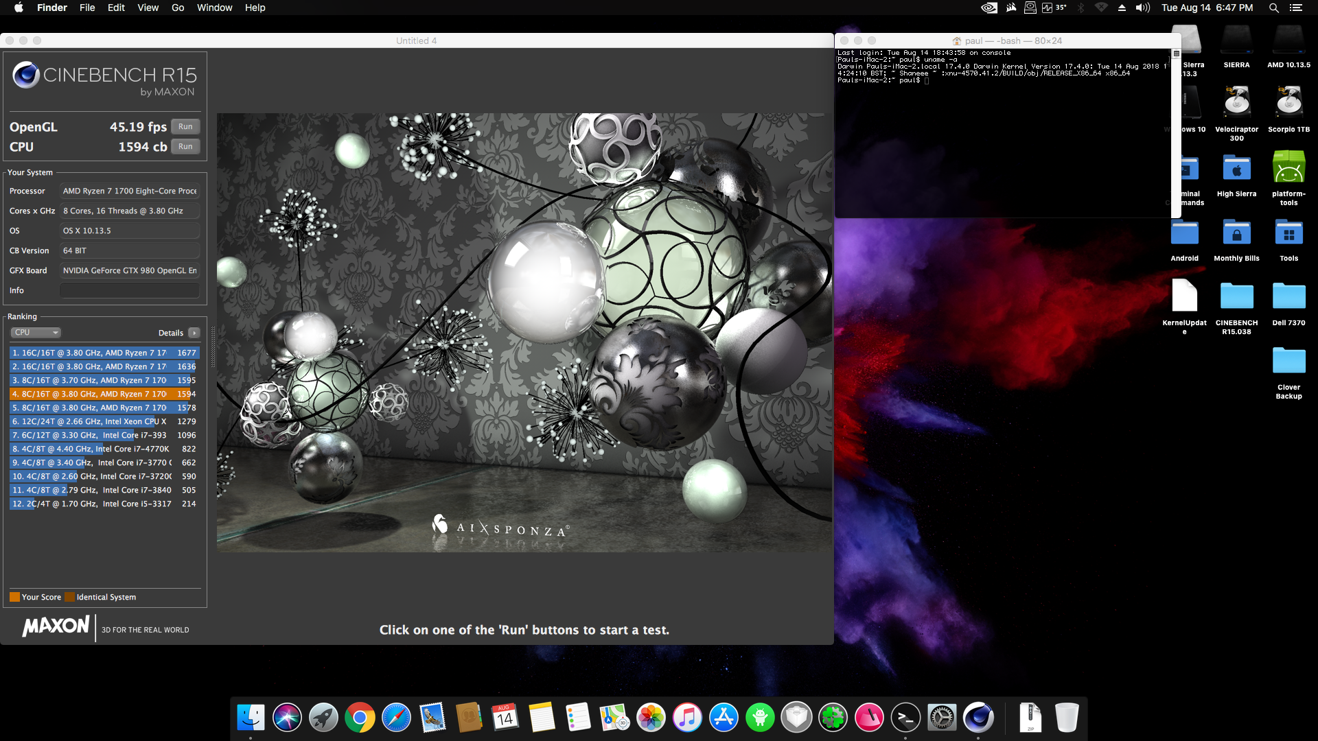

added -enableleaf "with kcsuffix=test" to my bootargs. Didnt seem to make a difference. Only thing i noticed was i lost wifi. System still runs smooth and fast. Fastest boot time to date. Also i cleared all my settings in CPU in clover.
