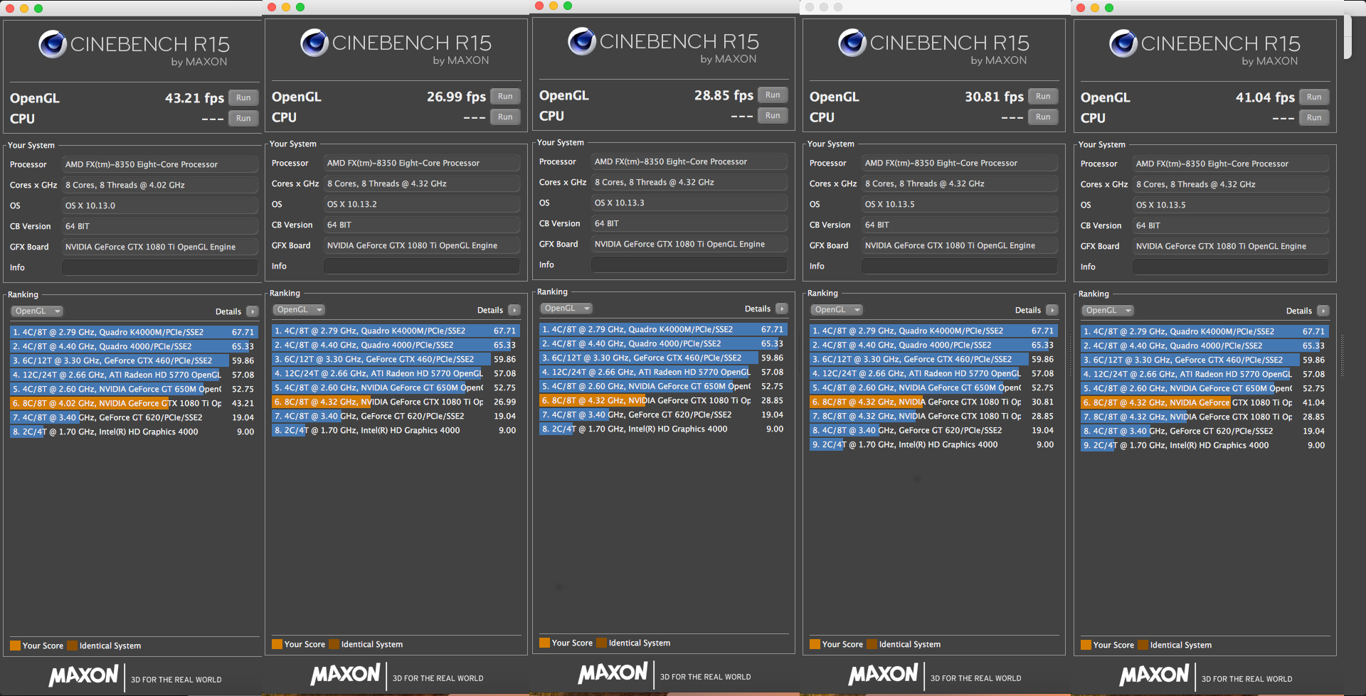

fagneroliveira Posted August 24, 2018 Share Posted August 24, 2018 the result of Nvidia 1080ti with FX8320 on HS version 13.0 is the best preforme on my 1080ti 13.2 poor 13.3 poor 13.5 rollback kext 13.3. performance is poor 13.5 prelinked of 13.0 good but without internet Link to comment https://www.insanelymac.com/forum/topic/325514-amd-high-sierra-kernel-release-and-testing/page/41/#findComment-2631545 Share on other sites More sharing options...

AlGrey Posted August 25, 2018 Share Posted August 25, 2018 6 hours ago, fagneroliveira said: the result of Nvidia 1080ti with FX8320 on HS version 13.0 is the best preforme on my 1080ti 13.2 poor 13.3 poor 13.5 rollback kext 13.3. performance is poor 13.5 prelinked of 13.0 good but without internet do you see any difference with this one ? kcsuffix=tsc kernel.tsc.zip Link to comment https://www.insanelymac.com/forum/topic/325514-amd-high-sierra-kernel-release-and-testing/page/41/#findComment-2631558 Share on other sites More sharing options...

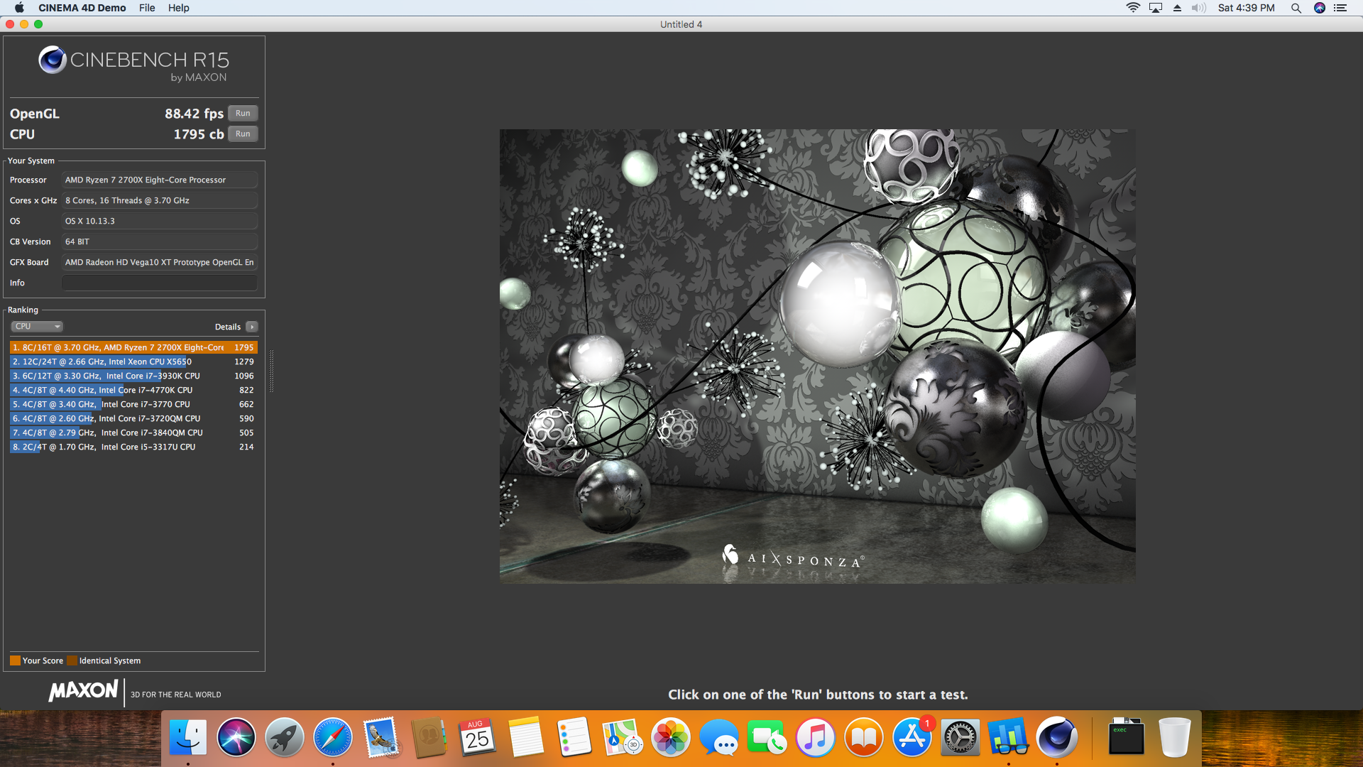

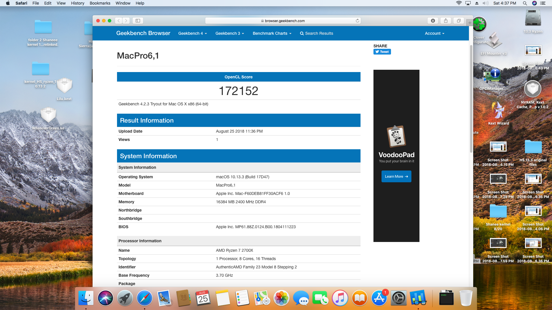

Gigamaxx Posted August 25, 2018 Author Share Posted August 25, 2018 18 hours ago, AlGrey said: give this one a try kernel.test.zip IS there any way to add about 10% to that fix? Intel setups run Vega at 205,000 to 208,000 even on my 3.2GHz Pentium G3258. It would be nice to get Intel level performance out of Ryzen for AMD graphics if its possible. Link to comment https://www.insanelymac.com/forum/topic/325514-amd-high-sierra-kernel-release-and-testing/page/41/#findComment-2631560 Share on other sites More sharing options...

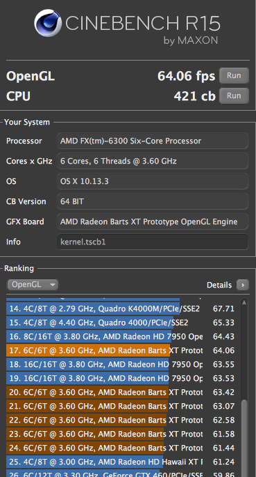

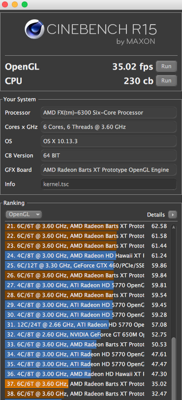

jsl2000 Posted August 25, 2018 Share Posted August 25, 2018 (edited) 7 hours ago, AlGrey said: do you see any difference with this one ? kcsuffix=tsc kernel.tsc.zip Thanks for this new kernel which can boot to desktop in my FX-6300 hackintosh, but its performance score by Cinebench R15 got only 50 % of your previous kernel.testb. Wake-up got reboot too. BTW why it showed this kernel by uname -a as : Darwin iMac-2.local 17.4.0 Darwin Kernel Version 17.4.0: Fri Aug 24 15:24:31 PDT 2018; ~ Shaneee ~ :AMD-High-Sierra-XNU/BUILD/obj/RELEASE_X86_64 x86_64 Edited August 25, 2018 by jsl2000 Link to comment https://www.insanelymac.com/forum/topic/325514-amd-high-sierra-kernel-release-and-testing/page/41/#findComment-2631595 Share on other sites More sharing options...

AlGrey Posted August 25, 2018 Share Posted August 25, 2018 22 hours ago, Gigamaxx said: IS there any way to add about 10% to that fix? Intel setups run Vega at 205,000 to 208,000 even on my 3.2GHz Pentium G3258. It would be nice to get Intel level performance out of Ryzen for AMD graphics if its possible. Any improvement with this one ? kernel.tscb1.zip 1 Link to comment https://www.insanelymac.com/forum/topic/325514-amd-high-sierra-kernel-release-and-testing/page/41/#findComment-2631706 Share on other sites More sharing options...
Gigamaxx Posted August 25, 2018 Author Share Posted August 25, 2018 15 minutes ago, AlGrey said: Any improvement with this one ? kernel.tscb1.zip 15 minutes ago, AlGrey said: Any improvement with this one ? kernel.tscb1.zip I’ll test in a few minutes when I get back home. Link to comment https://www.insanelymac.com/forum/topic/325514-amd-high-sierra-kernel-release-and-testing/page/41/#findComment-2631709 Share on other sites More sharing options...
fagneroliveira Posted August 25, 2018 Share Posted August 25, 2018 On 8/24/2018 at 4:37 PM, Shaneee said: I can't replicate the issue with colour change in PS. I know about the warp stabilizer crash and I'll look into it when I've got time. @fagneroliveira Can you test this kernel with the FX. Copy to S/L/K and run sudo kextcache -u / to compile prelinkedkernel.test Remove it if it's there first. Then boot Clover with kcsuffix=test kernel.test.zip Shaneee I did not notice much difference. only the boot that was slower and sometimes it froze for less than 1 sec 23 hours ago, AlGrey said: do you see any difference with this one ? kcsuffix=tsc kernel.tsc.zip I did not notice the difference in performance. Link to comment https://www.insanelymac.com/forum/topic/325514-amd-high-sierra-kernel-release-and-testing/page/41/#findComment-2631716 Share on other sites More sharing options...

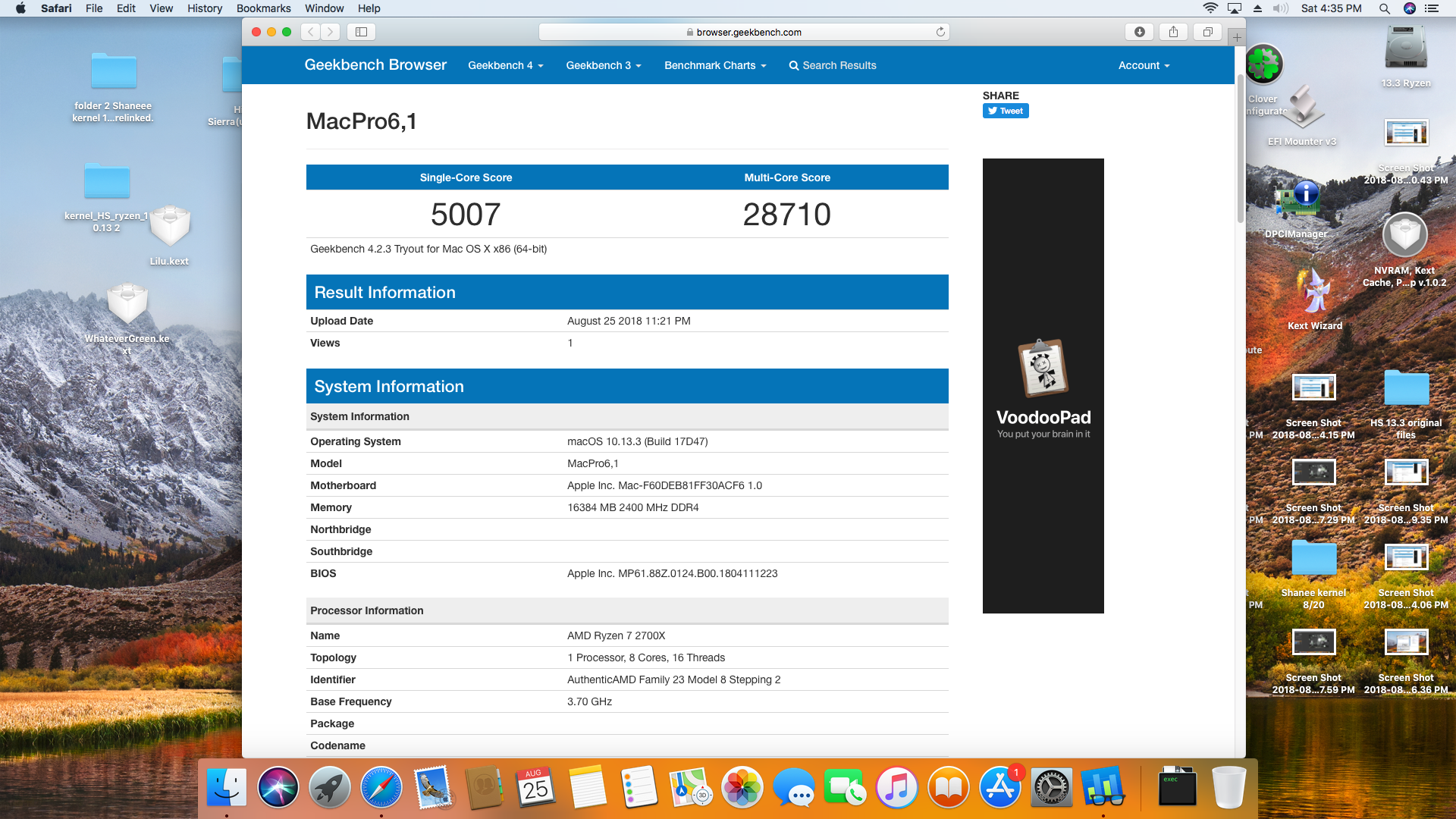

Gigamaxx Posted August 26, 2018 Author Share Posted August 26, 2018 2 hours ago, AlGrey said: Any improvement with this one ? kernel.tscb1.zip I got about 1-1.5 % increase in performance. Link to comment https://www.insanelymac.com/forum/topic/325514-amd-high-sierra-kernel-release-and-testing/page/41/#findComment-2631718 Share on other sites More sharing options...

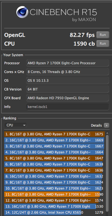

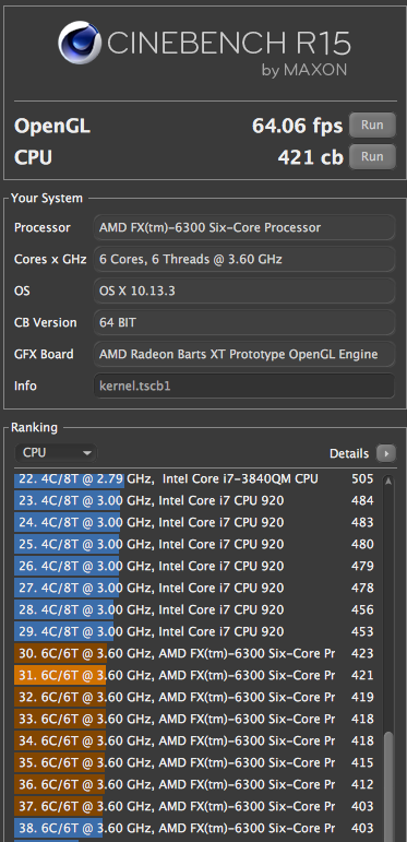

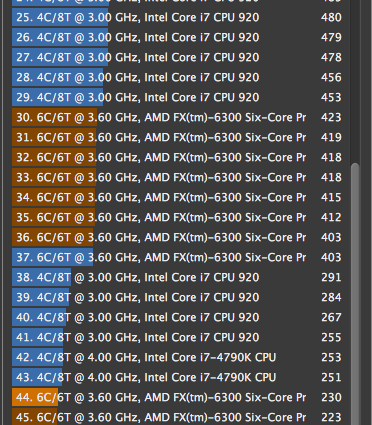

jsl2000 Posted August 26, 2018 Share Posted August 26, 2018 (edited) 10 hours ago, AlGrey said: Any improvement with this one ? kernel.tscb1.zip Thanks for this kernel.tscb1 which got the best scores in Cinebench R15 in my FX-6300 hackintosh at 10.13.3. Can you fix the power management issue which should be wake-up instead of reboot in FX-6300 hackintosh ? No such an issue in my Ryzen 1700X hackintosh with AMD Radeon 7950 GPU. I'm not sure whether it's due to your kernel or AMD Radeon 6870 GPU. Because no such an issue with Bronya's kernel I guess it's due to kernel more than GPU problem. In Ryzen 1700X hackintosh it got best GPU performance and less well CPU scores in Cinebench R15. Edited August 26, 2018 by jsl2000 Link to comment https://www.insanelymac.com/forum/topic/325514-amd-high-sierra-kernel-release-and-testing/page/41/#findComment-2631720 Share on other sites More sharing options...

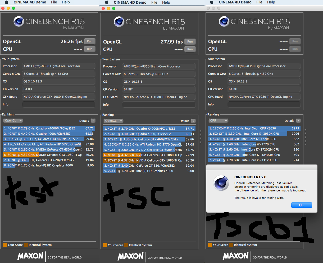

fagneroliveira Posted August 26, 2018 Share Posted August 26, 2018 the result of the last kernels test.rtf tsc.rtf tscb1.rtf Link to comment https://www.insanelymac.com/forum/topic/325514-amd-high-sierra-kernel-release-and-testing/page/41/#findComment-2631779 Share on other sites More sharing options...
AlGrey Posted August 26, 2018 Share Posted August 26, 2018 3 hours ago, fagneroliveira said: the result of the last kernels test.rtf tsc.rtf tscb1.rtf report the full sysctl -a output please 17 hours ago, jsl2000 said: Thanks for this kernel.tscb1 which got the best scores in Cinebench R15 in my FX-6300 hackintosh at 10.13.3. Can you fix the power management issue which should be wake-up instead of reboot in FX-6300 hackintosh ? No such an issue in my Ryzen 1700X hackintosh with AMD Radeon 7950 GPU. I'm not sure whether it's due to your kernel or AMD Radeon 6870 GPU. Because no such an issue with Bronya's kernel I guess it's due to kernel more than GPU problem. In Ryzen 1700X hackintosh it got best GPU performance and less well CPU scores in Cinebench R15. Will have to look into this, but I have an idea what it could be 18 hours ago, Gigamaxx said: I got about 1-1.5 % increase in performance. ok so pretty much none 1 Link to comment https://www.insanelymac.com/forum/topic/325514-amd-high-sierra-kernel-release-and-testing/page/41/#findComment-2631809 Share on other sites More sharing options...
fagneroliveira Posted August 26, 2018 Share Posted August 26, 2018 1 hour ago, AlGrey said: report the full sysctl -a output please Will have to look into this, but I have an idea what it could be ok so pretty much none sys-a-test.txt sys-a-tsc.txt sys-a-tscb1.txt Link to comment https://www.insanelymac.com/forum/topic/325514-amd-high-sierra-kernel-release-and-testing/page/41/#findComment-2631816 Share on other sites More sharing options...
Gigamaxx Posted August 26, 2018 Author Share Posted August 26, 2018 1 hour ago, AlGrey said: ok so pretty much none It did bump it up with a consistent 1%, I ran several benches and it holds up. My Cinebench hit 1800 for CPU. 1 Link to comment https://www.insanelymac.com/forum/topic/325514-amd-high-sierra-kernel-release-and-testing/page/41/#findComment-2631817 Share on other sites More sharing options...

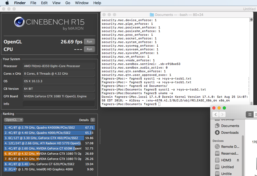

AlGrey Posted August 26, 2018 Share Posted August 26, 2018 1 hour ago, fagneroliveira said: sys-a-test.txt sys-a-tsc.txt sys-a-tscb1.txt You are not even testing the kernels.... all the outputs are for kern.version: Darwin Kernel Version 17.4.0: Fri 24 Aug 2018 20:24:38 BST; ~ Shaneee ~ :xnu-4570.41.2/BUILD/obj/RELEASE_X86_64 Link to comment https://www.insanelymac.com/forum/topic/325514-amd-high-sierra-kernel-release-and-testing/page/41/#findComment-2631821 Share on other sites More sharing options...
fagneroliveira Posted August 26, 2018 Share Posted August 26, 2018 21 minutes ago, AlGrey said: You are not even testing the kernels.... all the outputs are for kern.version: Darwin Kernel Version 17.4.0: Fri 24 Aug 2018 20:24:38 BST; ~ Shaneee ~ :xnu-4570.41.2/BUILD/obj/RELEASE_X86_64 I tested and now my kextcache return child process signal 10. let me see what happened Link to comment https://www.insanelymac.com/forum/topic/325514-amd-high-sierra-kernel-release-and-testing/page/41/#findComment-2631823 Share on other sites More sharing options...

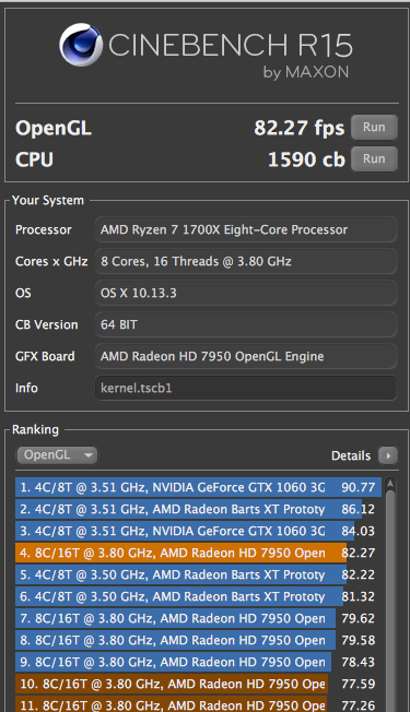

jsl2000 Posted August 26, 2018 Share Posted August 26, 2018 (edited) 5 hours ago, AlGrey said: report the full sysctl -a output please Will have to look into this, but I have an idea what it could be ok so pretty much none 1700X-tscb1.txt 1700X-backup.txt FX6300-tscb1.txt FX6300-backup.txt Thanks for your kernel.tscb1 which worked smoothly in both Ryzen 1700X & FX-6300 hackintoshs. Solved previous wake-up --> reboot issue with GPU AMD Radeon 6870: (1) need roll-back to previous version of WhateverGreen.kext (1.1.2) instead of update to newer version (2) config.plist : Graphics/RadeonDeInit & Devices/Arbitrary/ (AMD sleep patch for 10.13.2 or higher need Lilu + WhateverGreen) Edited August 27, 2018 by jsl2000 1 Link to comment https://www.insanelymac.com/forum/topic/325514-amd-high-sierra-kernel-release-and-testing/page/41/#findComment-2631830 Share on other sites More sharing options...
fagneroliveira Posted August 27, 2018 Share Posted August 27, 2018 Sorry ALGrey I had problems with the prelinked the output for fx8320 more the cinebench result geek bench OpenCL = 187310 sys-a-tscb1.txt Link to comment https://www.insanelymac.com/forum/topic/325514-amd-high-sierra-kernel-release-and-testing/page/41/#findComment-2631832 Share on other sites More sharing options...

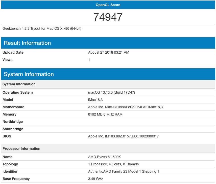

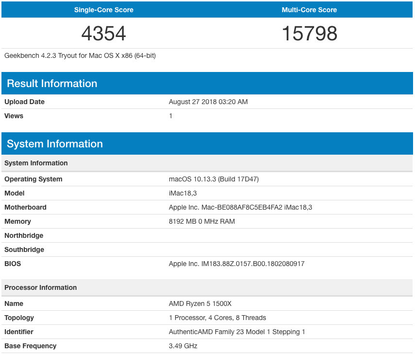

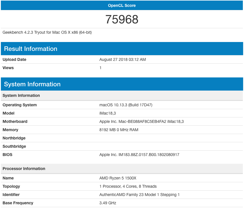

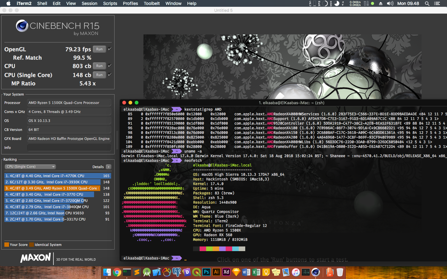

sembrex Posted August 27, 2018 Share Posted August 27, 2018 Benchmark result comparison between @Shaneee kernel and @Bronya kernel Shaneee kernel Spoiler Bronya kernel Spoiler Link to comment https://www.insanelymac.com/forum/topic/325514-amd-high-sierra-kernel-release-and-testing/page/41/#findComment-2631841 Share on other sites More sharing options...

jsl2000 Posted August 28, 2018 Share Posted August 28, 2018 6 hours ago, AlGrey said: any improvement with this one ? kernel.t3.zip Unfortunately this kernel.t3 got instant reboot in my FX-6300 hackintosh ! Link to comment https://www.insanelymac.com/forum/topic/325514-amd-high-sierra-kernel-release-and-testing/page/41/#findComment-2632004 Share on other sites More sharing options...

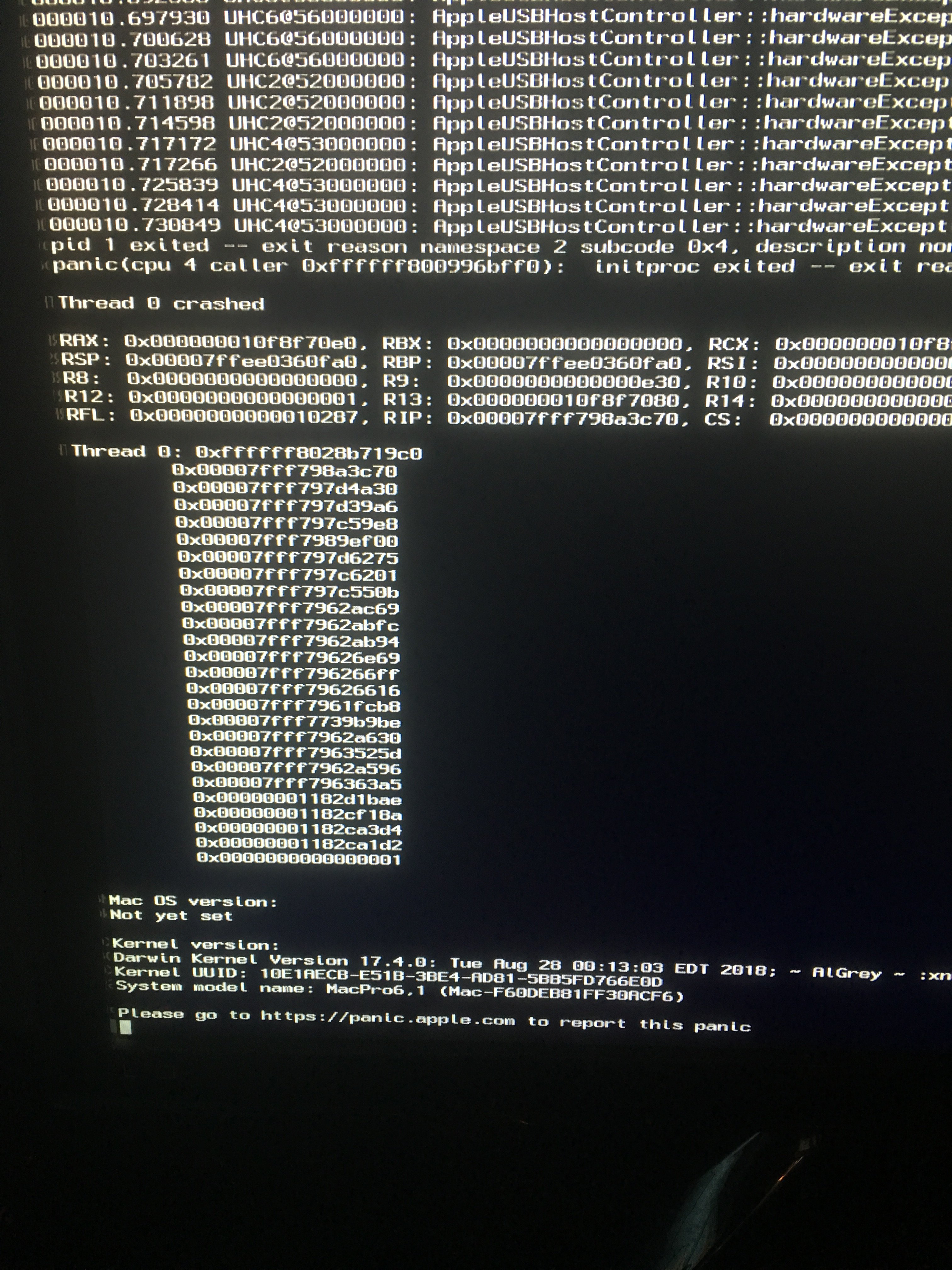

fagneroliveira Posted August 28, 2018 Share Posted August 28, 2018 9 hours ago, AlGrey said: any improvement with this one ? kernel.t3.zip kernel panic Link to comment https://www.insanelymac.com/forum/topic/325514-amd-high-sierra-kernel-release-and-testing/page/41/#findComment-2632021 Share on other sites More sharing options...
