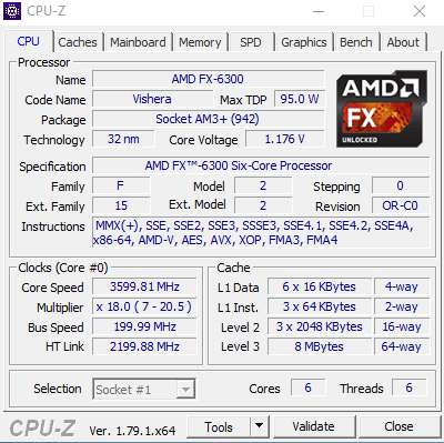

jsl2000 Posted August 19, 2018 Share Posted August 19, 2018 (edited) Just now, Shaneee said: Can you please share a screenshot of CPU-Z in Windows and the output of this in terminal please sysctl -a | grep hw. FX-6300.txt Edited August 19, 2018 by jsl2000 Link to comment https://www.insanelymac.com/forum/topic/325514-amd-high-sierra-kernel-release-and-testing/page/40/#findComment-2630777 Share on other sites More sharing options...

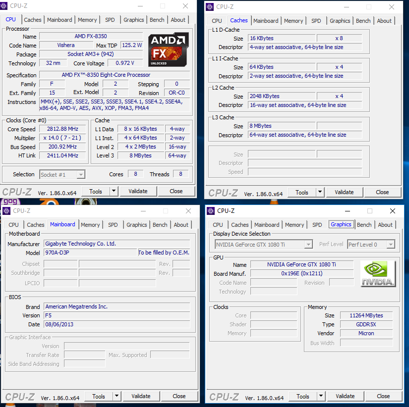

fagneroliveira Posted August 19, 2018 Share Posted August 19, 2018 (edited) For amd FX 8350 the new kernel is more smooth Nvidia on cinebench have 40 fps before 29 cinebench cpu without pstate 490 before 230 ethernet load but no connection. sys.rtf Edited August 19, 2018 by fagneroliveira wrong image Link to comment https://www.insanelymac.com/forum/topic/325514-amd-high-sierra-kernel-release-and-testing/page/40/#findComment-2630805 Share on other sites More sharing options...
Shaneee Posted August 19, 2018 Share Posted August 19, 2018 7 hours ago, jsl2000 said: FX-6300.txt Great. Can you test this one please and if it boots fine the same sysctl output please. You can use kcsuffix=test to boot it once you've run sudo kextcache -u / to build prelinkedkernel.test kernel.test.zip Link to comment https://www.insanelymac.com/forum/topic/325514-amd-high-sierra-kernel-release-and-testing/page/40/#findComment-2630847 Share on other sites More sharing options...

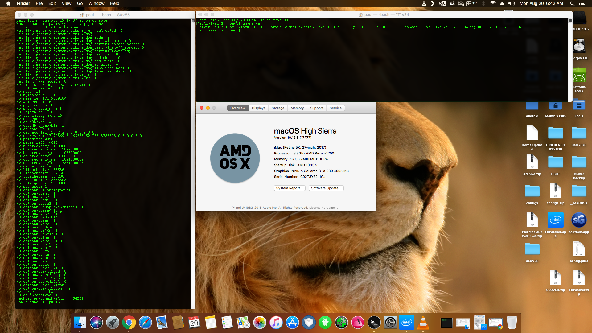

Shaneee Posted August 20, 2018 Share Posted August 20, 2018 2 hours ago, tikizondo94 said: Hey Shaneee, just noticed with your latest test kernel I'm noticing video playback lag. Tested with VLC, IINA, and MPV. All are laggy. Quicktime playback works normal. Can you share a CPU-Z screenshot from Windows and the full output from sysctl -a please. Also test latest kernel. Use kcsuffix to test it. Link to comment https://www.insanelymac.com/forum/topic/325514-amd-high-sierra-kernel-release-and-testing/page/40/#findComment-2630923 Share on other sites More sharing options...
tikizondo94 Posted August 20, 2018 Share Posted August 20, 2018 (edited) 44 minutes ago, Shaneee said: Can you share a CPU-Z screenshot from Windows and the full output from sysctl -a please. Also test latest kernel. Use kcsuffix to test it. Sure Shaneee. CPU Outputs.rar DESKTOP-CUFK5QD.txt Terminal Saved Output.txt Edited August 20, 2018 by tikizondo94 Link to comment https://www.insanelymac.com/forum/topic/325514-amd-high-sierra-kernel-release-and-testing/page/40/#findComment-2630927 Share on other sites More sharing options...
Shaneee Posted August 20, 2018 Share Posted August 20, 2018 6 minutes ago, tikizondo94 said: Sure Shaneee. CPU Outputs.rar DESKTOP-CUFK5QD.txt Terminal Saved Output.txt Do you have any settings enabled in Clover for the CPU or the APIC.aml file from my Discord? If so remove them. Link to comment https://www.insanelymac.com/forum/topic/325514-amd-high-sierra-kernel-release-and-testing/page/40/#findComment-2630930 Share on other sites More sharing options...

Shaneee Posted August 20, 2018 Share Posted August 20, 2018 That's ok then. Try this kernel with the boot arg -enableleaf see if there is a change in playback. Use kcsuffix=test to boot with it once you've built the prelinkedkernel for it. kernel.test.zip Link to comment https://www.insanelymac.com/forum/topic/325514-amd-high-sierra-kernel-release-and-testing/page/40/#findComment-2630937 Share on other sites More sharing options...
tikizondo94 Posted August 20, 2018 Share Posted August 20, 2018 30 minutes ago, Shaneee said: That's ok then. Try this kernel with the boot arg -enableleaf see if there is a change in playback. Use kcsuffix=test to boot with it once you've built the prelinkedkernel for it. kernel.test.zip Latest test seems to play video flawlessly. But i cannot boot with -enableleaf added. Terminal Saved Output.txt Link to comment https://www.insanelymac.com/forum/topic/325514-amd-high-sierra-kernel-release-and-testing/page/40/#findComment-2630942 Share on other sites More sharing options...
Shaneee Posted August 20, 2018 Share Posted August 20, 2018 1 minute ago, tikizondo94 said: Latest test seems to play video flawlessly. But i cannot boot with -enableleaf added. Terminal Saved Output.txt Any errors when booting? Works on my Ryzen 5 2400G. Link to comment https://www.insanelymac.com/forum/topic/325514-amd-high-sierra-kernel-release-and-testing/page/40/#findComment-2630943 Share on other sites More sharing options...

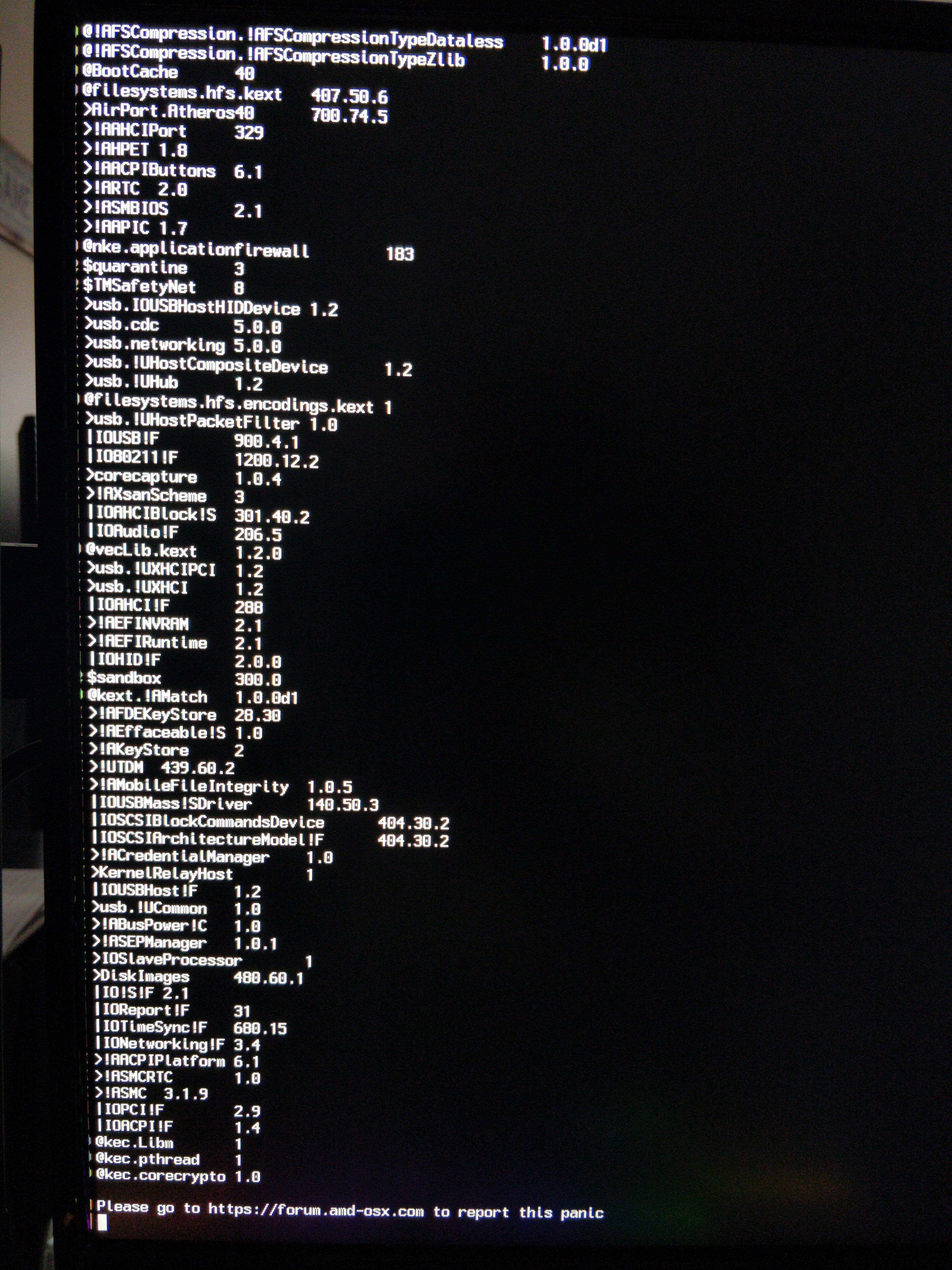

tikizondo94 Posted August 20, 2018 Share Posted August 20, 2018 33 minutes ago, Shaneee said: Any errors when booting? Works on my Ryzen 5 2400G. Just gets stuck at the apple loading boot screen. Loading line makes it a quarter of the way and locks. "with -enableleaf added" Send me Pauls-iMac.zip Link to comment https://www.insanelymac.com/forum/topic/325514-amd-high-sierra-kernel-release-and-testing/page/40/#findComment-2630948 Share on other sites More sharing options...
Shaneee Posted August 20, 2018 Share Posted August 20, 2018 5 minutes ago, tikizondo94 said: Just gets stuck at the apple loading boot screen. Loading line makes it a quarter of the way and locks. "with -enableleaf added" Send me Pauls-iMac.zip Boot with verbose and see what's causing the issue. Link to comment https://www.insanelymac.com/forum/topic/325514-amd-high-sierra-kernel-release-and-testing/page/40/#findComment-2630949 Share on other sites More sharing options...
tikizondo94 Posted August 20, 2018 Share Posted August 20, 2018 7 minutes ago, Shaneee said: Boot with verbose and see what's causing the issue. This is where it locks. Link to comment https://www.insanelymac.com/forum/topic/325514-amd-high-sierra-kernel-release-and-testing/page/40/#findComment-2630954 Share on other sites More sharing options...
Shaneee Posted August 20, 2018 Share Posted August 20, 2018 Ohh ok shall work on the Leaf7 features. At least your video issue is fixed there. Also Please go to https://forum.amd-osx.com to report this panic 1 Link to comment https://www.insanelymac.com/forum/topic/325514-amd-high-sierra-kernel-release-and-testing/page/40/#findComment-2630957 Share on other sites More sharing options...

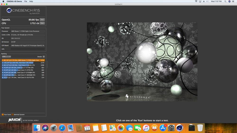

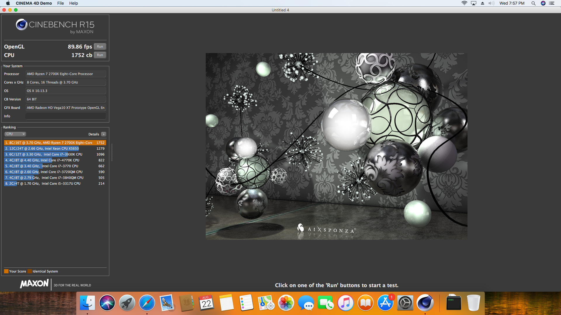

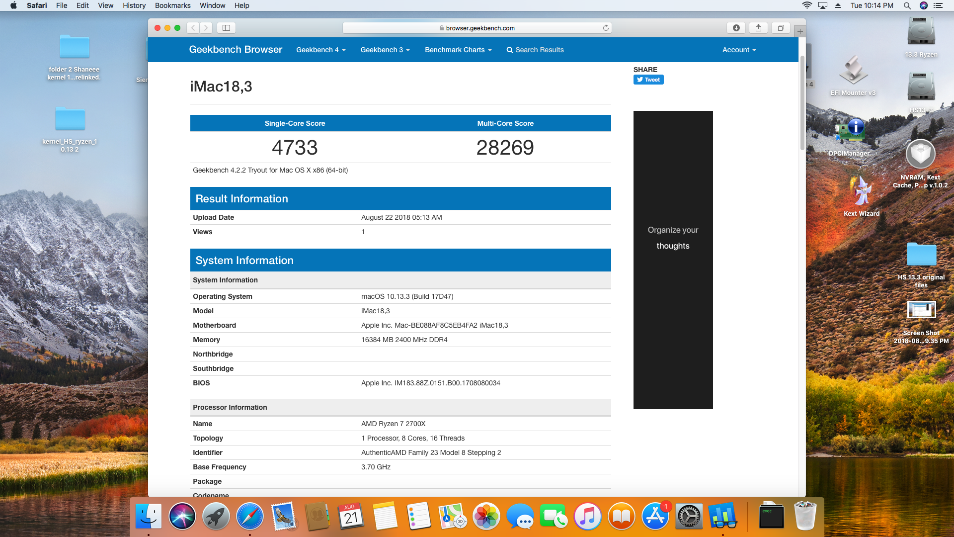

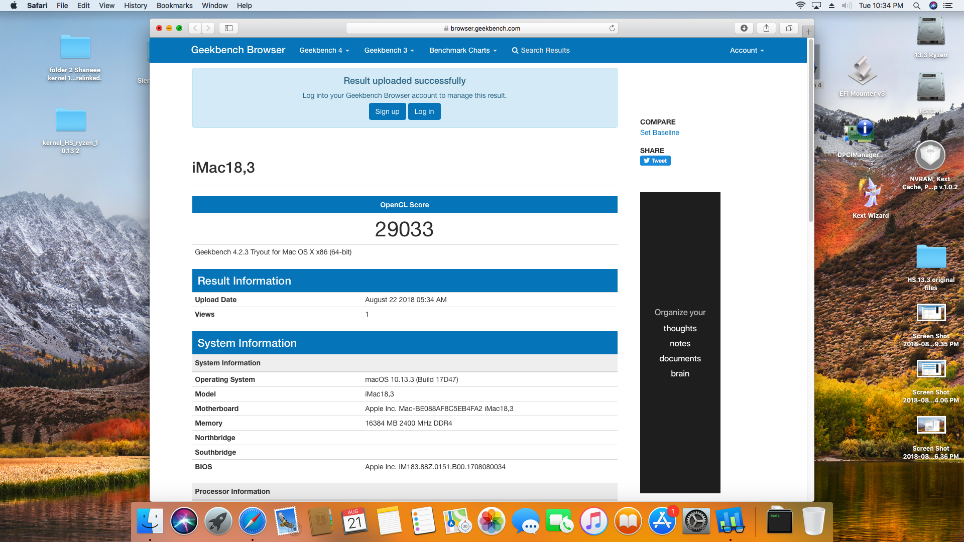

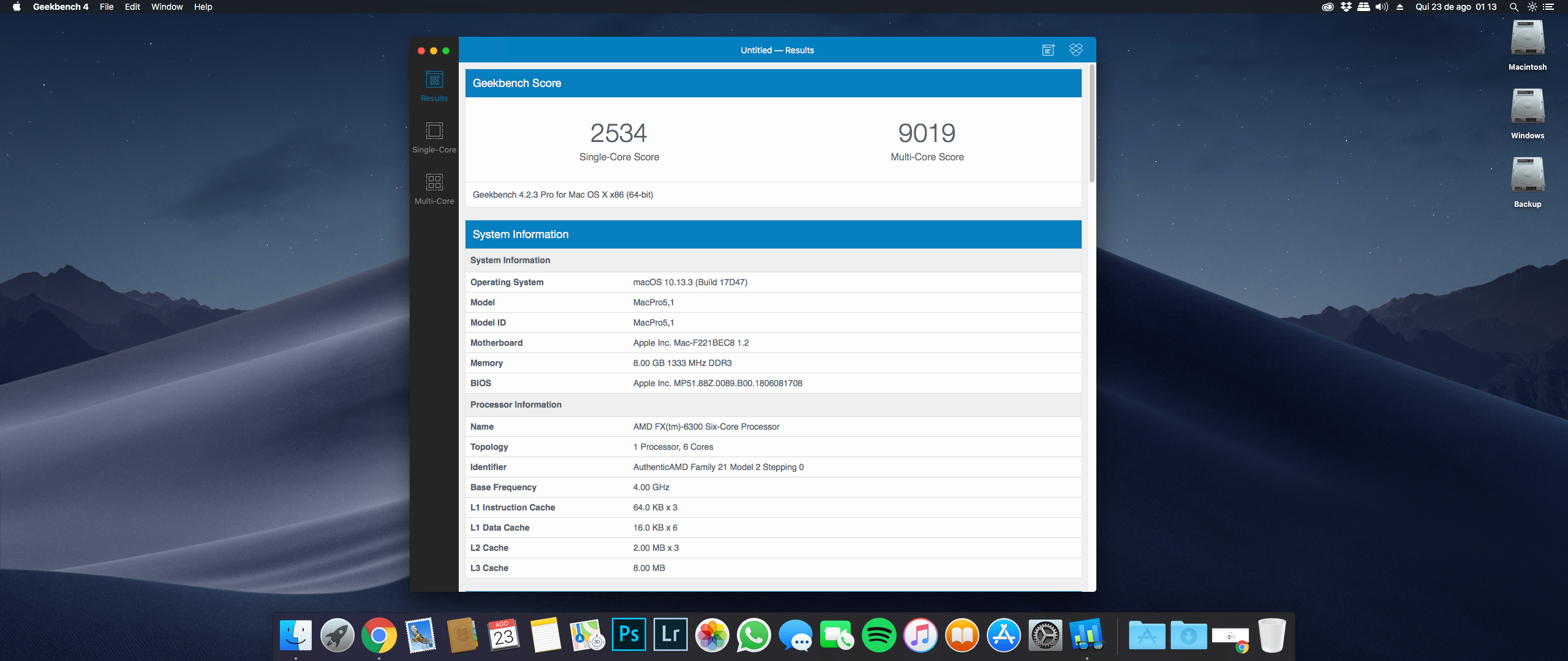

Gigamaxx Posted August 23, 2018 Author Share Posted August 23, 2018 (edited) I finally got to test the new kernel with R7 2700X, the 8 cores 16 threads works great and Geekbench score is good. However, for some reason my Vega 64 card is scoring really low @ 28000 points. I replaced with your old kernel and it went back up to 170,000. Replaced the kernel again and many relinked kernel reloads but it keeps getting low score. Luxmark is fine and cinebencz is ok but Geekbench is not even close for some reason. I'll download again and try over to confirm. I retested and have same results. I tried my RX 480 and I get black screen. I put lilu and weg Kexts in and same issue. I* tested my R7 265 (AKA R9 270X0 it has the same low score in Geekbench compute. On on a side note: I tested the iMac Pro 1.1 definition and it won’t even load the pre kernel, no +++++++++++++ at all. Edited August 24, 2018 by Gigamaxx Update 1 Link to comment https://www.insanelymac.com/forum/topic/325514-amd-high-sierra-kernel-release-and-testing/page/40/#findComment-2631335 Share on other sites More sharing options...

AlGrey Posted August 24, 2018 Share Posted August 24, 2018 On 8/22/2018 at 11:50 PM, Gigamaxx said: I finally got to test the new kernel with R7 2700X, the 8 cores 16 threads works great and Geekbench score is good. However, for some reason my Vega 64 card is scoring really low @ 28000 points. I replaced with your old kernel and it went back up to 170,000. Replaced the kernel again and many relinked kernel reloads but it keeps getting low score. Luxmark is fine and cinebencz is ok but Geekbench is not even close for some reason. I'll download again and try over to confirm. I retested and have same results. I tried my RX 480 and I get black screen. I put lilu and weg Kexts in and same issue. I* tested my R7 265 (AKA R9 270X0 it has the same low score in Geekbench compute. On on a side note: I tested the iMac Pro 1.1 definition and it won’t even load the pre kernel, no +++++++++++++ at all. give this one a try kernel.test.zip 1 Link to comment https://www.insanelymac.com/forum/topic/325514-amd-high-sierra-kernel-release-and-testing/page/40/#findComment-2631498 Share on other sites More sharing options...
Gigamaxx Posted August 24, 2018 Author Share Posted August 24, 2018 (edited) 50 minutes ago, AlGrey said: give this one a try kernel.test.zip Nice, thanks it works! R7 265 Geekbench now 82,000 up from 28,000. RX Vega 64 @ 170,000. Edited August 24, 2018 by Gigamaxx 1 Link to comment https://www.insanelymac.com/forum/topic/325514-amd-high-sierra-kernel-release-and-testing/page/40/#findComment-2631502 Share on other sites More sharing options...
