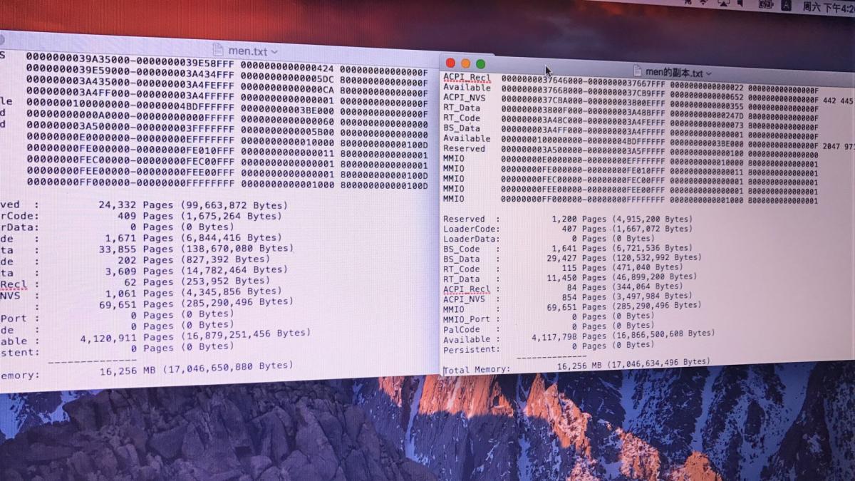

gujiangjiang Posted May 13, 2017 Share Posted May 13, 2017 Today i have update the bios to 1.2.25 but cant boot into osx ever. I changed osxaptiodrv-64 to v2 but still cant boot. I add slide=32 64 but all cant boot into osx. 从我的 iPhone 发送,使用 Tapatalk Link to comment https://www.insanelymac.com/forum/topic/319764-guide-dell-xps-15-9550-mojave-1014-1015-quick-installation/page/23/#findComment-2422686 Share on other sites More sharing options...
joginek Posted May 13, 2017 Share Posted May 13, 2017 Today i have update the bios to 1.2.25 but cant boot into osx ever. I changed osxaptiodrv-64 to v2 but still cant boot. I add slide=32 64 but all cant boot into osx. 从我的 iPhone 发送,使用 Tapatalk I've got the same problem. I had to downgrade to the version before 1.2.25 and everything runs fine again. Link to comment https://www.insanelymac.com/forum/topic/319764-guide-dell-xps-15-9550-mojave-1014-1015-quick-installation/page/23/#findComment-2422706 Share on other sites More sharing options...
Krim404 Posted May 13, 2017 Author Share Posted May 13, 2017 Today i have update the bios to 1.2.25 but cant boot into osx ever. I changed osxaptiodrv-64 to v2 but still cant boot. I add slide=32 64 but all cant boot into osx. 从我的 iPhone 发送,使用 Tapatalk what error comes up when you try to boot? Link to comment https://www.insanelymac.com/forum/topic/319764-guide-dell-xps-15-9550-mojave-1014-1015-quick-installation/page/23/#findComment-2422719 Share on other sites More sharing options...

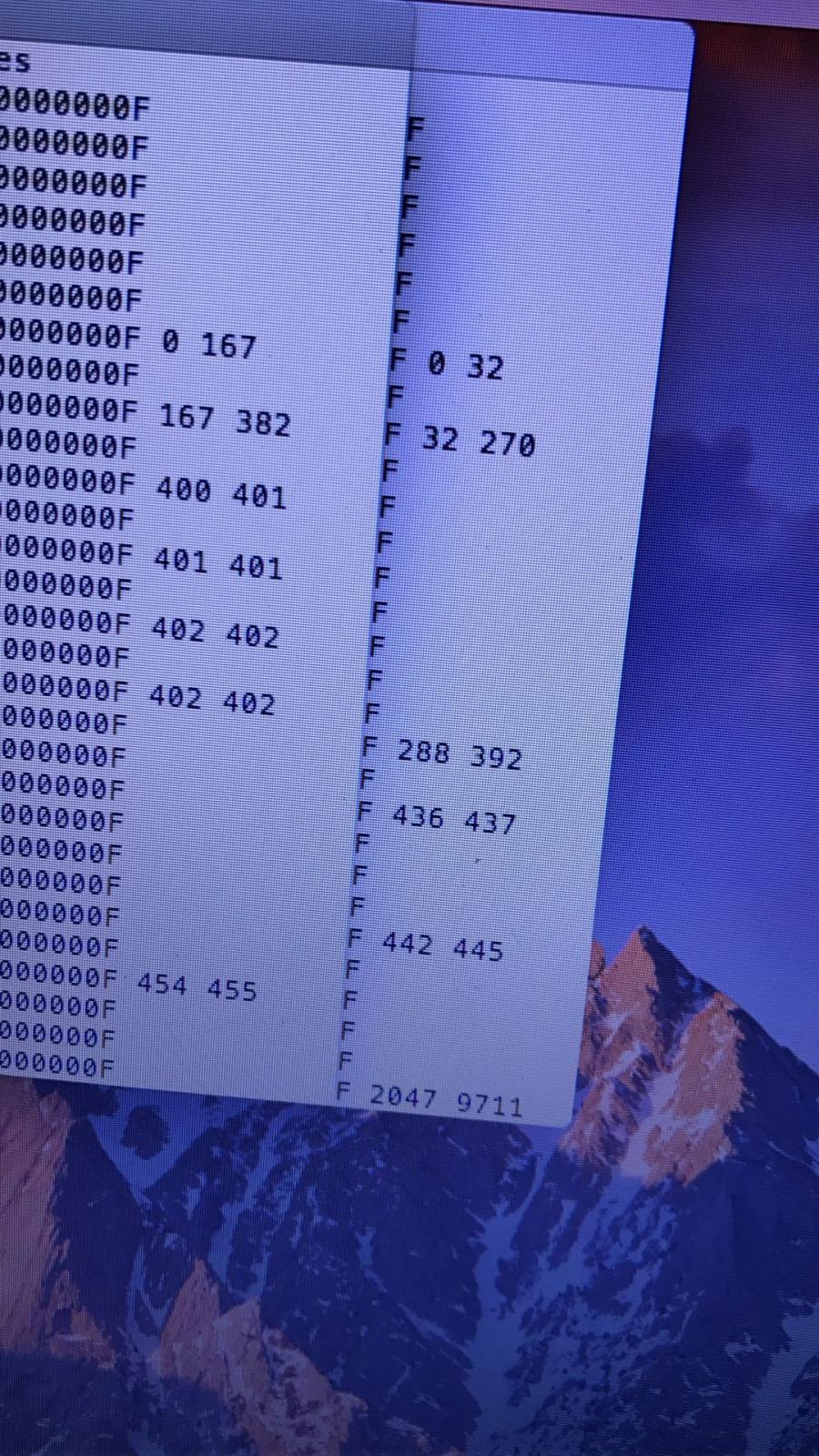

gujiangjiang Posted May 13, 2017 Share Posted May 13, 2017 I've got the same problem. I had to downgrade to the version before 1.2.25 and everything runs fine again. what error comes up when you try to boot? Report Change OSXAptioDrv-64.efi to OSXAptioDrv2-64.efi + slide=168 can boot into osx with no error. And i have found a big change in menmap. Here are the picture. Left is 1.2.25 and Right is 1.2.21 you can compare the difference. So i found some slide number and test sometimes and found slide=168 or slide=170 can boot osx perfect. And now we can use v2 instead of v1 just replace v2 and add slide=168 or 170. Good Luck. If someone have more ideal you can replay later. 2 Link to comment https://www.insanelymac.com/forum/topic/319764-guide-dell-xps-15-9550-mojave-1014-1015-quick-installation/page/23/#findComment-2422742 Share on other sites More sharing options...
goodwin_c Posted May 13, 2017 Share Posted May 13, 2017 Report Change OSXAptioDrv-64.efi to OSXAptioDrv2-64.efi + slide=168 can boot into osx with no error. And i have found a big change in menmap. Here are the picture. Left is 1.2.25 and Right is 1.2.21 you can compare the difference. E5D6174CBAFAF9239FDB33D2B7D464A4.jpg So i found some slide number and test sometimes and found slide=168 or slide=170 can boot osx perfect. F4447DD79D81BE4F02E1E0BBF12F6021.jpg And now we can use v2 instead of v1 just replace v2 and add slide=168 or 170. Good Luck. If someone have more ideal you can replay later. Hi, can you attach original files with memmaps? Want to check what has been changed in new bios. Also, regarding aptiofix v2 - it was always working, just needed proper slide. But with slide it is working not very properly - for ex., you will loose Safe Mode (as this case is not covered in aptiofix-v2, and slide parameter breaks safe mode) 1 Link to comment https://www.insanelymac.com/forum/topic/319764-guide-dell-xps-15-9550-mojave-1014-1015-quick-installation/page/23/#findComment-2423013 Share on other sites More sharing options...

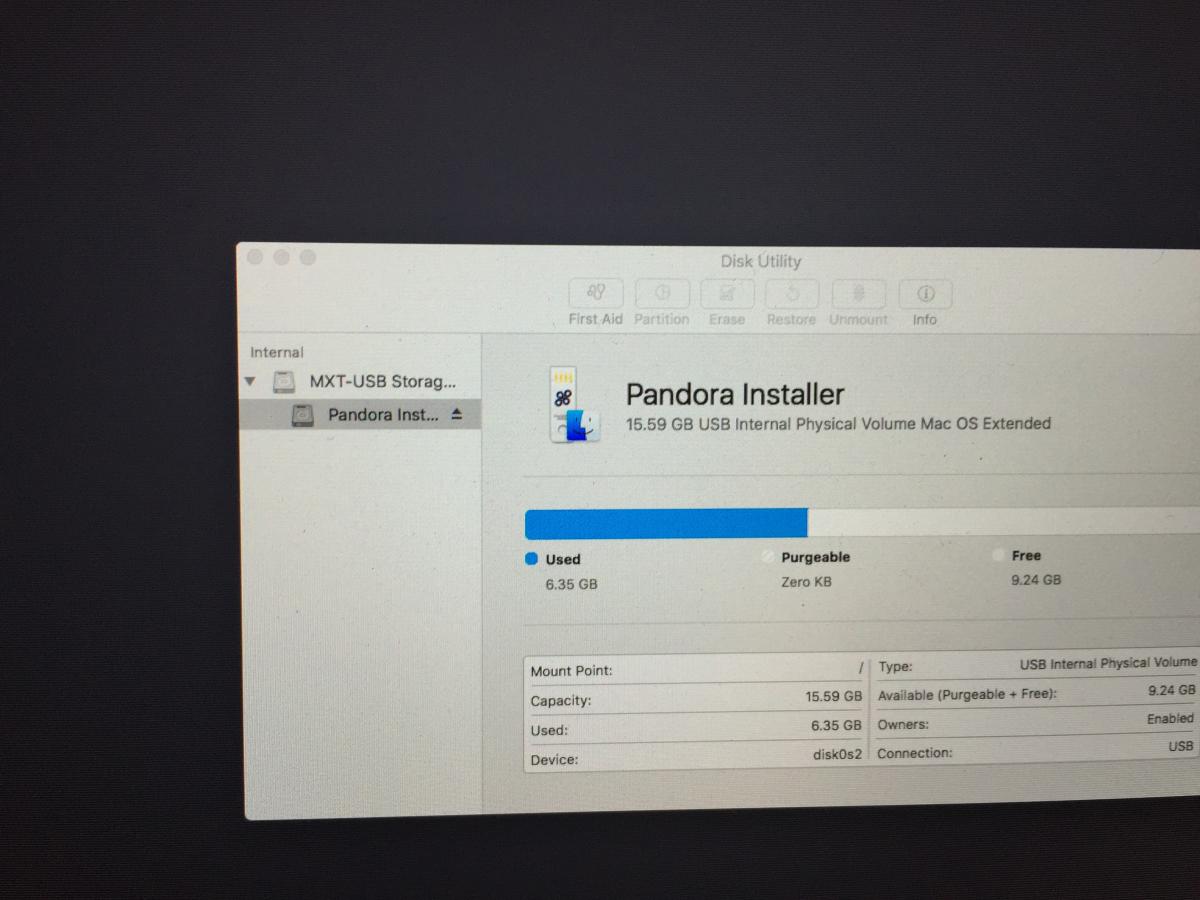

Kndtime Posted May 14, 2017 Share Posted May 14, 2017 Hi, First of all thank you all for this amazing tutorial and thread! I have been struggling to install Sierra on my XPS 15. Can someone post a picture of his BIOS configuration? I not really sure I have done it right.. My problem is that I can't select my SSD to format and install Sierra on.. Can someone help me? Link to comment https://www.insanelymac.com/forum/topic/319764-guide-dell-xps-15-9550-mojave-1014-1015-quick-installation/page/23/#findComment-2423553 Share on other sites More sharing options...
