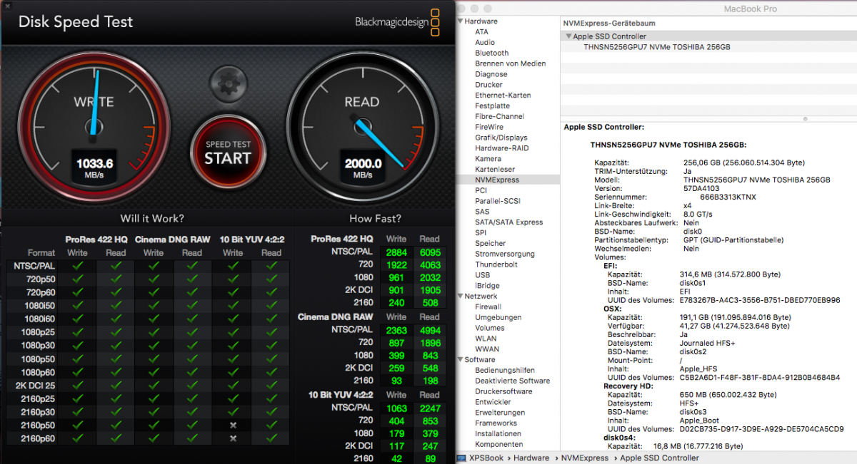

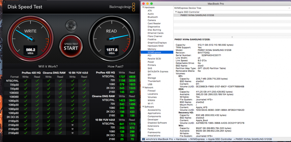

gujiangjiang Posted May 8, 2017 Share Posted May 8, 2017 it is capable, i'm running it on 4k. Tbh: i trust nvme-cli more than the windows tools. ;-) THNSN5512GPU7 NVMe TOSHIBA 512GB: Capacity: 512,11 GB (512.110.190.592 Byte) TRIM-Support: Yes Model: THNSN5512GPU7 NVMe TOSHIBA 512GB Version: 57DA4103 $ diskutil info / | grep Block Device Block Size: 4096 Bytes Allocation Block Size: 4096 Bytes however - did the windows tools with my already patched one and looks fine: Hello wmchris. I Have replace a new THNSN5512GPU7 XG3 SSD from Dell and i want to know how about your xg3? Is it still in 4ksector without any error? And what about the ePSA? Thanks. Link to comment https://www.insanelymac.com/forum/topic/319764-guide-dell-xps-15-9550-mojave-1014-1015-quick-installation/page/22/#findComment-2419844 Share on other sites More sharing options...
Krim404 Posted May 9, 2017 Author Share Posted May 9, 2017 My XG3 broke down last week (burned) after using ePSA. It's a warranty replacement. May be a coincidence, but its possible that ePSA is the culprit. So i would suggest not using it anymore. Sadly i got a Samsung drive from Dell (which is much slower than the original Toshiba drive) and they dont accept to deliver me another toshiba drive or anything comparable, because "the samsung drive is in working condition" and "it will work on windows, and we only support windows" as well as "you have to live with it". Also Samsung doesnt support 4Kn sectors, because switching to 4Kn on the Samsung drives is "a company secret" - they really answered with this phrase on my request. And yes. the Samsung drives are the slowest in the 9550 series. up to 50-70% slower than the hynix, toshiba or lite-on. See attached images i created with my other original (but only 256gb) toshiba disk vs the new samsung (btw: test is capped at 2000, it's > than 2400) 1 Link to comment https://www.insanelymac.com/forum/topic/319764-guide-dell-xps-15-9550-mojave-1014-1015-quick-installation/page/22/#findComment-2420478 Share on other sites More sharing options...
