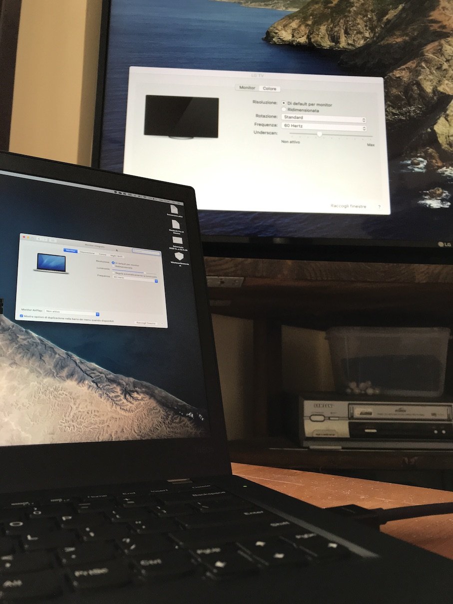

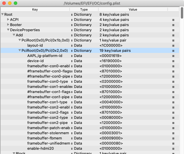

nijhawank Posted April 9, 2020 Share Posted April 9, 2020 50 minutes ago, simprecicchiani said: I managed to get audio through HDMI working by setting framebuffer-cons2-type to 00080000. I still get black internal screen (disabled) when connected to external monitor. This was my configuration with Clover. I do remember testing it with my TV but don't remember did I check the Audio, I assume it was working. I haven't enabled it with the OC based setup yet. <key>PciRoot(0x0)/Pci(0x2,0x0)</key> <dict> <key>#framebuffer-con2-flags</key> <data>hwEAAA==</data> <key>#framebuffer-con2-pipe</key> <data>EgAAAA==</data> <key>AAPL,ig-platform-id</key> <data>AAAWGQ==</data> <key>device-id</key> <data>FhkAAA==</data> <key>enable-hdmi20</key> <data>AQAAAA==</data> <key>framebuffer-con2-enable</key> <integer>1</integer> <key>framebuffer-con2-type</key> <data>AAgAAA==</data> <key>framebuffer-fbmem</key> <data>AACQAA==</data> <key>framebuffer-patch-enable</key> <data>AQAAAA==</data> <key>framebuffer-stolenmem</key> <data>AAAwAQ==</data> <key>framebuffer-unifiedmem</key> <data>AAAAgA==</data> </dict> Link to comment https://www.insanelymac.com/forum/topic/315451-guide-lenovo-t460t470-macos-with-clover-and-opencore/page/45/#findComment-2716471 Share on other sites More sharing options...
simprecicchiani Posted April 9, 2020 Share Posted April 9, 2020 (edited) 12 hours ago, nijhawank said: This was my configuration with Clover. I do remember testing it with my TV but don't remember did I check the Audio, I assume it was working. I haven't enabled it with the OC based setup yet. Thanks! Putting together thoughts gathered from different sources is what made my configuration working in the first place. I’ll figure something out of it. I‘ve tried to understand something from whatevergreen FAQs but informations are really specific and at the same time minimalistic. How did you set this up? Edited April 10, 2020 by simprecicchiani Link to comment https://www.insanelymac.com/forum/topic/315451-guide-lenovo-t460t470-macos-with-clover-and-opencore/page/45/#findComment-2716493 Share on other sites More sharing options...
nijhawank Posted April 9, 2020 Share Posted April 9, 2020 Sorry, I don't remember the guide that I followed to make it work. Link to comment https://www.insanelymac.com/forum/topic/315451-guide-lenovo-t460t470-macos-with-clover-and-opencore/page/45/#findComment-2716496 Share on other sites More sharing options...
simprecicchiani Posted April 10, 2020 Share Posted April 10, 2020 (edited) @nijhawank adding flags and pipe to HDMI connector made the trick! Thank you again. Edited April 10, 2020 by simprecicchiani Link to comment https://www.insanelymac.com/forum/topic/315451-guide-lenovo-t460t470-macos-with-clover-and-opencore/page/45/#findComment-2716548 Share on other sites More sharing options...
