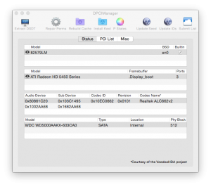

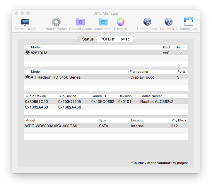

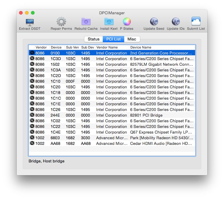

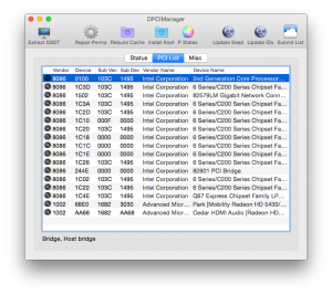

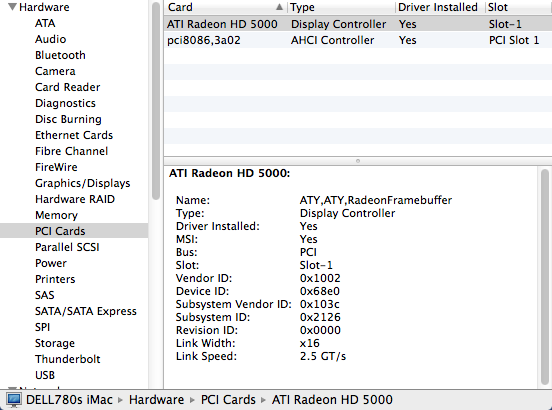

kaplishkap011 Posted January 4, 2017 Share Posted January 4, 2017 Ok, then post your clean DSDT (as zip file) and poste pictures from the DPCIManager from the tab "Status" and "PCIList" !!! I'll see what I can do. Ioreg would be good too. Here the pictures and dsdt Got it . It's 0x68E01002 not 68E01002 ! You can upload files by zipping them and using "More replay options" button. I all ready tried with 0x DSDT.aml.zip Link to comment https://www.insanelymac.com/forum/topic/312656-guide-macos-sierra-1012-dell-optiplex-780-760-755-790-990/page/9/#findComment-2344415 Share on other sites More sharing options...

polyzargone Posted January 4, 2017 Share Posted January 4, 2017 I can give a try but I would also need an IOReg extracted with this (Menu File > Save as…). Thx. Link to comment https://www.insanelymac.com/forum/topic/312656-guide-macos-sierra-1012-dell-optiplex-780-760-755-790-990/page/9/#findComment-2344434 Share on other sites More sharing options...
polyzargone Posted January 4, 2017 Share Posted January 4, 2017 Try this one (place it in EFI/CLOVER/ACPI/patched) : DSDT.aml.zip 1 Link to comment https://www.insanelymac.com/forum/topic/312656-guide-macos-sierra-1012-dell-optiplex-780-760-755-790-990/page/9/#findComment-2344670 Share on other sites More sharing options...

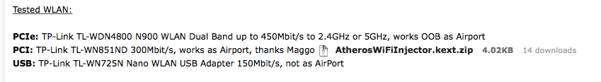

goodguess Posted January 15, 2017 Share Posted January 15, 2017 Thanks folks for this very profund guide. I did upgrade my Dell 780 El Cap backup drive with Sierra with the files provided in the first post. Things are looking good except for the TP-Link TL-WN851ND WLAN. Of course I added the strings in the plist and let Kext Utility do its thing. The Dell´s WLAN is on, but it it does not see my WLAN hotspots. Am I missing something obvious? El Cap and earlier do work with equal hardware of course. Link to comment https://www.insanelymac.com/forum/topic/312656-guide-macos-sierra-1012-dell-optiplex-780-760-755-790-990/page/9/#findComment-2350142 Share on other sites More sharing options...
MacPeet Posted January 16, 2017 Author Share Posted January 16, 2017 Try AtherosWiFiInjector.kext from post #1 with original IO8211Family.kext. AtherosWiFiInjector.kext in EFI/Clover/kexts/10.12/ (or others, if you did not create 10.12). TP-Link TL-WN851ND works well with Sierra. 1 Link to comment https://www.insanelymac.com/forum/topic/312656-guide-macos-sierra-1012-dell-optiplex-780-760-755-790-990/page/9/#findComment-2350607 Share on other sites More sharing options...

goodguess Posted January 17, 2017 Share Posted January 17, 2017 Works like a charm again thanks to your hint. I must have over read the kext inject thing. I´ll clone the Sierra instance and try it with the backup 780 one of these days. Won´t be a big thing to swap the graphics card eventually, it was good enough for 10.9 and W10 though. Link to comment https://www.insanelymac.com/forum/topic/312656-guide-macos-sierra-1012-dell-optiplex-780-760-755-790-990/page/9/#findComment-2351673 Share on other sites More sharing options...
