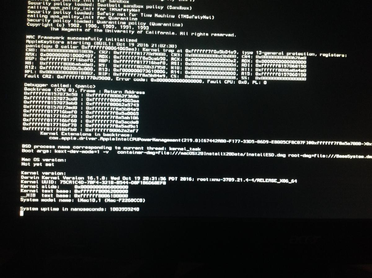

morpheousman Posted November 12, 2016 Share Posted November 12, 2016 Well, I am about ready to take the plunge here. Probably going to need MacPeets help with my Optiplex 790 Audio. I am going to backup the partition first. Then give it a try. Edit: I have downloaded the installer twice. Both times I have started install I get an error, "The installer payload failed signature check". Link to comment https://www.insanelymac.com/forum/topic/312656-guide-macos-sierra-1012-dell-optiplex-780-760-755-790-990/page/5/#findComment-2318144 Share on other sites More sharing options...
MacPeet Posted November 13, 2016 Author Share Posted November 13, 2016 How did you create the USB flash drive? Describe more precisely! Which SMBIOS selected? FakeSMC latest version? Clover newer version? FakeSMC in ... / kexts / 10.12 /? Kext Inject on Yes? Link to comment https://www.insanelymac.com/forum/topic/312656-guide-macos-sierra-1012-dell-optiplex-780-760-755-790-990/page/5/#findComment-2318208 Share on other sites More sharing options...
morpheousman Posted November 13, 2016 Share Posted November 13, 2016 Trying to do upgrade straight from Sierra App, had to download App several times, finally got past Error message, but now installer hangs on reboot, Tried with usb installer, and it also hangs. Link to comment https://www.insanelymac.com/forum/topic/312656-guide-macos-sierra-1012-dell-optiplex-780-760-755-790-990/page/5/#findComment-2318628 Share on other sites More sharing options...
MacPeet Posted November 14, 2016 Author Share Posted November 14, 2016 KP CPUPower ... Try SMBIOS iMac14,2 (or 14,1) and USB_Injector from post # 113! Fits better to the i7. Very little info's for us. If direct update, then all the kext's in /10.11/ and /10.12/ or /others/ ??? Your Clover version ? FakeSMC version ? (6.21.1412) DSDT and config.plist of Capitan not changed? SIP disable (0x67) ? Update: 10.12.2 DP Beta 3 16C48b --> works, no problem Link to comment https://www.insanelymac.com/forum/topic/312656-guide-macos-sierra-1012-dell-optiplex-780-760-755-790-990/page/5/#findComment-2318658 Share on other sites More sharing options...
