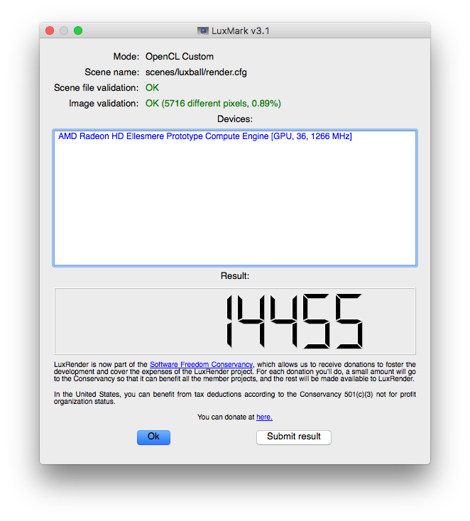

Picasso Posted June 13, 2017 Share Posted June 13, 2017 I installed a 390x to get a powerfull Open CL and FCPX, here the result attached for someone interested: http://www.insanelymac.com/forum/topic/313977-r9-nano/?p=2443850 1 Link to comment https://www.insanelymac.com/forum/topic/312582-amd-polaris-ids-on-sierra-high-sierra/page/20/#findComment-2443862 Share on other sites More sharing options...
Max.1974 Posted June 13, 2017 Share Posted June 13, 2017 I installed a 390x to get a powerfull Open CL and FCPX, here the result attached for someone interested: http://www.insanelymac.com/forum/topic/313977-r9-nano/?p=2443850 Uowwww!! Very nice Man!!! Thanks... im thinking buy another, my Sapphire is go to guarantee but im thinking different kkkkk Would you post complete description, please Picasso? Nice GPU!!! This is native on Mac? Is like that? 1 Link to comment https://www.insanelymac.com/forum/topic/312582-amd-polaris-ids-on-sierra-high-sierra/page/20/#findComment-2443866 Share on other sites More sharing options...
Picasso Posted June 13, 2017 Share Posted June 13, 2017 Uowwww!! Very nice Man!!! Thanks... im thinking buy another, my Sapphire is go to guarantee but im thinking different kkkkk Would you post complete description, please Picasso? Nice GPU!!! This is native on Mac? Is like that? This is https://www.asus.com/Graphics-Cards/STRIXR9390XDC3OC8GD5GAMING/ Link to comment https://www.insanelymac.com/forum/topic/312582-amd-polaris-ids-on-sierra-high-sierra/page/20/#findComment-2443908 Share on other sites More sharing options...

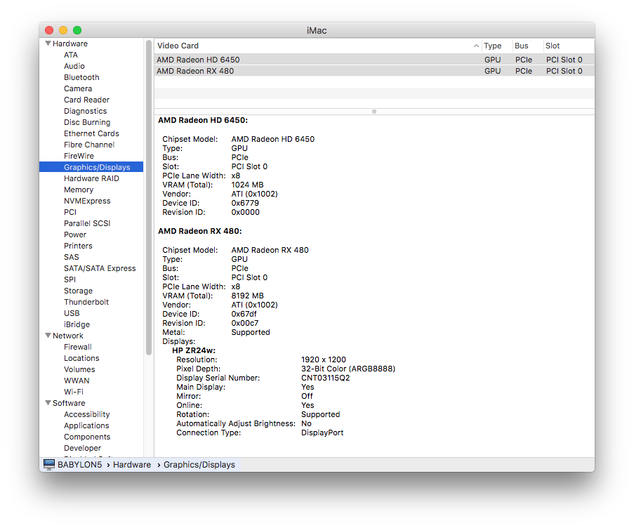

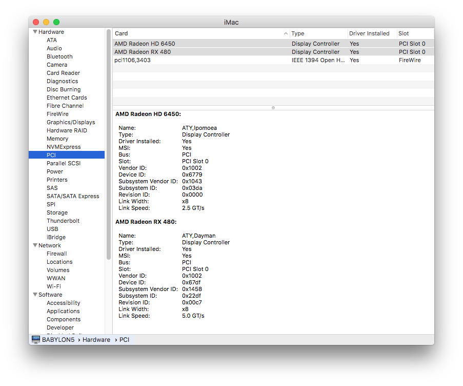

Ciro82 Posted June 14, 2017 Author Share Posted June 14, 2017 It's not clear to me how I have to chose the correct FB for my RX480/580, could someone be so kind to explain me? Thank you. Clover configurator, graphics, FB Name: Dayman Or DSDT injection 1 Link to comment https://www.insanelymac.com/forum/topic/312582-amd-polaris-ids-on-sierra-high-sierra/page/20/#findComment-2444210 Share on other sites More sharing options...
hackaro Posted June 14, 2017 Share Posted June 14, 2017 Clover configurator, graphics, FB Name: Dayman Or DSDT injection Grazie Ciro! But why Dayman? I mean 67DF is present in both AMD9500 and AMD9520. So it could be Caroni, Elqui, Florin or something else. How do you decide? Link to comment https://www.insanelymac.com/forum/topic/312582-amd-polaris-ids-on-sierra-high-sierra/page/20/#findComment-2444256 Share on other sites More sharing options...

Ur-Quan Posted June 15, 2017 Share Posted June 15, 2017 It's not clear to me how I have to chose the correct FB for my RX480/580, could someone be so kind to explain me? Thank you. http://www.insanelymac.com/forum/topic/303186-how-to-modification-of-amd-fb-clover-injection/ 1 Link to comment https://www.insanelymac.com/forum/topic/312582-amd-polaris-ids-on-sierra-high-sierra/page/20/#findComment-2445399 Share on other sites More sharing options...
