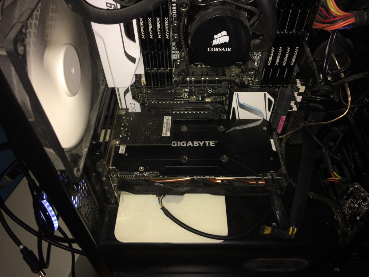

schot Posted June 17, 2017 Share Posted June 17, 2017 Well changed my builds i put the RX580 (480 flashed to 580) in a x99 board and places my gt210 as a helper card. Sierra still boot fine and works but High Sierra won't boot. I tried to boot with my install usb flash drive but won't work get a black screen in the gt210 and on the rx580. Then i tried to start the High sierra install and that worked without any problem. Anybody here with an X99 board has High Sierra running? On my old Z97 it worked very well but i can not get it booting on X99, mahbe some patches need to be done to get it working on a X99. However it is strange that my installation just starts.... i really have no idea. Also on one X99 board i have problems, it reboots after afps.efi is loaded the second time it always boots. It is not a big problem but a strange problem. Link to comment https://www.insanelymac.com/forum/topic/312582-amd-polaris-ids-on-sierra-high-sierra/page/21/#findComment-2446508 Share on other sites More sharing options...

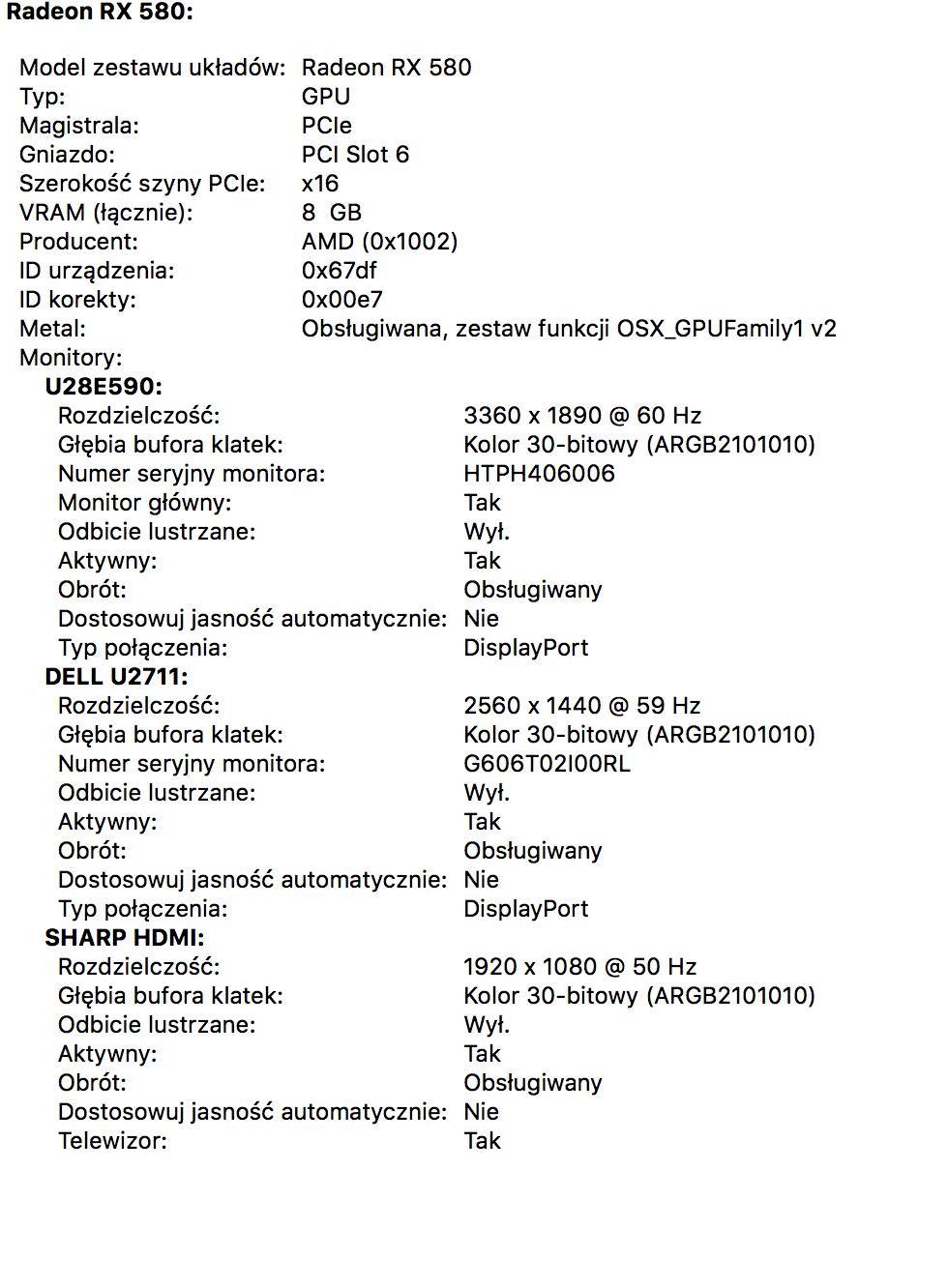

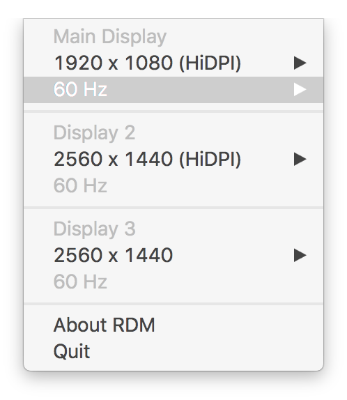

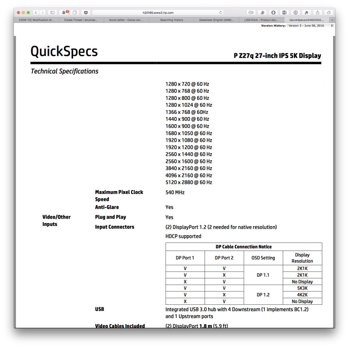

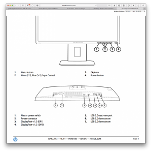

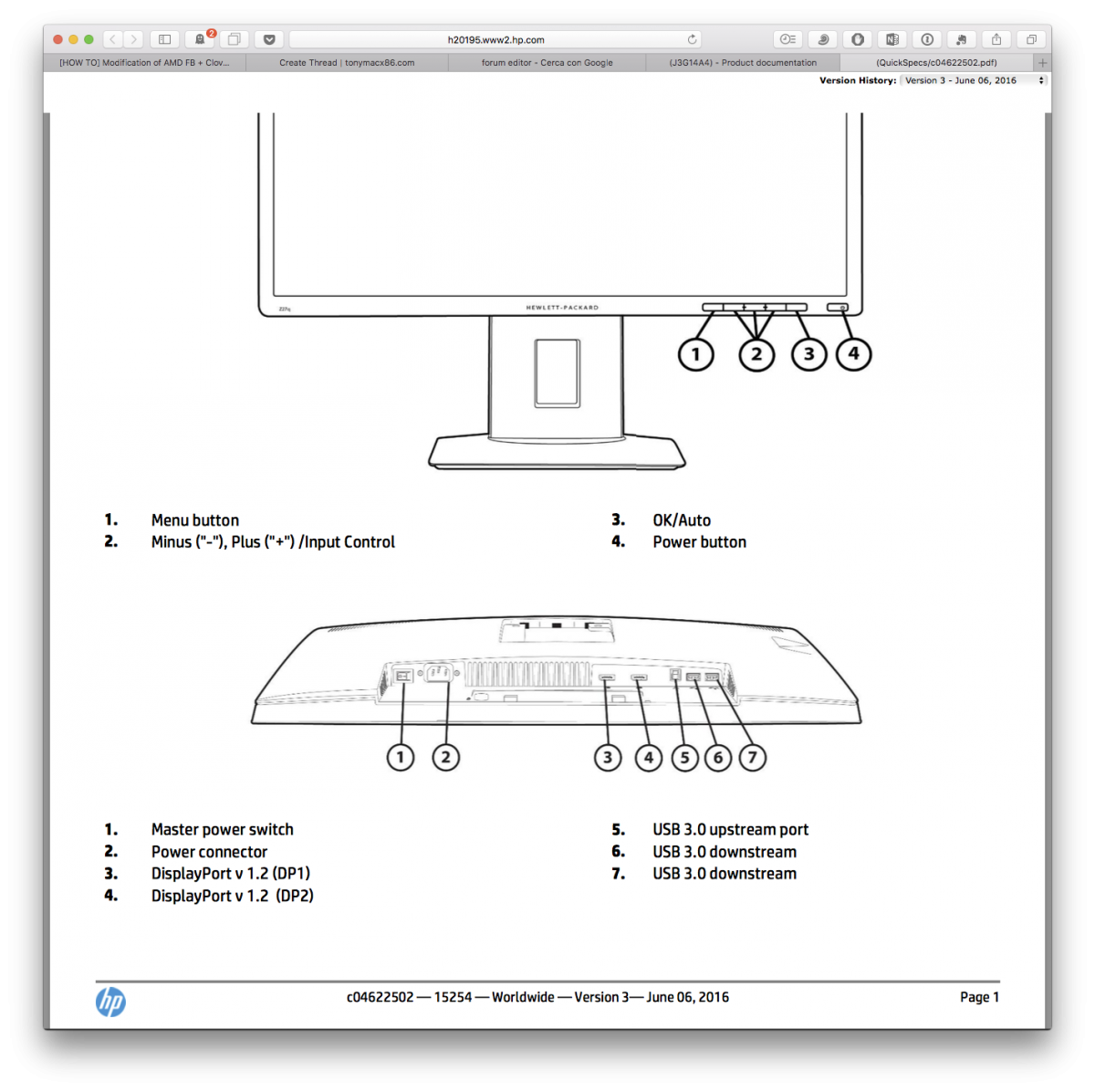

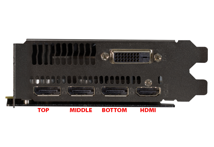

hackaro Posted June 20, 2017 Share Posted June 20, 2017 Enabling 5K display with ATI Radeon RX480/580 As matter of fact I’ve always been driven by a desire to have a 5K monitor working in a multi display configuration. Since last year I’ve jumped on the red ATI bandwagon and, in doing so, all my efforts have been moved towards ATI GPUs. My HW test configuration is the following: • SKU GA Z170-HD3 DDR3 • GPU PowerColor Radeon RX480 8GB Red Devil • GPU (alternate) PowerColor Radeon RX580 8GB Red Devil Golden Sample (it's coming...) • CPU Intel Kaby Lake I7-7700K • HP Z27Q 5K Following the guides here and here and using tools provided in the 1st posts of each guide I made all my homework and got the complete dump of the necessary infos regarding my RX480: where from left to right we have: 01 [DISPLAY_PORT] (top) 02 [DISPLAY_PORT] (middle) 03 [DISPLAY_PORT] (bottom) 04 [HDMI_TYPE_A] on the second row 05 [DVI_TYPE_D] connectors configurations are as follow in this spoiler: ============================================== 01 [DISPLAY_PORT] (top) redsock_bios_decoder : enc obj id [0x21] txmit [0x12] duallink [0x2] enc [0x4] radeon_bios_decode : Connector at index 0 Type [@offset 40862]: DisplayPort (10) Encoder [@offset 40866]: INTERNAL_UNIPHY2 (0x21) i2cid [@offset 40972]: 0x90, OSX senseid: 0x1 HotPlugID: 06 Code Costruction: 12 04 06 01 ========================================================= 02 [DISPLAY_PORT] (middle) redsock_bios_decoder : encoder obj id [0x21] txmit [0x22] duallink [0x2] enc [0x5] radeon_bios_decode : Connector at index 1 Type [@offset 40872]: DisplayPort (10) Encoder [@offset 40876]: INTERNAL_UNIPHY2 (0x21) i2cid [@offset 40999]: 0x92, OSX senseid: 0x3 HotPlugID: 04 Code Costruction: 22 05 04 03 ========================================================= 03 [DISPLAY_PORT] (bottom) redsock_bios_decoder : encoder obj id [0x20] txmit [0x11] duallink [0x1] enc [0x2] radeon_bios_decode : Connector at index 2 Type [@offset 40882]: DisplayPort (10) Encoder [@offset 40886]: INTERNAL_UNIPHY1 (0x20) i2cid [@offset 41026]: 0x91, OSX senseid: 0x2 HotPlugID: 01 Code Costruction: 11 02 01 02 ========================================================= 04 [HDMI_TYPE_A] redsock_bios_decoder : encoder obj id [0x20] txmit [0x21] duallink [0x1] enc [0x3] radeon_bios_decode : Connector at index 3 Type [@offset 40892]: HDMI-A (11) Encoder [@offset 40896]: INTERNAL_UNIPHY1 (0x20) i2cid [@offset 41053]: 0x93, OSX senseid: 0x4 HotPlugID: 05 Code Costruction: 21 03 05 04 =========================================================== 05 [DVI_TYPE_D] redsock_bios_decoder : encoder obj id [0x1e] txmit [0x10] duallink [0x0] enc [0x0] radeon_bios_decode : Connector at index 4 Type [@offset 40902]: DVI-D (3) Encoder [@offset 40906]: INTERNAL_UNIPHY (0x1e) i2cid [@offset 41080]: 0x95, OSX senseid: 0x6 HotPlugID: 03 Code Costruction: 10 00 03 06 =========================== END ============================ All the necessary dumps and scripts results are in a zip file where everyone can find the hardware details of my PowerColor. it's called archive.zip. The second piece of information needed is the correct FB to choose. AMD9500Controller — Acre, Dayman, Guariba, Huallaga 0x67E01002 0x67EF1002 0x67FF1002 0x67C01002 0x67DF1002 AMD9510Controller — Berbice 0x67EF1002 AMD9515Controller — Longavi, Mazaruni 0x67EF1002 AMD9520Controller — Caroni, Elqui, Florin 0x67E01002 0x67EF1002 0x67FF1002 0x67C01002 0x67DF1002 AMDRadeonX4100_AMDBaffinGraphicsAccelerator 0x67E01002 0x67FF1002 0x67EF1002 AMDRadeonX4150_AMDBaffinGraphicsAccelerator 0x67E01002 0x67FF1002 0x67EF1002 AMDRadeonX4200_AMDBaffinGraphicsAccelerator 0x67EF1002 0x67FF1002 AMDRadeonX4200_AMDEllesmereGraphicsAccelerator 0x67DF1002 0x67C01002 As you can see the Device ID of my card 0x67DF1002 is present in more than one kext and there are many FBs available for each Kext. After a long long examination I choose to go with Dayman but I've tried extensively also OPM which leads basically to the same results but needs much more modifications. So i Put in Clover Dayman, Inject ATI, and videoport=5. As you can see here: and rebooted. Et voilà: 5K is enabled! The correct resolution is stated in HP OSD panel. And OSX says the same: 5120*2880 HP Z27Q in About this Mac. But there are some caveats which I was not able to solve completely. NOT ALL THE DP ports are working at the same time. Only two of them can work simultaneously. I really don't know why and I ask help for solving this limit. The middle DP (2) seems to be or inactive or kind of passive... But more of this later. It's fundamental that the 1st DP port of the monitor starts as really as first. Infact HP Z27Q has the following display modes: And the main is DP is the HP_DP1 as you can see here at the point number 3. in the next figure: so HP_DP1 must start before(*) HP_DP2 for having the monitor correctly display 5K res. So you can have plenty of configurations here, all working. I.e. : GPU_DP1 <-> HP_DP1 GPU_DP2 <-> HP_DP2 or i.e.: GPU_DP1 <-> HP_DP1 GPU_DP3 <-> HP_DP2 all of them working. But unfortunately the left GPU DP is not working, no matter if you connect a 1K, or 2K or 4K display. It won't work: black screen and then monitor will go to sleep and, above all, the monitor is not present in system report, while HDMI and/or DVI were not tested at that moment. All this without any modding of the Dayman FB. All Vanilla. SO I tried to work on the FB personality to improve the situation. Let's look at the Dayman a bit closer: Dayman (6) @ 0x102370 DP, DP, DP, HDMI, DVI-D, DP 000400000403000000010101000000001204060100000000 000400000403000000010201000000002205040300000000 000400000403000000010301000000001102010200000000 000800000402000000010400000000002103050400000000 040000000402000000010500000000000000030600000000 000400000001000000010601000000002001020500000000 and as you can see, apart from the last DP, Dayman is exactly the same hw configuration of my GPU. More than that, Dayman has almost the right connectors code in place. Before modding we have: 1a row: 00040000 04030000 00010101 00000000 12 04 06 01 00000000 2a row: 00040000 04030000 00010201 00000000 22 05 04 03 00000000 3a row: 00040000 04030000 00010301 00000000 11 02 01 02 00000000 4a row: 00080000 04020000 00010400 00000000 21 03 05 04 00000000 5a row: 04000000 04020000 00010500 00000000 00 00 03 06 00000000 6a row: 00040000 00010000 00010601 00000000 20 01 02 05 00000000 and I don't consider the 6th row because my GPU has only 5 ports. After modding we have: 1a row: 00040000 04030000 00010101 00000000 12 04 06 01 00000000 2a row: 00040000 04030000 00010201 00000000 22 05 04 03 00000000 3a row: 00040000 04030000 00010301 00000000 11 02 01 02 00000000 4a row: 00080000 04020000 00010400 00000000 21 03 05 04 00000000 5a row: 04000000 04020000 00010500 00000000 10 00 03 06 00000000 the underlined byte is the only one modified. And the explanation is pretty clear as already stated in many FB modding guides: if for example, we can just consider the 1st row we have: 00 04 00 00 / Display Port 04 03 00 00 /ATY, ControlFlags 00 01 01 01 / Features 00 00 00 00 /Sierra control code 12 / Trasmitter 04 / Encoder 06 /hotplug ID 01 / Sense ID 00 00 00 00 /Sierra control code and this matches perfectly what we have got from the hw dump of my GPU. Now I put my attention on the corsive 8 bytes coloured in medium grey. We have: 1a row: 00010101 2a row: 00010201 3a row: 00010301 This is the part that relates to the ATY,Features (hex digits), and the first pair of numbers are: 0 × 0002: LVDS * 0x09 = 09 0 × 0004: DVI 0x00 = 00 0 × 0010: VGA 0x00 = 00 0 × 0080: S-Video 0x04 = 04 0 × 0200: DVI 0x00 = 00 0 × 0400: Display Port 0 × 00 = 00 0 × 0800: HDMI 0 × 00 = 00 0 × 1000: DVI 0x00 = 00 The second pair of numbers: Use Internal * 0 × 01 = 01 Use RGB YUV On 0 × 04 = 04 Use Backlight * 0 × 08 = 08 Backlight Inverted 0 × 10 = 10 Use Clamshell 0 × 20 = 20 A third pair of numbers represents the order of connector activation 01 = first active connector 02 = second active connector 03 = third active connector etc. ... we normally suggest that you mark as first, connector row that your monitor will use it as primary. Anyway in this case we have: 1a row: 00 01 01 01 <=> DP port; Internal Use; 1st active connector; Unknown; now I modified the 3rd pair of bytes to mirror the Sense ID order of the other octet as follow: 1a row: 00040000 04030000 00010101 00000000 12 04 06 01 00000000 2a row: 00040000 04030000 00010301 00000000 22 05 04 03 00000000 3a row: 00040000 04030000 00010201 00000000 11 02 01 02 00000000 now look at the underlined bytes to see the modification: I have to admit this is a total try... and I have the suspect this modification is more related to Hotplug ID order than Sense ID order. But I'm open to experimenting here! What I got was: all the 4 monitor (I consider 5K an MST double monitor as required two DPs) working at the same time! 3 DP ports and 1 HDMI! and here there is a video : https://youtu.be/e1Pyf4DFwa0 but as you can see from the video (sorry for my italian! The video was not initially meant for the forum!), the 5K starts in scaled mode and the HP OSD panel states 2560*1440 px while the RetinaDisplayMenu app states correctly 2560*1440 (HiDPI) mode, that's to say full 5K res. I also tried cmd+alt+3 to make a screen capture and the png is 5120*2880 so I'm pretty sure that the monitor is working correctly. BTW, at least for now, I haven't used any modification of the "CFG_USE_AGDC" var neither in AMD*controllers.kext nor in AGDP.kext. I'm asking for help or suggestions or any ideas to remove that last strange scaled mode in which 5K is presented even if it's working in 5K correctly. I'm really close to have everything working as it has to be. That's my actual environment: MacOS 10.12.6 Public Beta 3 (beta 4 is out but not public at the moment so I have to wait) SYsDef 17,1 (but tried also with 18,3 and it's working) CSM disabled in BIOS iGPU (HD630) as helper graphics enabled (and needed!) Clover v. 4091 9 Link to comment https://www.insanelymac.com/forum/topic/312582-amd-polaris-ids-on-sierra-high-sierra/page/21/#findComment-2448249 Share on other sites More sharing options...
Mork vom Ork Posted June 20, 2017 Share Posted June 20, 2017 WOW, the way best detailed posting about user experiences with AMD RX4x0 card, i have seen in month. I think, in "hackaro" we have someone, who is willing to do everthing thats needed to get all the AMD problems fixed, most relevant: blackscreen after verbose boot and wakeup after sleep. I am really impressed on how much details he put into his posting just to explain what exactly he did and what the summary of his experiences so far have been. I think we really need more people like him, people who have the desired hardware and are willing to test every possible solution (or just the thought, that it might could be a solution) in problem fixing. So i think, that he might not be a coder (same like me(also NO coding skills)) but willing to test, whatever the main CLOVER coders might deliver as a possible solution. And i'll be willing to spend a desired AMD card to persons like slice or sherlock, if they promise to try finding a solution by trying to improve CLOVERs ATI-codefiles, when they have the desired hardware to test their improvements by themselve. * I'll be willing to spend the gfx-hardware to people like SLICE or SHERLOCK, so we (respective THEY) could find a solution as soon as possible. So if anyone of them is interested in that offer, just let me know and don't hesitate to contact me. I am NOT kidding. Regards... Mork vom Ork 4 Link to comment https://www.insanelymac.com/forum/topic/312582-amd-polaris-ids-on-sierra-high-sierra/page/21/#findComment-2448267 Share on other sites More sharing options...

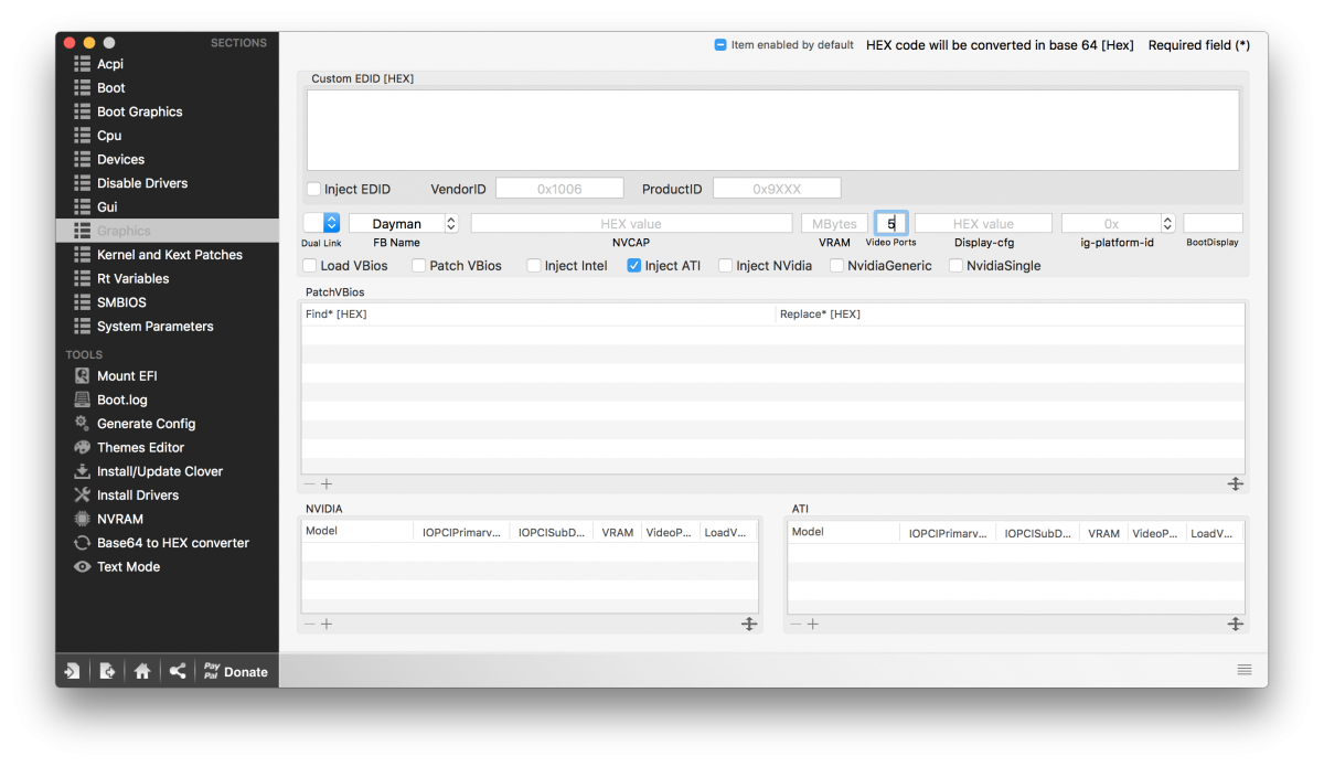

Nightf4ll Posted June 24, 2017 Share Posted June 24, 2017 As you can see the Device ID of my card 0x67DF1002 is present in more than one kext and there are many FBs available for each Kext. After a long long examination I choose to go with Dayman but I've tried extensively also OPM which leads basically to the same results but needs much more modifications. So i Put in Clover Dayman, Inject ATI, and videoport=5. As you can see here: I had to put in Berbice in and it detected two fo my DP ports (which is all I need). I think it detects the HDMI ports too, but they dont seem to support 4K at 60Hz, only 30Hz for some reason. I guess I should test some FB's where my ID is actually present, thx for the info. Card is Sapphire RX480 Nitro, OS is MacOS 10.13 DP2 Also, sound works OOB EDIT: well, putting in 5 ports and Dayman seems to be the way to go for my card 1 Link to comment https://www.insanelymac.com/forum/topic/312582-amd-polaris-ids-on-sierra-high-sierra/page/21/#findComment-2450597 Share on other sites More sharing options...
