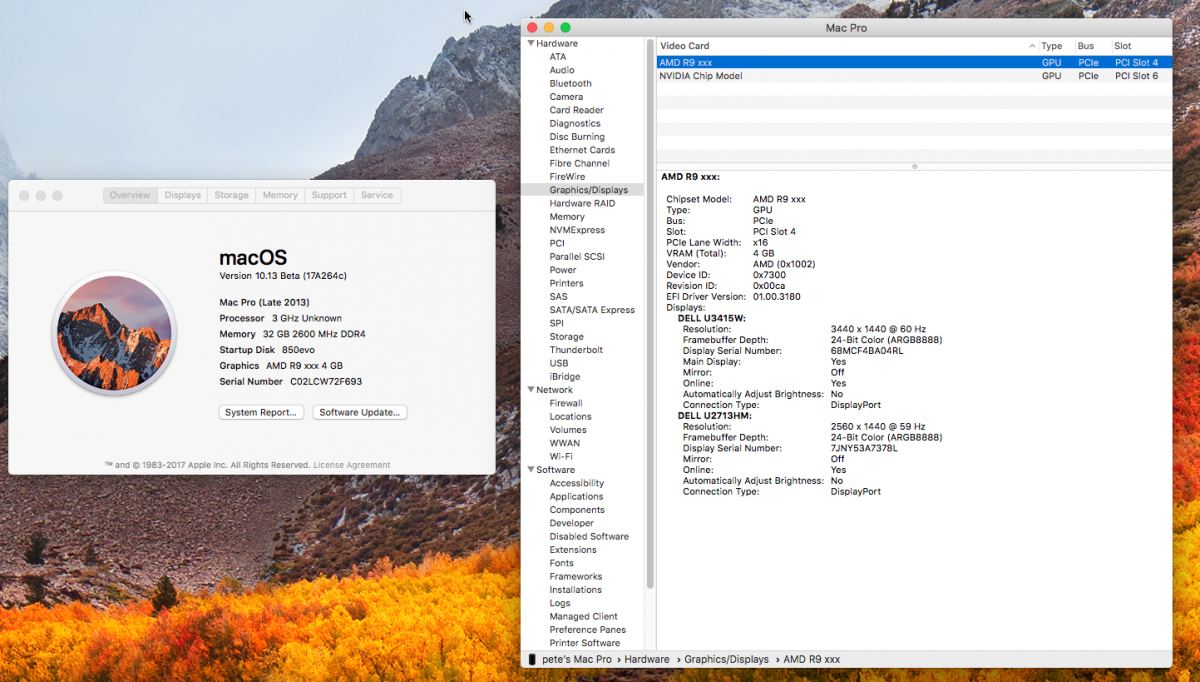

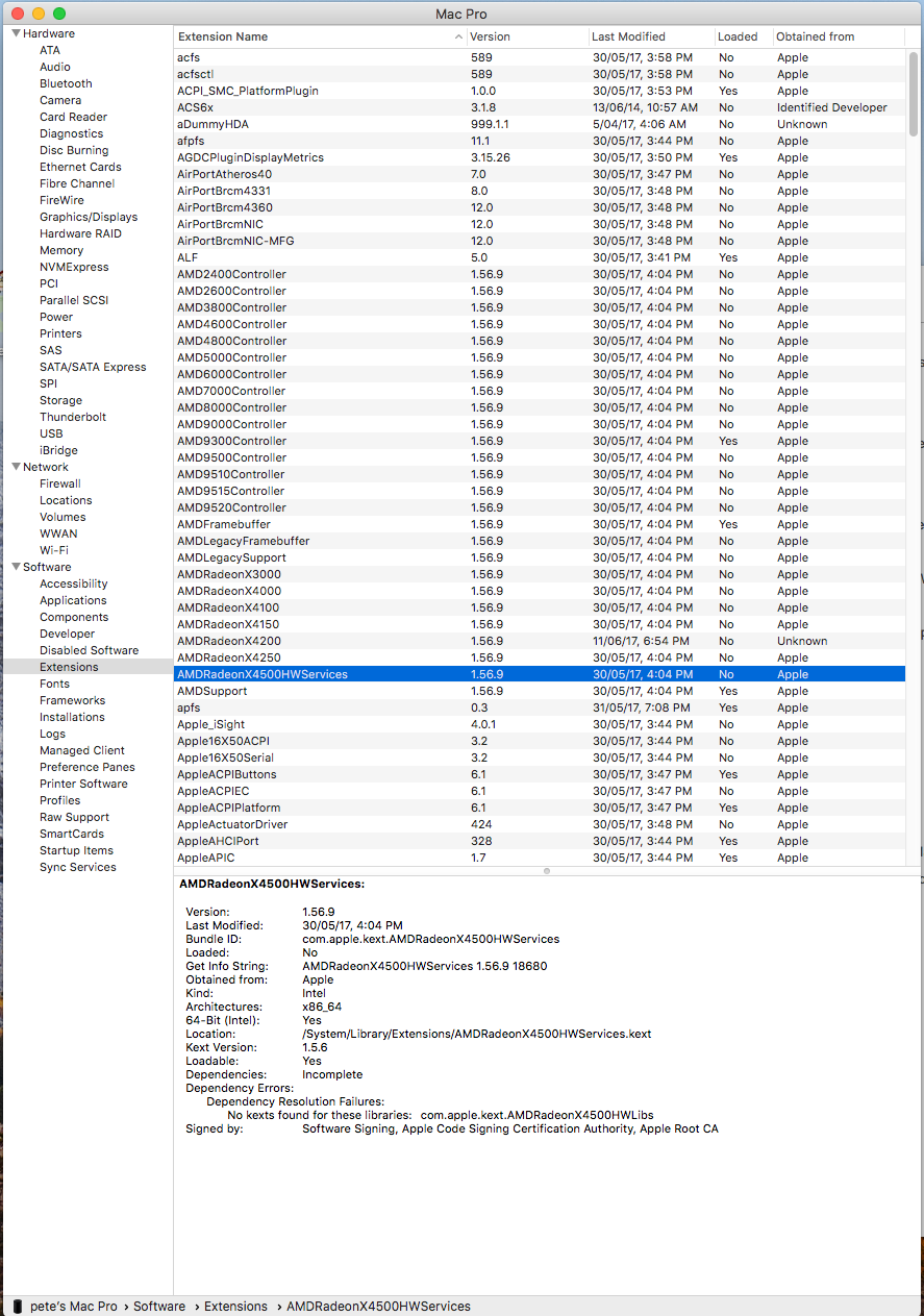

surfinchina Posted June 9, 2017 Share Posted June 9, 2017 Yep AMD Radeon™ R9 Fury Series 7300 So, forgive my ignorance, but do I only need to change fb in clover to maltese? or malteseS ?? I've got 10.13 going ok, just no acceleration on my R9 Nano. (X99) Flag that. I got no output at all and some HD4xxx video. Back to baffin and no acceleration. Link to comment https://www.insanelymac.com/forum/topic/312582-amd-polaris-ids-on-sierra-high-sierra/page/19/#findComment-2439453 Share on other sites More sharing options...

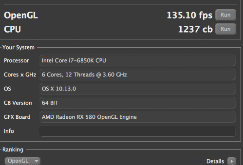

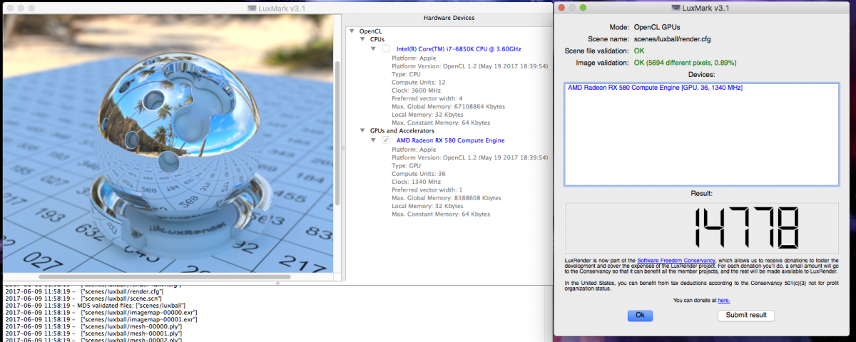

Picasso Posted June 9, 2017 Share Posted June 9, 2017 Can someone make a couple of test with a single 480/580 in 10.13? (Luxmark, Cinebench, Bruce FCPX, etc) Link to comment https://www.insanelymac.com/forum/topic/312582-amd-polaris-ids-on-sierra-high-sierra/page/19/#findComment-2439636 Share on other sites More sharing options...

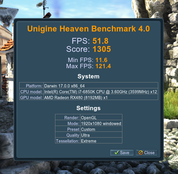

Matthew82 Posted June 9, 2017 Share Posted June 9, 2017 Finally i could report, that my Sapphire RX480 Nitro runs under macOS 10.13, too. But don't ask, what kind os work this was. It did NOT work nearly "out-of-the-box" ! <--- it is really far away from working like this. But here are my results: • iGPU set to primary, RX480 in slot#1 as secondary, CSM enabled = verbose boot but than black screen on both monitors (each card has its own monitor, connected via Displayport) • iGPU, CSM enabled and RX480 set to FakeID 67ef1002 via CLOVER (as for successfull boot, when RX card is the only one, but w/o accelleration) = black screens • iGPU, CSM enabled, RX460 in Akitio Node Encloser connected via Gigabyte Alpine Ridge Thunderbolt 3 card = Login Screen comes up but: after a login immediatly Logout and back to Login Screen • iGPU, CSM enabled, RX480 in Akitio Node Encloser connected via Gigabyte Alpine Ridge Thunderbolt 3 card = Login Screen comes up but: after a login immediatly Logout and back to Login Screen so i was thinking: what else to try to make it work? Than i remember, that Apple's eGPU Developer Kit is a RX580 and Sonnet eGPU encloser. And i remember, that it is possible to flash Sapphire RX480 Nitro with VBIOS from Sapphire RX580 Nitro. Botted into WIN10, get VBIOS from TechPowerUp website, flashed onto the RX480, put that newly flashed card back into the Akitio Node and rebooted into HighSierra: As you can see, full METAL support, but system remains only 0MB VRAM ?!? But it work and i have also testen HEAVEN Benchmark, which reports good framerates (havent made a full benchmark test with it so far). My personal conclusion: WHAT A DISASTER TO MAKE THIS ONE WORK! It may be my personal hardware, which have made this report and experience so horrible. As i told earlier: N E V E R had such problems within macOS 10.12. Regards... EDIT1: now i know, why it is showing 0MB VRAM: it is CLOVER related, cause i don't set any value for VRAM in config.plist - exactly i have completely no entry to set this value in my config.plist and which already never was a problem so far, cause CLOVER detected VRAMsize automatically. Booted with "inject ATI = false", i will get RadeonFramebuffer, but correct VRAM size shown in system profiler. Not a problem for me and maybe it is related cause it is somewaht in the night and i am realy tired from this horrible experience. So do you thing if will work with boot screen wen we flash gpu with bios from Sapphire RX480 Nitro? (whiteout IGPU or helper card) Link to comment https://www.insanelymac.com/forum/topic/312582-amd-polaris-ids-on-sierra-high-sierra/page/19/#findComment-2439801 Share on other sites More sharing options...
Matthew82 Posted June 9, 2017 Share Posted June 9, 2017 Can someone make a couple of test with a single 480/580 in 10.13? (Luxmark, Cinebench, Bruce FCPX, etc) BruceX 16s [ attachment=243617:Zrzut ekranu 2017-06-09 o 12.11.32.png] 1 Link to comment https://www.insanelymac.com/forum/topic/312582-amd-polaris-ids-on-sierra-high-sierra/page/19/#findComment-2439852 Share on other sites More sharing options...
