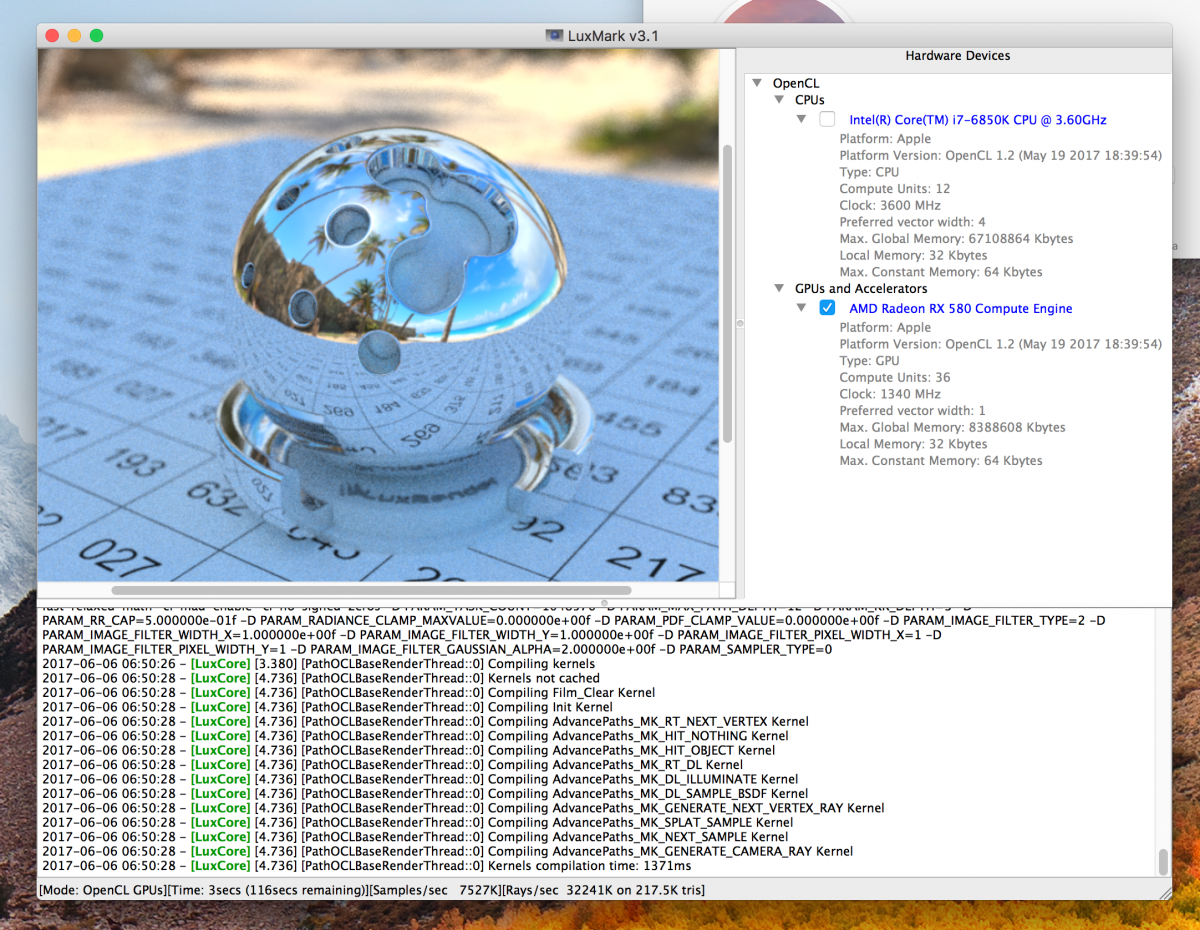

Matthew82 Posted June 6, 2017 Share Posted June 6, 2017 RX 480/580 working without any patch on 10.13 5 Link to comment https://www.insanelymac.com/forum/topic/312582-amd-polaris-ids-on-sierra-high-sierra/page/18/#findComment-2436392 Share on other sites More sharing options...

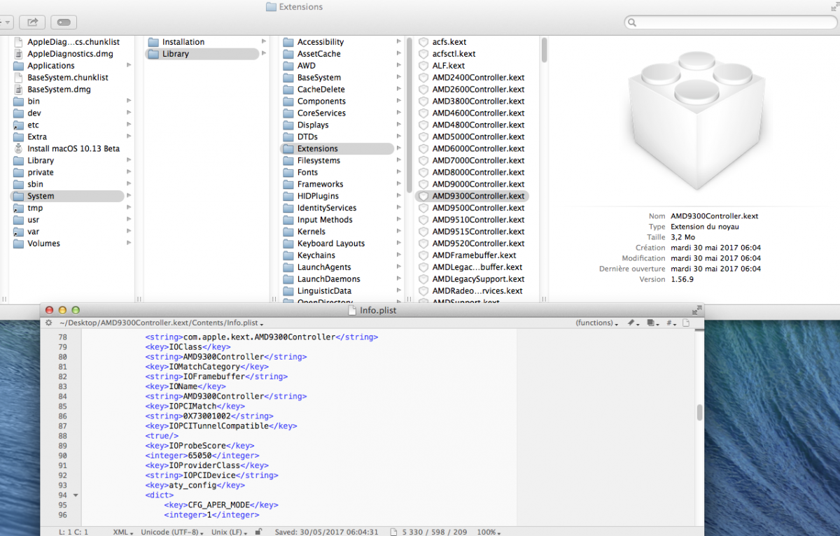

Ciro82 Posted June 7, 2017 Author Share Posted June 7, 2017 Dear Matthew, will you please be so kind and upload your VBIOS somewhere, cause my SAPPHIRE RX480 Nitro OC 8GB does NOT work with acceleration. Also please be so kind and check, which framebuffer HIGH_SIERRA chossed for your card an which AMD9xxxController was used for it. Thanx in advance. From Netkas forum: ### AMD9520Controller.kext * pci device: 67c0 - Ellesmere [Polaris10] * pci device: 67df - Ellesmere [Radeon RX 470/480] * pci device: 67e0 - Baffin [Polaris11] * pci device: 67ef - Baffin [Radeon RX 460] * pci device: 67ff - Baffin [Polaris11] ### AMD9300Controller.kext * pci device: 7300 - Fiji [Radeon R9 FURY / NANO Series] ### AMD9510Controller.kext * pci device: 67ef - Baffin [Radeon RX 460] ### AMD9515Controller.kext * pci device: 67ef - Baffin [Radeon RX 460] ### AMD9500Controller.kext * pci device: 67c0 - Ellesmere [Polaris10] * pci device: 67c0 - Ellesmere [Polaris10] * pci device: 67df - Ellesmere [Radeon RX 470/480] * pci device: 67df - Ellesmere [Radeon RX 470/480] * pci device: 67e0 - Baffin [Polaris11] * pci device: 67e0 - Baffin [Polaris11] * pci device: 67ef - Baffin [Radeon RX 460] * pci device: 67ef - Baffin [Radeon RX 460] * pci device: 67ff - Baffin [Polaris11] * pci device: 67ff - Baffin [Polaris11] ### AMDRadeonX4100.kext * pci device: 67e0 - Baffin [Polaris11] * pci device: 67ef - Baffin [Radeon RX 460] * pci device: 67ff - Baffin [Polaris11] ### AMDRadeonX4500HWServices.kext * pci device: 7300 - Fiji [Radeon R9 FURY / NANO Series] ### AMDRadeonX4150.kext * pci device: 67e0 - Baffin [Polaris11] * pci device: 67ef - Baffin [Radeon RX 460] * pci device: 67ff - Baffin [Polaris11] ### AMDRadeonX4200.kext * pci device: 67c0 - Ellesmere [Polaris10] * pci device: 67df - Ellesmere [Radeon RX 470/480] * pci device: 67ef - Baffin [Radeon RX 460] * pci device: 67ff - Baffin [Polaris11] ### AMDRadeonX4250.kext * pci device: 67df - Ellesmere [Radeon RX 470/480] @fantomas1 thanks for the thread edits man Link to comment https://www.insanelymac.com/forum/topic/312582-amd-polaris-ids-on-sierra-high-sierra/page/18/#findComment-2437377 Share on other sites More sharing options...

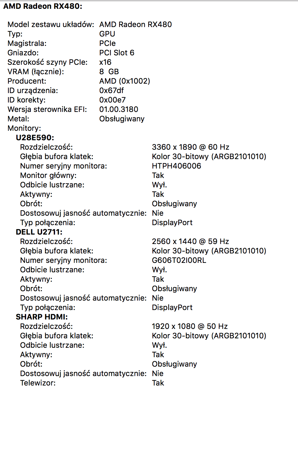

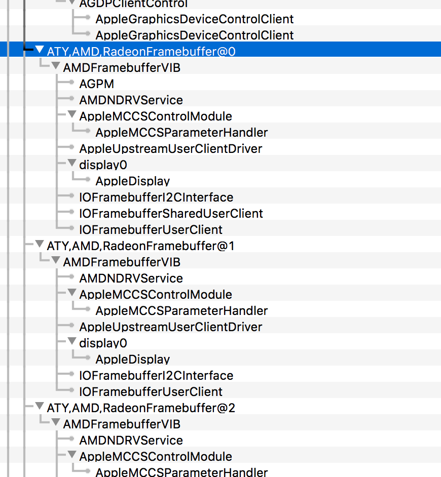

Matthew82 Posted June 7, 2017 Share Posted June 7, 2017 Dear Matthew, will you please be so kind and upload your VBIOS somewhere, cause my SAPPHIRE RX480 Nitro OC 8GB does NOT work with acceleration. Also please be so kind and check, which framebuffer HIGH_SIERRA chossed for your card an which AMD9xxxController was used for it. Thanx in advance. Rom from my RX 480 https://www.dropbox.com/s/sxoa0g0yn98ofo7/RX480Mac.ROM?dl=0 New Sierra loading standard framebuffer Link to comment https://www.insanelymac.com/forum/topic/312582-amd-polaris-ids-on-sierra-high-sierra/page/18/#findComment-2437475 Share on other sites More sharing options...
Ciro82 Posted June 7, 2017 Author Share Posted June 7, 2017 Rom from my RX 480 https://www.dropbox.com/s/sxoa0g0yn98ofo7/RX480Mac.ROM?dl=0 New Sierra loading standard framebuffer Zrzut ekranu 2017-06-07 o 12.28.12.png Try to use Baladi FrameBuffer in Clover Link to comment https://www.insanelymac.com/forum/topic/312582-amd-polaris-ids-on-sierra-high-sierra/page/18/#findComment-2437482 Share on other sites More sharing options...
Matthew82 Posted June 7, 2017 Share Posted June 7, 2017 Try to use Baladi FrameBuffer in Clover I was trying. No working. Link to comment https://www.insanelymac.com/forum/topic/312582-amd-polaris-ids-on-sierra-high-sierra/page/18/#findComment-2437484 Share on other sites More sharing options...
Ciro82 Posted June 7, 2017 Author Share Posted June 7, 2017 I was trying. No working. That's because you have UEFI GOP disabled in your ROM Link to comment https://www.insanelymac.com/forum/topic/312582-amd-polaris-ids-on-sierra-high-sierra/page/18/#findComment-2437490 Share on other sites More sharing options...

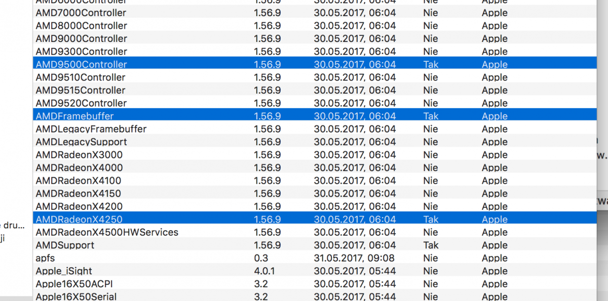

Mork vom Ork Posted June 7, 2017 Share Posted June 7, 2017 Something weird is going on here. Take a look at this Screenshot: Something you should noticed: System Profiler shows 9 loaded AMD.kexts, while Kext Wizzard only shows 3 loaded AMD.kexts. Also see IORegExplorer that NO Accelleration ha been applied. And this is Screenshot of my AMD RX460 Nitro plugged into PCIe slot #1. Also it is only 8x lane wide. For me no way to get this 16x lanes wide. I'm getting nuts here... Link to comment https://www.insanelymac.com/forum/topic/312582-amd-polaris-ids-on-sierra-high-sierra/page/18/#findComment-2437493 Share on other sites More sharing options...
Ciro82 Posted June 7, 2017 Author Share Posted June 7, 2017 Something weird is going on here. Take a look at this Screenshot: Something you should noticed: System Profiler shows 9 loaded AMD.kexts, while Kext Wizzard only shows 3 loaded AMD.kexts. Also see IORegExplorer that NO Accelleration ha been applied. And this is Screenshot of my AMD RX460 Nitro plugged into PCIe slot #1. Also it is only 8x lane wide. For me no way to get this 16x lanes wide. I'm getting nuts here... Rx460 is pcie x8 man... Link to comment https://www.insanelymac.com/forum/topic/312582-amd-polaris-ids-on-sierra-high-sierra/page/18/#findComment-2437503 Share on other sites More sharing options...

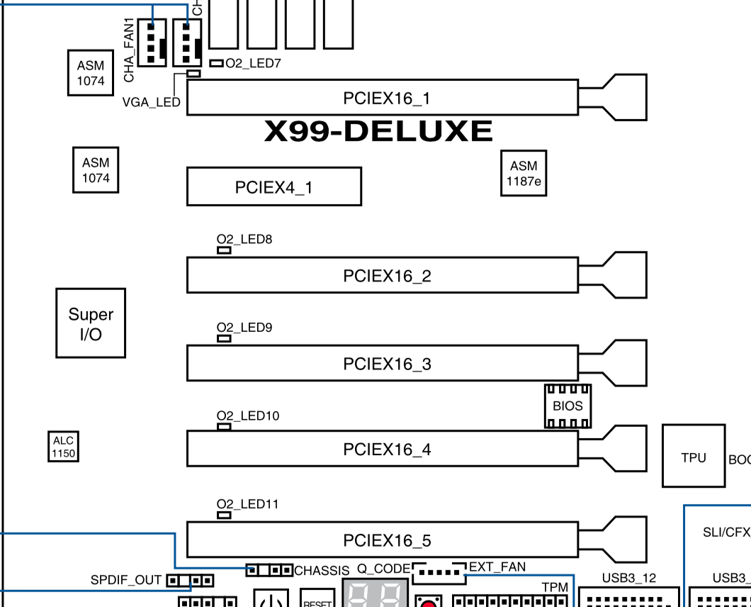

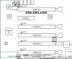

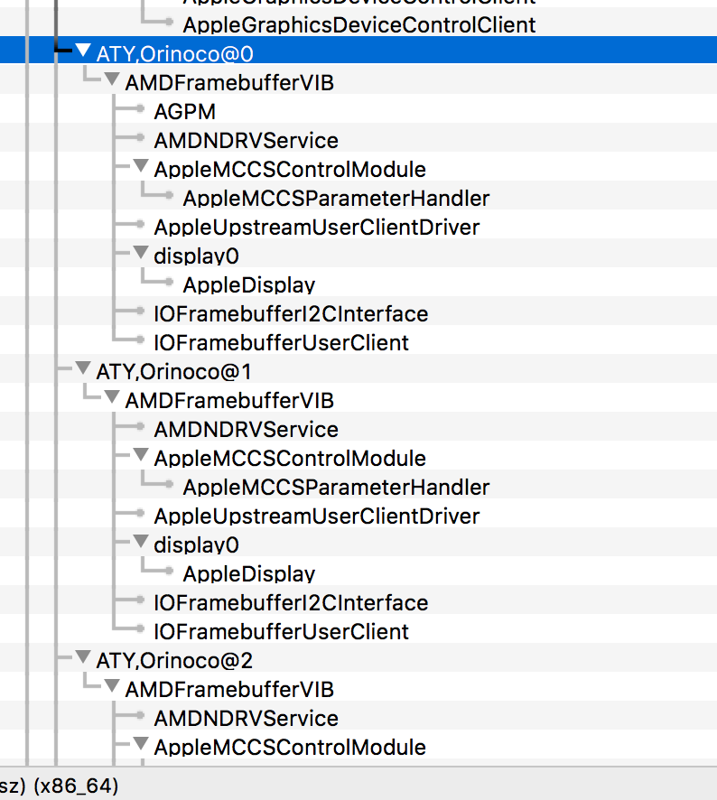

Mork vom Ork Posted June 7, 2017 Share Posted June 7, 2017 Sorry Matthew, two more questions: are you using your AMD RX as primary card ? I think for u it worx, because X99 boards don't have any IGPU, right? Link to comment https://www.insanelymac.com/forum/topic/312582-amd-polaris-ids-on-sierra-high-sierra/page/18/#findComment-2437608 Share on other sites More sharing options...

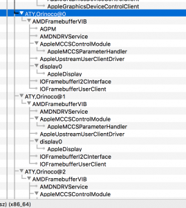

Matthew82 Posted June 7, 2017 Share Posted June 7, 2017 Sorry Matthew, two more questions: are you using your AMD RX as primary card ? I think for u it worx, because X99 boards don't have any IGPU, right? Right. But I have card connected to PCEX6_3 slot on 16_5 is Thunderbolt (only using for audio firewire interface) and on 16_2 I have USB 3.1 card. First slot waiting for second RX Now I'm testing new framebuffers "Orinoco" is working with every DP port without any patch. HDMI audio working to. 3 monitor on the same time Guariba - all monitors and HDMI Dayman - all monitors and no HDMI Orinoco - all monitors and HDMI Balladi - injection not work OPM - only 1 DP monitor work but LuxMark score is highest Link to comment https://www.insanelymac.com/forum/topic/312582-amd-polaris-ids-on-sierra-high-sierra/page/18/#findComment-2437620 Share on other sites More sharing options...
