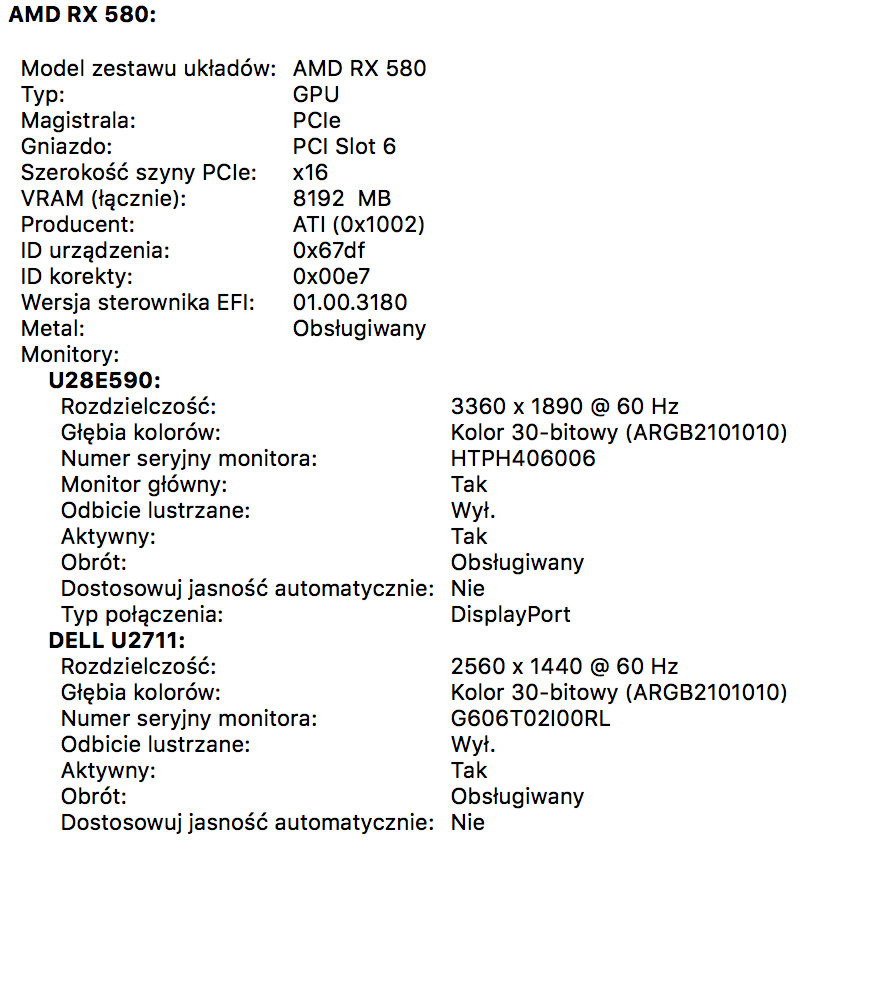

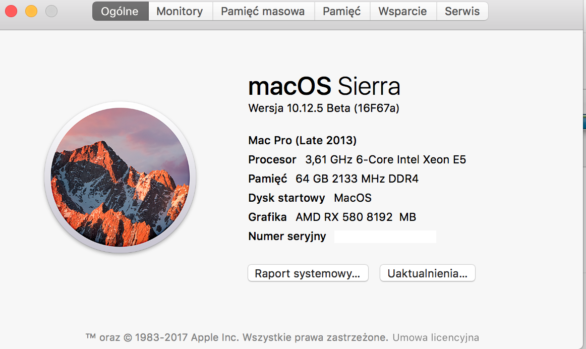

Denicio Posted April 25, 2017 Share Posted April 25, 2017 Flashed RX 480 to 580 - 4% performance boost Zrzut ekranu 2017-04-24 o 16.48.30.png Hello Matthew, first of all congratulations on your findings. Is there any way to your knowledge to utilize the RX 480 as a standalone GPU (without iGPU helper)? Link to comment https://www.insanelymac.com/forum/topic/312582-amd-polaris-ids-on-sierra-high-sierra/page/17/#findComment-2411667 Share on other sites More sharing options...

Matthew82 Posted April 25, 2017 Share Posted April 25, 2017 Solution is here http://www.insanelymac.com/forum/topic/313977-r9-nano/?p=2333976 2 Link to comment https://www.insanelymac.com/forum/topic/312582-amd-polaris-ids-on-sierra-high-sierra/page/17/#findComment-2411741 Share on other sites More sharing options...
Matthew82 Posted April 25, 2017 Share Posted April 25, 2017 Working very well on last beta 1 Link to comment https://www.insanelymac.com/forum/topic/312582-amd-polaris-ids-on-sierra-high-sierra/page/17/#findComment-2411828 Share on other sites More sharing options...

Matthew82 Posted April 25, 2017 Share Posted April 25, 2017 I just flesh my RX 480 from Gigabyte to RX 580. 1 Link to comment https://www.insanelymac.com/forum/topic/312582-amd-polaris-ids-on-sierra-high-sierra/page/17/#findComment-2411885 Share on other sites More sharing options...
Max.1974 Posted April 25, 2017 Share Posted April 25, 2017 Just change bios to RX580 bios? Just flash? My card is Sapphire Nitro 8Gb, will work? Link to comment https://www.insanelymac.com/forum/topic/312582-amd-polaris-ids-on-sierra-high-sierra/page/17/#findComment-2411888 Share on other sites More sharing options...
Matthew82 Posted April 25, 2017 Share Posted April 25, 2017 The hardware is the same in 480 and 580. AMD only change bios. If you do this right it will work. 1 Link to comment https://www.insanelymac.com/forum/topic/312582-amd-polaris-ids-on-sierra-high-sierra/page/17/#findComment-2411894 Share on other sites More sharing options...

Pavo Posted April 25, 2017 Share Posted April 25, 2017 Tks a lot Matthew82, sorry ask one more time, im find a bios from RX580 and im have dificult to find tutorial, you can post some link for us? Tks https://www.techpowerup.com/vgabios/191262/sapphire-rx580-8192-170320 Link to comment https://www.insanelymac.com/forum/topic/312582-amd-polaris-ids-on-sierra-high-sierra/page/17/#findComment-2411906 Share on other sites More sharing options...

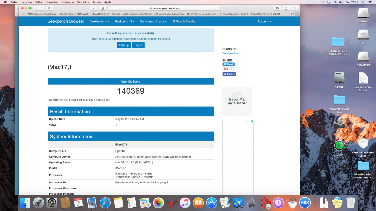

Max.1974 Posted May 2, 2017 Share Posted May 2, 2017 Its working on Beta 10.12.5 (16F71B), but intel IGFX not working well, im have black screen... EDIT: Im solved this problem with this Kexts: IntelGraphicsFixup Lilu Credits: http://www.insanelymac.com/forum/topic/306156-clover-bugissue-report-and-patch/?p=2418516 @Ukr55 Link to comment https://www.insanelymac.com/forum/topic/312582-amd-polaris-ids-on-sierra-high-sierra/page/17/#findComment-2415851 Share on other sites More sharing options...
