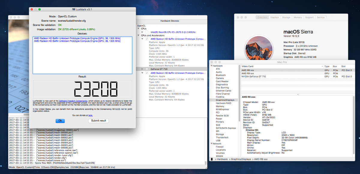

SwithDrawn Posted March 11, 2017 Share Posted March 11, 2017 A huge thanks to everyone working on this -- was able to get my two Asus Dual-Fan RX480 8G's working on 10.12.3! 1) Started with a single 480 and Nvidia GT710 as a helper card (I have a Matrox IGPU so it's no good). For some reason the clover injection methods weren't working for me, I ended up editing info.plist in AMDRadeonX4100.kext, changing 0x67FF1002 to 0x67DF1002. That gave me acceleration on the 480, and I applied the CU patch to unlock all 36 compute units. I still needed the GT710 to boot. I tried putting in the second 480 but wasn't able to get a boot even with the GT710 helper card -- the setup only worked with a single 480 + helper card. 2) I modified the 480's vbios so I wouldn't need the GT710 (thanks to Rhys216's method). This worked fine, I hoped this would allow me to insert the second 480 without needing to mod its bios but this wasn't the case. I couldn't get OS X to boot up with the unmodded 480 alongside the modded 480 even with the GT710 helper card still in the case. 3) I modded the second 480's vbios and presto - both cards working in OS X and I don't need the GT710. Edit: for those interested in using the modded bios 480's in Windows, I had to use Crimson 16.9.1 as recent drivers check the bios signature and I got Error 43 in the Device Manager. 4) With just the two 480's and no post/bios/bootloader showing up, I have two config.plist files - one specifies the MacOS disk as default and the other selects the Windows disk. I switch them out depending on which OS I want to boot up. I used this guide to mount the clover EFI partition in Windows. My Luxmark scores about doubled from the single 480. That being said, even on just one 480 Adobe Premiere is very unstable with OpenCL but I can use Metal API for rendering and it seems solid. My test scene with Metal API trounced the same scene on Windows with OpenCL, and they were both way better than my previous setup (two R9 280s). Edit: I've found that removing the extra CU patch (so CUs go from 36 to 16) improves my OpenCL stability in Premiere. 3 Link to comment https://www.insanelymac.com/forum/topic/312582-amd-polaris-ids-on-sierra-high-sierra/page/15/#findComment-2382681 Share on other sites More sharing options...
jmacie Posted March 12, 2017 Share Posted March 12, 2017 A huge thanks to everyone working on this -- was able to get my two 480s working on 10.12.3! 1) Started with a single 480 and Nvidia GT710 as a helper card (I have a Matrox IGPU so it's no good). For some reason the clover injection methods weren't working for me, I ended up editing info.plist in AMDRadeonX4100.kext, changing 0x67FF1002 to 0x67DF1002. That gave me acceleration on the 480, and I applied the CU patch to unlock all 36 compute units. I still needed the GT710 to boot. I tried putting in the second 480 but wasn't able to get a boot even with the GT710 helper card -- the setup only worked with a single 480 + helper card. 2) I modified the 480's vbios so I wouldn't need the GT710 (thanks to Rhys216's method). This worked fine, I hoped this would allow me to insert the second 480 without needing to mod its bios but this wasn't the case. I couldn't get OS X to boot up with the unmodded 480 alongside the modded 480 even with the GT710 helper card still in the case. 3) I modded the second 480's vbios and presto - both cards working in OS X and I don't need the GT710 (although I will keep it in for Bios/Windows switching). My Luxmark scores about doubled from the single 480. That being said, even on just one 480 Adobe Premiere is very unstable with OpenCL but I can use Metal API for rendering and it seems solid. My test scene with Metal API trounced the same scene on Windows with OpenCL, and they were both way better than my previous setup (two R9 280s). Screen Shot 2017-03-11 at 2.57.33 PM.png Could you direct us to the OP for Rhys216's method that this youtube is linked from. Also which rx480 brands are you using and if I put this powercolor rom in my msi rx480 would I be able to boot into win10 in a dual boot, as well as sierra without a helper card? Thanks for any info. Link to comment https://www.insanelymac.com/forum/topic/312582-amd-polaris-ids-on-sierra-high-sierra/page/15/#findComment-2382717 Share on other sites More sharing options...

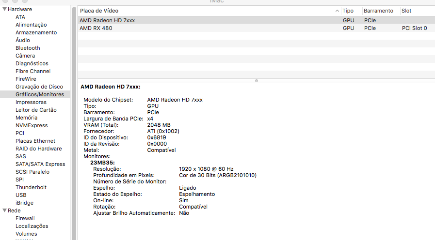

Max.1974 Posted March 12, 2017 Share Posted March 12, 2017 Flashing bios is great alternative, but im fraid to crash my card.. im not advanced user... Im using another AMD card HD7850 (native) with RX 480, so its better than lags with IGPX onboard. Tks for @Gigamaxx !! Im using 10.12.4 public beta 5 [ macOS 10.12.4 (16E183b) ] Link to comment https://www.insanelymac.com/forum/topic/312582-amd-polaris-ids-on-sierra-high-sierra/page/15/#findComment-2383010 Share on other sites More sharing options...

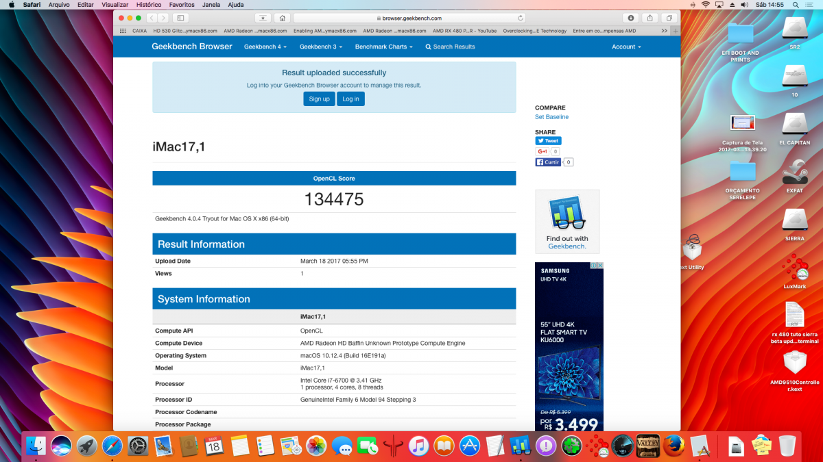

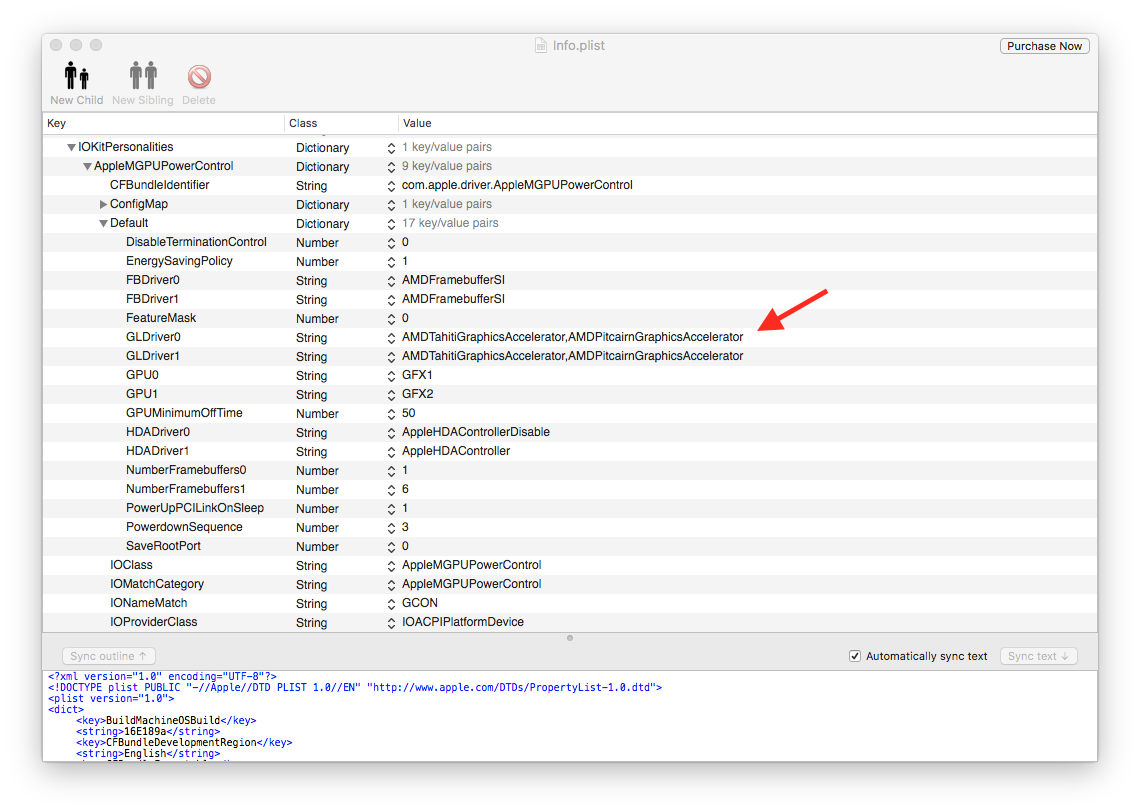

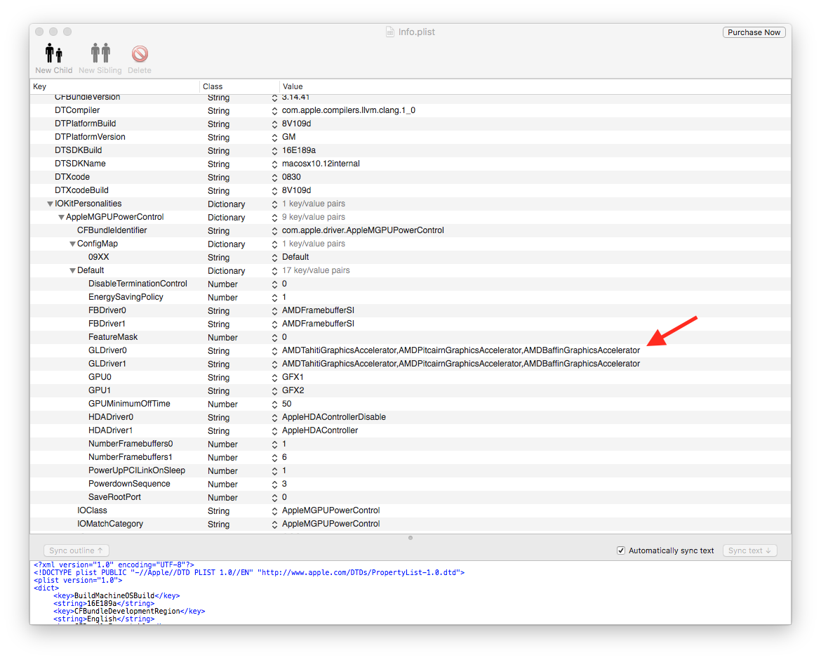

Max.1974 Posted March 18, 2017 Share Posted March 18, 2017 Hello everyone, I've been checking the info.Plist AppleMGPUPower.kext/Plugins/AppleGraphicsControl.kext and I noticed, as in print that there was no AMDBuffin control, would it have any relevance? Because I managed to change the score of Benchmark 4 that went up a lot ... just a small light of a curious face ... and im not use overclock.. best regards !!! 1 Link to comment https://www.insanelymac.com/forum/topic/312582-amd-polaris-ids-on-sierra-high-sierra/page/15/#findComment-2386967 Share on other sites More sharing options...
SwithDrawn Posted March 22, 2017 Share Posted March 22, 2017 Hello everyone, I've been checking the info.Plist AppleMGPUPower.kext/Plugins/AppleGraphicsControl.kext and I noticed, as in print that there was no AMDBuffin control, would it have any relevance? Because I managed to change the score of Benchmark 4 that went up a lot ... just a small light of a curious face ... and im not use overclock.. best regards !!! Good find, but what was your Luxmark score before the change? 14k is about consistent with one of my 480 8GB cards on Luxball. I added AMDBaffinGraphicsAccelerator to AppleMGPUPowerControl but didn't see any difference. Actually went down by 100, lol. 1 Link to comment https://www.insanelymac.com/forum/topic/312582-amd-polaris-ids-on-sierra-high-sierra/page/15/#findComment-2389064 Share on other sites More sharing options...
Max.1974 Posted March 23, 2017 Share Posted March 23, 2017 Before the change was 78000 at 85000 in Benchmark 4 and 7600 at 9500 in Luxmark. Sorry that not worked for you. Im using Clover 4003 and no injections for ATI or Intel on config.plist. Just id for both. Link to comment https://www.insanelymac.com/forum/topic/312582-amd-polaris-ids-on-sierra-high-sierra/page/15/#findComment-2390097 Share on other sites More sharing options...

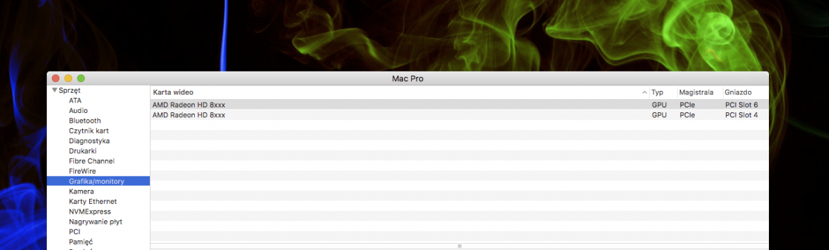

Matthew82 Posted April 2, 2017 Share Posted April 2, 2017 I made the FCPX performance test with single R9 290X Matrix (Asus) and RX 480 G1 (8 GB version) BruceX test: Single 290X - 22 s. Single RX 480 15 s. 1 Link to comment https://www.insanelymac.com/forum/topic/312582-amd-polaris-ids-on-sierra-high-sierra/page/15/#findComment-2397074 Share on other sites More sharing options...
Fljagd Posted April 2, 2017 Share Posted April 2, 2017 I made the FCPX performance test with single R9 290X Matrix (Asus) and RX 480 G1 (8 GB version) BruceX test: Single 290X - 22 s. Single RX 480 15 s. Zrzut ekranu 2017-04-02 o 13.58.41.png Hi matthew really good rx480 all alone? Link to comment https://www.insanelymac.com/forum/topic/312582-amd-polaris-ids-on-sierra-high-sierra/page/15/#findComment-2397177 Share on other sites More sharing options...
Matthew82 Posted April 2, 2017 Share Posted April 2, 2017 Yes. RX +6850k OC to 4.2 Link to comment https://www.insanelymac.com/forum/topic/312582-amd-polaris-ids-on-sierra-high-sierra/page/15/#findComment-2397300 Share on other sites More sharing options...

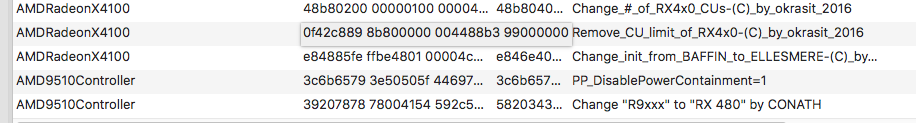

Fljagd Posted April 2, 2017 Share Posted April 2, 2017 Yes. RX +6850k OC to 4.2 Can you share your config.plist? Thank Link to comment https://www.insanelymac.com/forum/topic/312582-amd-polaris-ids-on-sierra-high-sierra/page/15/#findComment-2397305 Share on other sites More sharing options...
Matthew82 Posted April 2, 2017 Share Posted April 2, 2017 Can you share your config.plist? Thank config.plist.zip 1 Link to comment https://www.insanelymac.com/forum/topic/312582-amd-polaris-ids-on-sierra-high-sierra/page/15/#findComment-2397359 Share on other sites More sharing options...
Fljagd Posted April 2, 2017 Share Posted April 2, 2017 config.plist.zip it's for RX480? 5 patches. Right Link to comment https://www.insanelymac.com/forum/topic/312582-amd-polaris-ids-on-sierra-high-sierra/page/15/#findComment-2397368 Share on other sites More sharing options...
Matthew82 Posted April 2, 2017 Share Posted April 2, 2017 Yes. Enable this patch Link to comment https://www.insanelymac.com/forum/topic/312582-amd-polaris-ids-on-sierra-high-sierra/page/15/#findComment-2397371 Share on other sites More sharing options...
Fljagd Posted April 2, 2017 Share Posted April 2, 2017 yes Thank a lot Hello everyone, I've been checking the info.Plist AppleMGPUPower.kext/Plugins/AppleGraphicsControl.kext and I noticed, as in print that there was no AMDBuffin control, would it have any relevance? Because I managed to change the score of Benchmark 4 that went up a lot ... just a small light of a curious face ... and im not use overclock.. best regards !!! The path /System/Library/Extensions/AppleGraphicsControl.kext/Contents/PlugIns/AppleMGPUPowerControl.kext/Contents/Info.plist 1 Link to comment https://www.insanelymac.com/forum/topic/312582-amd-polaris-ids-on-sierra-high-sierra/page/15/#findComment-2397372 Share on other sites More sharing options...
