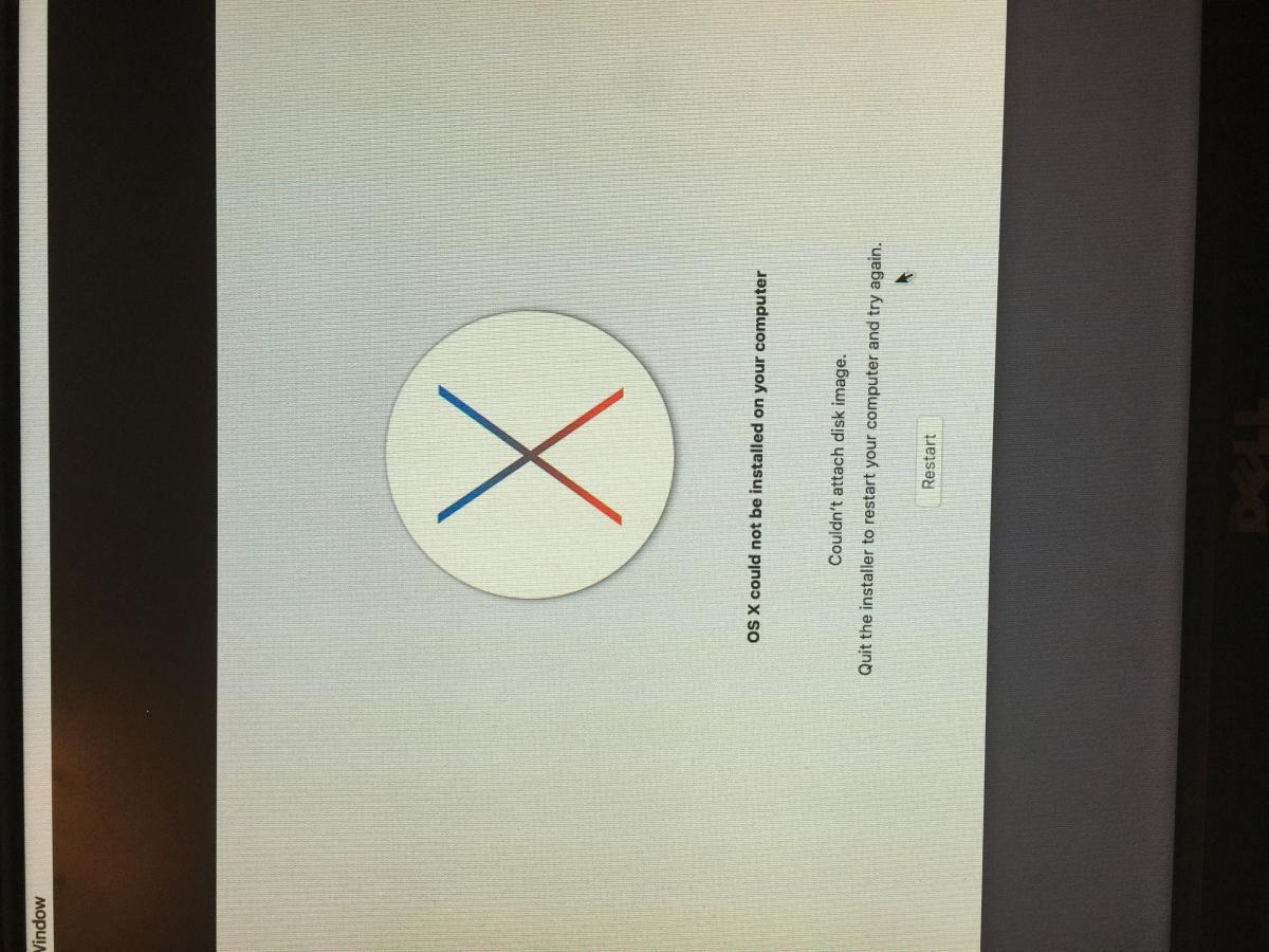

Blaggah Posted August 21, 2016 Share Posted August 21, 2016 Thanks man, I'm finally booting up with your clover files. However, upon installing I get this message a couple of seconds from the count down. This is my second usb installer. I got the culprit, it happened to be my thumb drive. I swapped to another one and everything ok. Are there any edits needed to be done in order to get sound to work? I'm not using ATI hd5450, but an Nvidia 630 gt card. After post installation, i ran update to 10.11.6 straight. Haven't been able to get sound to work at all even after a lot of kext repair permissions. Link to comment https://www.insanelymac.com/forum/topic/308097-guide-el-capitan-1011x-dell-optiplex-780-760-755-790-990/page/41/#findComment-2268323 Share on other sites More sharing options...
morpheousman Posted August 21, 2016 Author Share Posted August 21, 2016 Thanks man, I'm finally booting up with your clover files. However, upon installing I get this message a couple of seconds from the count down. This is my second usb installer. I got the culprit, it happened to be my thumb drive. I swapped to another one and everything ok. Are there any edits needed to be done in order to get sound to work? I'm not using ATI hd5450, but an Nvidia 630 gt card. After post installation, i ran update to 10.11.6 straight. Haven't been able to get sound to work at all even after a lot of kext repair permissions. For Sound other than AppleHDA with HD5450, try the Voodoo.HDA kexts. They are in Clover/Kexts/10.11/Voodoo.HDA. Delete Apple.HdA edits from Clover.config > Kernel and Kext Patches. 1 Link to comment https://www.insanelymac.com/forum/topic/308097-guide-el-capitan-1011x-dell-optiplex-780-760-755-790-990/page/41/#findComment-2268605 Share on other sites More sharing options...
