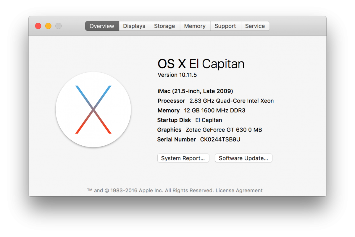

pastrychef Posted May 29, 2016 Share Posted May 29, 2016 Oops. I'm sorry. I have a GT 630, not a GT 730. Yes, it worked without need for Nvidia web drivers but can also work with them. After you boot in to your Optiplex, you can download and install the web drivers if you wish. This is what I did. Yes, I am using the DTST and config.plist from post #1. They are fine for my GT 630. I have a Zotac brand GT 630. Please ignore that it reports my CPU as Xeon. It is in fact just a Q9550S. Link to comment https://www.insanelymac.com/forum/topic/308097-guide-el-capitan-1011x-dell-optiplex-780-760-755-790-990/page/37/#findComment-2241130 Share on other sites More sharing options...

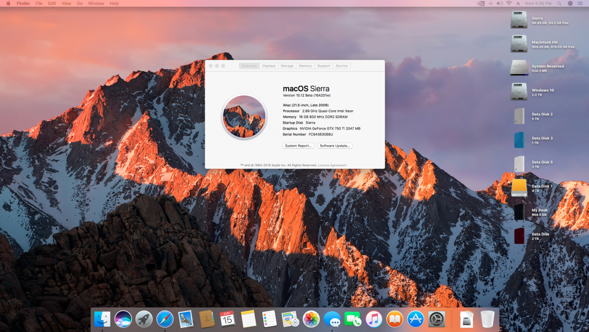

Trimatix Posted June 11, 2016 Share Posted June 11, 2016 ====SUCCESS REPORT: GT 740==== Fully operational using an asus nvidia GT 740, graphics acceleration and screen resolution appear to be working perfectly. What I used:- The generic DSDT supplied by the guide - SMBIOS randomly generated using iMac13,1 - Edited USB_Injector.kext - Change all appearances of "iMac10,1" to "iMac13,1" (download mine here) - nvda_drv=1 boot arg. - NVIDIA web driver 346.03.10f02, obtained here If you're using a Haswell CPU rather than the Core duo that comes with the optiplex, you will need to: - Use SMBIOS generated for iMac14,2 to avoid power management issues - Edit the USB_Injector.kext for iMac14,2 instead of iMac13,1 as I described above I'm a complete noob to hackintoshing, so if anyone has any trouble with the GT 740, it will probably be quite easy to fix. Hmu if you have questions. Big thanks to the man himself, for advice on the USB_Injector kext and SMBIOS edits - @polyzargone 3 Link to comment https://www.insanelymac.com/forum/topic/308097-guide-el-capitan-1011x-dell-optiplex-780-760-755-790-990/page/37/#findComment-2242197 Share on other sites More sharing options...

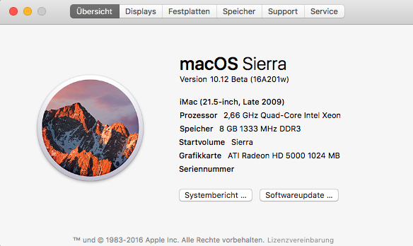

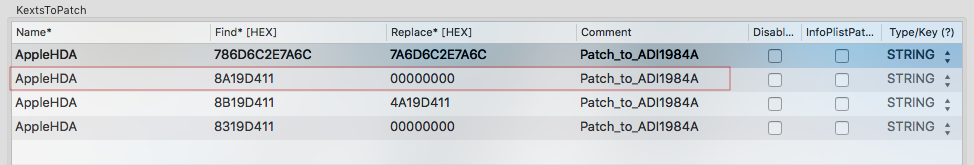

MacPeet Posted June 15, 2016 Share Posted June 15, 2016 my Dell 780 works with macOS Sierra 10.12 Works quite well. Even Siri. Audio on the fly is not working Audio with patched HDA of Capitan works HDMI-Audio works nativ Appstore, Cloud, iMessage, FaceTime, Airdrop, AirServer, Siri and... works Update: on the fly works with macOS Sierra new Binary-patch on 00000000 Copy Layout1.zml.zlib and Platform.zml.zlib to VanillaHDA and install VanillaHDA cache rebuilt realtekALC to Clovers kexts 10.12 4 Link to comment https://www.insanelymac.com/forum/topic/308097-guide-el-capitan-1011x-dell-optiplex-780-760-755-790-990/page/37/#findComment-2243182 Share on other sites More sharing options...

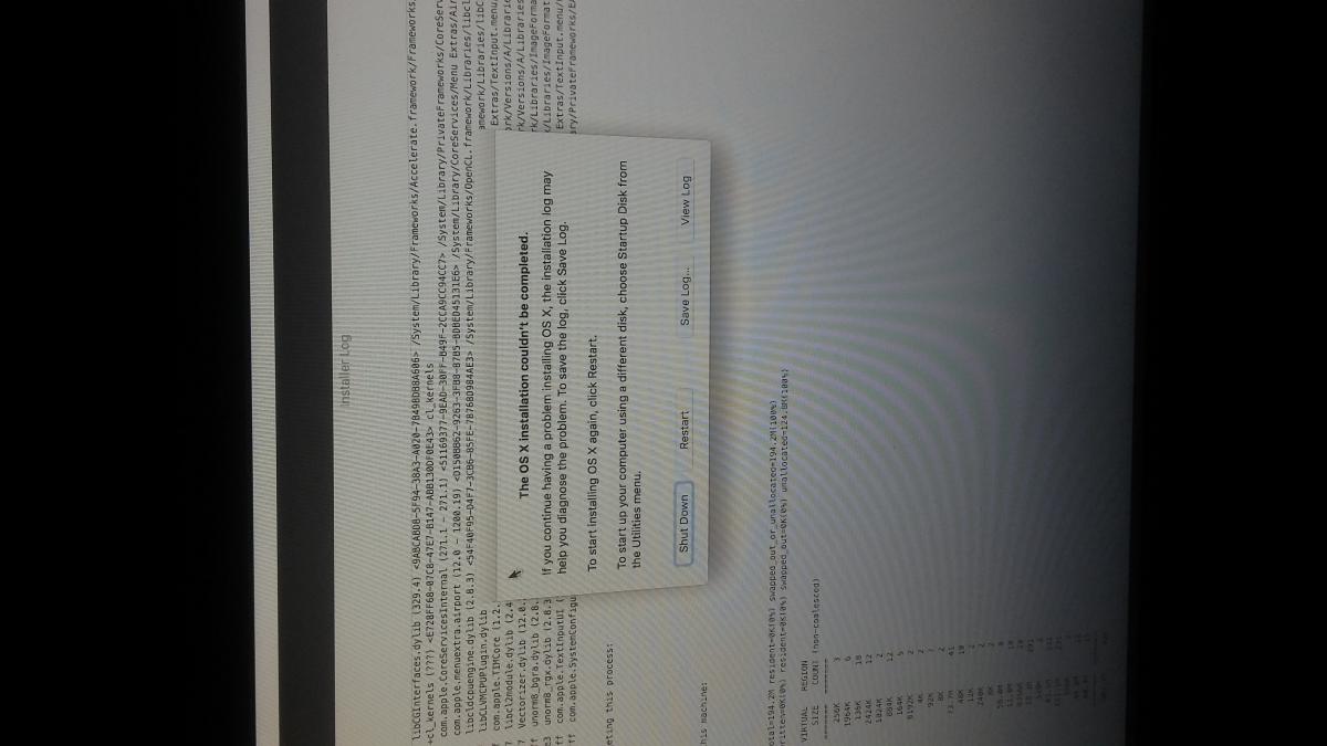

rob88v Posted June 15, 2016 Share Posted June 15, 2016 @MacPeet I made the USB using the method you mentioned and I get it to load but this is the issue I keep facing: Link to comment https://www.insanelymac.com/forum/topic/308097-guide-el-capitan-1011x-dell-optiplex-780-760-755-790-990/page/37/#findComment-2243325 Share on other sites More sharing options...
MacPeet Posted June 15, 2016 Share Posted June 15, 2016 Clover Version Clover_v2.3k_r3561 ??? is new!!! FakeSMC to Clover kext 10.12 and/or to others ??? SMBIOS iMac10,1 ??? Clean Install ??? fresh HDD ??? Link to comment https://www.insanelymac.com/forum/topic/308097-guide-el-capitan-1011x-dell-optiplex-780-760-755-790-990/page/37/#findComment-2243336 Share on other sites More sharing options...
rob88v Posted June 15, 2016 Share Posted June 15, 2016 Yes Clover version is the very latest, FakeSMC is in Other, SMBIOS is iMac 10,1 and I am installing to a created seperate partition on an existing drive but I can try a blank one Link to comment https://www.insanelymac.com/forum/topic/308097-guide-el-capitan-1011x-dell-optiplex-780-760-755-790-990/page/37/#findComment-2243345 Share on other sites More sharing options...
polyzargone Posted June 15, 2016 Share Posted June 15, 2016 Perhaps your installer is corrupted… Where does it come from ? Link to comment https://www.insanelymac.com/forum/topic/308097-guide-el-capitan-1011x-dell-optiplex-780-760-755-790-990/page/37/#findComment-2243346 Share on other sites More sharing options...
rob88v Posted June 16, 2016 Share Posted June 16, 2016 Got everything working 100 percent! I installed from internal partition and everything is working fine alongside my main El Capitan install. Thank you to everyone who works hard to keep the Optiplex alive and well. 2 Link to comment https://www.insanelymac.com/forum/topic/308097-guide-el-capitan-1011x-dell-optiplex-780-760-755-790-990/page/37/#findComment-2243507 Share on other sites More sharing options...
