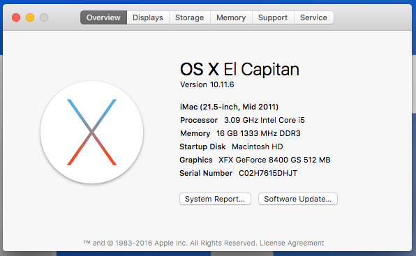

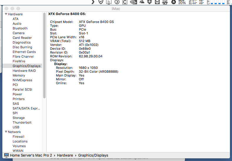

Dan_Marshall Posted August 25, 2016 Share Posted August 25, 2016 Another weird issue relating to the above: - with the original DSDT + injectnvidia checked - graphics were glitchy and all USB ports working ok, the graphics in the system profiler showed the nvidia card ok but the vendor read: vendor ati 0x1002 - with the original DSDT + injectnvidia unchecked - graphics were great but USB Drives shown as internal, the graphics in the system profiler showed the nvidia card ok and the vendor read: vendor nvidia EFI folder too large (20.6MB), Attached is the Clover folder from the EFI partition Thanks for your help mate Dan Dell 990 CLOVER.zip Link to comment https://www.insanelymac.com/forum/topic/308097-guide-el-capitan-1011x-dell-optiplex-780-760-755-790-990/page/42/#findComment-2269726 Share on other sites More sharing options...

Dan_Marshall Posted August 26, 2016 Share Posted August 26, 2016 Dell Optiplex 990 DSDT.aml.zip After carrying out some more testing with the 'generic' DSDT 790 config, the nvidia graphics is still unable to load. In both cases, the the graphics in the system profiler showed the nvidia card ok but the vendor read: vendor ati 0x1002. This is with the injectnvidia both checked and then unchecked in clover configurator Screenshot of the system profiler and attached DSDT used in this configuration (everything works except graphics) And this is the 'about this mac' screenshot: I also can confirm the dell optiplex 990 (mine is SFF) has 4 USB ports in front and 6 USB ports in back. Using the 790 DSDT without the USB injector kext all USB ports work Link to comment https://www.insanelymac.com/forum/topic/308097-guide-el-capitan-1011x-dell-optiplex-780-760-755-790-990/page/42/#findComment-2269951 Share on other sites More sharing options...

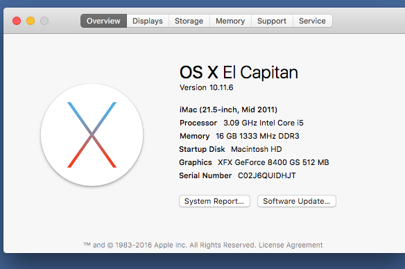

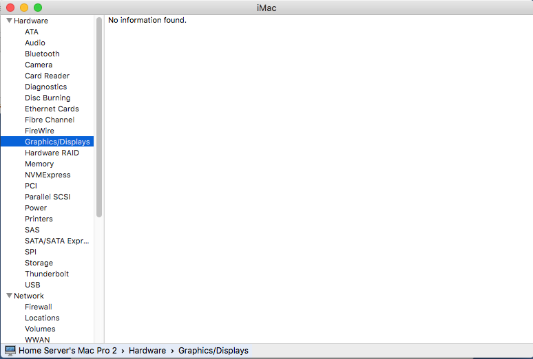

Dan_Marshall Posted August 26, 2016 Share Posted August 26, 2016 Thanks mate - tried with the 990 generic DSDT and these are the results: Booting with injectnvidia on - graphics buggy and lost screen resolution (1280 x 1024 only) Booting without injectnvidia (no checked boxes on any 'inject' clover configurator) - graphics buggy and lost screen resolution as above. You can see from the screenshots that it looks as if the graphics card is not recognised - also serial of the machine - I checked the SMBIOS and all the info is still there just not being displayed Both boots and the USB ports work as they should - all available and read as external. ?????????????????? Crazy! lol Anyways I have attached some screenshots of the above, the EFI folder used to boot (including DSDT and config.plist) Dell Optiplex EFI with Generic DSDT.zip Dell Optiplex 990 IOReg.zip 1 Link to comment https://www.insanelymac.com/forum/topic/308097-guide-el-capitan-1011x-dell-optiplex-780-760-755-790-990/page/42/#findComment-2270035 Share on other sites More sharing options...

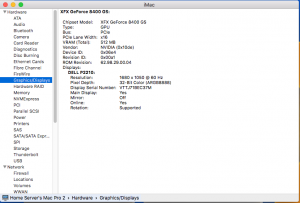

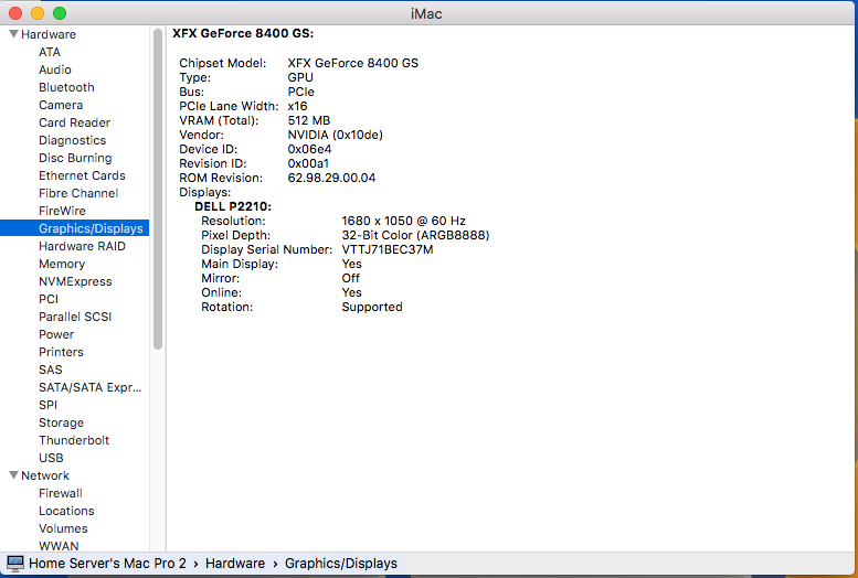

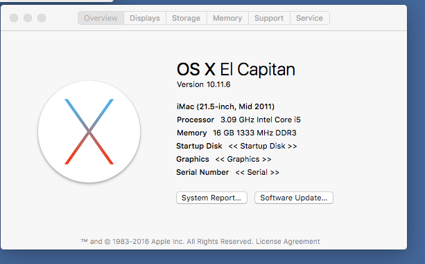

Dan_Marshall Posted August 27, 2016 Share Posted August 27, 2016 Dell Optiplex 990 Success!! After trying many settings with DSDT's and config files, I now have a fully working Dell Optiplex 990 SFF running El Capitan 10.11.6. Everything is working, sleep, shutdown, iMessage etc! As per above posts, I was having difficulty on my existing system with either non accelerated graphics or external USB drives reading as internal. After trying many different settings with the help of the files (790 CLOVER) and members of this thread, I started again as follows: Booted up with 790 Clover EFI folder 'as is' which got me into the machine. USB ports working but graphics buggy. Once in, I opened the config.plist file from the EFI folder that was used to boot the machine. Downloaded the 790 Clover folder from @morpheousman to the desktop I then opened the config.plist file from @morpheousman 790 Clover folder on the desktop. Comparing the 2 files in clover configurator, it showed that clover added many fixes and removed the patches to the booted config file (even though the files were exactly the same before booting) I then mirrored the config files so that they were identical - Removing the fixes that were added and manually entering the patches as per the original config.plist from the config file that was in the 790 CLOVER folder. The only extra entries I added were - injectnvidia for my Nvidia 8400GS and removed the name 'shrike' from the framebuffer. I rebooted (this took about 20 minutes - must've been writing to the nvRAM) and, viola! Fully working Dell Optiplex 990 running El Capitan 10.11.6 :) I know the above is not as technical for an explanation but more of a trial and error process and am delighted with the results. I have attached my EFI folder (Essentially the same as @morpheousman 790 CLOVER with the injectnvidia fix) Again many thanks to polyzargone for your patience and help with this and and morpheousman for the files. Please have a looked at the attached files and offer any advice / suggestions for improvements as you guys are the sensei! Dan Dan's Dell Optiplex 990 EFI.zip Dan's Dell Optiplex 990 IOReg.zip 3 Link to comment https://www.insanelymac.com/forum/topic/308097-guide-el-capitan-1011x-dell-optiplex-780-760-755-790-990/page/42/#findComment-2270403 Share on other sites More sharing options...
