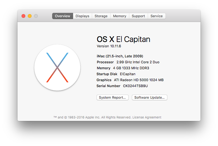

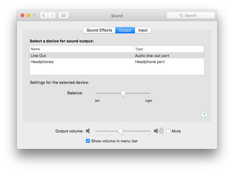

jfth40 Posted November 3, 2016 Share Posted November 3, 2016 Hi! I have a Dell Optiplex 780 SFF with El Capitan. I followed the instructions here to install. Some steps were not verry clear but I managed to make almost everything work. Minor problem - Sound is ok from the headphone jack but I have no sound from the computer speaker. When computer sleep and I wake up with keystroke. The computer wakes up but not the monitor.Important note : About this mac show ATI Radeon HD 5000 but realy it is a Radeon HD5450 inside (I dont know why I have HD 5000 in diagnostic). Link to comment https://www.insanelymac.com/forum/topic/308097-guide-el-capitan-1011x-dell-optiplex-780-760-755-790-990/page/43/#findComment-2313235 Share on other sites More sharing options...
MacPeet Posted November 3, 2016 Share Posted November 3, 2016 Computer speaker is mono and not configured. Sound LineOut is the green connector on the back. Cable connected? HP green front. About this mac show ATI Radeon HD 5000 is ok. Set in the Clover at Graphics FrameBufferName "Shrike" then goes also Sleep. 1 Link to comment https://www.insanelymac.com/forum/topic/308097-guide-el-capitan-1011x-dell-optiplex-780-760-755-790-990/page/43/#findComment-2313253 Share on other sites More sharing options...
jfth40 Posted November 4, 2016 Share Posted November 4, 2016 Computer speaker is mono and not configured. Sound LineOut is the green connector on the back. Cable connected? HP green front. About this mac show ATI Radeon HD 5000 is ok. Set in the Clover at Graphics FrameBufferName "Shrike" then goes also Sleep. Yes this is what I have. in FB Name I already have "Shrike". Link to comment https://www.insanelymac.com/forum/topic/308097-guide-el-capitan-1011x-dell-optiplex-780-760-755-790-990/page/43/#findComment-2313822 Share on other sites More sharing options...

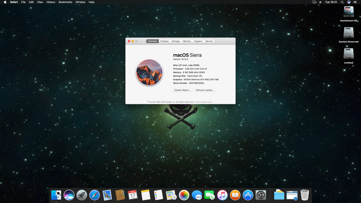

davey076 Posted January 17, 2017 Share Posted January 17, 2017 For those who are interested, i have managed to install OS Sierra on a Optiplex 790. Everything is working. Let me know if you want a tutorial. 3 Link to comment https://www.insanelymac.com/forum/topic/308097-guide-el-capitan-1011x-dell-optiplex-780-760-755-790-990/page/43/#findComment-2351469 Share on other sites More sharing options...
Blaggah Posted January 17, 2017 Share Posted January 17, 2017 Yes this is what I have. in FB Name I already have "Shrike". If Shrike doesn't work try Elemur for the frame buffer name. For those who are interested, i have managed to install OS Sierra on a Optiplex 790. Everything is working. Let me know if you want a tutorial. Yea, please make a tutorial for the 790. I have a SFF I'd like to try it on. Link to comment https://www.insanelymac.com/forum/topic/308097-guide-el-capitan-1011x-dell-optiplex-780-760-755-790-990/page/43/#findComment-2351519 Share on other sites More sharing options...
bclinton Posted January 17, 2017 Share Posted January 17, 2017 For those who are interested, i have managed to install OS Sierra on a Optiplex 790. Everything is working. Let me know if you want a tutorial. Curious....would it work as an upgrade to my existing El Capitan Optiplex 790 or require install from scratch? Link to comment https://www.insanelymac.com/forum/topic/308097-guide-el-capitan-1011x-dell-optiplex-780-760-755-790-990/page/43/#findComment-2351538 Share on other sites More sharing options...
davey076 Posted January 17, 2017 Share Posted January 17, 2017 Curious....would it work as an upgrade to my existing El Capitan Optiplex 790 or require install from scratch? It will. just updated mine today. Just make sure you're running the latest version of Clover, Copy the kexts from /EFI/CLOVER/kexts/10.11 to /EFI/CLOVER/kexts/10.12. After that run the app from the App store, when it reboots select the install partition in Clover and let it finish. It's as simple as that! Link to comment https://www.insanelymac.com/forum/topic/308097-guide-el-capitan-1011x-dell-optiplex-780-760-755-790-990/page/43/#findComment-2351705 Share on other sites More sharing options...
bocajoe Posted January 17, 2017 Share Posted January 17, 2017 For those who are interested, i have managed to install OS Sierra on a Optiplex 790. Everything is working. Let me know if you want a tutorial. A tutorial would be great for the community if you could be so kind. Link to comment https://www.insanelymac.com/forum/topic/308097-guide-el-capitan-1011x-dell-optiplex-780-760-755-790-990/page/43/#findComment-2351712 Share on other sites More sharing options...
davey076 Posted January 18, 2017 Share Posted January 18, 2017 I'll post a tutorial later this week. Stay tuned! 1 Link to comment https://www.insanelymac.com/forum/topic/308097-guide-el-capitan-1011x-dell-optiplex-780-760-755-790-990/page/43/#findComment-2352026 Share on other sites More sharing options...
