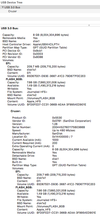

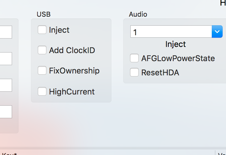

oSxFr33k Posted September 7, 2015 Share Posted September 7, 2015 If you're still using GenericUsbXHCI.kext when booting El Capitan, it will panic. Remove it and replace back AppleUSBEHCI, AppleUSBEHCIPCI, AppleUSBXHCI and AppleUSBXHCIPCI in the IOUSBHostFamily kext. And also, don't forget to set correctly CrsActiveConfig flag in Clover if you're using latest PB's or DP's so you can play around with System folder (e.g. install and remove kexts and set or fix permissions) ! You should be able to boot El Capitan with no KP but it's likely that your USB 3.0 ports won't work at full speed or won't work at all. I'm not sure about the ASMedia chipset so I suggest you read previous posts. I believe someone had success with it. Finally and based on IOReg, DSDT, etc. you should be able to determine your correct ports addresses. That's all I can see for now since I'm definitely not an expert when it comes to DSDT and all that stuff . Well I put everything back and removed the GenericUsbXHCI driver and I still get a kernel panic. Its the ASMedia controller causing it. In my Z97 I boot El Capitan without any issues and that has the ASMedia controllers on it. Disabling the ASMedia USB 3 rear and Front does to help. There must be something else that needs modifying to get past at least the kernel Panic. I have to keep trying different things in Clover/SSDT. Riley said he could not get past the Kernel Panic as well. Edited: I finally booted into El Captain. After about 10 reboots. No 3rd party kexts installed. Ioreg attached to see if this can help the developers get a driver written to at least stop the Kernal Panic? All USB3 ports working perfectly right now except this flooded message which I made a screen shot from my post above. 9/7/15 4:48:20.000 PM kernel[0]: 000598.797120 ASMX@00000000: AppleUSBHostController::setPowerStateGated: going to state 2 failed with 0xe00002e9 9/7/15 4:48:20.000 PM kernel[0]: 000598.797204 ASMX@00000000: AppleUSBHostController::setPowerStateGated: going to state 1 returned 0xe00002e9 9/7/15 4:48:21.000 PM kernel[0]: 000598.897601 ASMX@00000000: AppleUSBHostController::setPowerStateGated: going to state 2 failed with 0xe00002e9 9/7/15 4:48:21.000 PM kernel[0]: 000598.897687 ASMX@00000000: AppleUSBHostController::setPowerStateGated: going to state 1 returned 0xe00002e9 9/7/15 4:48:21.000 PM kernel[0]: 000598.997914 ASMX@00000000: AppleUSBHostController::setPowerStateGated: going to state 2 failed with 0xe00002e9 9/7/15 4:48:21.000 PM kernel[0]: 000598.997999 ASMX@00000000: AppleUSBHostController::setPowerStateGated: going to state 1 returned 0xe00002e9 9/7/15 4:48:21.000 PM kernel[0]: 000599.098562 ASMX@00000000: AppleUSBHostController::setPowerStateGated: going to state 2 failed with 0xe00002e9 9/7/15 4:48:21.000 PM kernel[0]: 000599.098642 ASMX@00000000: AppleUSBHostController::setPowerStateGated: going to state 1 returned 0xe00002e9 9/7/15 4:48:21.000 PM kernel[0]: 000599.199734 ASMX@00000000: AppleUSBHostController::setPowerStateGated: going to state 2 failed with 0xe00002e9 9/7/15 4:48:21.000 PM kernel[0]: 000599.199887 ASMX@00000000: AppleUSBHostController::setPowerStateGated: going to state 1 returned 0xe00002e9 Ioreg attached. Edited Again: Got rid of the flooded messages by unchecking everything under USB in Clover Configurator but I still get a kernel panic and takes about 5-8 times to finally boot into El Capitan. All USB including USB 3 ports function as they should. My Kingston USB2/3 flash drive shows up in System Profile under USB 3 and I am getting the correct USB 3 speeds. Now just to solve the Kernel Panic. Edited: The USB Installer was one of the earlier PB's maybe 1 but after I updated to PB6 panic is gone but the ASMedia ports do not work now. I don't care I have enough Intel USB ports on this board that are working. Edited: False alarm it just happened to boot this time without a panic. I still get the panic every 5 to 10 times then it boots to Desktop. El_Capitan.ioreg.zip Link to comment https://www.insanelymac.com/forum/topic/306777-guide-usb-fix-el-capitan-1011/page/12/#findComment-2166183 Share on other sites More sharing options...

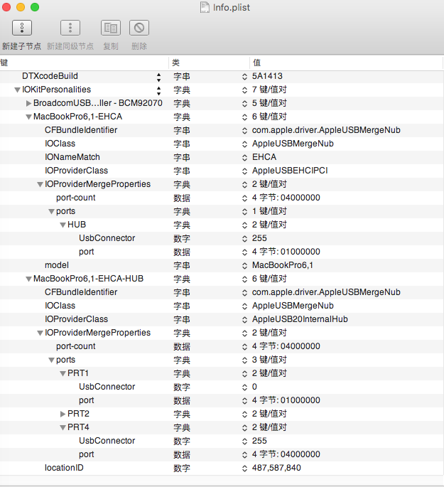

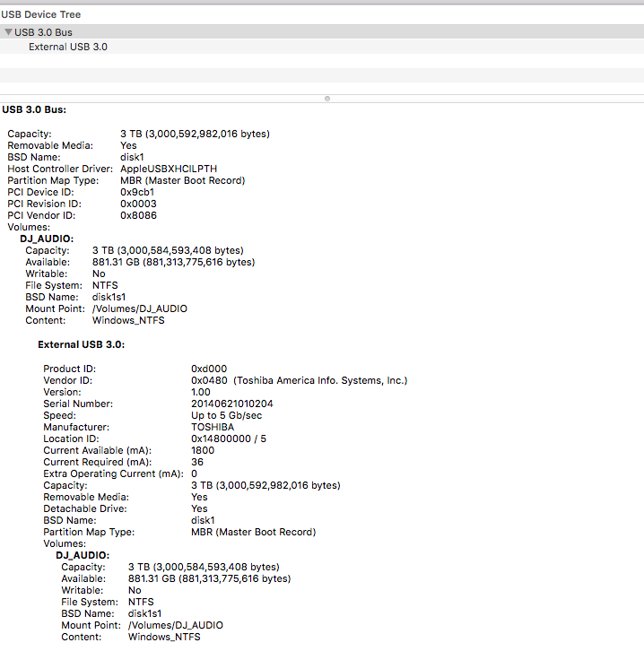

Rytz Posted September 9, 2015 Share Posted September 9, 2015 I was able to get all 4 USB ports working in 2 different scenarios:[1] Modify AppleUSBEHCIPCI.kext to force PRT1 on EHC1 @ 0x01. All 4 ports work but USB3 shows up under USB2 hub with only USB2 speeds. [2] Modify AppleUSBXHCIPCI.kext to replace 0x8c318086 with 0x9cb18086 under AppleUSBXHCILPTH1 > IOPCIPrimaryMatch. Also remove port restrictions under MacBookAir6,2-XHC1 > IOProviderMergeProperties. In this scenario, all USB devices show under the USB3 bus and USB3 devices in USB3 ports get USB3 speeds. USB2 devices work fine. My AppleUSBEHCIPCI.kext is never loaded on startup. I always have to load this kext manually. I'm not sure why. Even with the original IOUSBHostFamily.kext, it doesn't load on startup. No matter what types of changes I make from the suggestions in this thread, I cannot get the mix and match of USB2 and USB3 devices under the correct bus/hubs. At least with scenario #2 above, I can get fully working ports with USB3 speeds (tested). My Bluetooth was working in Yosemite 10.10.5 with RehabMan's atheros kext, but I have been unable to get Bluetooth to work with any changes made during these USB tests. I still get "Bluetooth: Not Available" on the menu bar. RehabMan has suggested that my hubs are not properly set up. One thing I've noticed from my DSDT is that EHC2 exists but is never picked up by IORegExp. I also did some debug traces in the DSDT to see if methods under that HUBN are called but they are not. I added an entry to AppleUSBEHCIPCI.kext for EHC2 but the entries don't show up in IORegExp. I'm not sure what else to try for Bluetooth. I have attached my DSDT and ioregs. Thanks. rytz’s MacBook Pro.ioreg.zip DSDT.dsl.txt Link to comment https://www.insanelymac.com/forum/topic/306777-guide-usb-fix-el-capitan-1011/page/12/#findComment-2166406 Share on other sites More sharing options...
Rytz Posted September 10, 2015 Share Posted September 10, 2015 Got my USB ports(USB2/3 + USB3 speeds), bluetooth, and webcam working. My DSDT was not configured to enable the ports associated with bluetooth and webcam. Once I enabled those, I was able to see everything without port restrictions in the kexts. You can find the details by searching another forum with the title "Atheros Bluetooth: IOath3kfrmwr.kext: Not Working (AR3011)". My final solution: DSDT edits (below) and injector kext (below) to bypass apple and allow no port restrictions.Some important notes: > EHC1/2 are renamed to EH01/2 in DSDT to avoid apple conflicts. They are identified as so in the injector. > XHC is labeled as XHC in DSDT (no changes required). > "AppleUSBXHCILPTH1 > IOPCIPrimaryMatch" must match IOreg: added to injector and changed to "0x9cb18086" > Injector removes all port restrictions (no entries under IOProviderMergeProperties). Bootup seems normal again after a couple boots. These fixes all for Acer Aspire E5-771-74E7.Special thanks to RehabMan! RYTZUSBPortInjector.kext.zip rytz’s MacBook Pro.injector.ioreg.zip DSDT.dsl.zip Link to comment https://www.insanelymac.com/forum/topic/306777-guide-usb-fix-el-capitan-1011/page/12/#findComment-2166659 Share on other sites More sharing options...

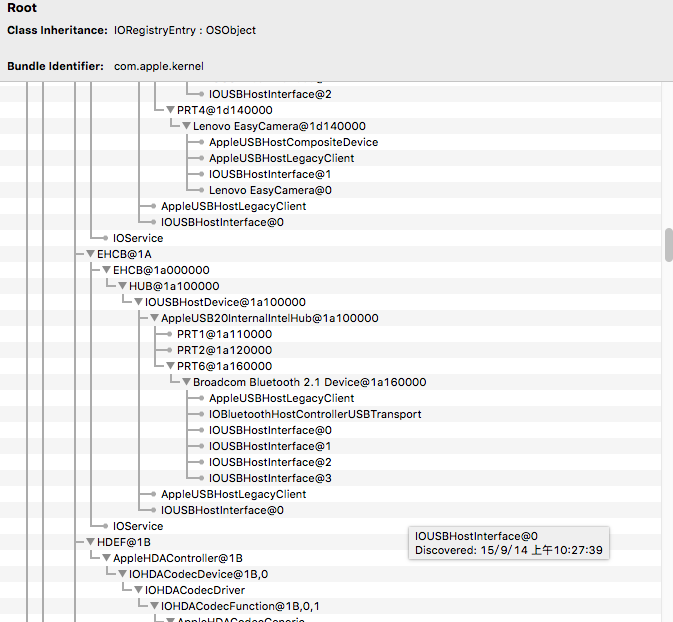

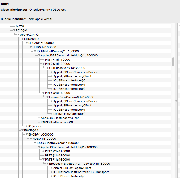

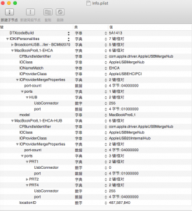

ninggu2008 Posted September 14, 2015 Share Posted September 14, 2015 @RehabMan I have a sleep problem. After inject info.plist, all my usb port and internal usb devices work fine, but my laptop only sleep a second and instant wake itself automatically, The log shows Wake reason : EHCA EHCB。 My laptop is HM55 motherboard, with 4 usb2.0 port, and 1 Internal usb camera, 1 Internal usb Bluetooth. If I disable the internal usb devices (both camera and bluetooth) by not inject them to info.plist, and other 4 usb2. port inject and work fine, then sleep works fine, no more instant wake itself. If I disable the internal usb devices, even I plug a mouse receiver, then sleep, the laptop won't wake itself. It seems that the internal usb devices wake my laptop, neither the devices plugged in usb port. I had try many ideas , patch dsdt--remove all _PSW _PRW method in EHC devices, edit or remove _UPC method in Bluetooth , change usbconnecter value in info.plist, no lucky. My dsdt has no _PLD method. More information: OS X El Capitan GM Candicate 15A282a Chameleon 2758 + BIOS + MBR Thank you for your help. IOreg and dsdt, injected info.plist lhl的MacBook Pro.zip dsdt.zip Info.zip Link to comment https://www.insanelymac.com/forum/topic/306777-guide-usb-fix-el-capitan-1011/page/12/#findComment-2167725 Share on other sites More sharing options...
RehabMan Posted September 14, 2015 Share Posted September 14, 2015 @RehabMan I have a sleep problem. After inject info.plist, all my usb port and internal usb devices work fine, but my laptop only sleep a second and instant wake itself automatically, The log shows Wake reason : EHCA EHCB。 Disable "wake on USB" in BIOS. If not available, DSDT patches required... Link to comment https://www.insanelymac.com/forum/topic/306777-guide-usb-fix-el-capitan-1011/page/12/#findComment-2167734 Share on other sites More sharing options...
ninggu2008 Posted September 14, 2015 Share Posted September 14, 2015 Disable "wake on USB" in BIOS. If not available, DSDT patches required... Thank you for your replay. There isn't "wake on usb" in bios. what kind patch should I use? I tried many but no lucky. Link to comment https://www.insanelymac.com/forum/topic/306777-guide-usb-fix-el-capitan-1011/page/12/#findComment-2167736 Share on other sites More sharing options...

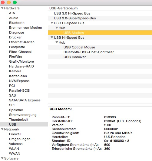

pinarek Posted September 15, 2015 Share Posted September 15, 2015 i have a problem with my US Robotics USB Modem 5637 for Fax, only this not work in El Capitan GM. All another USB 2.0 and 3.0 works fine. here is a screenshot from USB Modem in Systemprofile... Excuse me is from actual Yosemite 10.10.5... a moment i will boot from El Capitan GM the left Picture si Yosemite 10.10.5 all ok the right Picture is from El Capitan 10.11 GM see mA = 0 is available and Modem can't in systemconfig--network and Printer add see. Is this a Modem Driver problem or USB 2.0 Problem ? i need this for faxing on my Hackintosh. Here ist the Picture from El Capitan GM: http://www.insanelymac.com/forum/uploads/monthly_09_2015/post-6397-0-54816400-1442362762_thumb.jpg is a error here in Google Chrome browser, i see not the 2. Picture. In Safari see 2 Links from 2 Picture. Link to comment https://www.insanelymac.com/forum/topic/306777-guide-usb-fix-el-capitan-1011/page/12/#findComment-2168231 Share on other sites More sharing options...

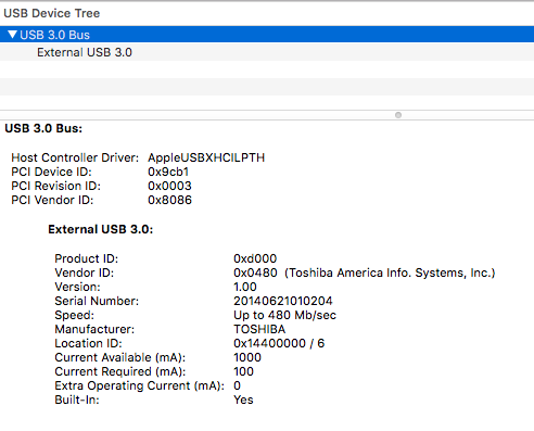

jperkins909 Posted September 17, 2015 Share Posted September 17, 2015 "For USB 3.0, it's different. Instead of using name (IOMatch), AppleUSBXHCIPCI will use ID to attach kext to USB 3 device in DSDT" How do I get the ID for my USB that will work for this? Because everything is defaulting to usb2 and if I understand correctly unless the ID field matches your hardware usb3 doesn't work? or is it just me..any help appreciated. 1 Link to comment https://www.insanelymac.com/forum/topic/306777-guide-usb-fix-el-capitan-1011/page/12/#findComment-2168533 Share on other sites More sharing options...
