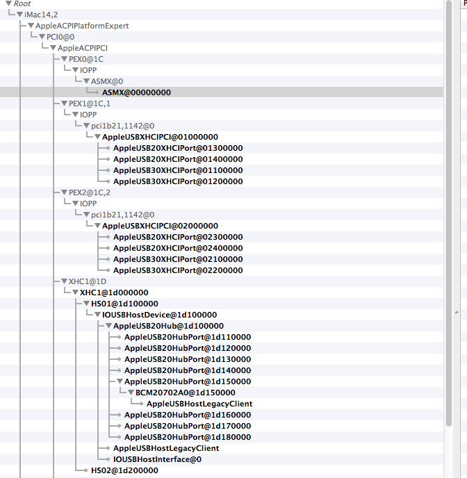

OK maybe a little help here because I am just not getting it and I really should after so many years of this.  I posted a picture on page 14, of the kernel panic as others have seen to, and in my case disabling USB3 or ASMedia did not stop the panic.  What allows me to boot without a flood of ASMX messages was VHC888 dummy kext for Z87 even though mine is an Asus X79, but only 2 USB ports work no biggie for now since I get past the kernel panic and no flood of ASMX messages.
Now here is the dilema and I think we are missing something here or its just me.  Without any 3rd party kexts I can boot into 10.11 after about 8 to 10 tries same pattern over and over weird ha?  Anyhow when I am able to boot my ASMedia USB3 ports are working!!  Not all ports but at least 2 in the back and 1 in the front and yes they are USB3 not USB2 according to Ioreg, now how can that be possible??  That is why I think we are missing something here?
I am trying to figure out what connectors/port addresses I need to modify in the dummy kext?  It seems that connector 0 and 3 for SMBIOS iMac14,2 in the unaltered dummy kext is not enough in my case.  I have 5 physical USB connectors on the Asus X79, and four of them are USB2 and 1 is USB3 which I can connect 2 of the 4 USB2 and 1 of the USB 3 connectors from PC case.  Does this mean I need to add connectors 0,1,2,3,4 and whatever the ones are in the back also part of the motherboard, then assign the HS and SSP and port addresses?  Do I use the port addresses I see in the ioreg because none of them are 10000000, 20000000 etc etc.,ioreg screenshot below.   Do I just name them as they are in the ioreg such as port 1d110000 through 1d14000 as you see under XHC1, HS01 and then XHC2, HS01 port 1a100000?
Can I name the connector number whatever I want as long as there are that many connectors on the motherboard?  Also what is the ASMX@00000000 because its that one that floods me with messages if I do not use a dummy kext.
Excuse me for my dumbness on this but if its as simple as placing the connectors 0 through 5 maybe one or two more because there are some that are already soldered to the board in the back and changing the port numbers as they are in the screenshots then I am good to go!!
My DSDT was posted on page 14 if you want to look at it but nothing in that DSDT will help me as the names such as connectors, hubs and port addresses are look nothing like what you see in the dummy kext.
Thanks

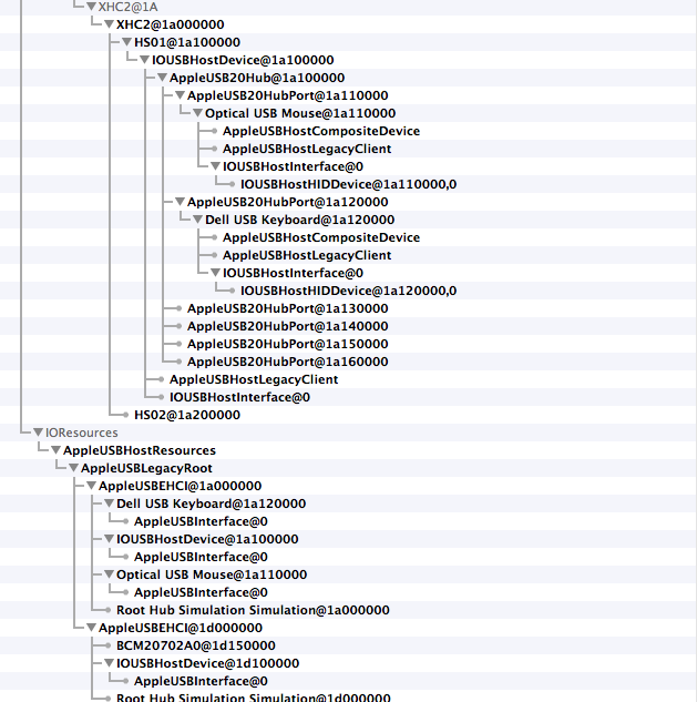

Thanks for replying.  I gave that a try and without the dummy kext I get the panic and I don't think the panic is from the USB3/ASMedia but rather some port address memory conflict possibly?  If I use your kext or the one I modified with the addresses in the ioreg, which made no difference as far as which ports are enabled and which are not I am able to boot perfectly, no ASMX messages.  Just 2 of the 4 USB ports in front don't work.  I had a developer help me design the DSDT/SSDT and here is what he came up with based on my Windows 10 RW-Everything and AIDA64 extracts.  Windows PCI/Device dumps and ACPITables.
He named the EUSB and USBE to XHC1 and XHC2.
Edited:
I just now realized that even the un-modified XHCI dummy kext works as well.  I don't think it worked before because I did not fix permissions and/or ignore caches!!
Edited Again:
I tried the EHCI Dummy kext with and without the XHCI dummy and with it all USB ports are disabled and without XHCI, I get the kernel panic.  So the only temp fix for now is to run the un-modified XHCI dummy until a Generic XHCI driver is available for the ASMedia 1042 in OS X 10.11.
DSDT.aml.zip
SSDT.aml.zip
SSDT-1.aml.zip
@VCH888,  I will give this another shot.  I actually did the edits in DSDT instead of SSDT and did not use Scope.  Would I do the same for PEX0-2 with Scope in SSDT?   Question about the connectors.  For iMac14,2 the Dummy XHCI kext has connector 0 and 3.  Do I need to add more connectors, to enable the other two USB2/1.1 ports in front and enable the USB3 in back to work as USB2?  Mid. USB2/1.1 has four physical connectors but the PC case only has provisions for two cables to front connection four usb2/1.1 ports and for some reason only two of those four ports work in 10.11.  Same with USB3 mid., there is only one PC Cable for that connector, and only one, not two USB3 ports in front. All the rest of the ports USB1.1/2/3 are soldered onto motherboard assuming this is the form factor for most modern day ATX/Mini-ATX Mb's?
I will try adding more connectors just to see if it does make any difference, unless 10.11 goes strictly by SMBIOS definition of connectors 0 and 3 for iMac14,2?  Changing the port ID certainly did not make any difference.

Hello to all participants here. I have a hackintosh that is basically a GA-P55M-UD2 v1.0 mobo with a USB3 PCIe expansion card installed in order to have USB3 capability in the PC. The card controller is Renesas based and in Mavericks it was working very well thanks to the Genericusbxhci kext. In Yosemite it worked with this kext too but I had to connect the device to the card port prior to turning on the PC since for some reason the PC did not recognize the device when connected after booting and starting up completely to the desktop. I recently cloned the Yosemite partition and upgraded directly to 10.11 GM candidate in the newly created partition. To make the USB mouse and keyboard work, I had to apply the EHC1 & EHC2 rename DSDdt patch in the Clover config.plist file following Rehabman instructions. I was wondering if I can do something at this stage to also force 10.11 to recognize and allow me use the USB3 expansion card ports. Attached is my ioreg file.
I feel that there is no universal method for fixing USBs on El Captian which is why many are confused. Some say to edit the DSDT, others say make your own injector, and others say use dummy kexts. And then some say use fakepciid to override usb 2.0. I'm not even sure what method is the best.
Any VIA805 or any other VIA controller usb 3.0 users here that have working usb 3.0 ports? And any guides on creating a port injector kext? At least an outline of what you should put in there? in my case that seems to be the only solution for my setup.
I don't think any third party xHCI controllers are working in 10.11 right now. Does AppleUSBXHCI load for your VIA VL805? What do you see in IORegistryExplorer under RP0x (wherever the VIA VL805 xHCI controller is on PCIe).
The back 4 USBs are detected by OS X since I can see that they list the correct names for those USB sticks. However those drives never get mounted. I checked System Info and AppleUSBXHCI is loaded.
I uploaded the IOREG. One of the USB drives is a real 3.0 device.
I'm not sure what approach to take. Using iMac 14,2 SMBIOS.
MSI H81ME34 IOReg.zip
Which one of these drives is the USB 3.0 device? I see four USB devices under PXSX.
In this case anything that is a USB 2.0 device in the PXSX section is under AppleUSB20XHCIPort@0XXXXXXXX. Anything that is a 3.0 device is under AppleUSB30XHCIPort@0XXXXXXXX. The 3.0 external hard drive is called AS2105.
And then there are other USB ports but those are controlled by Intel. These work normally without any modifications. SSP1 and SSP2 are the front panel 3.0 ports. Its the VIA805 ones that aren't working (4 ports) which leads me to believe that AppleUSB20XHCIPort and AppleUSB30XHCIPort aren't doing anything.
Not sure what method to apply here.
According to your IOReg your AS2105 is under a USB2.0 hub under the RP06/PXSX device. Not sure why this is happening, but this is probably what's limiting your speeds to USB 2.0. I think third-party xHCI controllers won't work for the time being with USB 3.0, so OS X is probably forcing all devices to connect to the USB 2.0 ports.
