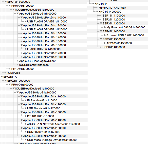

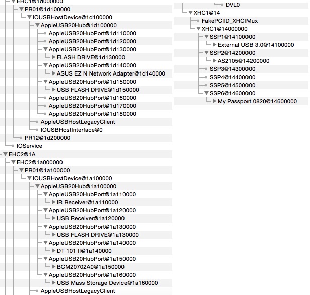

I tried to fix, following the guide on the first post but I noticed my ports (even with EHC1 and EHC2 present) are named UHC1... UHC6 in DSDT as in the picture below:
Without the DSDT, booting El Capitan with the one created by Clover and patched on-the-fly they look like the picture below:
I wasn't able to fix the dummy file or make the ports working by removing the ports restrictions.
When I boot with my DSDT the USBs look like this in the System Report:
And, if I boot without the DSDT, they are like this:
I'm attaching my DSDT to see if someone can help me.

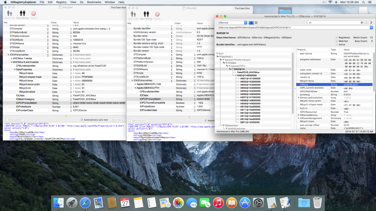

X99 USB Fixed
I used x99gaming g1 board just change IOPCIPrimaryMatch Id to 2kexts.
AppleUSBXHCIPCI.kext
0x9c318086
FakePCIID_XHCIMux.kext
  0x9c318086 0x9cb18086 0x8d318086 0x8cb18086
After change ids worked well.thanks RehabMan Can you add this Ids your kext.
0x8d318086
DP4.zip

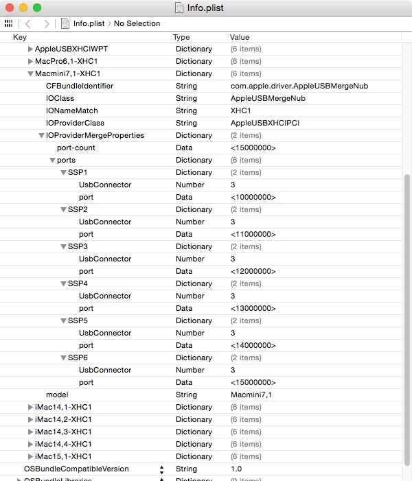

Any ideas how to add ports to my EHC1 and EHC2? I managed to add ports to my XHC1 but I have problems with EHC1/2. I tried removing port count but then I have a non working USB 2.0 ports.
In my DSDT the XHC1 is constructed like this : XHC1>RHUB>HSP1..4SSP1..4
My EHC1 is like this: EHC1>RHUB>PRT1>PRT1..8
Here is my ioreg.
