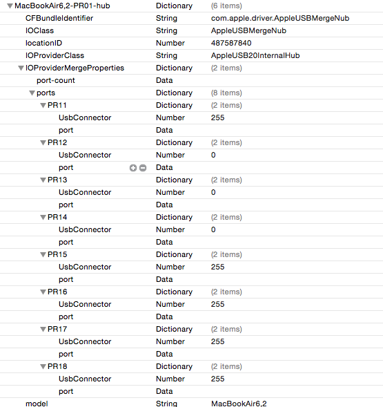

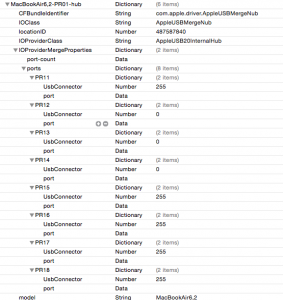

Through a bit of experimentation (and intuition) I was able to determine that the same properties (port-count and ports) that are read by the controller driver, are also read by the hub driver.
The trick is injecting the properties with an appropriate IOKitPersonality match:
Matching on provider class AppleUSB20InternalHub and locationID.  The locationID (0x1d100000, decimal 487587840) is the locationID you see for the hub in ioreg.  It is based on the port address and controller address.
The complete injector is at my u430 repo: https://github.com/RehabMan/Lenovo-U430-Touch-DSDT-Patch

Or you can inject port-count and ports for the hub itself and leave DSDT untouched.

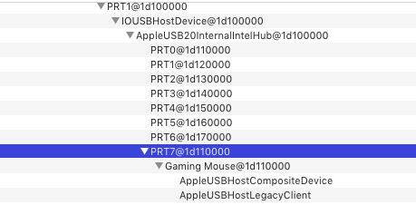

Yeah, I need an injector. Now I am looking at yours and trying to figure out to build one for myself.
Edit:
Thank you for your work, now I have all my ports defined in ioreg. Great work.
Edit2:
My mouse is working when plugged in USB 3.0 and FakePCIID is doing a great job now. :D

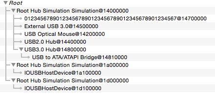

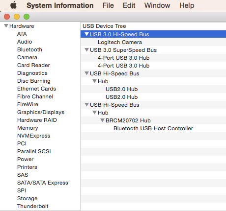

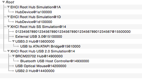

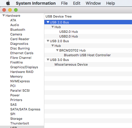

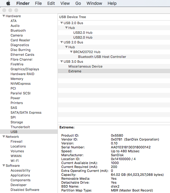

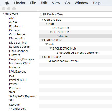

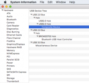

I have a problem that I hope someone here can shed some light on... I have a BRIX Pro with a Haswell i5-4570R. I set it up as a iMac14,1 because it most closely matches the DSDT. It only has 4 USB-3 ports and all of them work fine in El Capitan. My problem is that I've got Apple's BCM94360CD Wifi/BT card in the PCI/e slot. This has always showed up fine as stock Apple up until now. The Bluetooth just doesn't appear in El Capitan. It appears as a hub on one of the two active USB3 ports in Yosemite.
Any ideas? Thanks.
Any ideas? Thanks.
Try with BrcmBluetoothInjector.kext: https://github.com/RehabMan/OS-X-BrcmPatchRAM

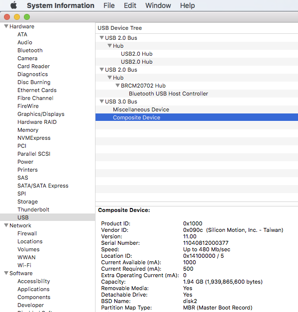

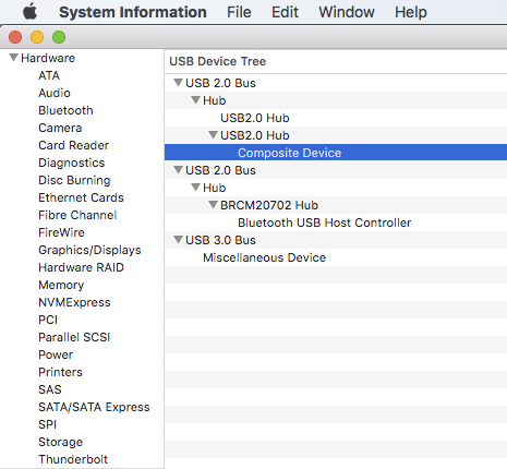

I have been comparing the USB ports on my Yosemite partition with my recently created El Capitan (PB4) partition, some of the USB 3.0 ports are not listed in El Capitan although they do seem to work at USB 2.0 speeds.

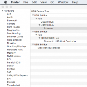

I don't use a DSDT, instead I have some patches created for me by TimeWalker75a but I assume this change is still related to the changes to USB in El Capitan?
Yosemite:
El Capitan:
El Capitan with USB 2.0 Drive attached (Front Left):
El Capitan with USB 2.0 Drive attached (Front Right):
El Capitan with USB 3.0 Drive attached (Front Left):
El Capitan with USB 3.0 Drive attached (Front Right):

Post ioreg using IORegistryExplorer v2.1.
It took a bit to find version 2.1 again, but I found it. Here are my ioreg files for Yosemite and El Capitan. Both use the same Clover loader. Thanks!
I don't really see a Broadcom BT device on the USB bus. So... I think you have a USB problem to solve first.
Yes, I've been trying every USB trick I could find. The Bluetooth shows fine in Yosemite (1st picture) but is missing in El Capitan (2nd picture). Everything else looks kosher. Anything I plug into the 4 USB3 ports works fine.

I have tried various configurations of the EHCI and XHCI Dummy kexts and lack thereof. Nothing I did seemed to make a difference. The 4 USB3 ports worked out of the box in every configuration, with or without renaming EHC1 & EHC2 of the DSDT in the config file.
The problem I suspect is due to the fact that the DSDT defines 24 USB ports while only using 4 USB3 externally and 2 internally for each mini pci-e slot. With ElCap's limitation of 15 ports, I suspect my internal ports fall in the upper 9 ports. I would try editing out the unused ports if I had any idea which was which and, of course a better idea of how to edit the DSDT properly/safely.
Edit: The FakePCIID & FakePCI_XHCIMux had no effect...
So close... So close...
I have discovered that the DummyUSB extensions just don't work on this system through Clover's Kext Injection. I moved it to /Library/Extensions and it loaded! As an experiment, I reversed the order of the ports for iMac14,1 and the Bluetooth loaded! I then removed ports HS10 through HS15 (High Speed?) to make space for SSP1 through SSP6 (Slow Speed Port?). Now every port works along with the internal BT port, except they are all USB2 now. Before I got BT back, all were USB3 only...
Now, I guess I can dig into the OP to understand exactly how to configure DummyUSBXHCI.
Thanks!
